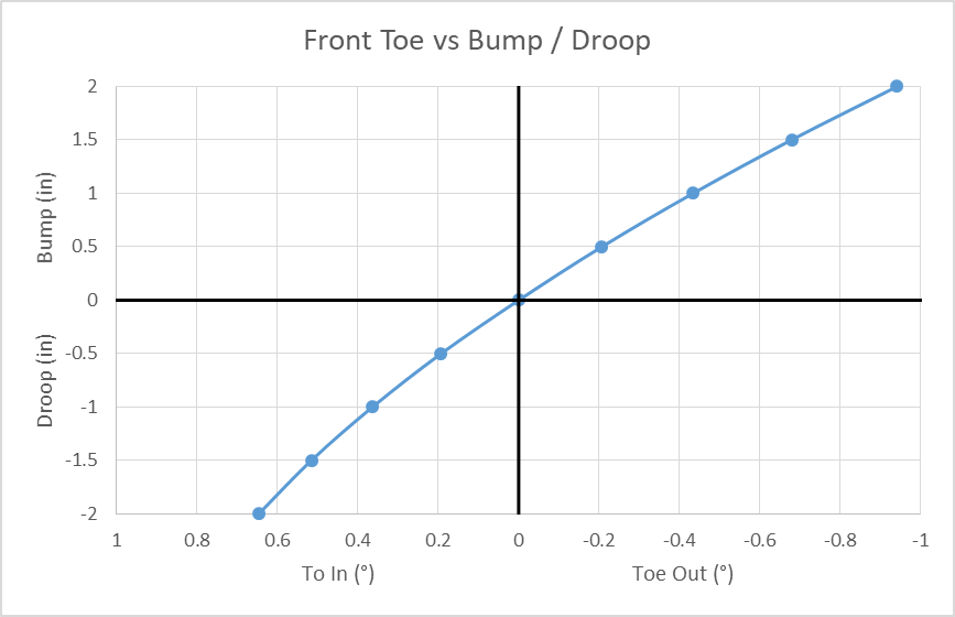

Toe:
Here we have toe out on bump and toe in on droop. This contributes to roll understeer in the front. There are many factors that contribute to the overall balance of the car, and this is just one of them.
Understeer and oversteer are not necessarily good or bad. Some highly skilled drivers may prefer oversteer, because of their ability to adjust and react quickly. Most production cars are setup with understeer, because most drivers are not skilled enough to take advantage of oversteer characteristics.

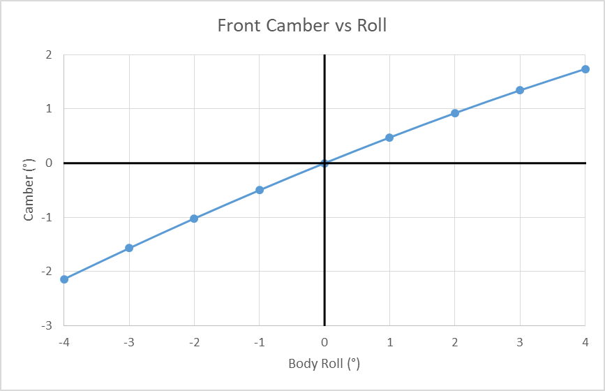

Camber:
In general, as this curve approaches horizontal, grip in a corner will go up and grip in a straight line while accelerating or decelerating will go down.
This particular curve is more aggressive than you would want for a street car and is more suited for the track.
