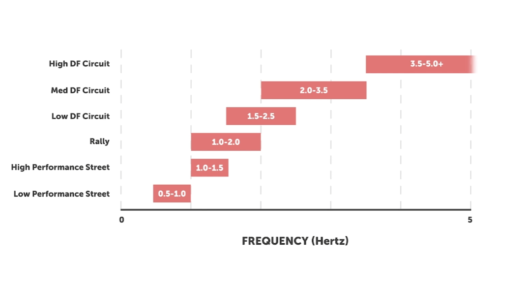

I recently signed up for HPAcademy and started working hard on their suspension tuning courses. With a lot of measuring and crunching numbers I feel like I have missed something since the stock springs from DF are almost double what I'm calculating. I've only calculated for the front so far as the numbers seem wildly off. Lets type it out for sanity and double check
Step 1) Determine desired suspension frequency
-Based on the following chart provided by HPAcademy I chose to use 1.5Hz as the target frequency. I have little experience on what frequency I'm looking for but based on the other options I believe this one makes the most sense as the goblin is definitely high performance street but not far enough to be considered a low down force car. If anyone has any insight of a frequency they would choose please let me know.
