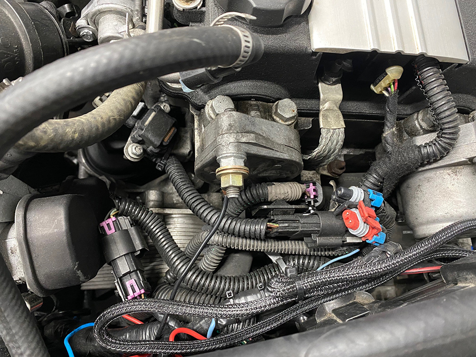

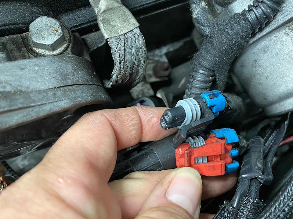

Wondering what you guys are getting as max psi in 2nd gear from stock LSJ. Mine is 2006. I'm seeing 9-10 psi max from mine and wondering if that's normal. Just usual DF Intake and a custom exhaust. Engine has healthy compression 215 or so across all cylinders and vacuum seems fine.
I am getting code P0033 Turbo Bypass Valve which would make sense if I have an issue with this.
The vehicle was built when I purchased it but I noticed two unused harness connectors in the area of the bypass valve and wondering if I'm missing anything needed for the bypass to function correctly. TIA

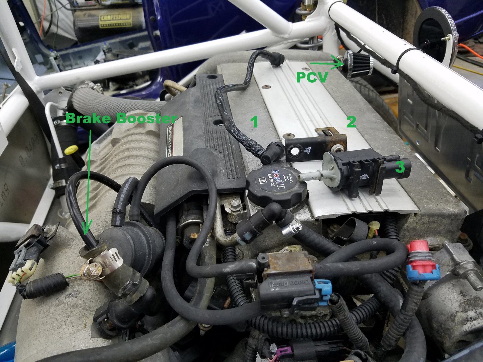

Those look like the evaporative emissions plugs. Most people don't keep them...I did just in case I ever need or want to put the canister back on. I hit 16psi in second gear but am tuned with a smaller pulley and other mods to support it. Not sure what the stick "setting" is supposed to be.

Ok cool yes I get codes for the Evaporative system as well but I ignored them. Other than that and the Fuel tank pressure nothing else besides the Bypass valve. I just want to make sure it's nothing obvious before I go and buy a replacement Bypass valve for $100

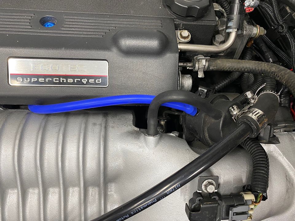

So looks like the blue connector is indeed actually for a boost solenoid of some sort
You don't actually have to have the boost solenoid but the line has to be plugged to prevent vacuum leaks.
I see the blue vacuum line leading to the intake, is that connected somewhere under there?
Basically the boost solenoid is to open the bypass valve to bleed off boost. This is done to prevent overboost and control boost say in first gear to prevent too much boost.
I wonder if yours is connected to vacuum and the bypass is active all the time.
Although you shouldn't expect 15-16psi of boost with the OEM pulley.

Yes its connected. From what I see it would normally go in the solenoid and then come out and go back into where it is now so basically looks like the solenoid was removed. Would that trigger the code is the question. And still doesn't explain why I'm only getting 9 or so psi on WOT.

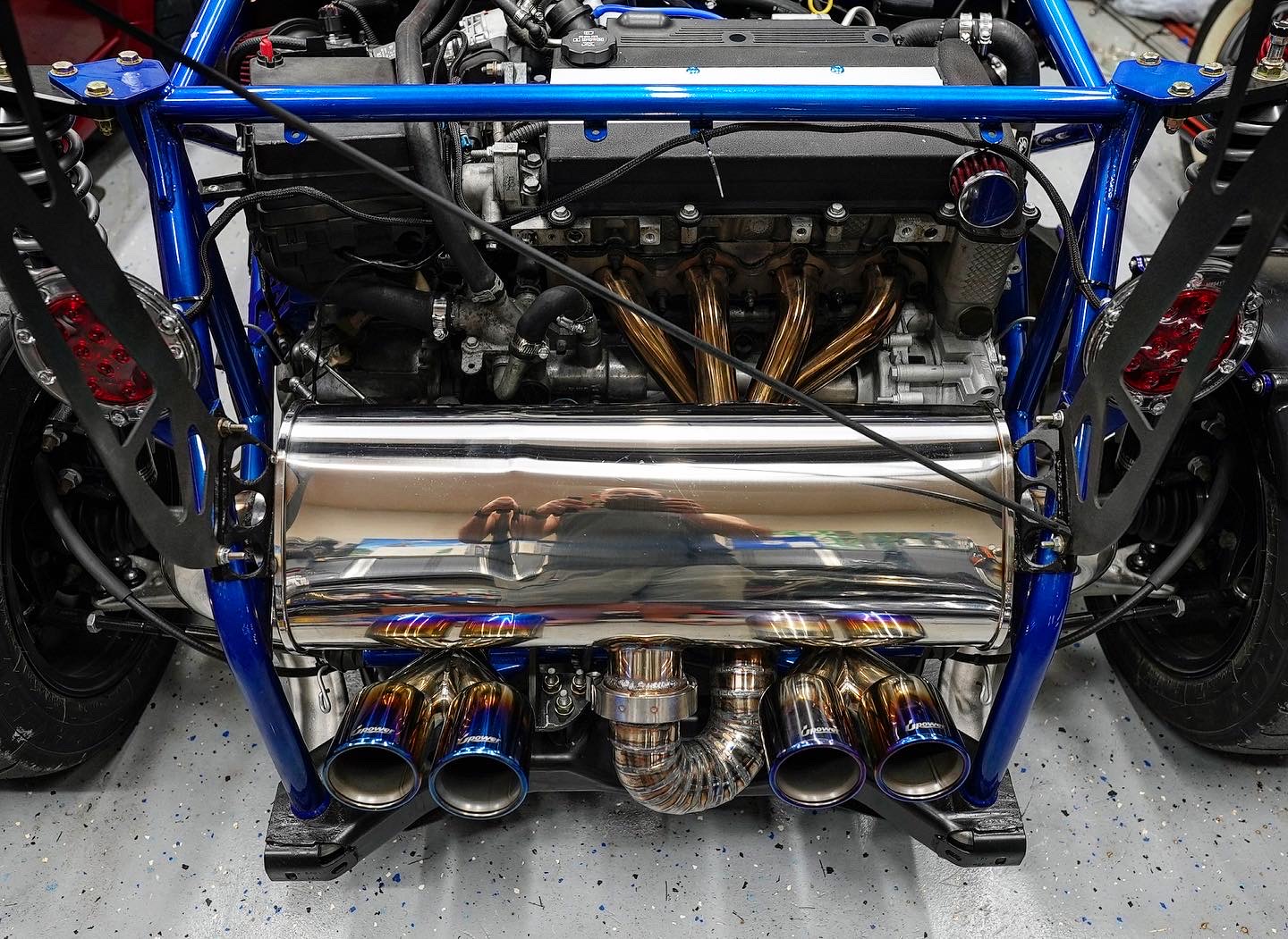

What is your custom exhaust setup? A free flowing exhaust, especially one with headers and no cats, will reduce boost pressure. Since you have good compression, 9/10 psi, and car is running smooth then I wouldn't worry too much about it. Might not hurt to solve the problem that is throwing the code, but if it were my car I wouldn't let that stop me from driving it.

ok yeah makes sense. It’s not that far off from what I’m expecting and I figured it may have dropped with the higher flow. I have a zzp stage 2 kit to install with a 3.0 pulley so just wanted to make sure everything was good before doing that. I ordered a solenoid and new bypass valve so I’ll see if that takes care of the code.
This is my exhaust. Zzp shorty header into custom vibrant setup.
