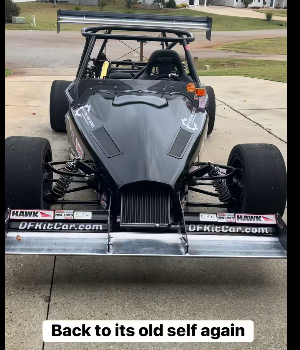

Justin posted a video of his rebuilt goblin.
54175
Justin Reed replied to me:
"it needed all new front suspension, right rear spindle, both rear struts, new rear wing, repaired front wing/rear uprights, frame tweaked on a jig, and the tires reseated"
