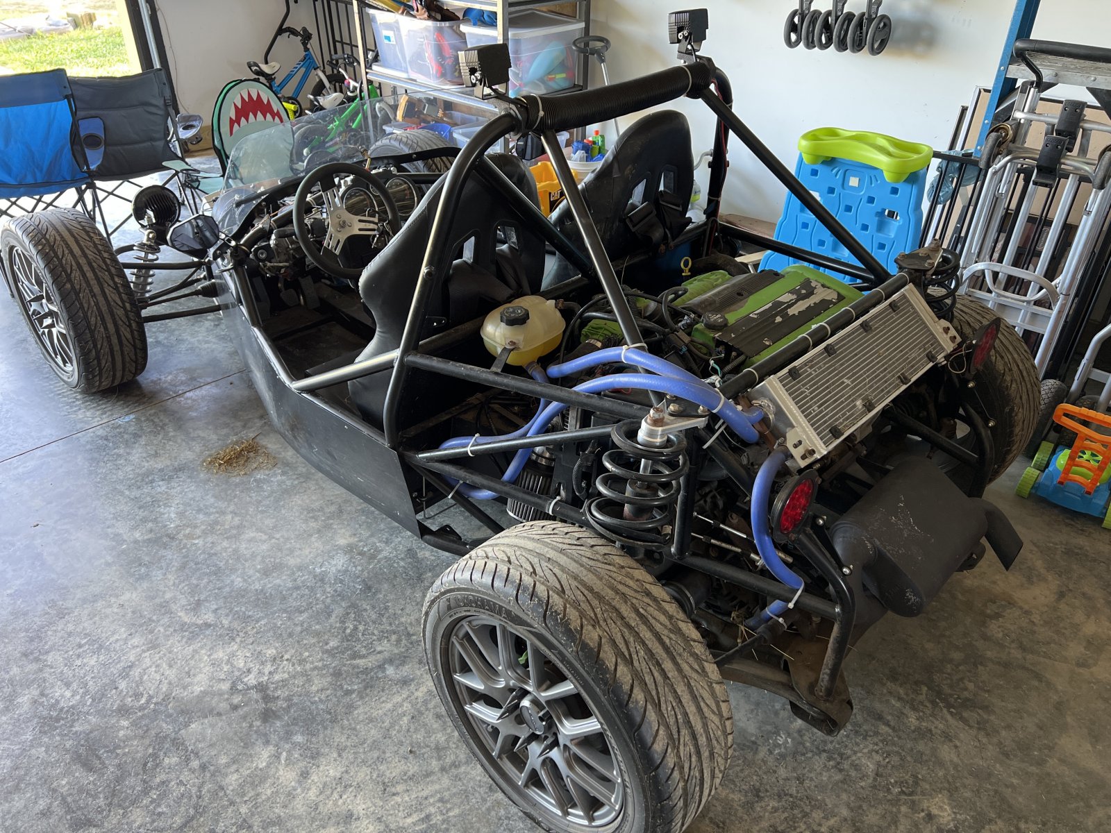

Hey guys, im finally in the home stretch to get my build street legal.
But when on test drives i feel like my suspension is very bouncy or floaty and feels like it sways side to side quite a bit...
I have tightened (clockwise) the front shocks as much as I can and i dont feel like theres any change...

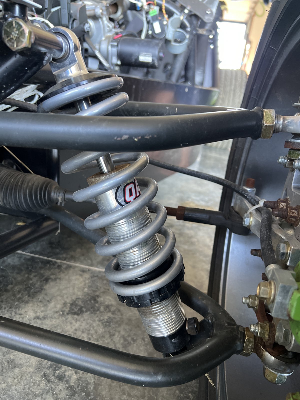

-front are the coil overs provided by df. (Adjustable)

Sorry, I miss typed my question about struts. I see that you have the Cobalt struts in the back. If you truly have a floating filling (60's land barge with worn out shocks) then it might be bad struts. If you have a darting, uncontrolled feeling when hitting bumps, then it's likely the things we are pointing out here.
The front coilovers are quite firm above 6 clicks or so. I'd recommend dialing them to full soft and adjusting from there to get the ride quality you want. I'm at 5 clicks from full soft for street use if I remember correctly.
