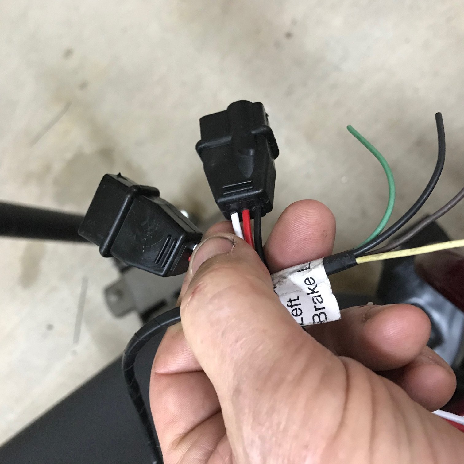

CaptFrank2001 Goblin Guru CaptFrank2001 Goblin Guru Nov 27, 2020 #1 There are two plugs on the DF supplied tail lights. One is a three pin the other is a two pin. How do these match up with the cars four wiries? Thanks Attachments IMG_7539.jpg 259.5 KB · Views: 309

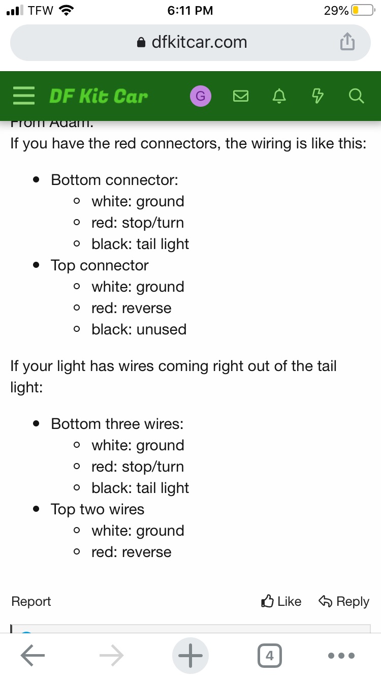

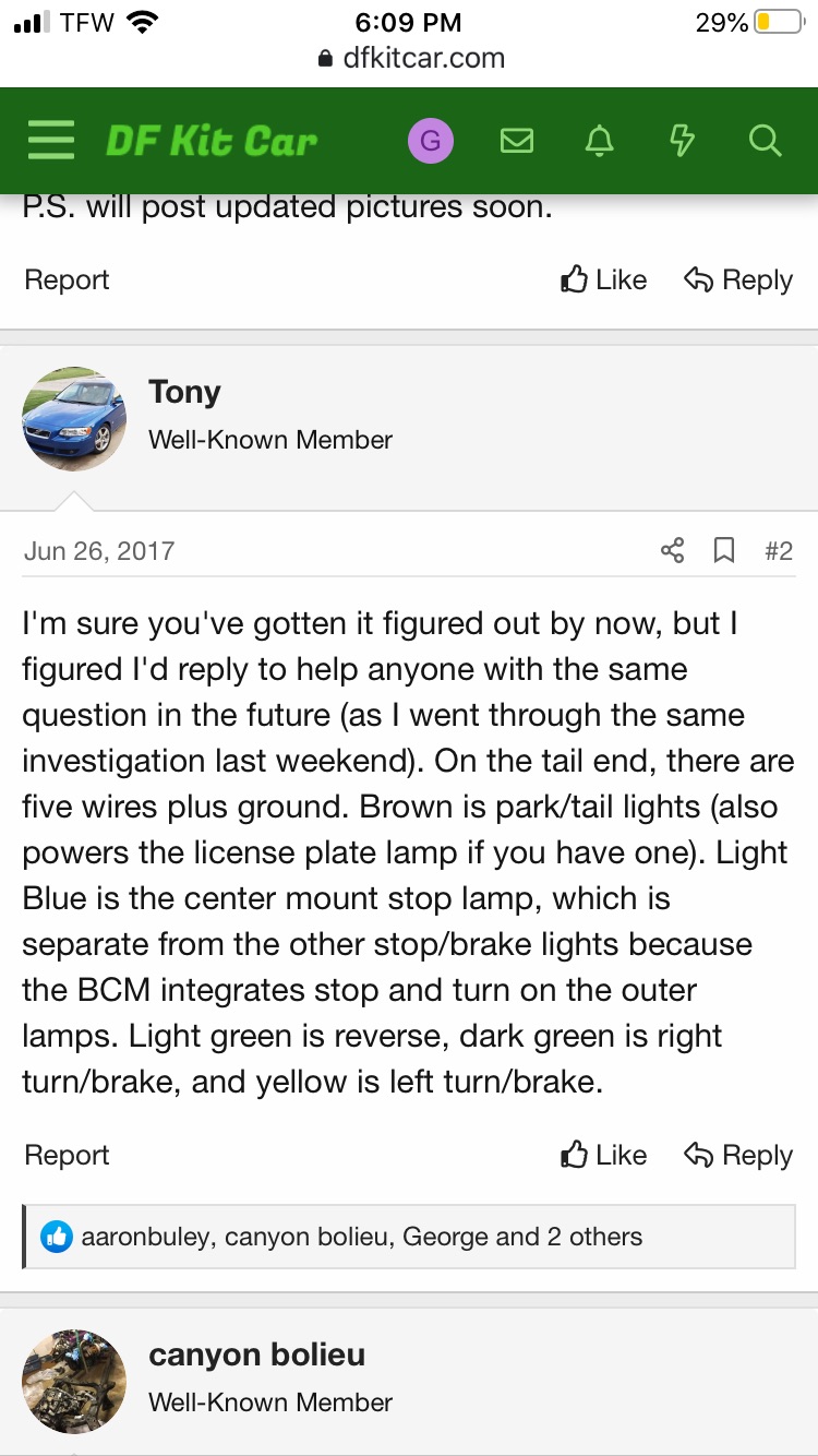

Goblin Graber Well-Known Member Goblin Graber Well-Known Member Nov 27, 2020 #2 CaptFrank2001 said: There are two plugs on the DF supplied tail lights. One is a three pin the other is a two pin. How do these match up with the cars four wiries? Thanks Click to expand... These screenshots I took a while back should help.
