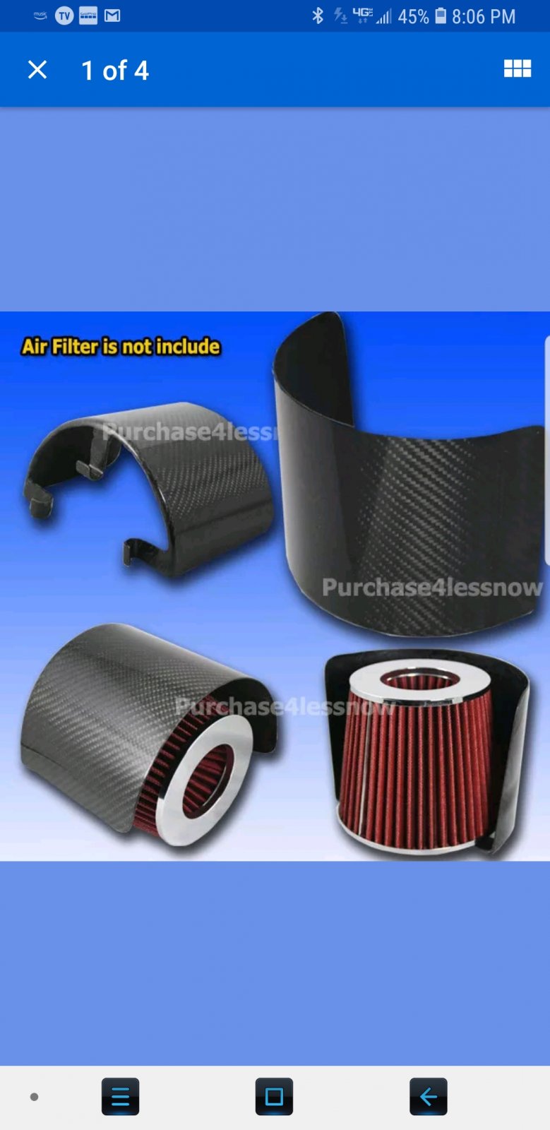

Ya I'm with you on the deaf ear haha. I was thinking about a half shell to mount around the top driverside of the filter. I really dont see a point in continuing with messing with mine. If it's that hard to get in then it will be super frustrating to take it in and out all the time to work on it.
Lethalcast
I'm just gonna go for one of these. It should help some I would imagine
