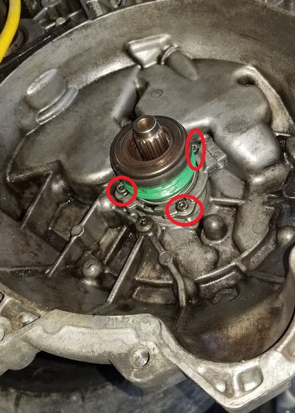

My 2006 SS SC clutch slave started acting up, so I had to separate the transmission from the engine. These 3 little bolts required a hand impact to get out.

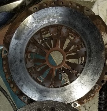

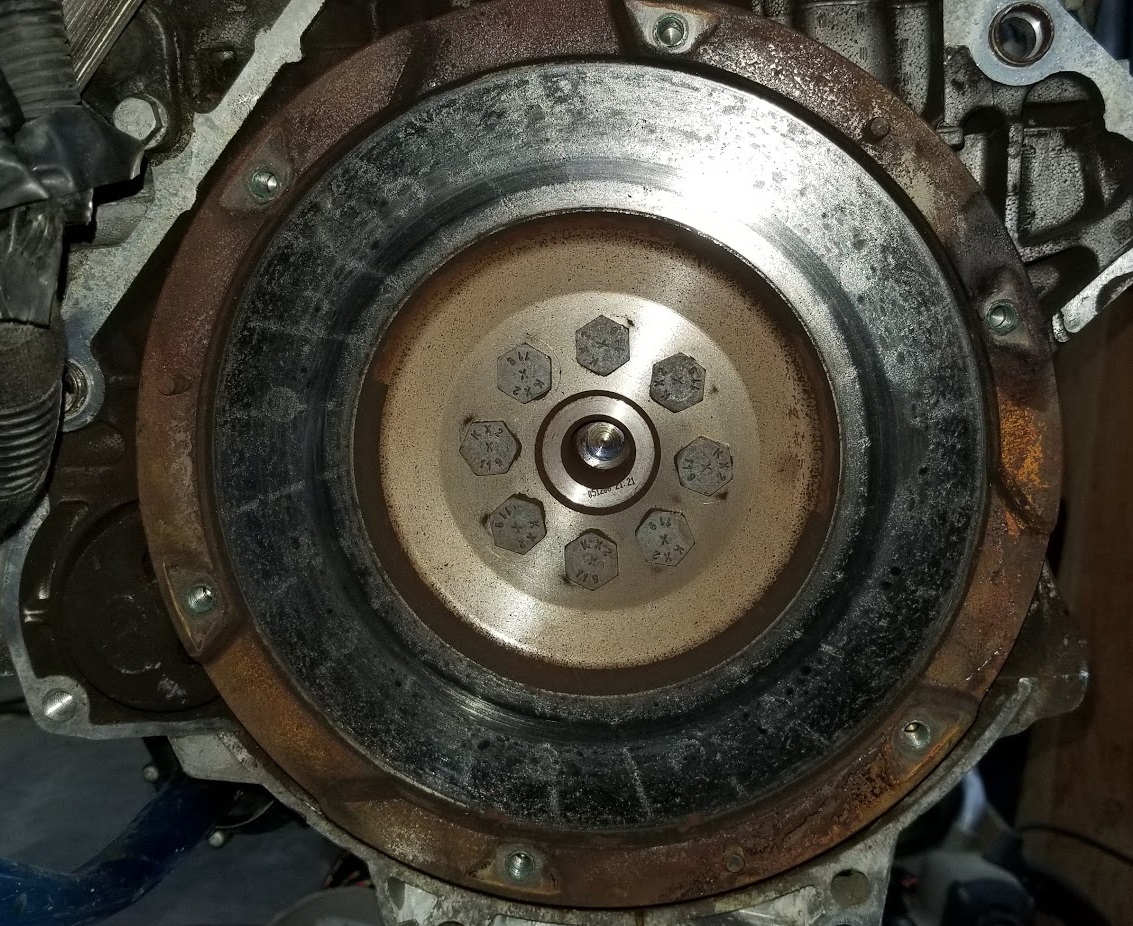

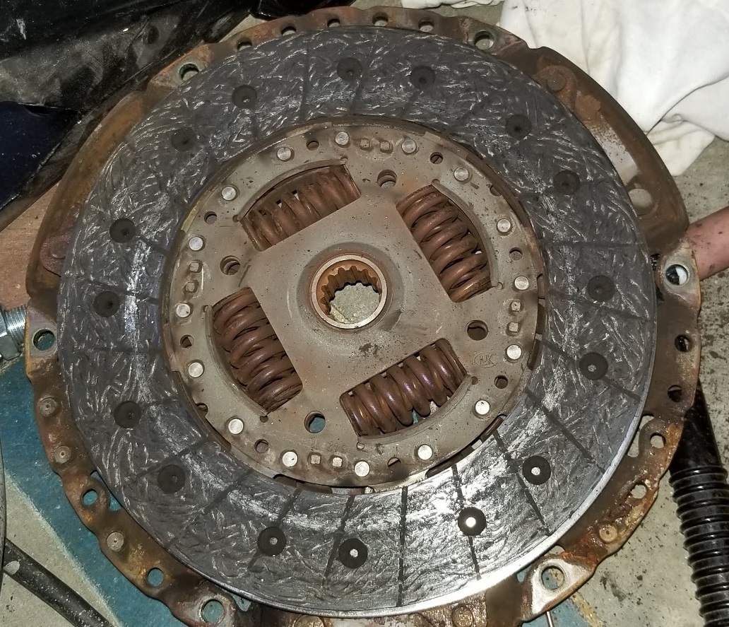

Once it was apart, might as well check the clutch. Seems to be transfering some metal from the clutch to the flywheel. It was working great before I took it apart, but I am here now, might as well do some maintenance.
Old flywheel, clutch & pressure plate pictures:
11608
11613
11614

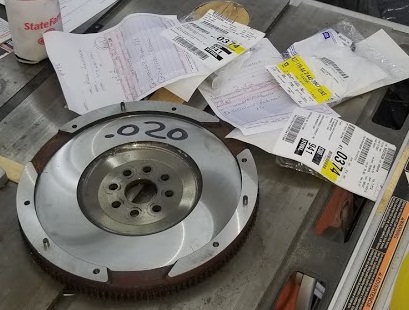

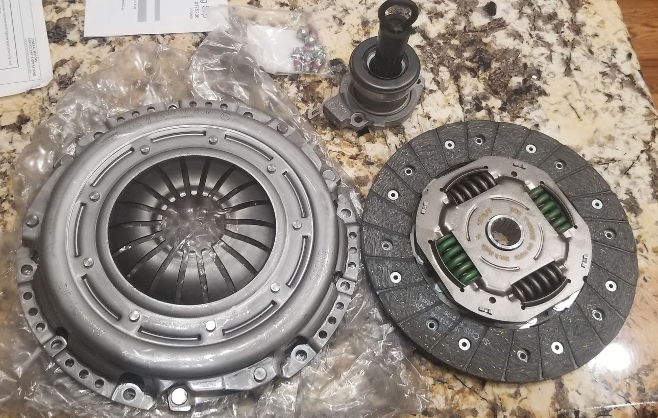

O'reilly auto parts resurfaced the original flywheel for $85, beside it was some chevy parts ($65) for the distribution block, plastic clip for it, & internal clutch line. ZZP sold me ($357) a 300hp GMPP clutch & pressure plate, 6 pressure plate bolts, LNF clutch slave for my LSJ, and a plastic alignment tool.
11609
11610
Still need to buy new flywheel bolts. Apparently the ARP ones are too tall, so I may have to go back to chevy parts at twice the cost.
Pros:
- Clutch price.
- Reviews say it feels like the stock clutch, so easy to drive.
- Stock dual mass 19lbs flywheel allows for easier clutch feathering, less likely to stall the engine.
- Resurfacing the stock flywheel is about half the cost of ZZP dual mass, and a lot less than a single mass flywheel.
Cons:
- 300hp. Although it is rated at 300hp for a Cobalt, many people said it was a conserative rating, and I am hoping our light Goblins will be easier on the clutch than a Cobalt. I don't know if I will build the engine higher than 300hp any time soon.
- stock heavy flywheel robs a bit of power when reving up the engine.
- There was 1mm of clutch material above the rivets on the old clutch. The new clutch arrived, and it has about the same 1mm of material, so maybe I didn't need to replace my clutch. Oh well, I am past that point now.

None of the images above shows a dual mass flywheel. On a dual mass flywheel the clutch surface floats on a bearing it is not locked to the crankshaft.
Dual mass flywheels are complex, some of them have springs, gears and counter weights inside.
If you hold the flywheel portion that bolts to the crankshaft, you can twist the clutch surface portion back and forth with your hands and feel it loading up some internal springs and other drive mechanisms inside the flywheel.

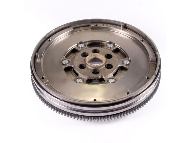

iir Our lemons car has one also it looks like this

The F40 transmission uses a dual mass flywheel. Resurfacing a dual mass is not something that most shops are capable of doing, it requires a special fixture to hold the two pieces rigid enough.
GMPP does make a performance dual mass set for the Regal GS, but is $$$ and getting harr to find.
All F35 and F23 transmissions use a single mass flywheel.
