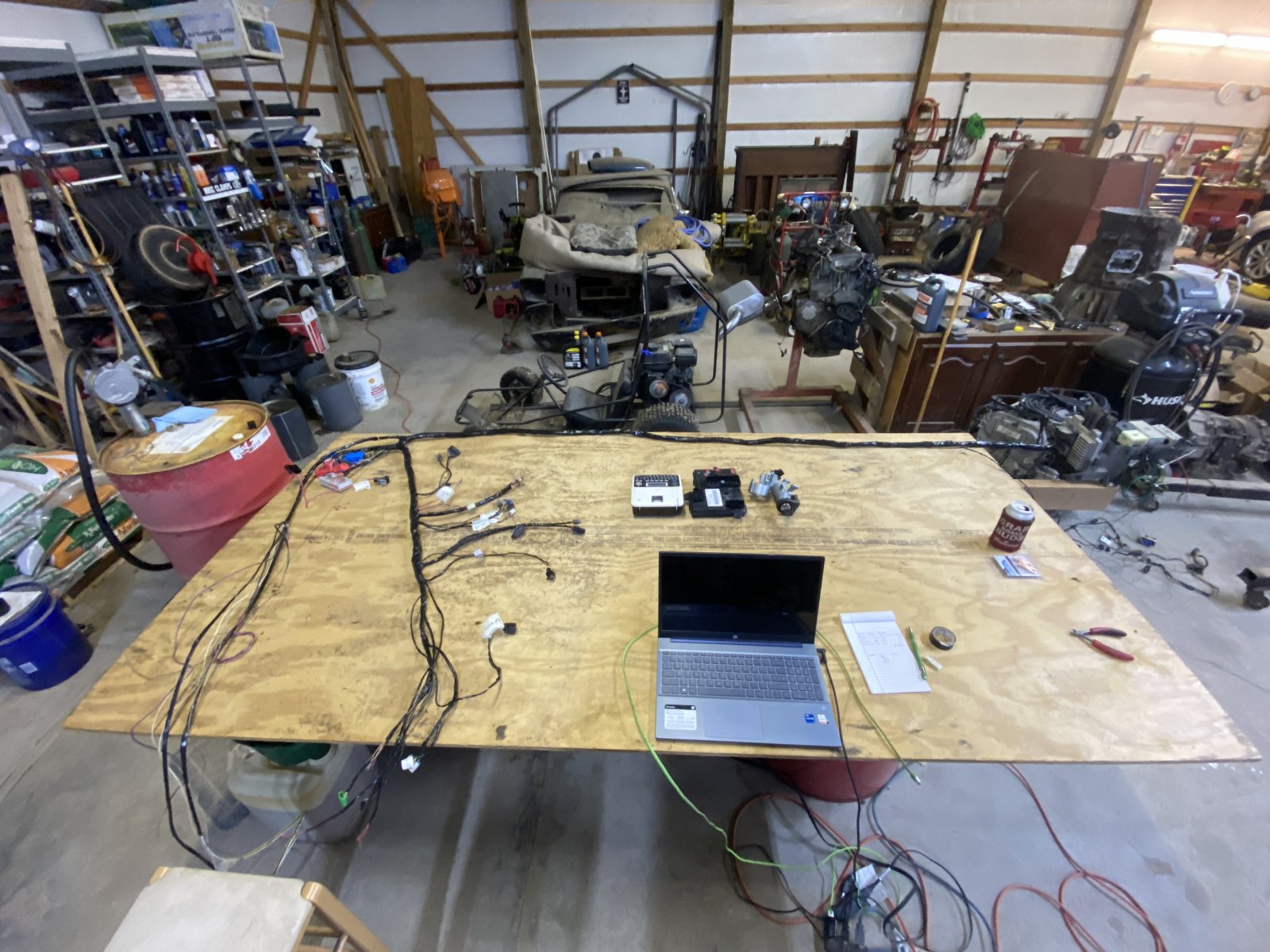

Hopefully this is the last of the wiring harness questions. What did I miss on the battery current sensor? I still have it but was it supposed to be removed?
Markm
I’m going to tape the battery current sensor wires out with the headlight wiring then route it and shorten it up when I get it in the car
Markm
Looks like my harness is ready for the wife’s Goblin minus where I ran short of tape on the headlight wiring

In my many years at Chevrolet they rarely have optional equipment wired, sometimes yes but most times no
Did I mention I have/sell those red + post covers?, I collected them at the junk yards.
My research so far is in 05-07. On these Cobalts, I think that depends upon which sub-system wiring harness you are looking at. The front light harnesses usually did not have the fog light wires, but the body harness(I believe and will recheck mine) did as part of the headlight wiring. (I'll have to dig deeper on this point as I would like to know for sure if ANY of the wiring harness are universal to all Cobalts.) I have a couple of fuse panels along, I think they all have a fog light fuse position, will need to see if all are wired for fog.
All body harness and dash harnesses I have worked on, the connector for both neutral safety start switches(Manual on the clutch pedal and auto on the shifter) the unused plug is in the harnesses, but taped out of the way.
Engine harnesses are manual or auto or SS/SC. SS/SC use a different ECM plug on the body harness. Sadly the steering/brake panel bolted into the body is auto or manual with the hole for the master and clutch pedal bolts.
Side Story: The transmission wiring can be cut out of the Automatic engine harness with little trouble, the Speed sensor is shortened and needs a new plug end(a copy is in the headlight harness, IIRC "temp probe" Maybe?) and some other changes, but the Auto transmission portion of the engine harness almost could have been a separate sub-harness.(Built together for quick factory assembly and slow, aggravating service.)

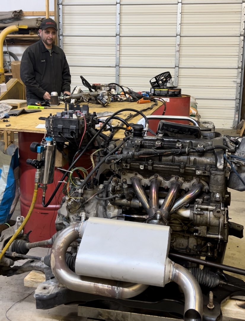

Tomorrow I’ll get the couple gaskets I need to reassemble the engine but I did set everything up for test firing minus the jumper cable I’ll need for the engine ground

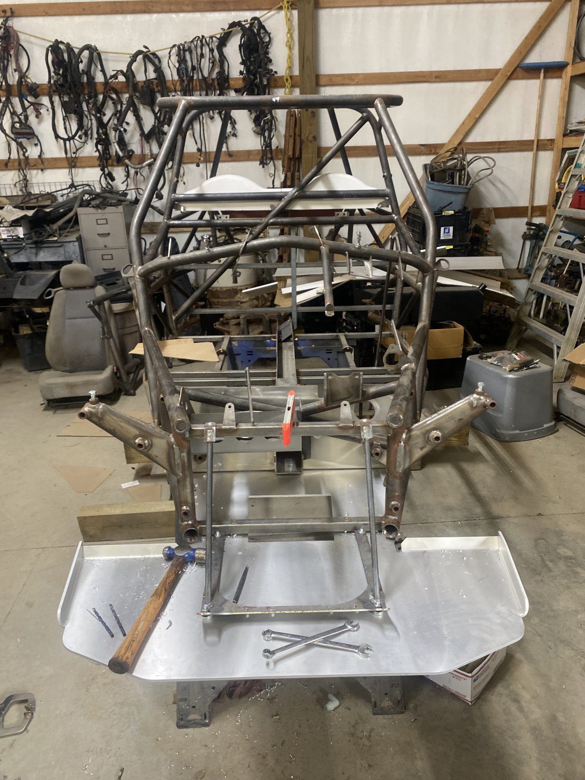

Markm

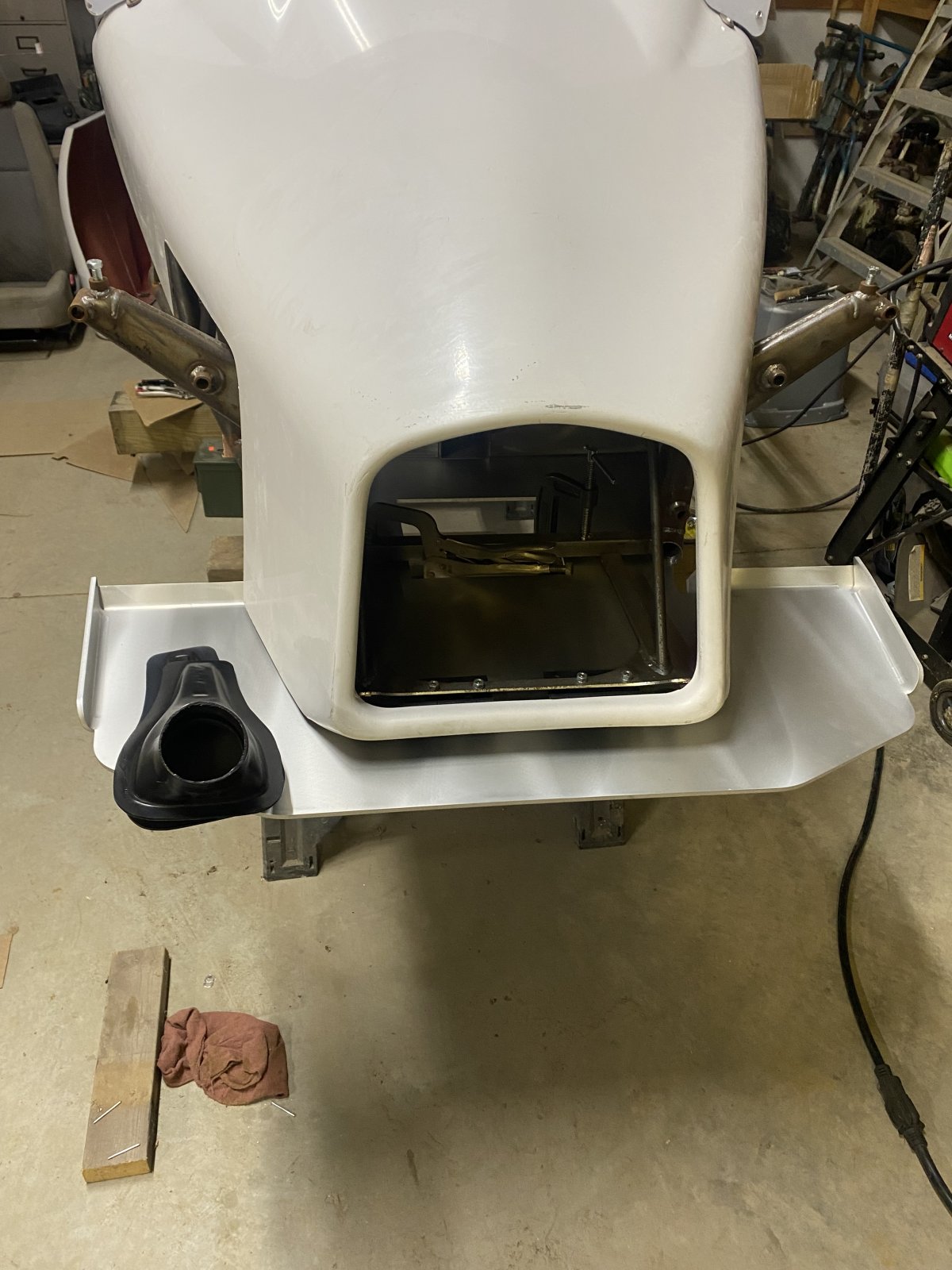

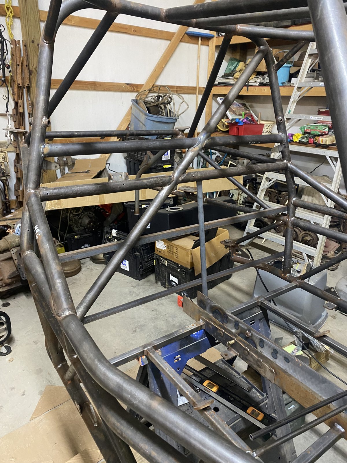

Been a while since an update. I got the front splitter mounted and finished the minor mods to the chassis and are ready for powder coat. The wife decided she wants it in Illusion Royal
