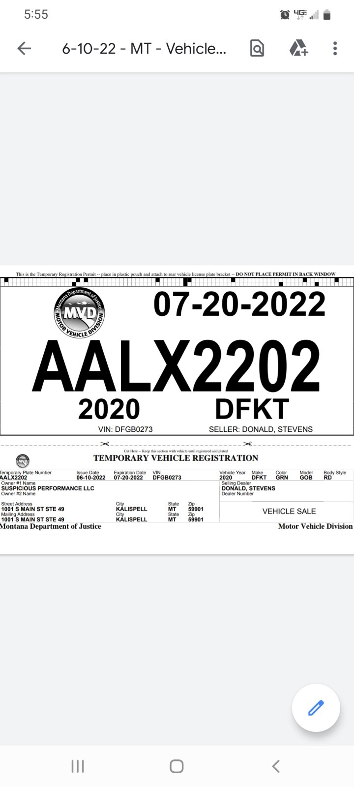

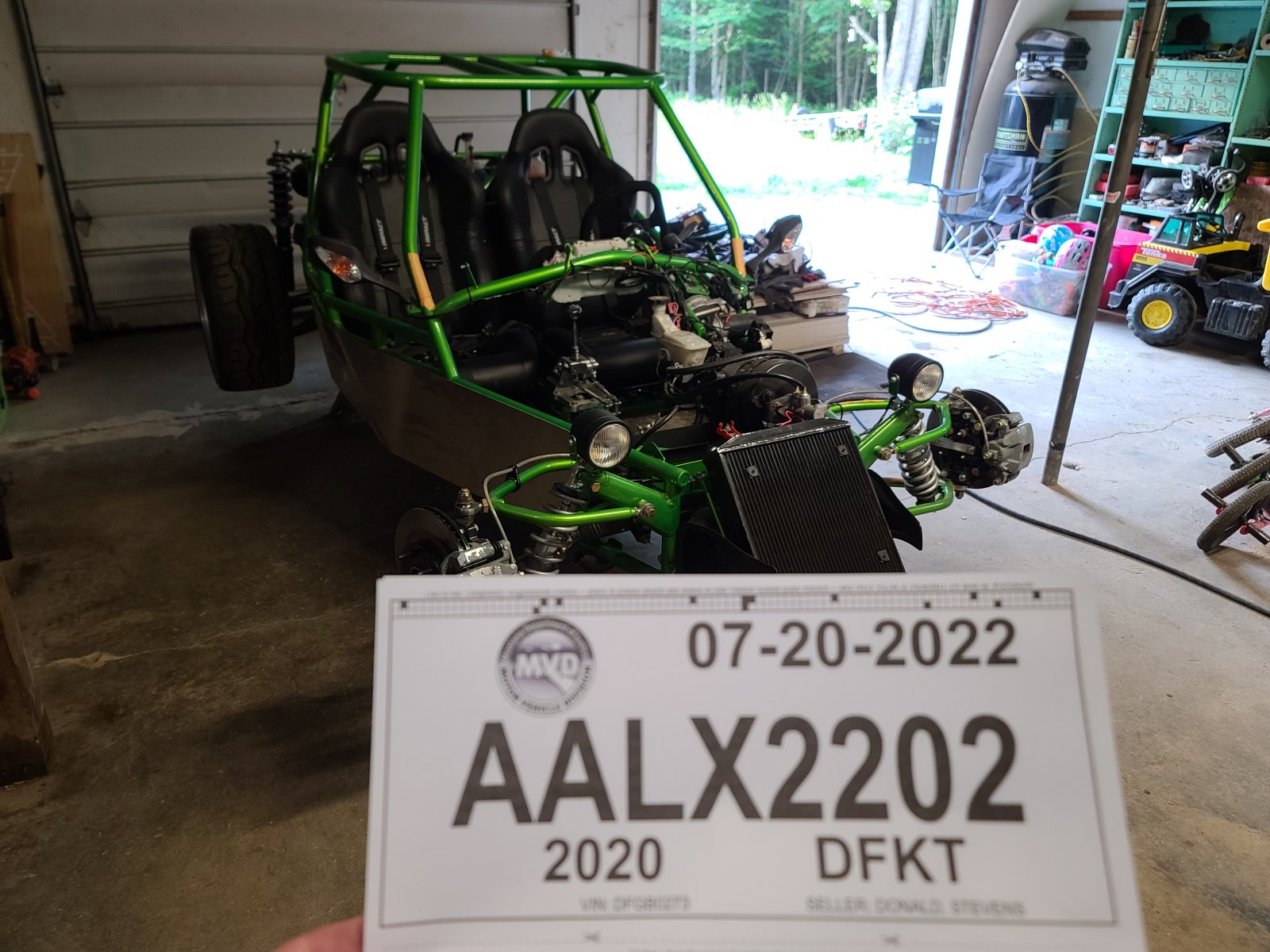

Just changed status to registered.

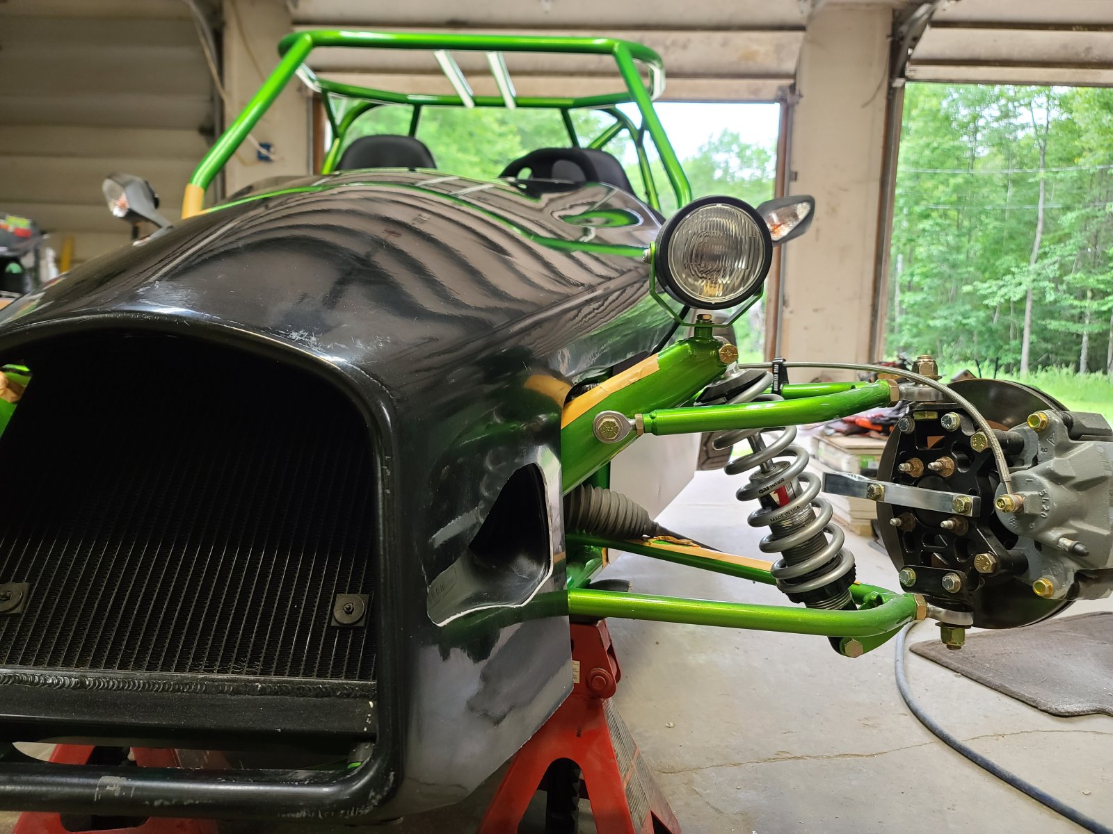

TheDon

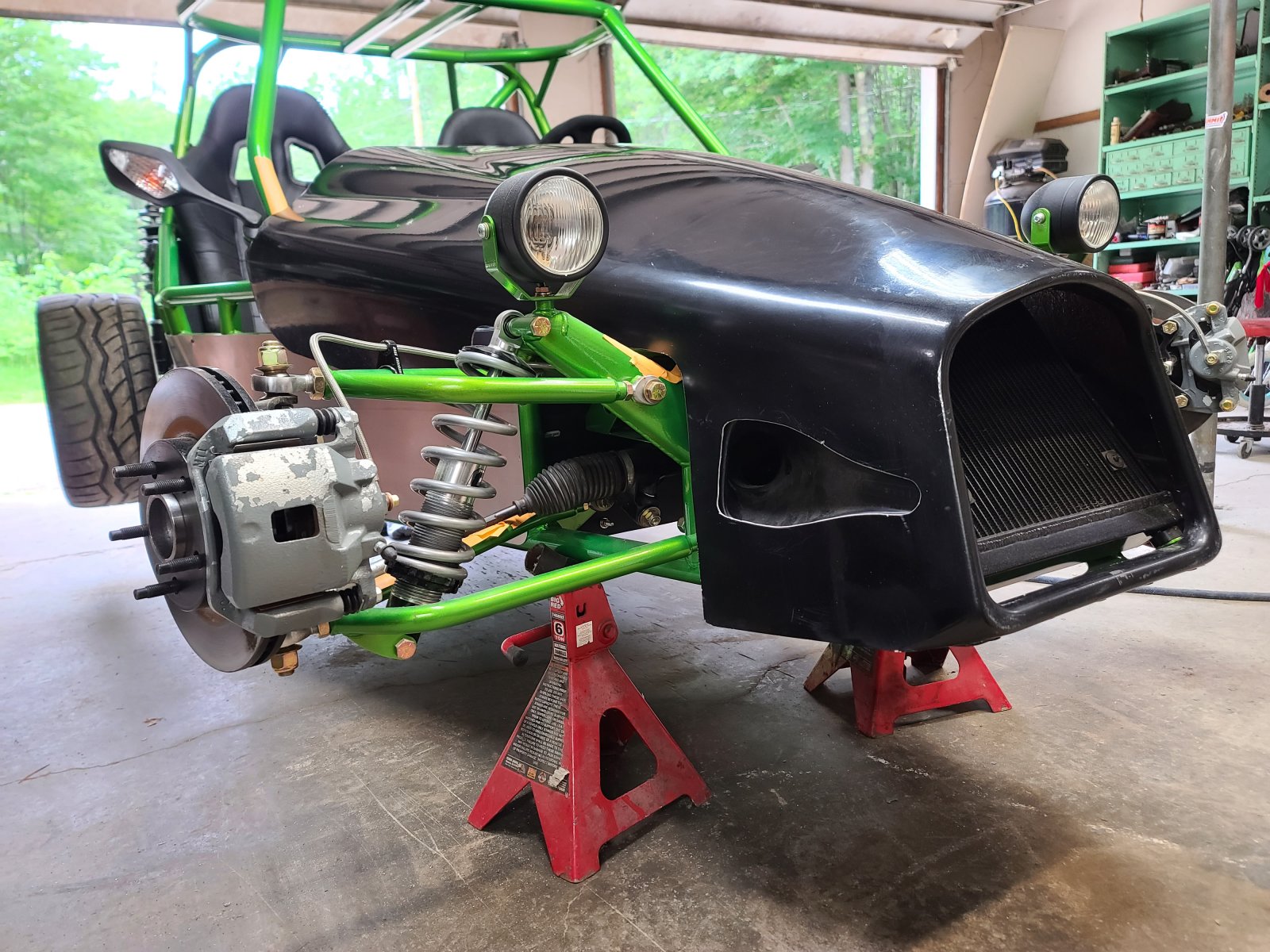

Was going to install steering limiters but think ill put it back together until they show up.

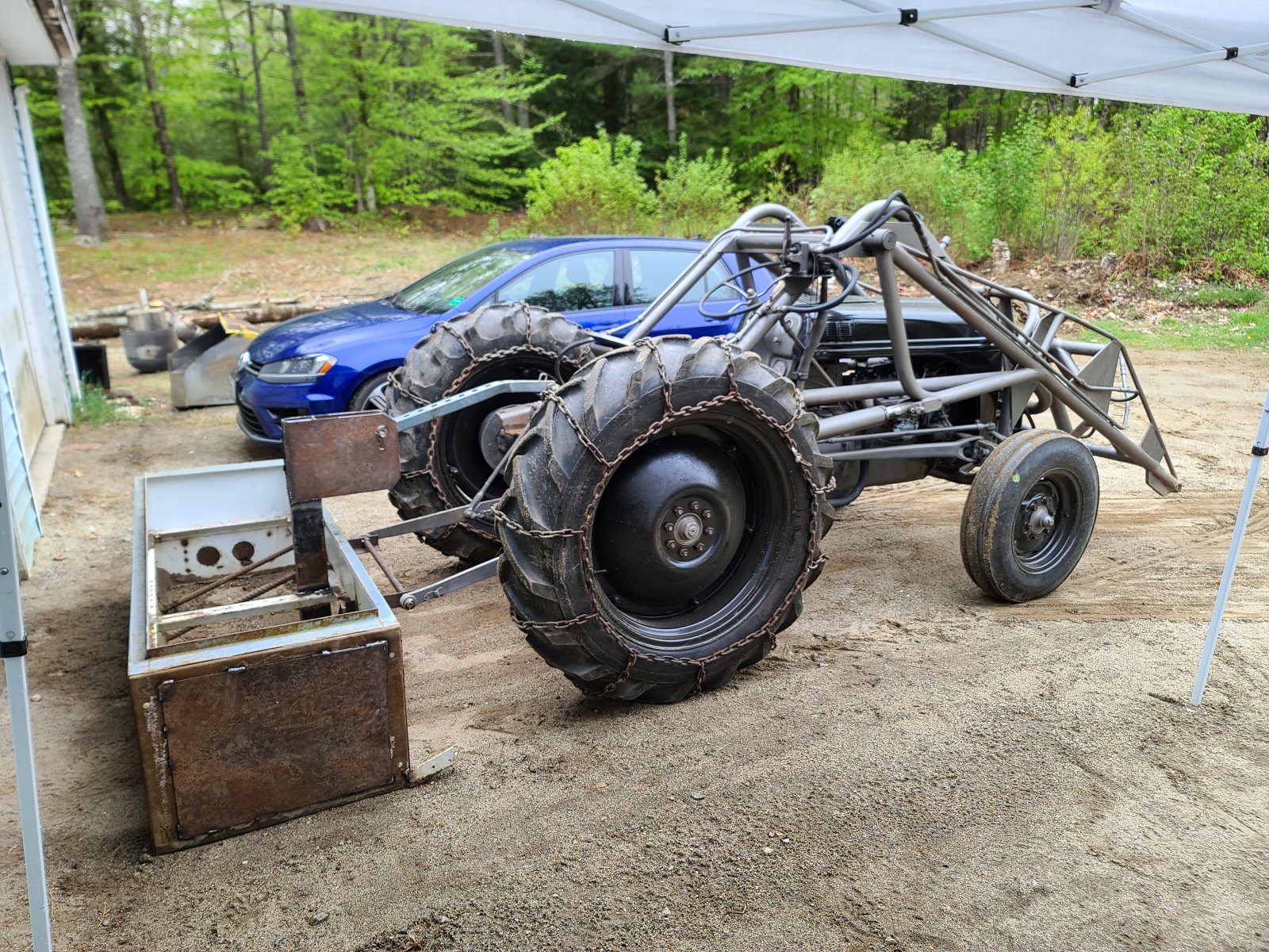

TheDon
All my neighbors want rides, I live on a dirt dead end road and had to weld up a custom box grader for my old tractor so the goblin can make it to the pavement. They all came out thanking me for fixing the road, but it was for the goblin

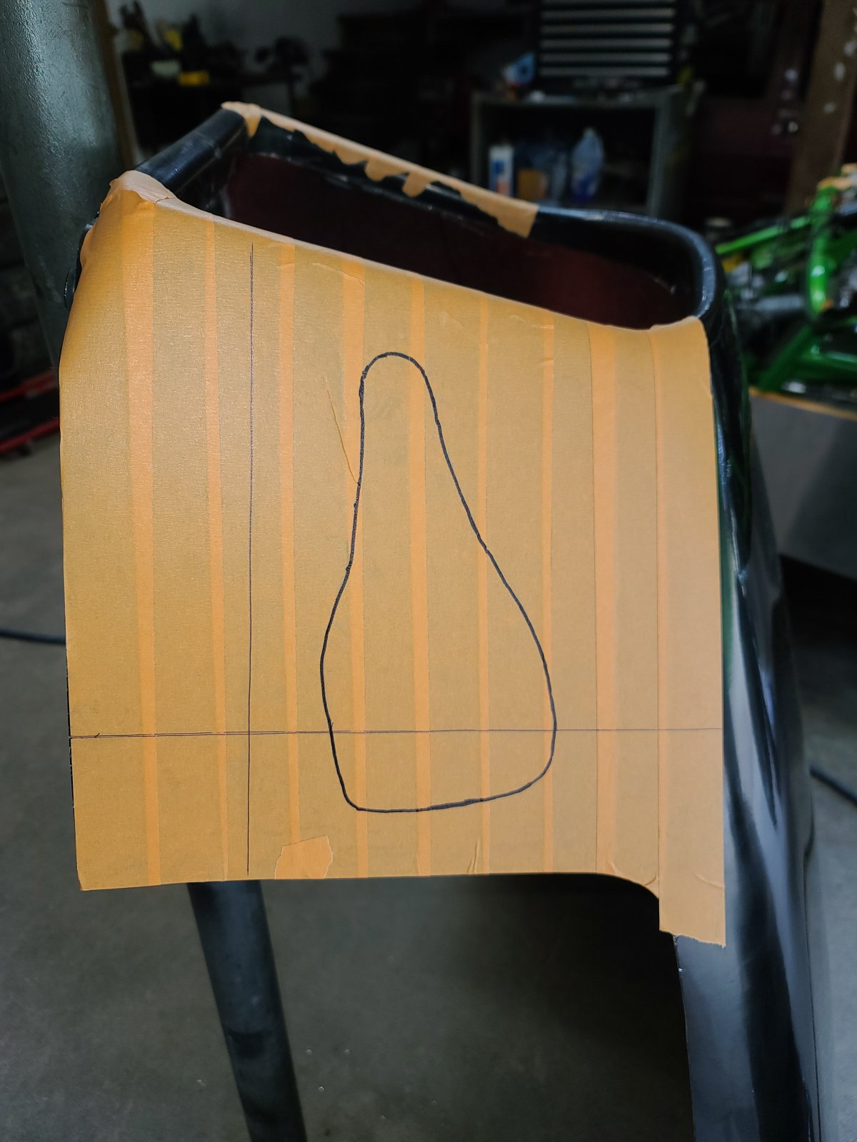

Been searching the forum for info on putting my naca ducts on inside of hood. Seems like putting hood on and off will be a 2 person job while jacked up after adding ducts? Weighing my options putting on the outside should be pretty straightforward but thinking inside would look cleaner

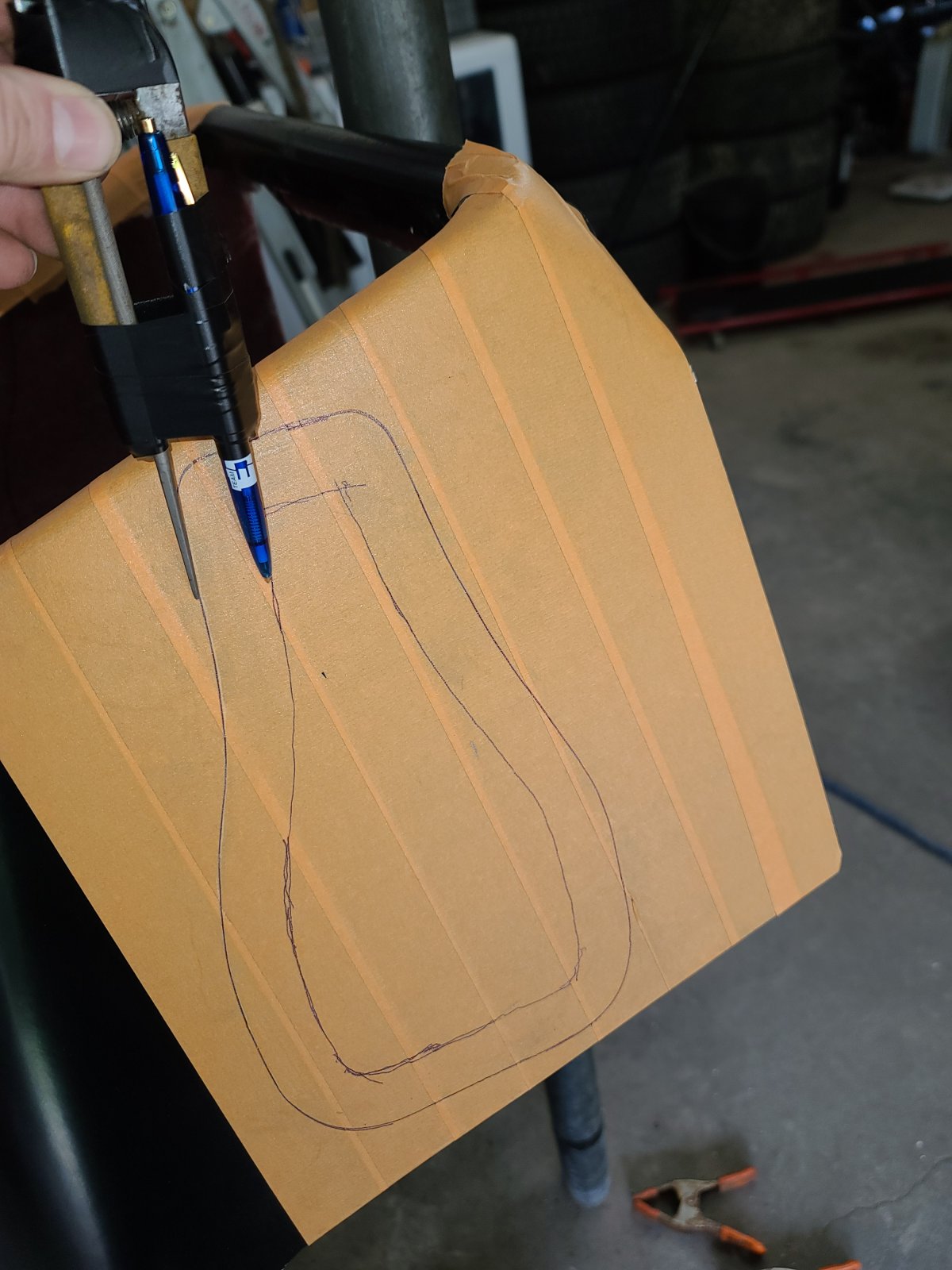

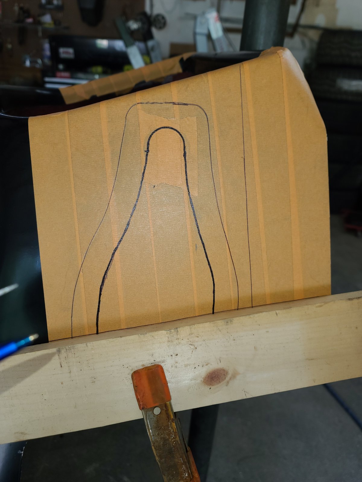

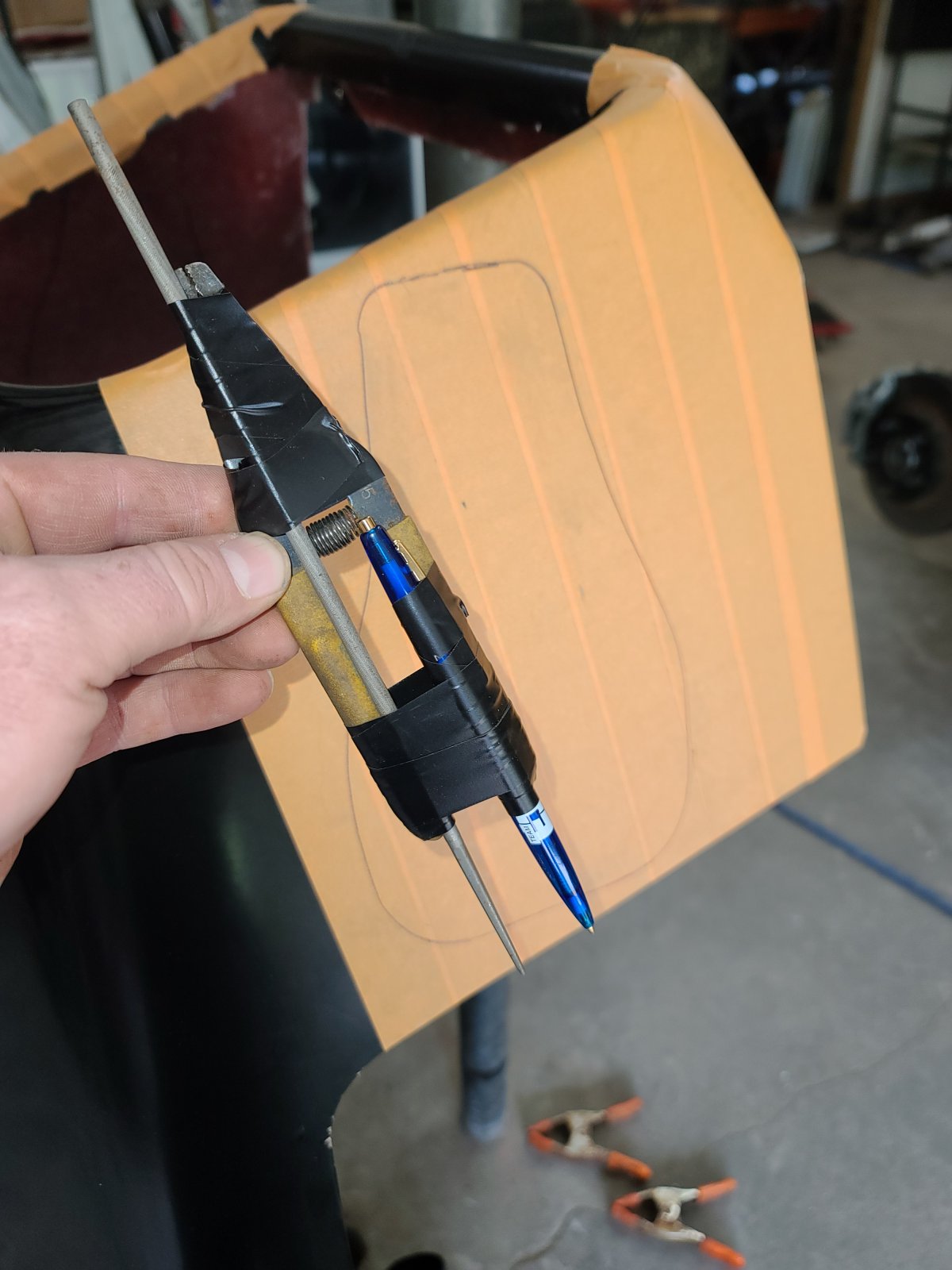

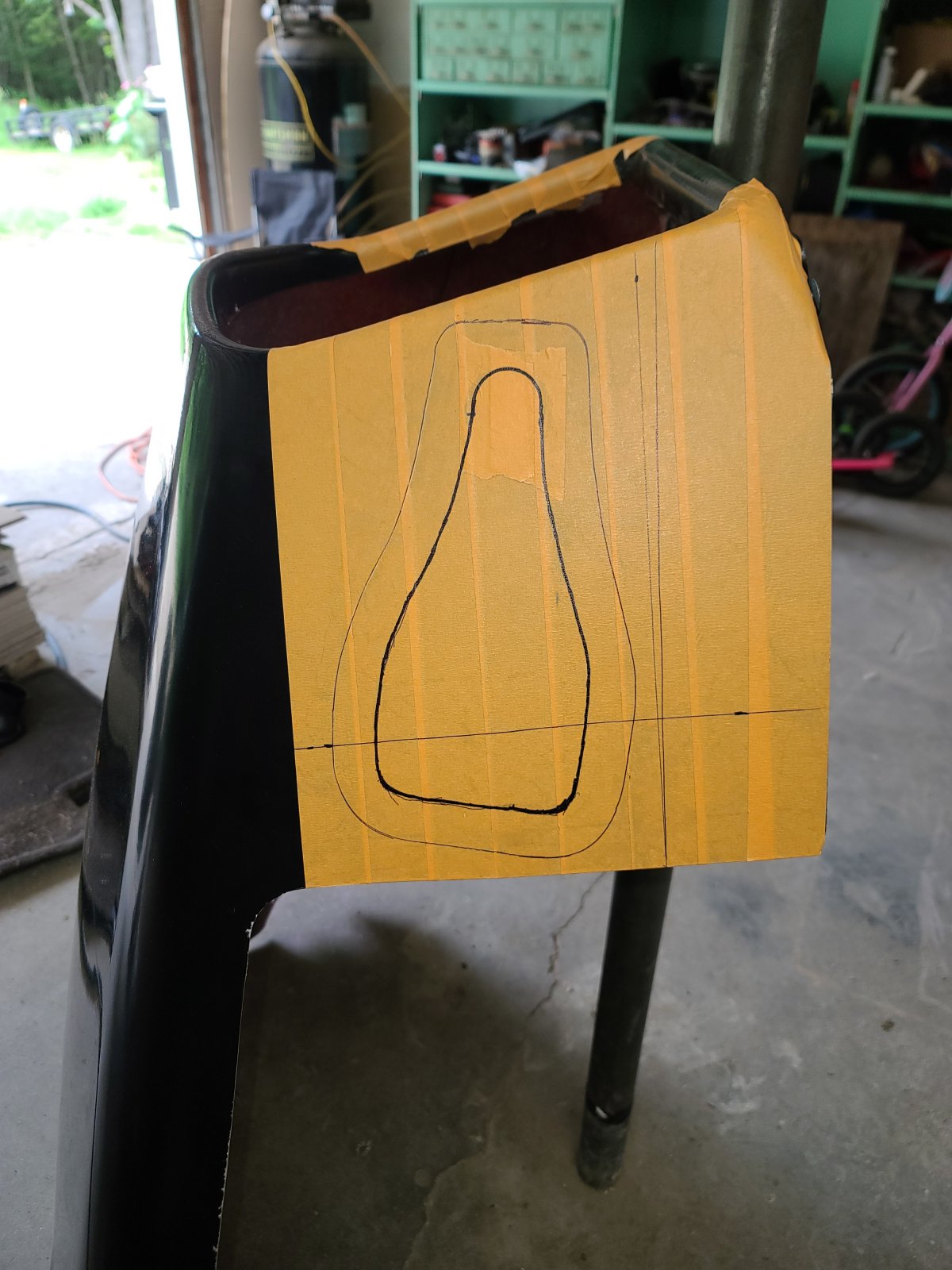

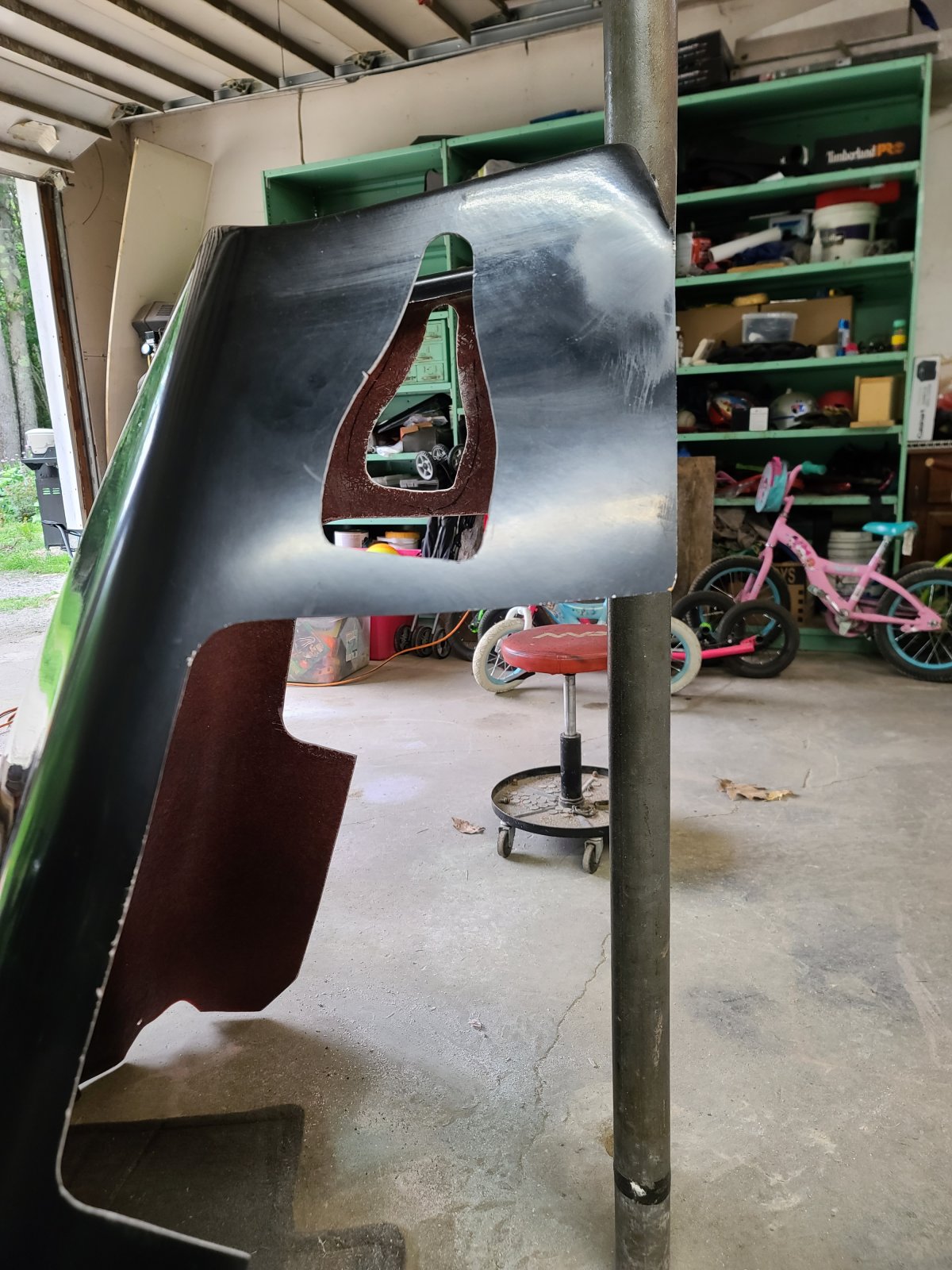

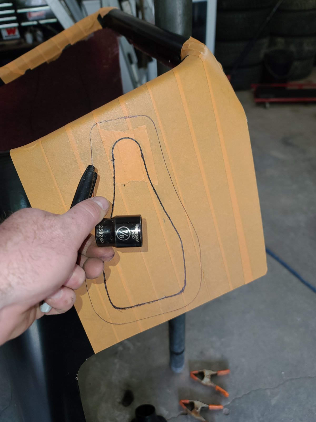

TheDon
Cut it for vents on inside.

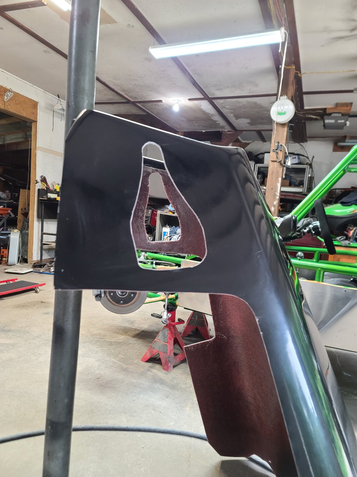

TheDon
Going to still use rivets to hold vents in place

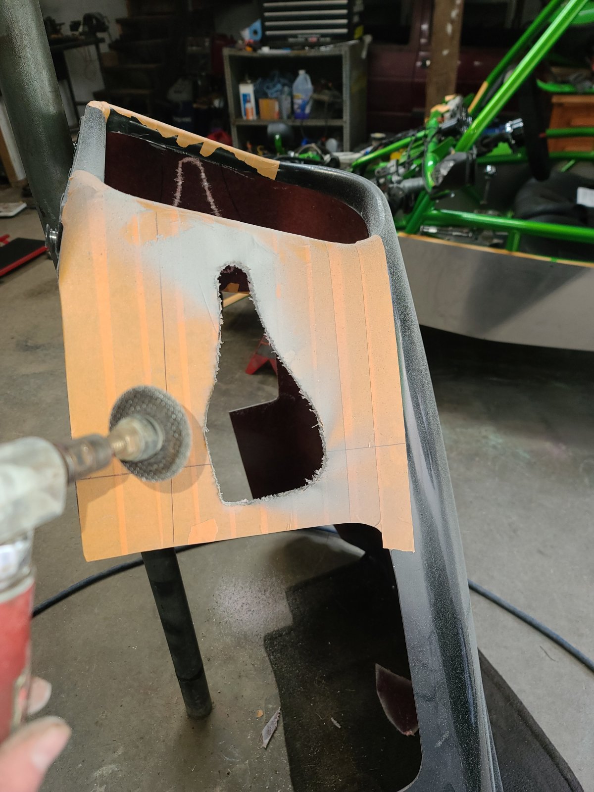

TheDon
Started with drill bit on dremel but didn't work ended up drilling a bunch of holes and playing connect the dots with a small cut off wheel then filled and sanded. Put 4 rivets in each going to see how easy it is to put hood on and off and will sandwiche some screens between duct and hood before riveting next time
