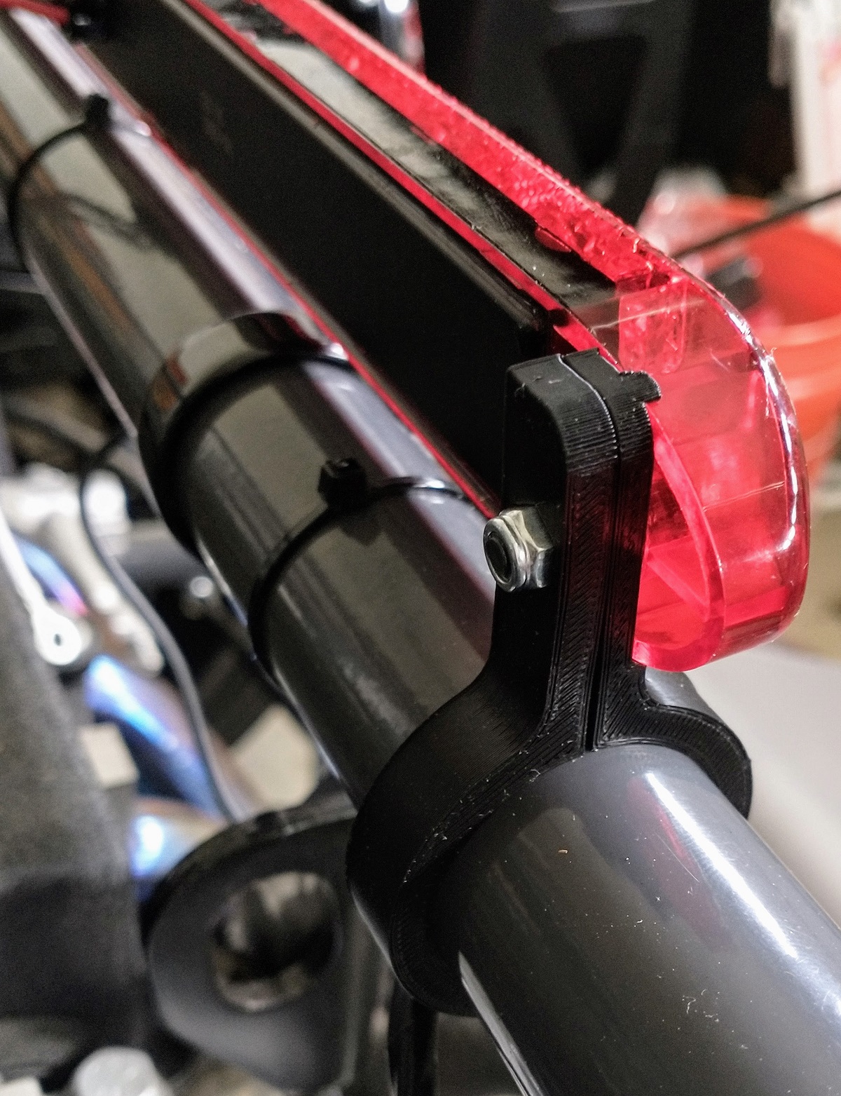

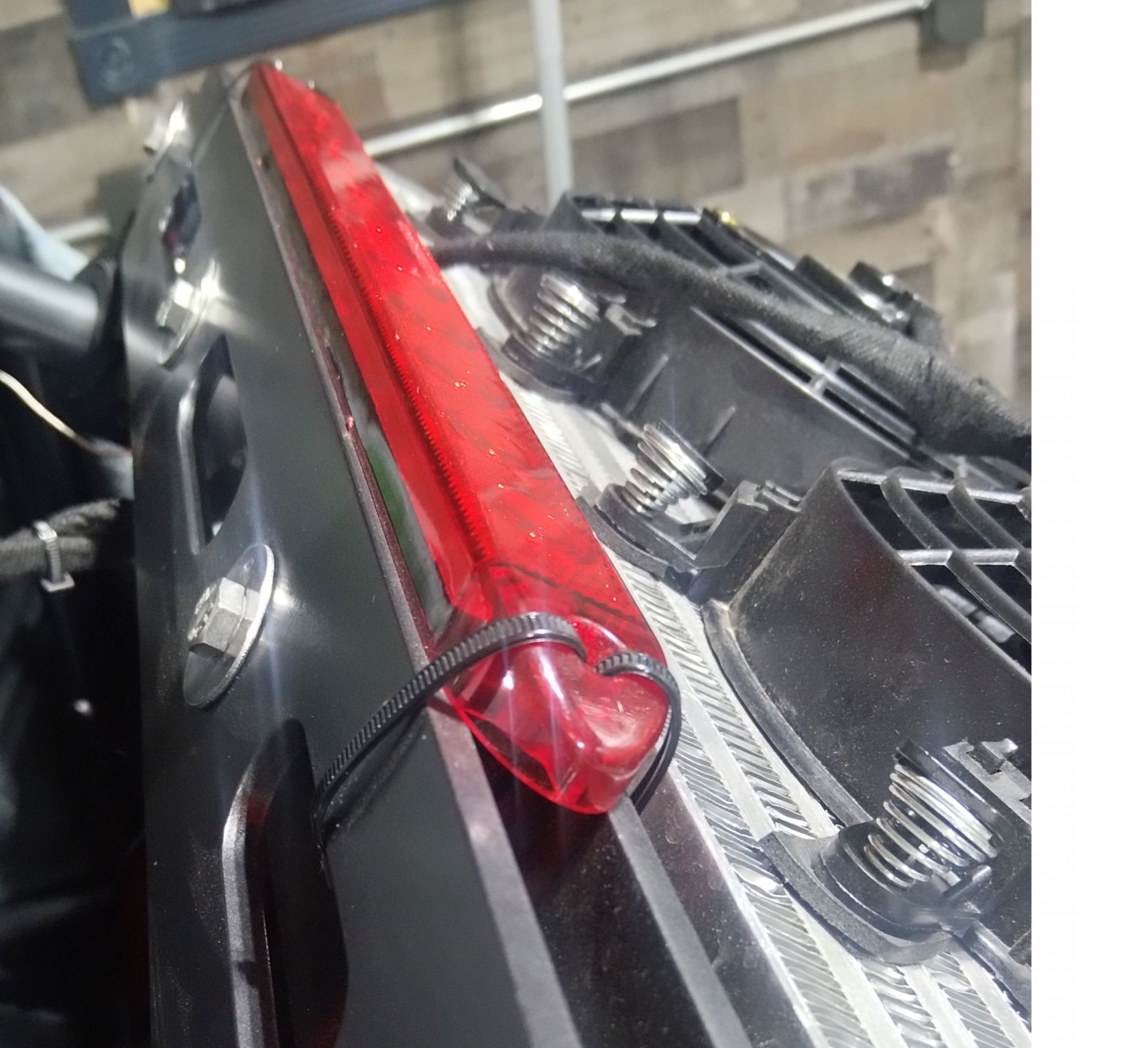

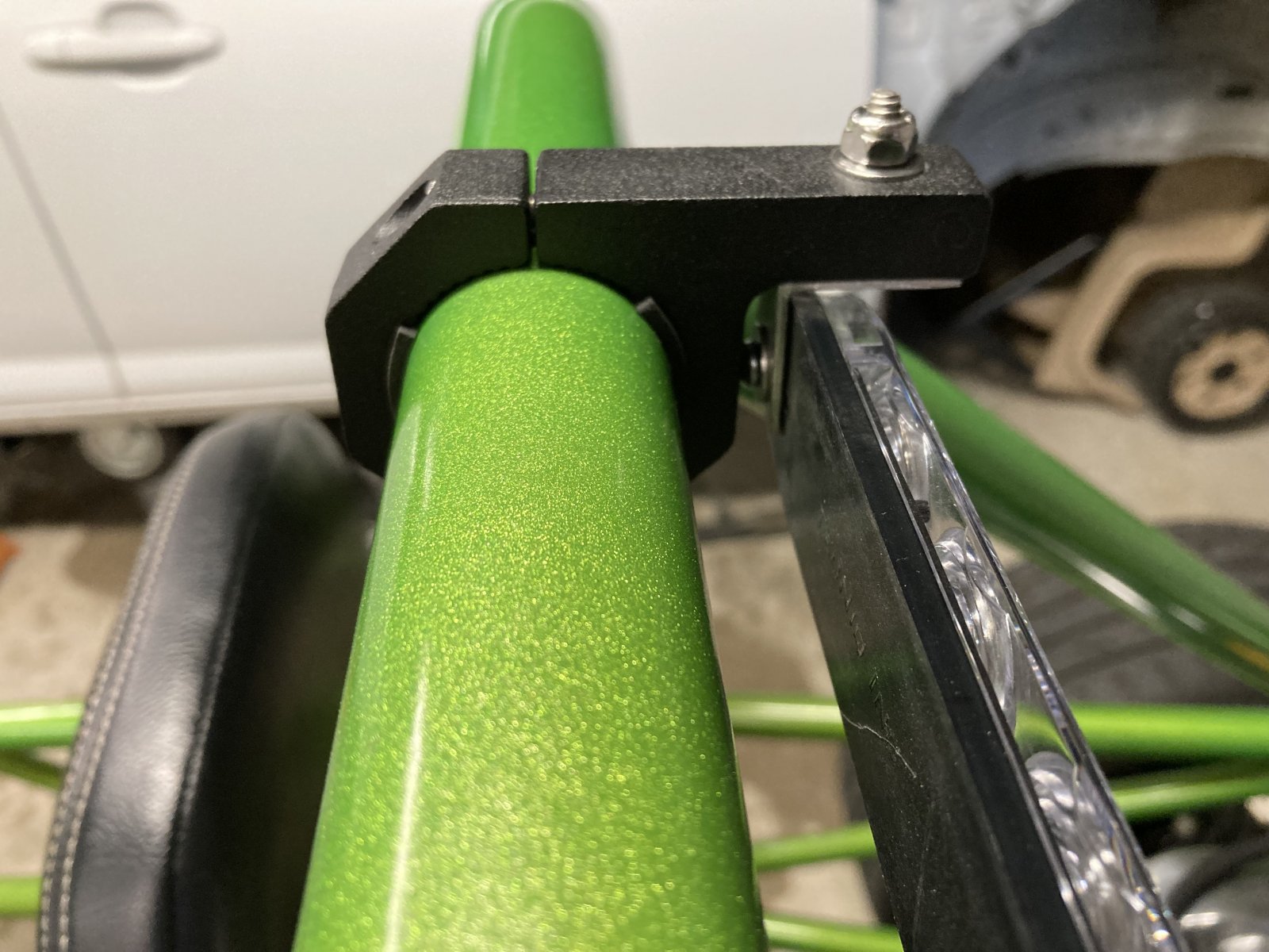

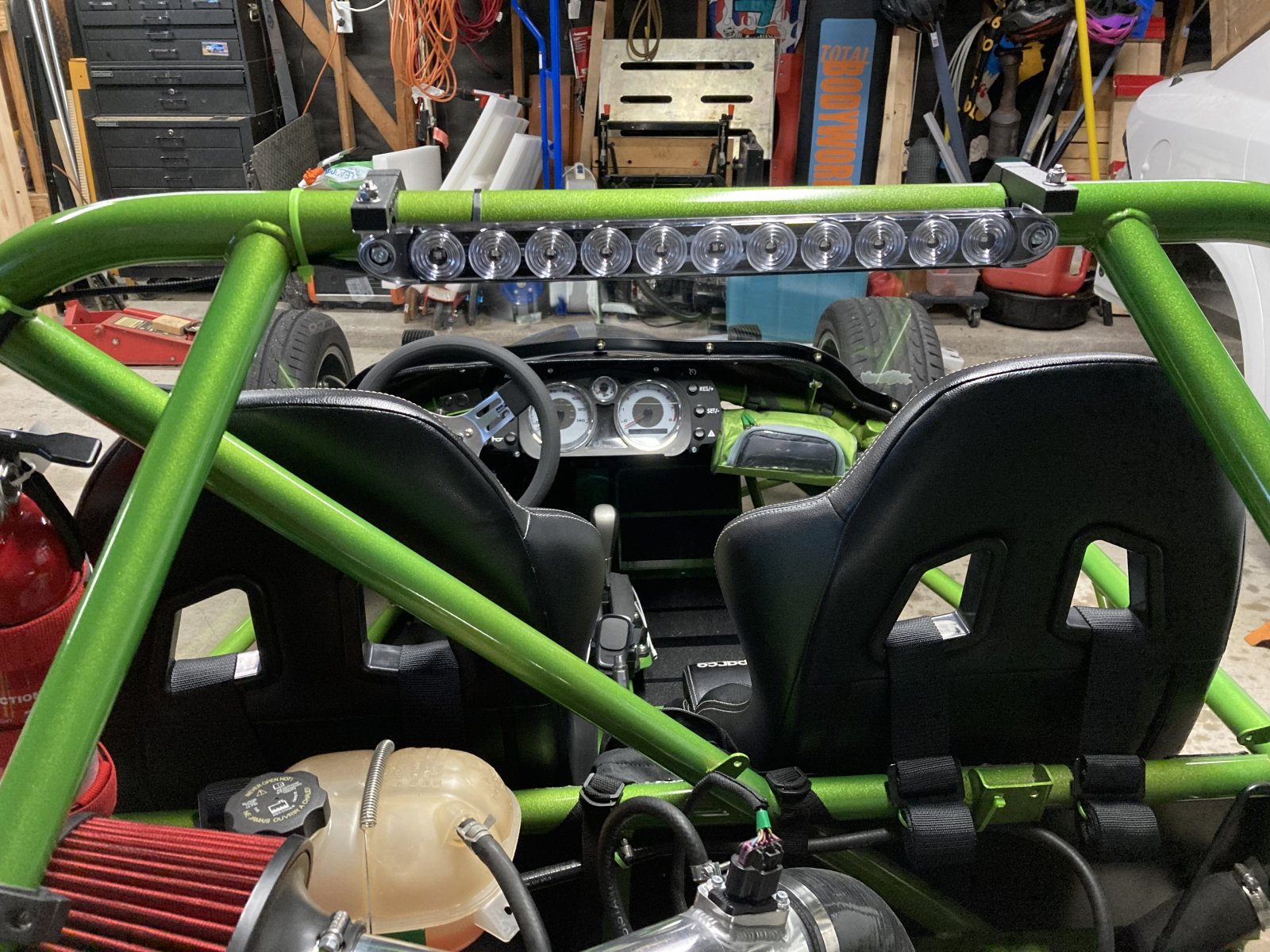

An amazon generic light (clear or red) and some 1.5" clamps. Put a little 3/4" aluminum angle to inset the light to be in line with the tubing. Brett has a ever so slightly cleaner look with his:

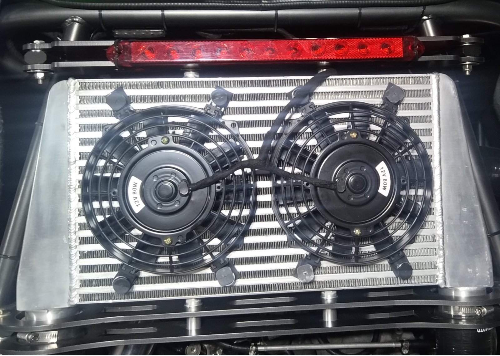

I used one of these. Drilled two holes on the rear lip of the engine cover and epoxied two pieces of steel inside the lip to add some reinforcement for the fasteners.
