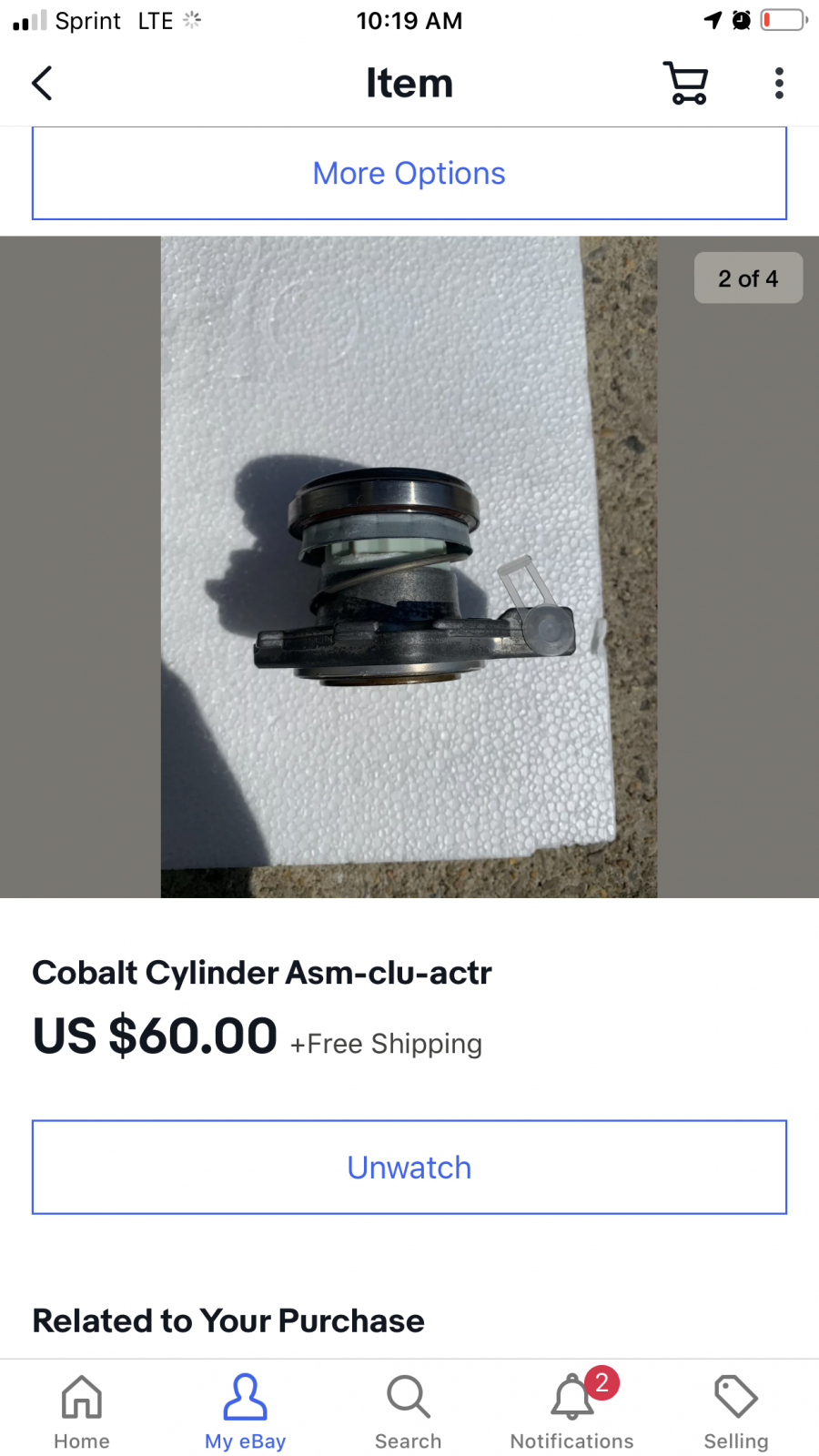

I just got one new OEM 2017 stock for turbo $64 on ebay 24242805
The LSJ apparently bleeds off pressure so the LN4 model is what you should be using 2424805
