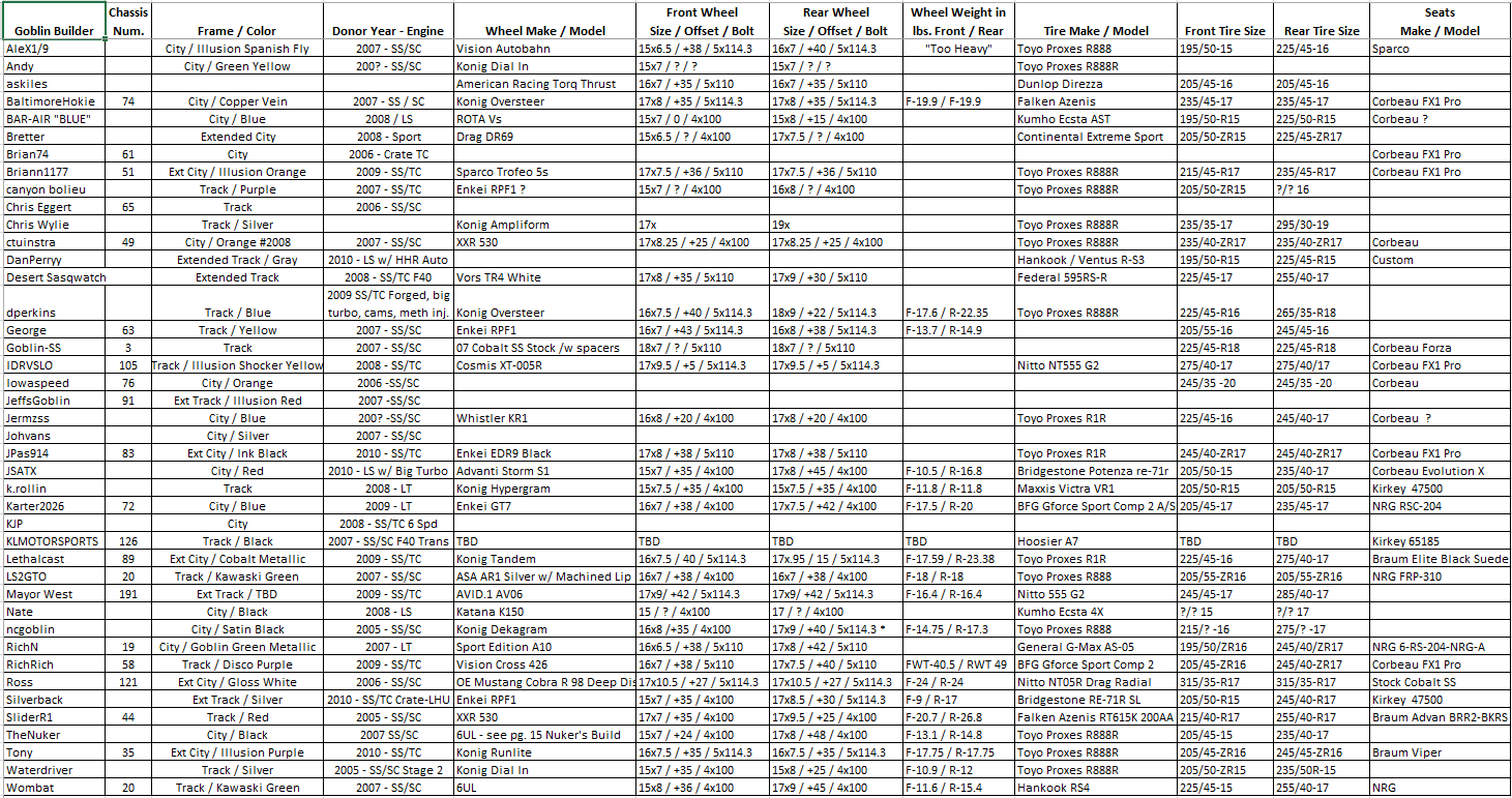

Updated list (3/25/2020) of chassis number, frame/color, donor year/engine, installed wheels, wheel weight, tires and seats on everyone's Goblins. I need help filling in the blanks. Please send me the following info and I'll add it to the list (or send corrections if needed):
Goblin Builder:
Chassis Number:
Frame Type / Color:
Donor Year / Engine:
Wheel Make / Model:
Front Wheel - Size / Offset / Bolt Pattern:
Rear Wheel - Size / Offset / Bolt Pattern:
Wheel Weight in lbs.:
Tire Make / Model:
Front Tire Size:
Rear Tire Size:
Seat Make / Model:
Click on list to make full screen and easier to read.

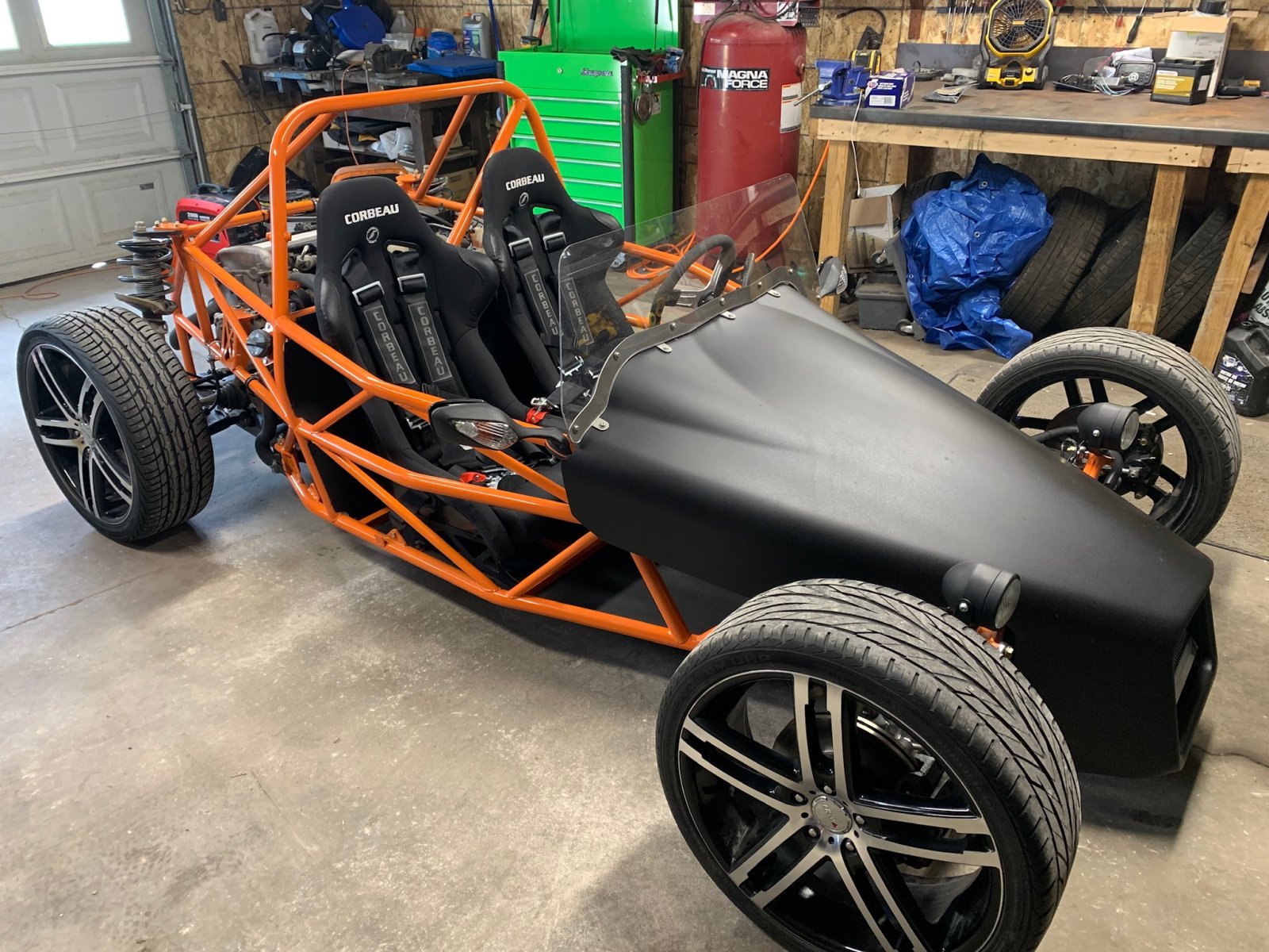

BaltimoreHokie
Goblin Builder: Manny
Chassis Number: 74
Frame Type / Color: City, Copper Vein
Donor Year / Engine: 2007, SS/SC 2.0
Wheel Make / Model: Konig Oversteer
Front Wheel - Size / Offset / Bolt Pattern: 17x8/+35/5x114.3
Rear Wheel - Size / Offset / Bolt Pattern: 17x8/+35/5x114.3
Wheel Weight in lbs.:19.9
Tire Make / Model: Falken Azenis
Front Tire Size: 235/45/17
Rear Tire Size: 235/45/17
Seat Make / Model: Corbeau, FX1 Pro
Build Thread: http://dfkitcar.com/forum/index.php?threads/mannys-city-goblin-07-ss-sc-donor.559/

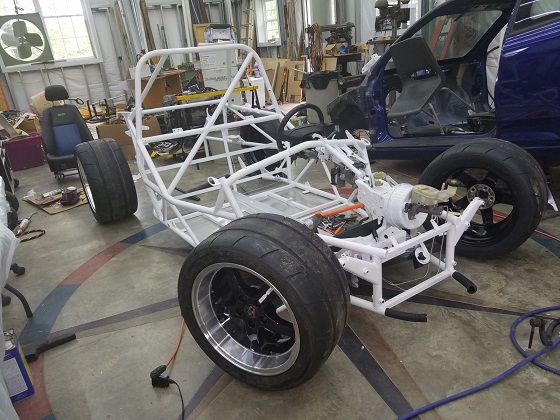

Goblin Builder: Ross
Chassis Number: 121
Frame Type / Color: Easy Entry Extended City / Rustoleum Gloss White
Donor Year / Engine: 2006 SS / 2.0 Supercharged
Wheel Make / Model: OE Wheels Mustang Cobra R 98 Deep Dish Wheel
Front Wheel - Size / Offset / Bolt Pattern: Size: 17" x 10.5" / Offset: +27mm / 5x114.3
Rear Wheel - Size / Offset / Bolt Pattern: Same as front. Spacer were used both front and rear.
Wheel Weight in lbs.: 24
Tire Make / Model: Nitto NT05R Drag Radial Tire
Front Tire Size: 315/35R17
Rear Tire Size: Same as front
Seat Make / Model: Cobalt SS Seats
9505
JeffsGoblin
Just curious, are drag radials legal in most states or not? I would suspect no, but they do have a little bit of tread on them. From my wheels and tires list, you got the widest so far. Its gonna look sick!
Those Nittos are DOT compliant, so yes, they are street legal.
The tires do wear quickly, have poor wet traction, and aren't quiet running. Not that I am looking for wet driving conditions.

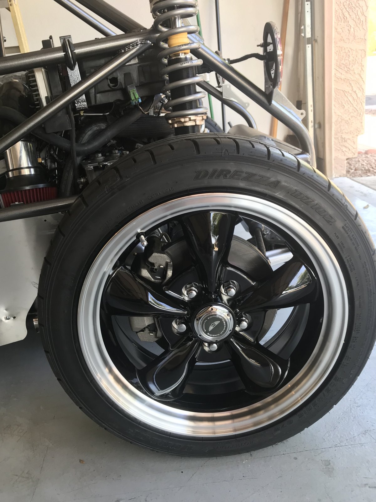

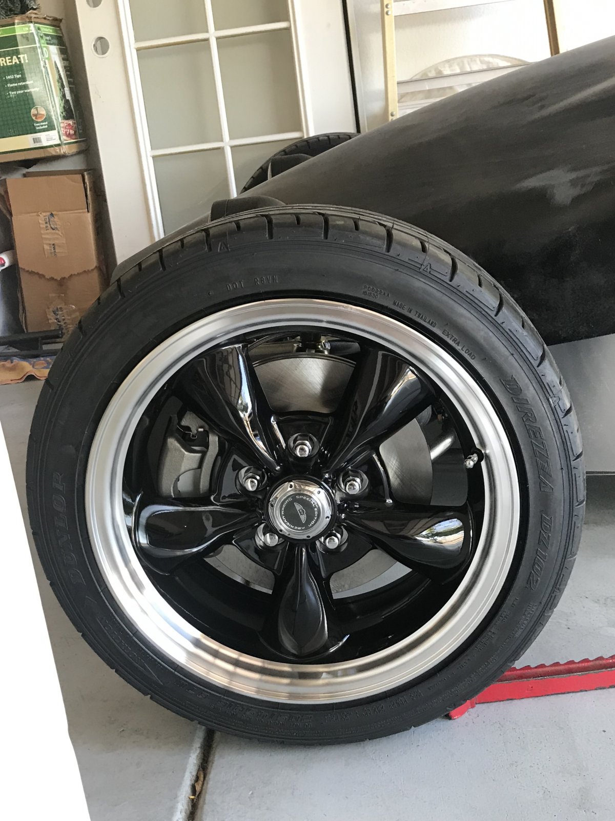

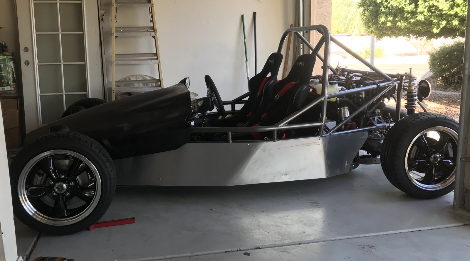

askiles
Wheels - American Racing - Torq Thrust - 16” x 7” - 35mm Offset - 5x110
Tires - Dunlop Direzza DZ102 - 205/45-16
