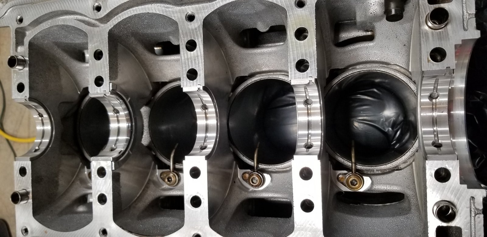

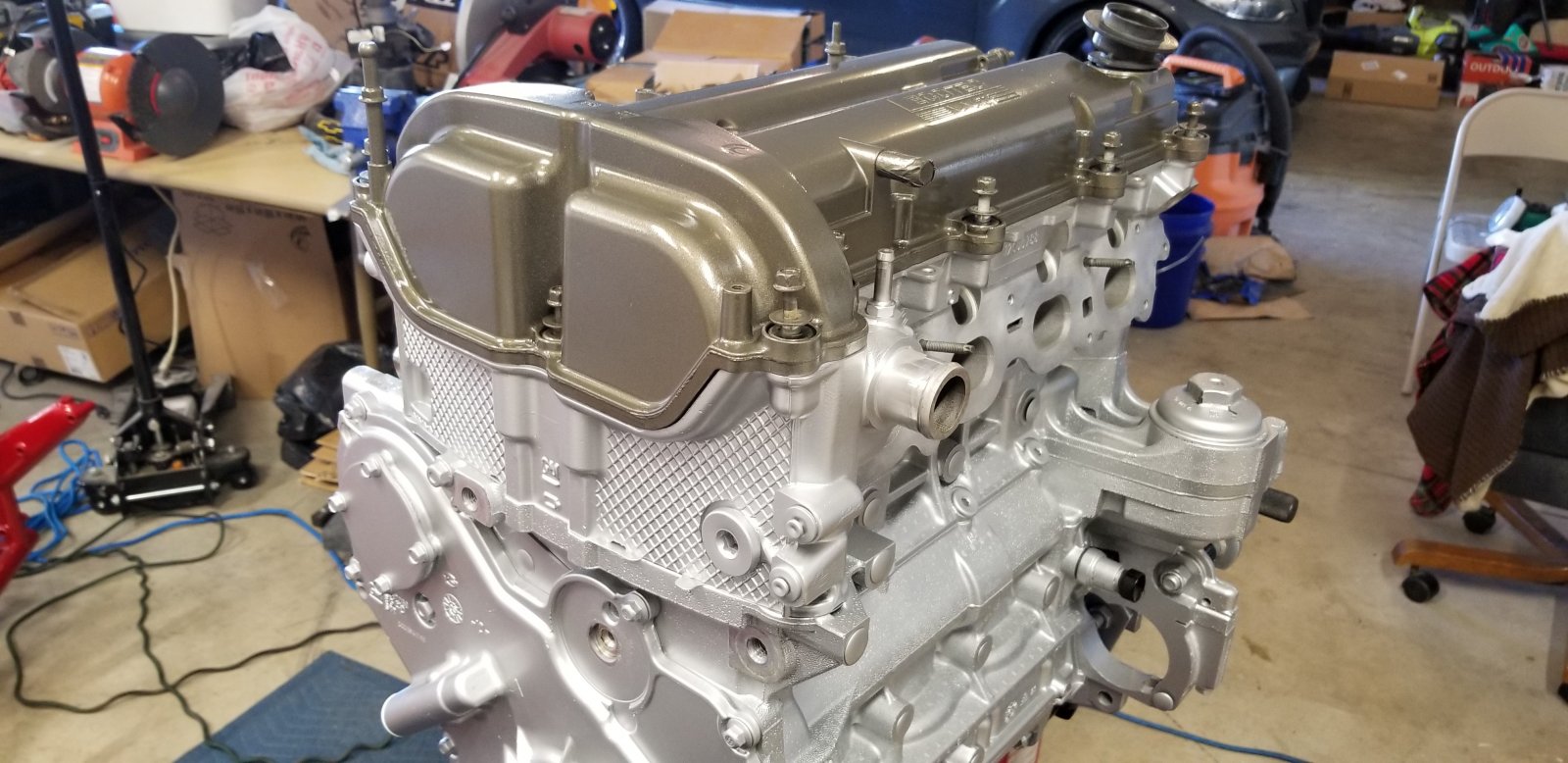

Todd, Brenden, welcome to the forum. You sneaked in under the radar, but not for long. Will you be starting a build log? Have to assume you have been reading in the forum to know all the recommended stuff.
Todd M
Thanks guys. Not really a avid poster, more of a reader :). I have been reading in the forums since before we decided to start the order/build.
I think we will put together a build log, probably as we get a little closer to the end. My son has even done video of some of it for timelapses.
In the meantime, here are some pics...
nice job on the engine cleaning!

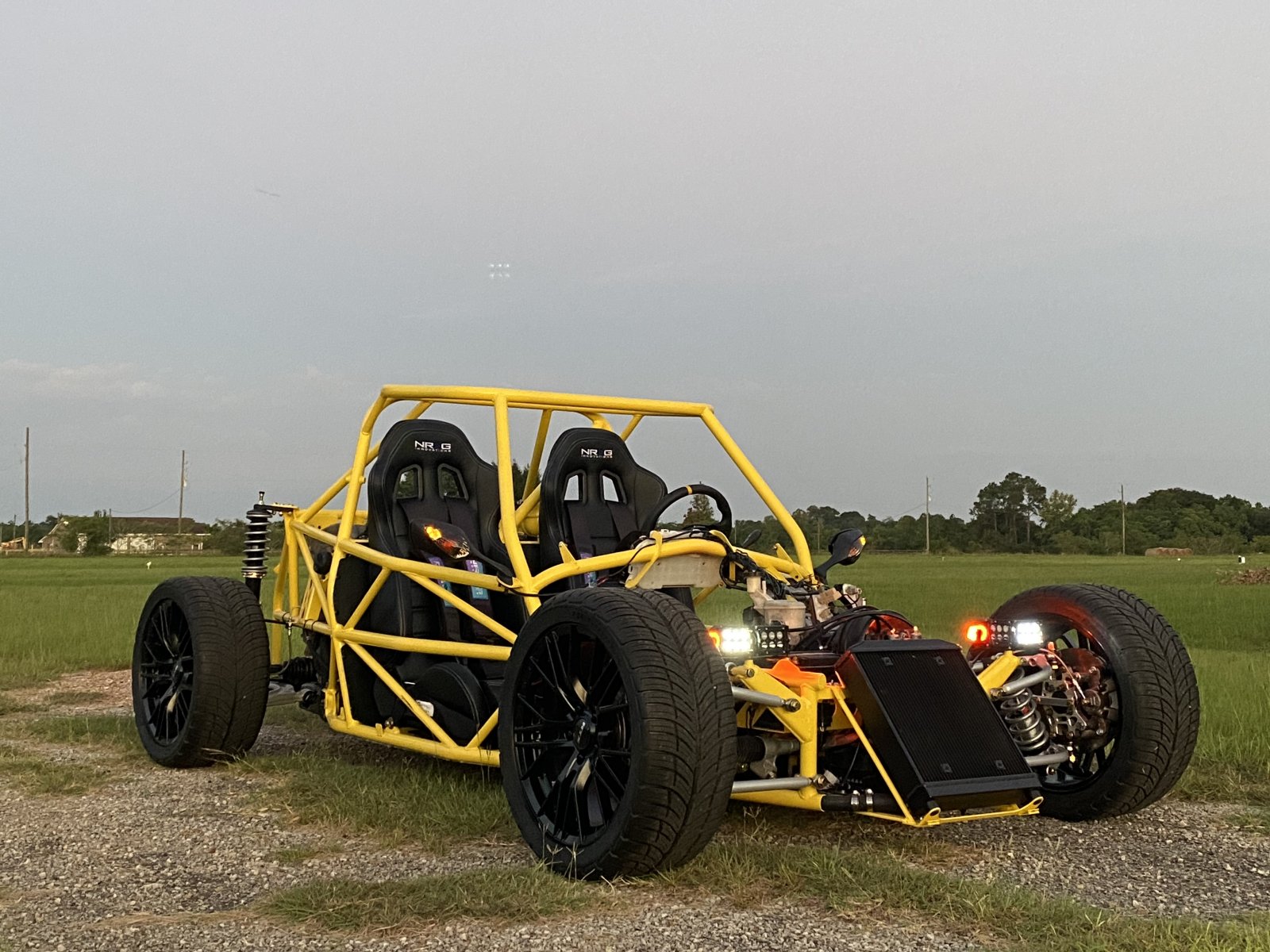

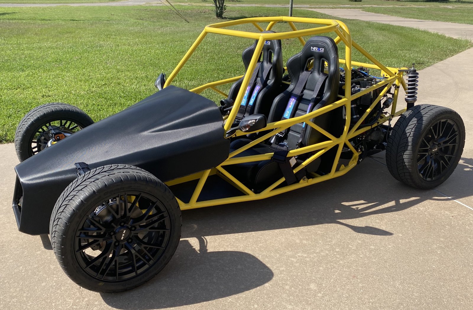

Goblin Builder: Russell
Chassis Number: 184
Frame Type / Color: track/safety yellow
Donor Year / Engine: ‘06 2.0L supercharged
Wheel Make / Model: Vertex RTX satin black
Front Wheel - Size / Offset / Bolt Pattern: 17x7.5 5-110
Rear Wheel - Size / Offset / Bolt Pattern: 17x7.5 5-110
Wheel Weight in lbs.:
Tire Make / Model: Toyo R888R
Front Tire Size: 245/40ZR17
Rear Tire Size: 245/40ZR17
Seat Make / Model: NRG RSC-208 W/cobalt mounts
Chassis Number: 184

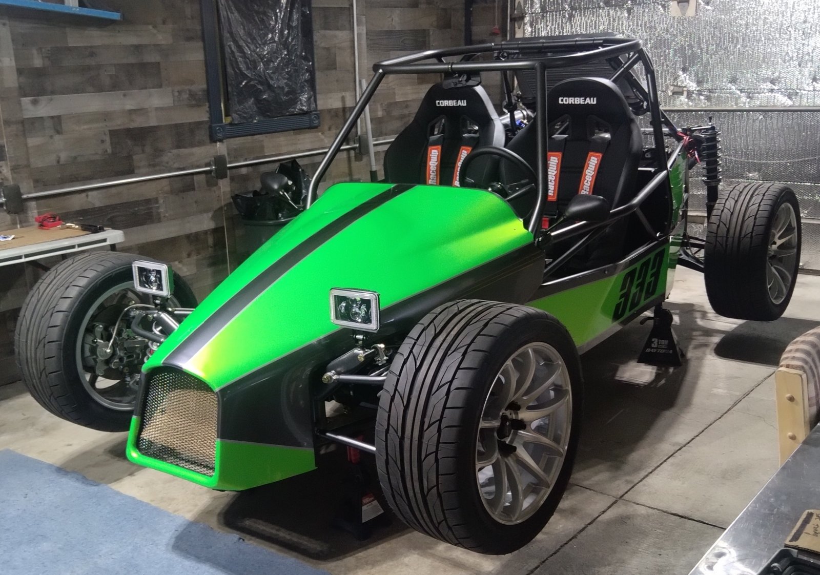

ColoradoCryptoTrader
Goblin Builder: Adam T - coloradocryptotrader
Chassis Number: 333
Frame Type / Color: full cage full door bars extended / Prismatic Evo Grey PMB-5969
Donor Year / Engine: 2008 LNF
Wheel Make / Model: Vors TR4 machined silver
Front Wheel - Size / Offset / Bolt Pattern: 17x9 / offset 30 / 5x114.3 (using 5x100 to 5x114.3 adapters)
Rear Wheel - Size / Offset / Bolt Pattern: 17x9 / offset 30 / 5x114.3 (using 5x100 to 5x114.3 adapters)
Wheel Weight in lbs.: 22.7
Tire Make / Model: Nitto NT555 G2
Front Tire Size: 275/40/R17
Rear Tire Size: 275/40/R17
Seat Make / Model: Corbeau Baja XP
