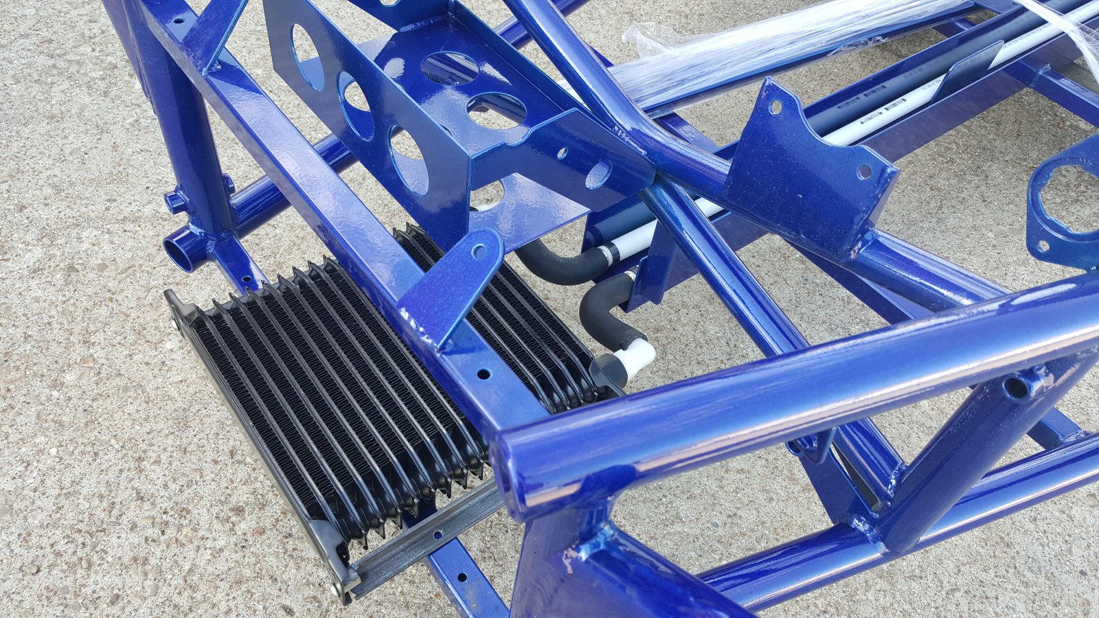

Finishing up plumbing the IC system, and got the heat exchanger mounted. Just need to plumb in the pump - wanted to make sure I had it in the right direction.
Then I laid in the finished harness for hopefully the last time. Almost everything seems to fit well - dash section is good, BCM and front fans/horn are good, and everything seems to fit the fuse box/ECM housing pretty well. I unfortunately seem to have added a little too much extra in the middle (though I only made one half the same length as the other, so...) and it's a bit long. I need to either bunch/fold it up in the tunnel or find a way to secure it out the back. Obviously the latter seems preferable, it would just require me to extend the rear tunnel ground (next to the headlight breakout).
Getting pretty excited, since all I'll have left after finishing these couple things is adding the brake lines from frame to caliper and bleeding, then adding the shifter, and I should be able to take a spin.
