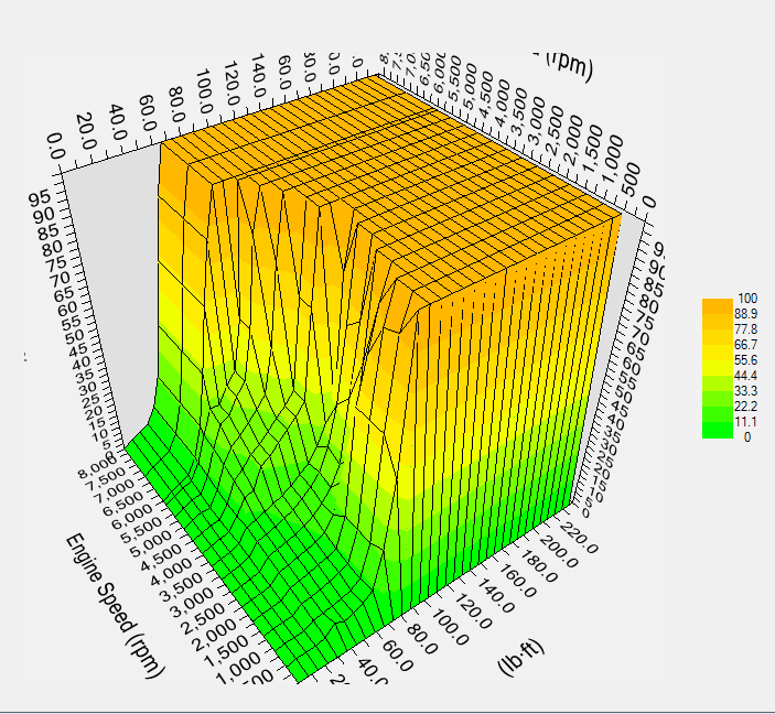

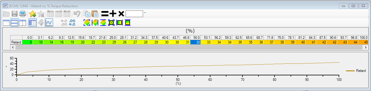

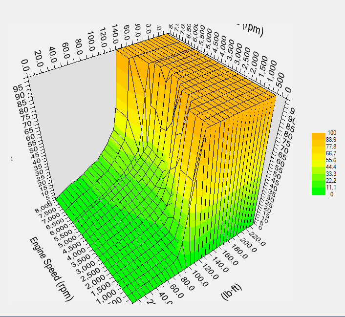

I've been looking at videos on Goat Rope Garage and looked at other tunes. I have not been able to find any shared tunes with Stage 2 Cams so that part is a big question for me. I was able to find a tune running 60lb injectors with a TVS. I look at a lot of changes (mainly fueling and spark) in that tune and transferred most of them over. There were a bunch of changes in that tune under injector control that I didn't understand. It had "Flow Rate vs Volts" at 1.3 and there were a lot of changes to the "Offset vs Volts vs MAP" and "Offset vs Volts vs VAC" tables. I didn't change anything in these tables yet.
I took another 10% out of the timing on that tune to start and set the injectors flow rate vs. kpa to 63lb across the board. I kept the rest of the changes from the modified tune that I had before like MAF, DFCO, etc.
Any help on adjusting this tune to get the car running and fine tuning once it's running would be greatly appreciated. I know there are at least 3 other people planning on installing a TVS so a lot of what we do here will probably help them.
If anyone has a TVS running and would like to share their tune, that would also be appreciated.
I'm still about 2-3 weeks away from getting everything in and back together. I'm still learning so don't be afraid to call me out on anything that looks wonky!
My tune is attached as well as the TVS 60s MAF tune that I found and referenced (used) as a template for a lot of changes.
