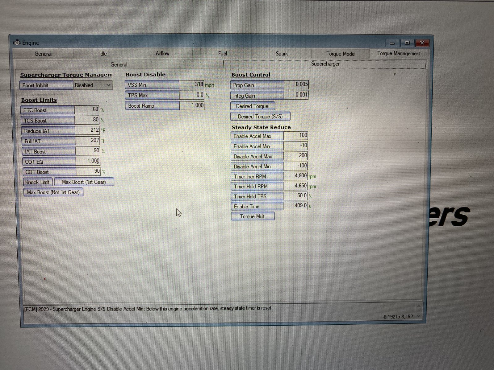

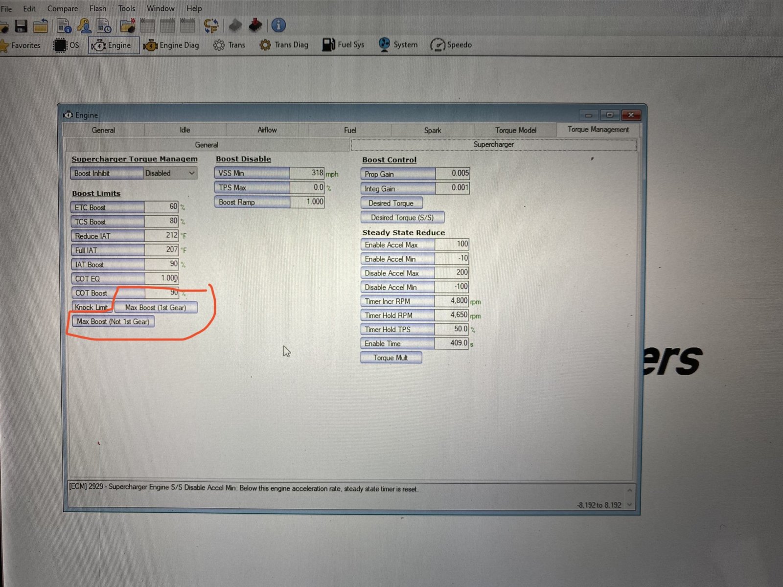

Will you be using 1 gear boost reduction on your tune ?
HP Tuners has gear information, but it doesn't work for my manual 2006 SC LSJ. I think it is for the automatic transmission, as most ECUs limit the torque during shifts. So basically there is no boost by gear using HP Tuners. I hope to use an independent boost controller that takes input from the transmission for 1st gear boost control.

I noticed when Lonny posted about off the ranch goblin in classified when the guy was trying to sell that goblin . That he listed his tune was set at no 1st gear boost reduction . I also have the Z54 turbo and ZZP will be doing a remote tune for my goblin. The hp tuners and laptop should be here Wednesday so I was going to set it like he did .

Limits your power through boost reduction. It must do a calculation for RPM versus speed to know what gear you are in. That’s the only way it could know.

I haven’t tried it. I set everything to not limit boost. I might try it one time in my tuning efforts to see if limiting boost changes anything.
