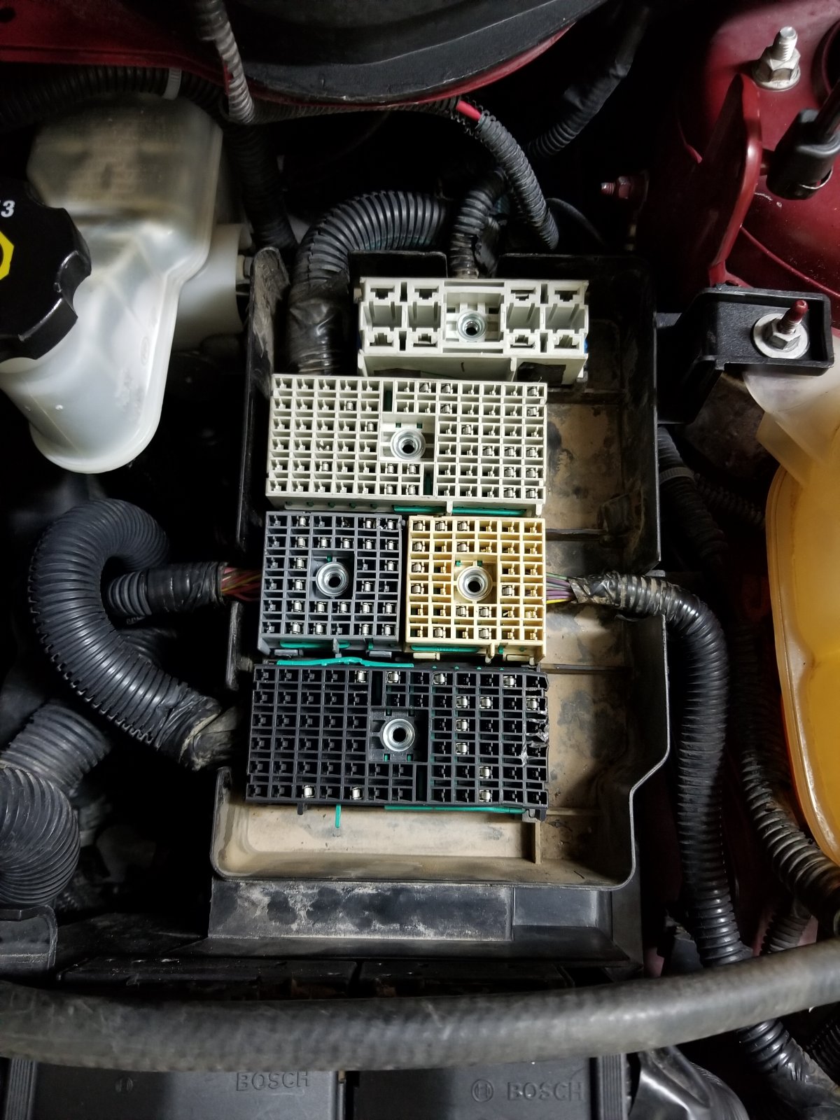

This all looks correct and in the right spot? I did find a pin on the relay board that was bent over but it looked like the heated seat fuse, so I left it.
