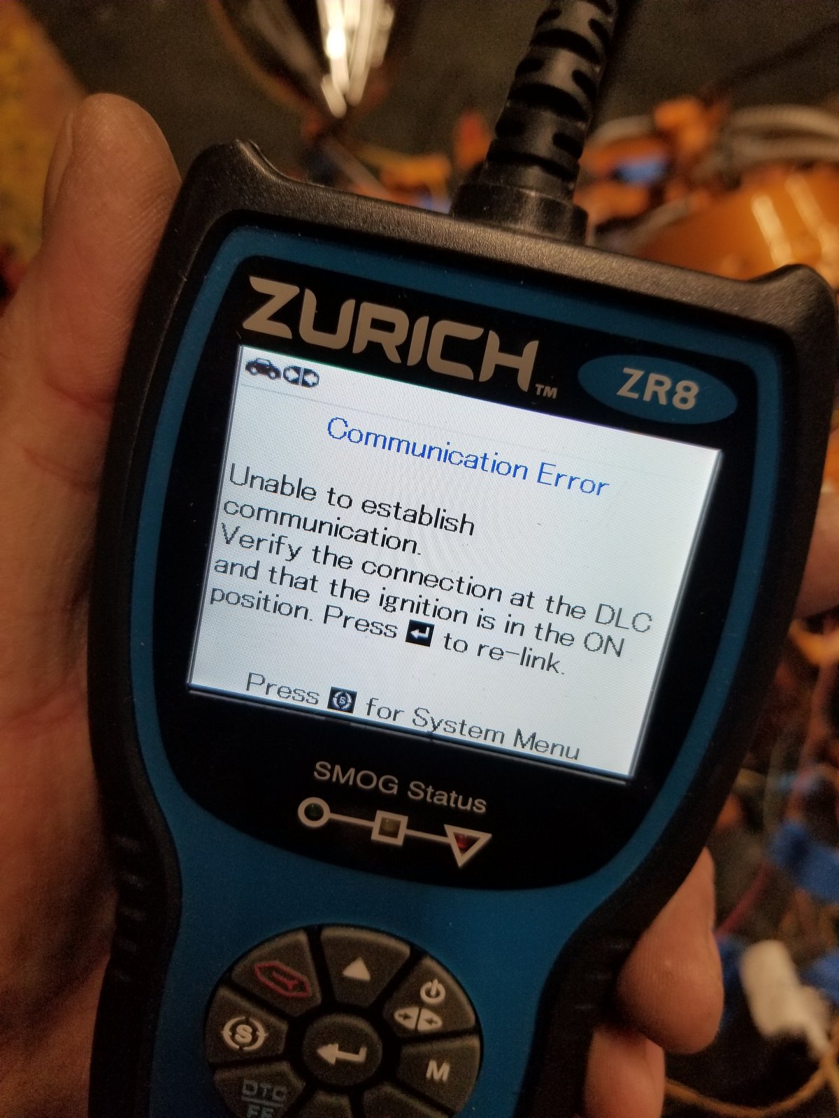

Ok what should I be looking for here? Yes the key is on. As soon as the battery is connected, the dash lights come on. Throttle plate does not cycle clutch in turn key BCM has clicking noise. but, no crank. the passkey shows "lockout" I tried to relearn the key, lockout light never turns off after 10 minutes.

Hmm. I would first check if all the plugs are seated correctly. Is anything from the BCM working? I want to say the BCM controlls the lights. Are they working? If yes theBCM seems to be on. If no check the power supply of the BCM.
If all is OK, I would check the can bus going to the vcm and Obd 2 plug.
I base my assumption on the communication error of your picture. I guess that means somehow the BCM can't be reached. Either no power or no can, I would think.
