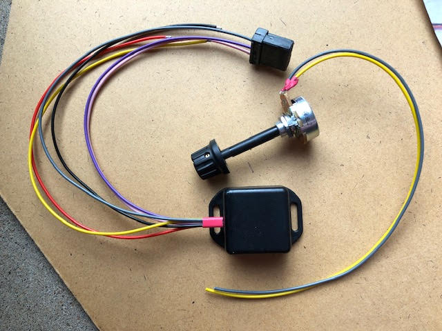

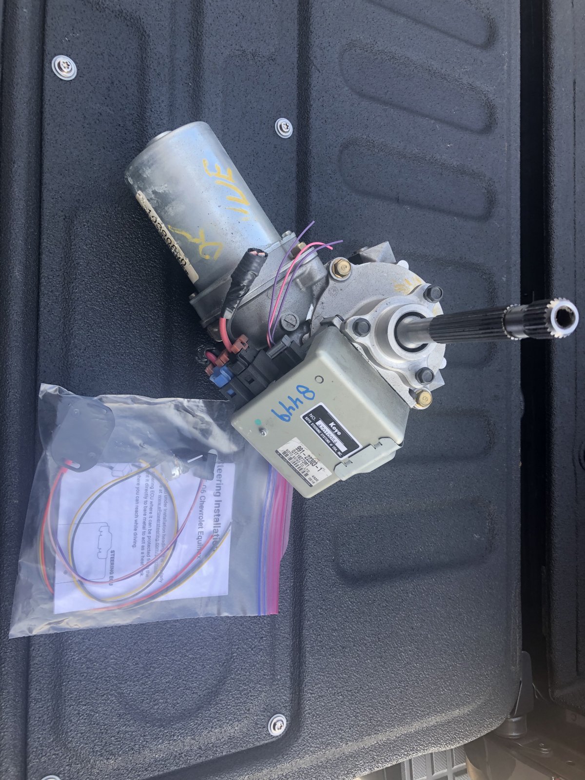

Steering box and adjustment switch kit so you can vary the amount of power steering in your car. Box is out of a Vue (metal case box)....the standard Cobalt boxes don’t work with the adjustment kit.
Sell both for $50 plus shipping...I paid $175 for both. I am going with a race steering setup so don’t need it.

I sure wish I knew how they did it with the VUE. I've looked into it and without having to do re-programming, I'm not sure how it would be accomplished on a Cobalt.

$45 on ebay for the Bruno controller that mimics the ECU... you still need to buy the power steering unit.
$110 for the Bruno controller, fuse, a few other parts.

Bump... Can someone tell me if the Vue steering unit is a direct bolt-in replacement, or would modifications be required? Considering going this route.

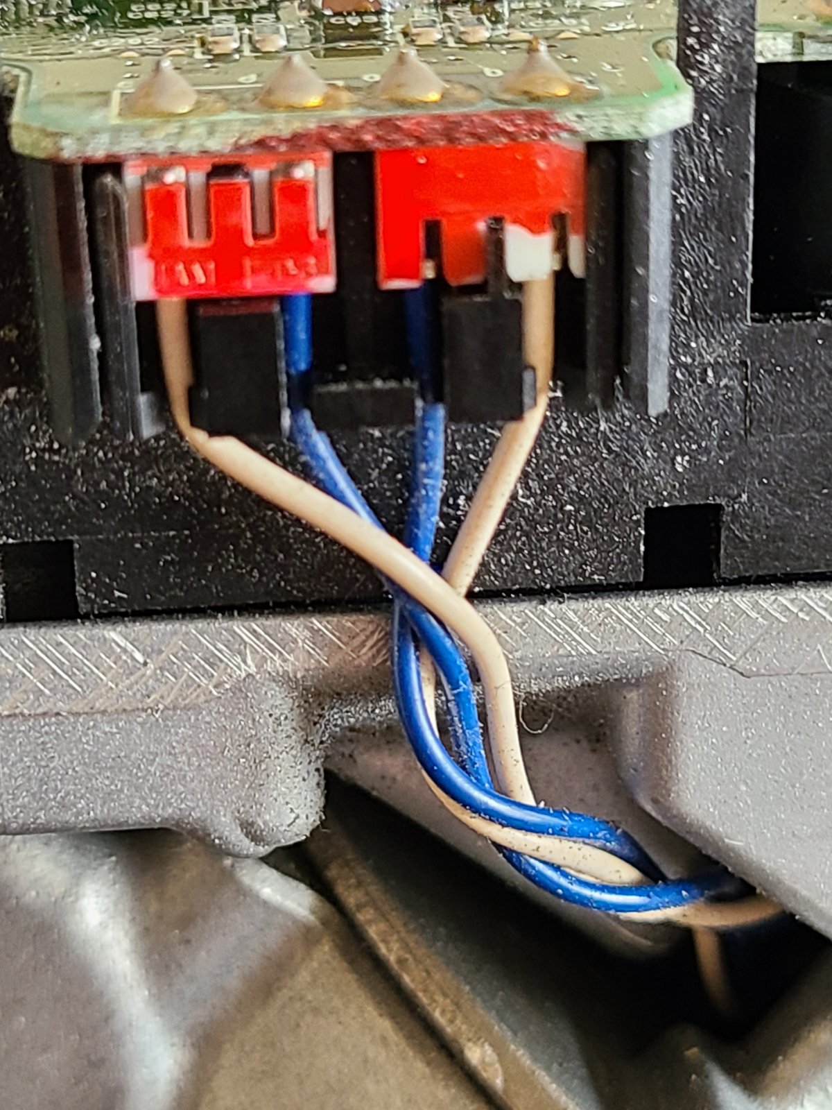

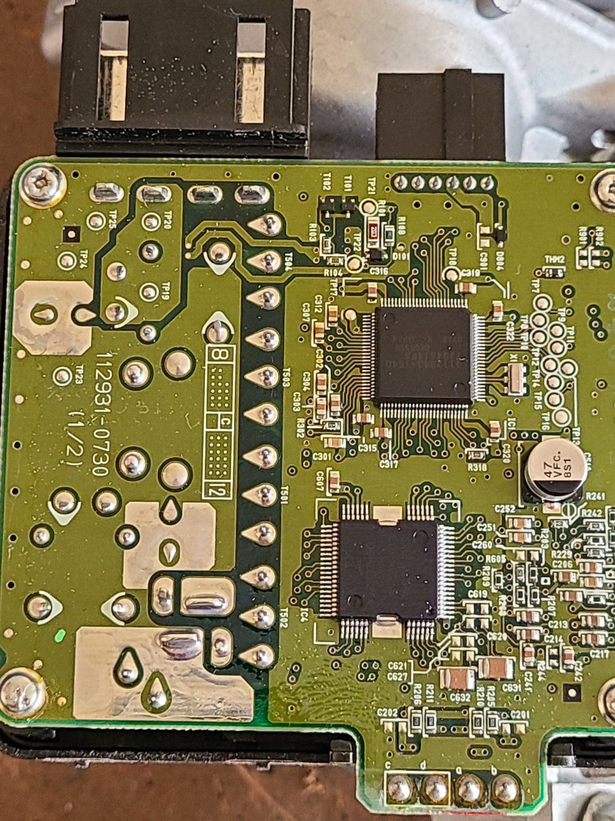

I was tinkering around and pulled the cover off the plastic box and found the side connector on the board can't be removed without taking the board out of the housing. But 1 of the 4 screws is soldered over so it can't be readily removed. The other end of the blue and white wires are hardwired into the steering motor. The board housing is held in with 2 screws and is easily removed. I'm not sure I'm going to dig any further into this without more information.
BTW, does anyone have photos of the metal box connector and possibly the board?

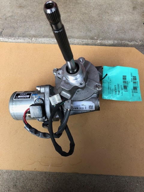

The plugs are identical, other than the motor to box and battery power to box plug positions are reversed. Why not just get the whole EPS unit from the Vue? Its a direct bolt in. Got mine for under $50 from a pull your own.
