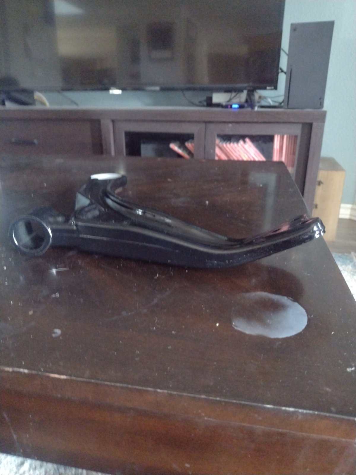

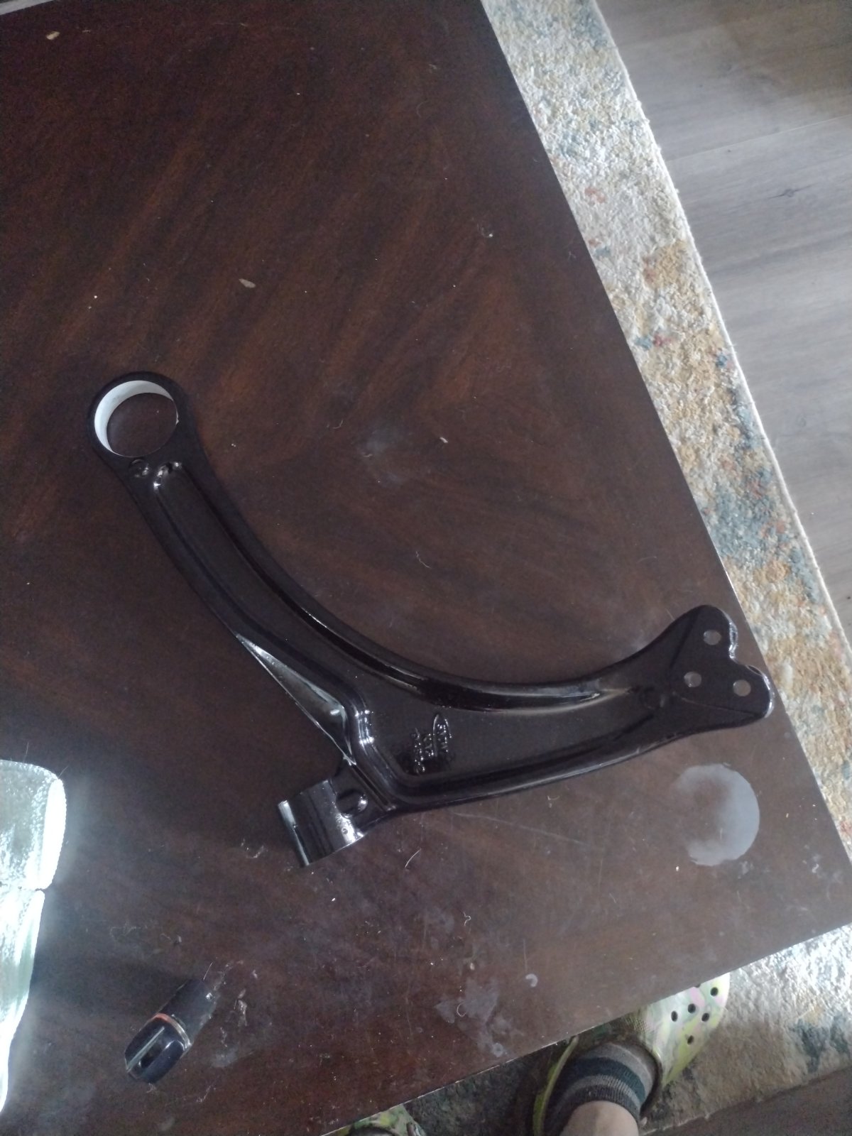

Got all my parts back from powder for the suspension, it seems at some time between having a buddy punch out the rivets and getting the powder done the arm got bend. Didn't notice it until now. Can't find tubulars in stock on zzp (lsj only) and ottp wants an arm and a leg. Anyone have a spare driver's side fe5 or any ideas?

I think the only possible difference might be the ball joint mounting holes spacing/size, but I don't know that they are different. OTTP may just have the last remaining stock LNF control arms and charging for it. There hasn't been anyone showing availability of actual stock LNF arms in years.
This won't work on the LNF, ball joint will be the wrong size. Hard to say if your LNF ball joint will match to the mounting of aftermarket arm, but "probably" will. If you are buying and changing the ball joint and bushings anyway, I would buy the cheapest aluminum arm they have. FE5 doesn't mean much in this case.

I'm just in the position of mounting holes not lining up or control arm length is off. I am replacing everything yes, but don't want to have to shell out 5-600+ for tubular arms just want to make sure if I order some they will work.

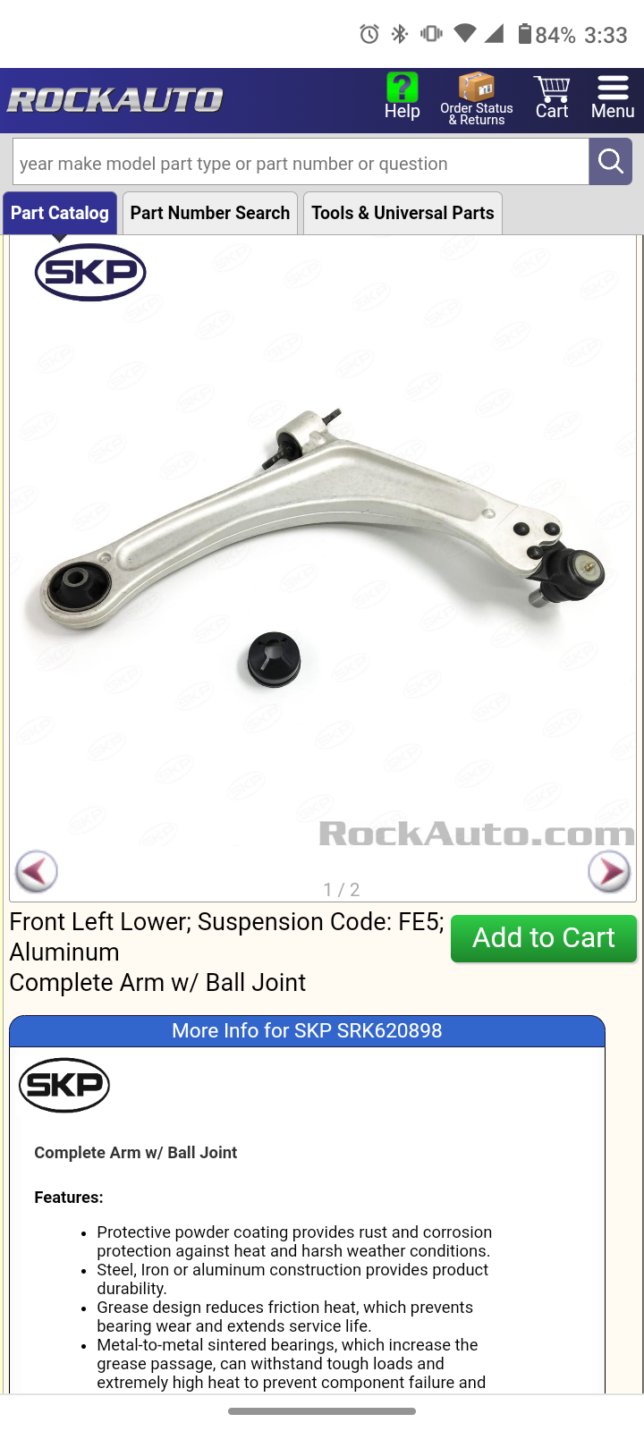

Well RockAuto list them for the LNF although they 99% won’t work. Order them, check the ball joint mount spacing and if it won’t work then return.
