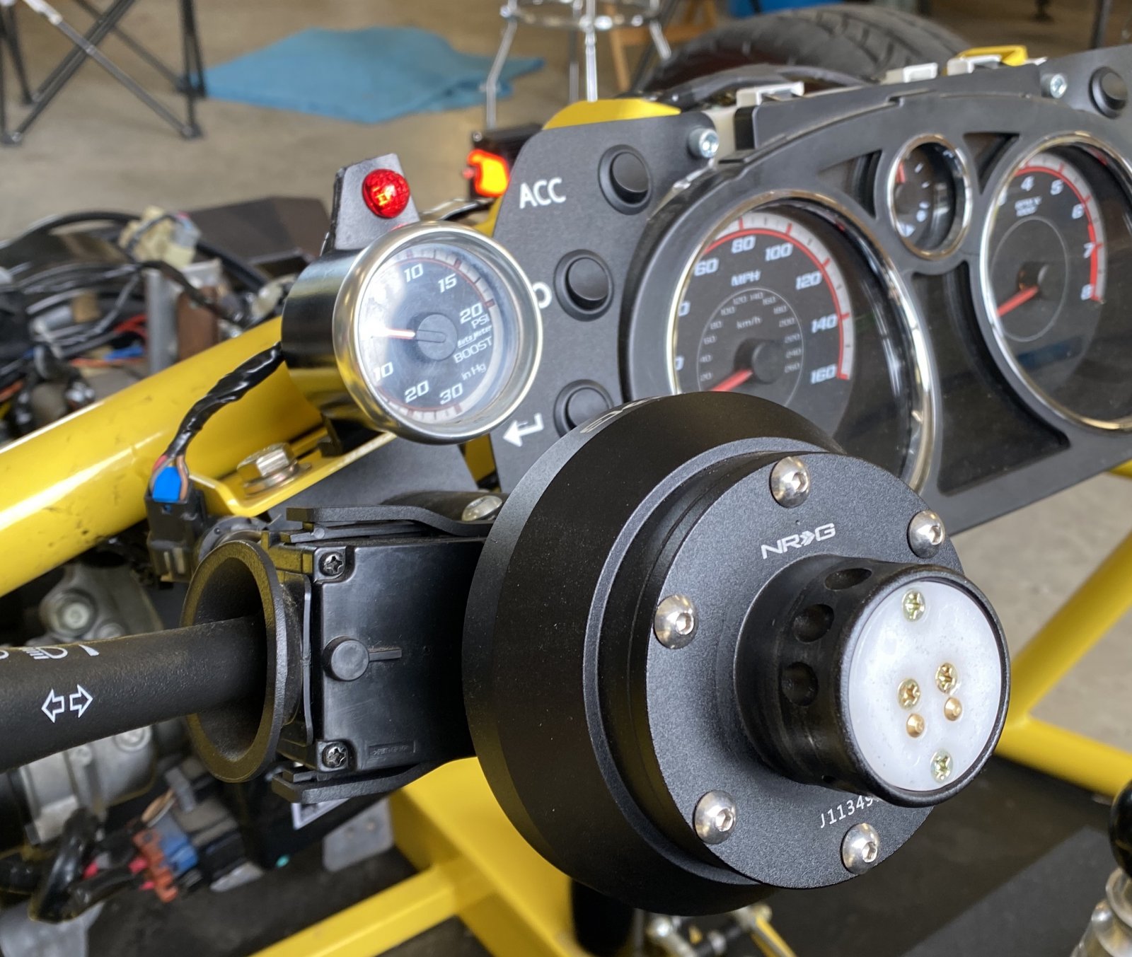

Since you don’t have a newer model, it’s not needed for programming, calibrations and such, so you wouldn’t be gaining anything. The abs and red brake light will still be on due to all the codes. If you need a functional red brake when the park brake is pulled (and to pass state inspection in some states), the switch that is on the handle triggers ground. Simply run a light wherever you want it, attach positive side of the light to ignition and the negative to that switch on the handle. On the handle, it’s just a spade connector you probably have in your electrical drawer. I mounted my red brake light to the boost gauge mount that I made.
