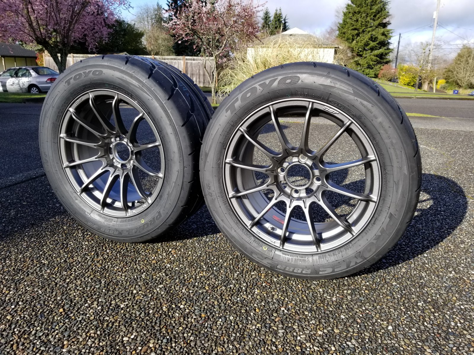

-Wheels: Konig Dial In
Front: 15x7, Grey, 35mm offset, 4x100, 10.9 lbs.
Rear: 15x8, Grey, 25mm offset, 4x100, 12 lbs.
- Tires: Toyo Prices R888R's
Front: P205/50/15, 20 lbs.
Rear: P235/50515, 23 lbs.
