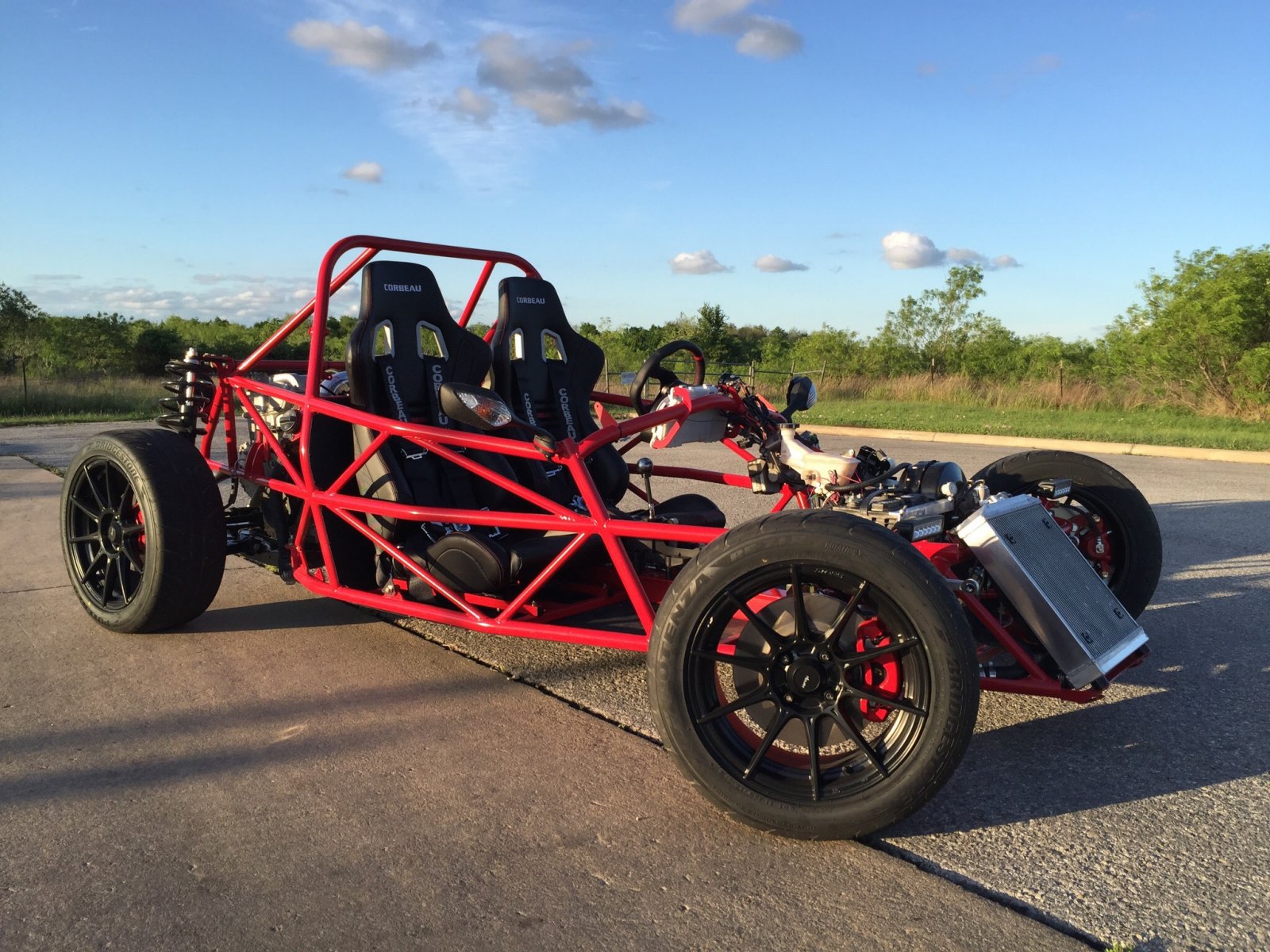

I've been looking a lot of wheels lately. I end up looking at this list, then googling the pictures etc. It would be great if everyone who has their wheels / seats etc mounted or possibly even unmounted, could snap a picture with their post. That way people could see what different types look like on the goblin, or how the seats look etc. Thoughts?
Funny, I was just thinking about this last night. When I get the car on the ground and get it in some good light, I'll take some photos focusing on primarily the wheels and tires on the car.
JSATX
There’s a bunch in my thread but here’s another
