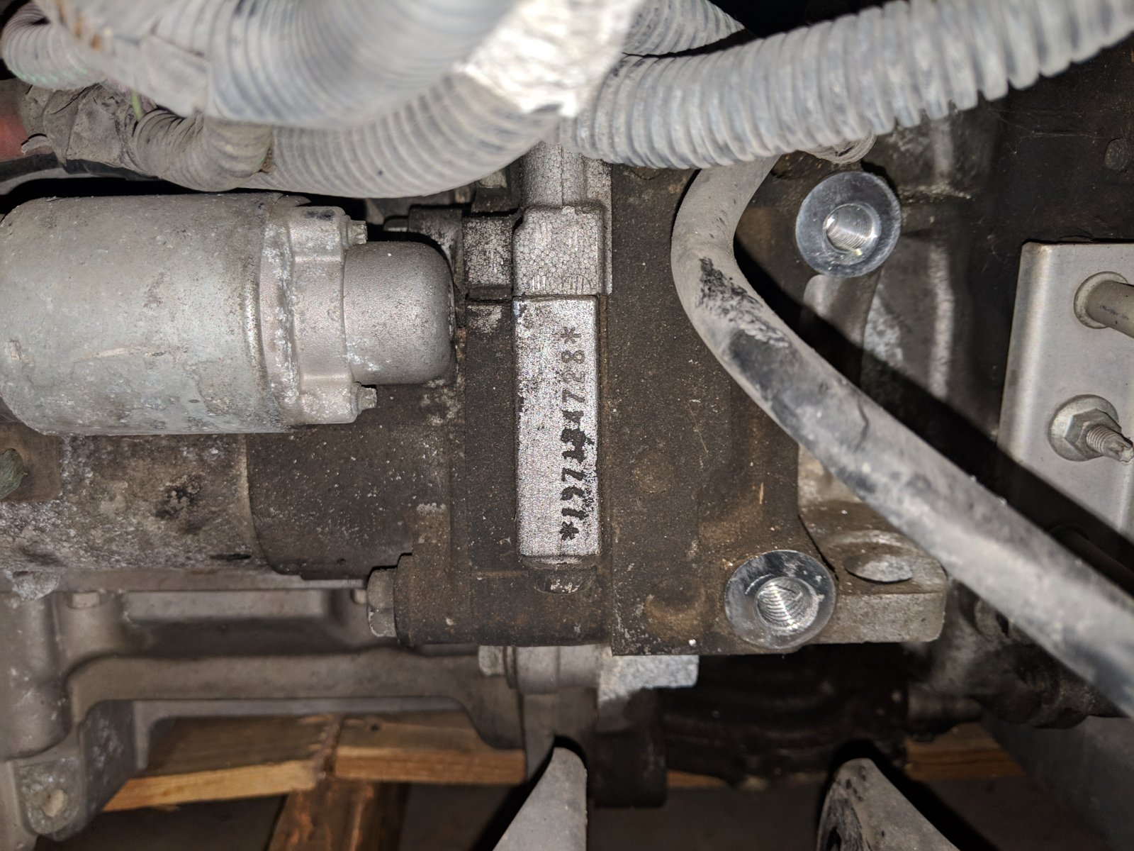

My donor was a prior salvage vehicle and when purchased there were some interesting conversations around the year of the car, i know that sounds weird. Curious is the engine was possibly from another vehicle and want to confirm what ecotec version i have. The title shows 2008 so i assumed i have an L61 2.2. Is there a stamping somewhere on the engine to confirm the version of engine?
Adam
You can find a partial VIN etched into the block below the oil filter near the starter. It should match the last 9 digits of your vin.
