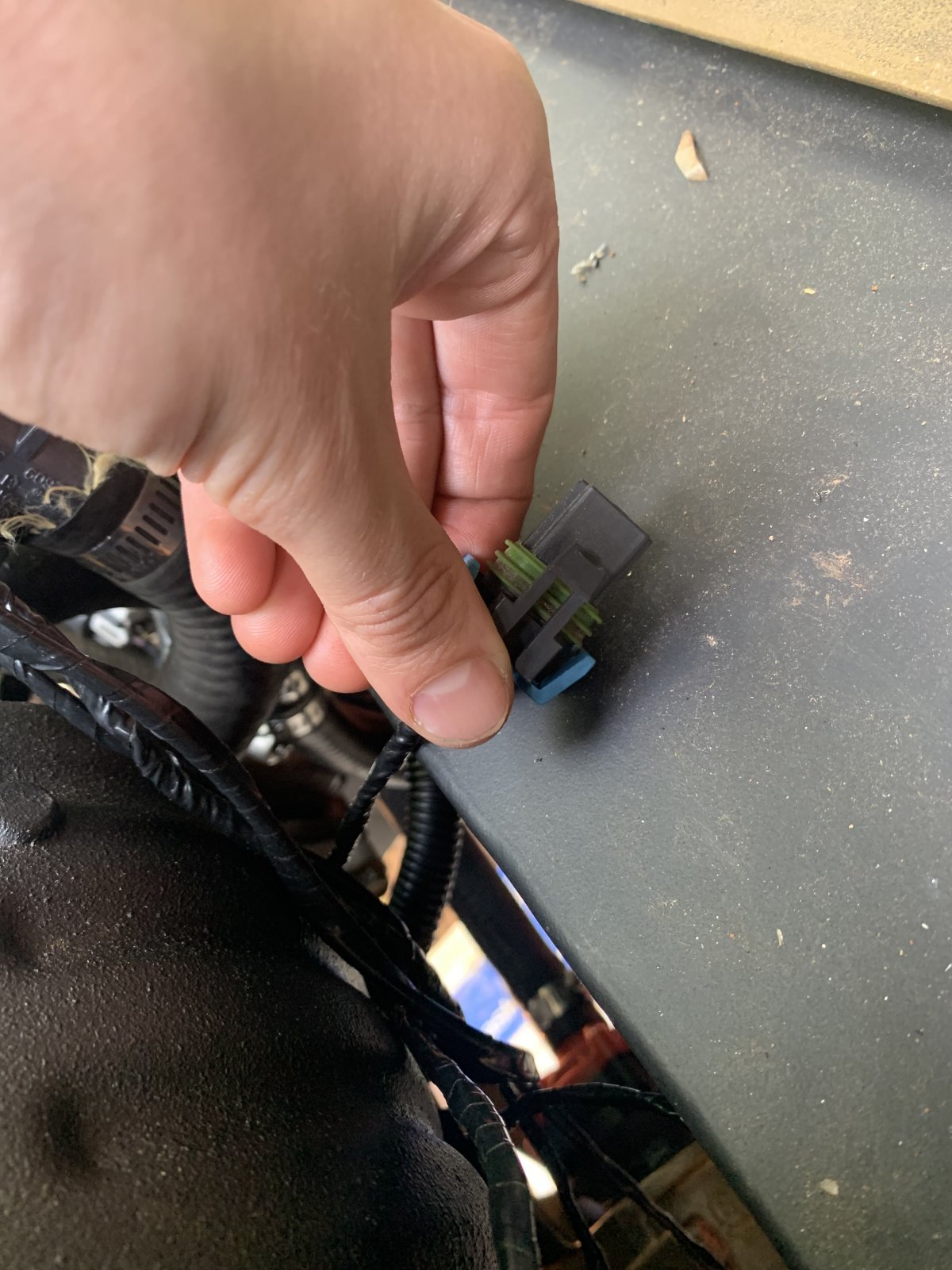

1. I believe this was from the MAP sensor on the supercharger. What becomes of this now that there is a turbo in it's place?
40623

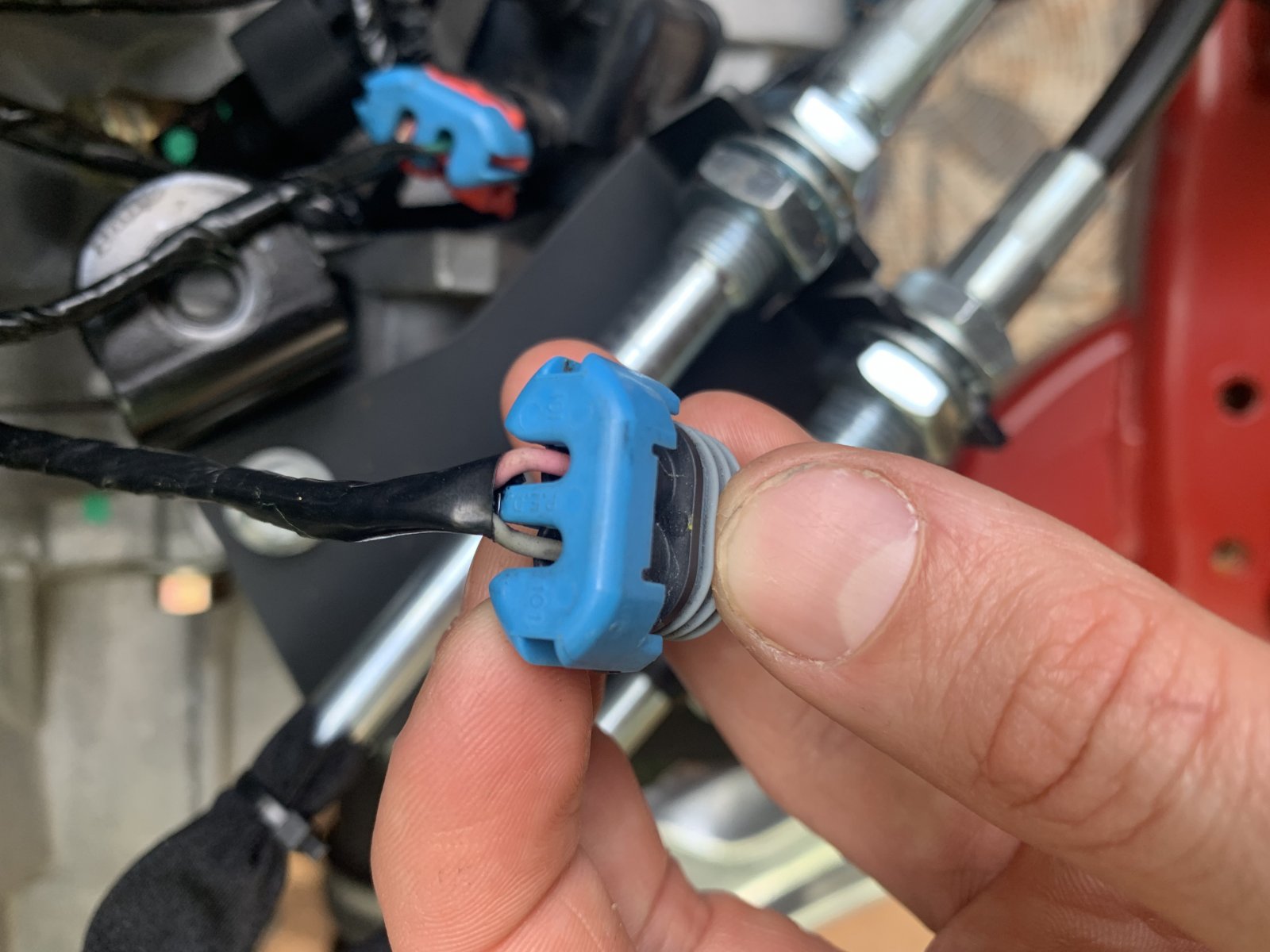

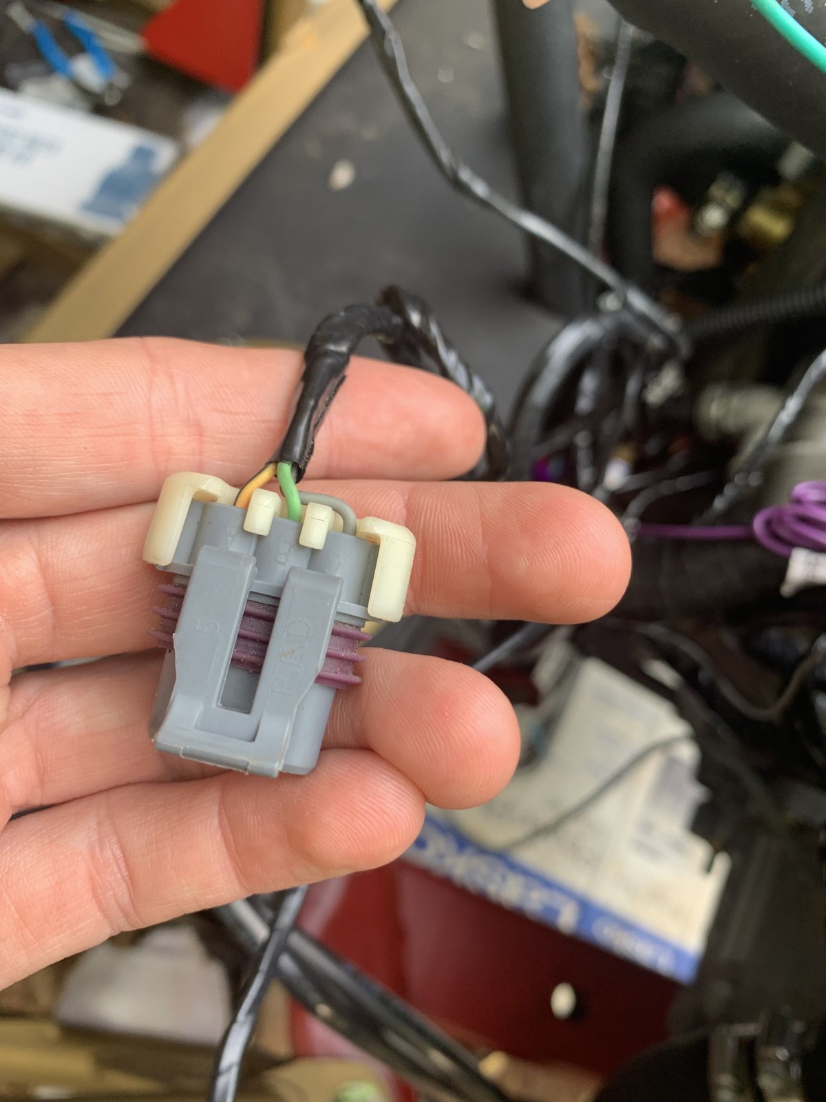

2. Does anyone know what this connector goes to? Really not sure on this one
40624

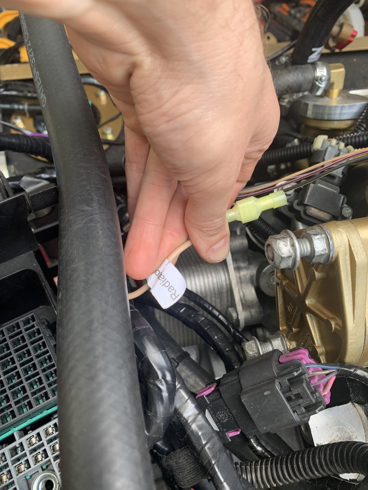

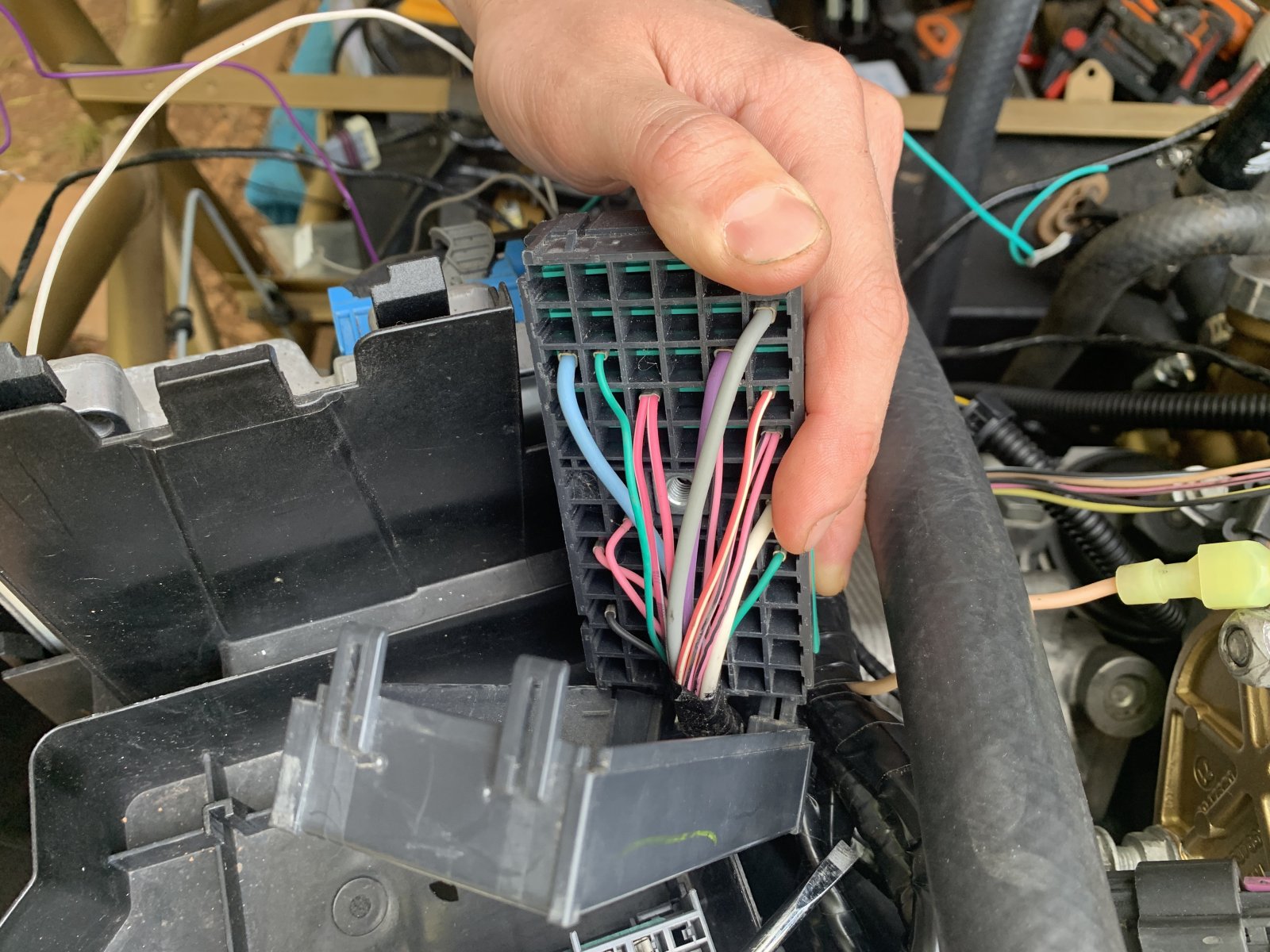

3. So as mentioned, DF did my harness and used this tan wire to extend the radiator fan wire. However, in the video (part 20 I think it is), where the fusebox installation is covered, Lonny mentions soldering this to a light blue wire from the black multi-plug - The light blue wire in my black multi-plug is still intact. I'm pretty sure I just need to cut this and then solder in the tan wire. Can anyone confirm?

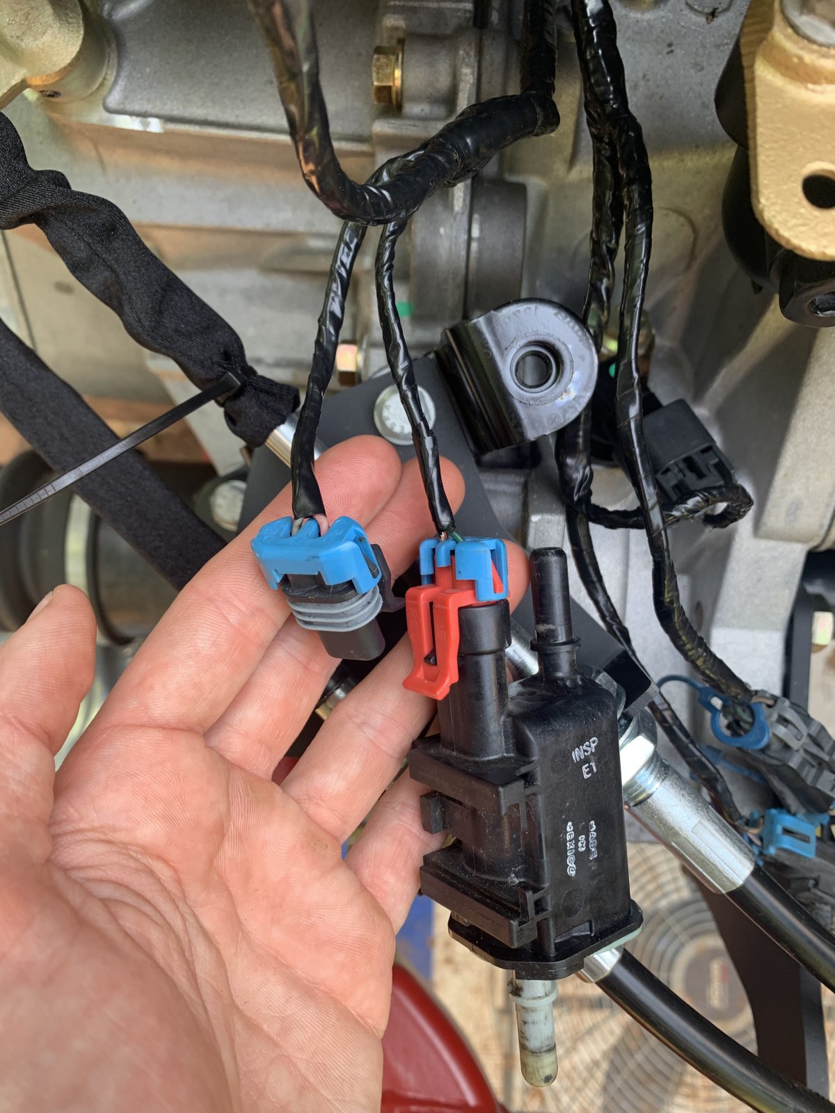

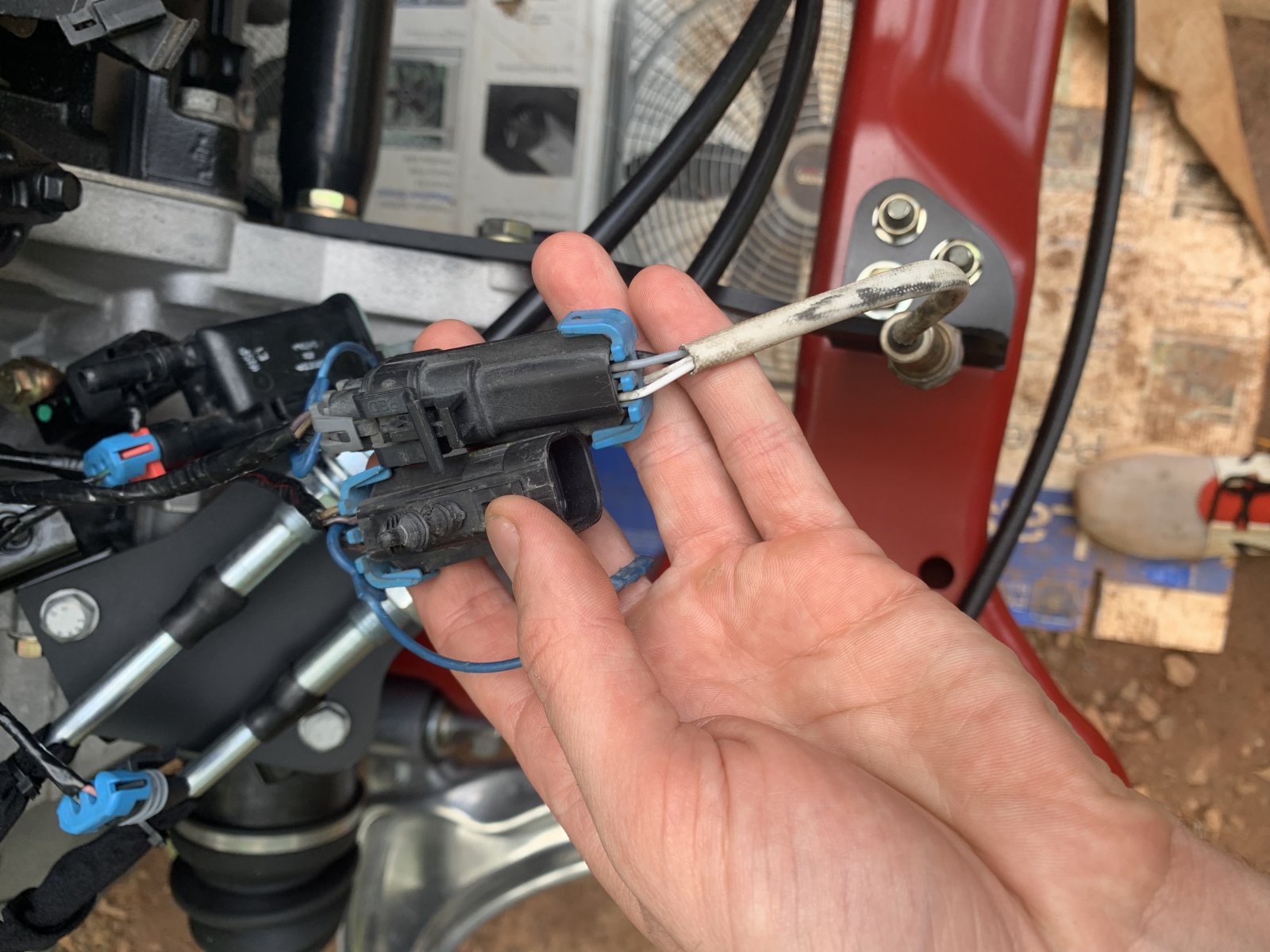

4. This pops out right over the transmission housing, next to the EVAP solenoid connector. Does anyone know what this goes to?
40626

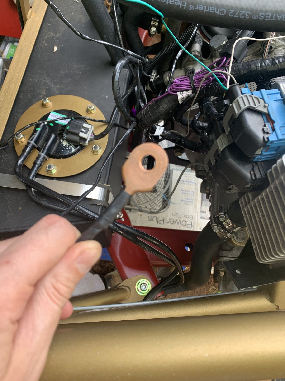

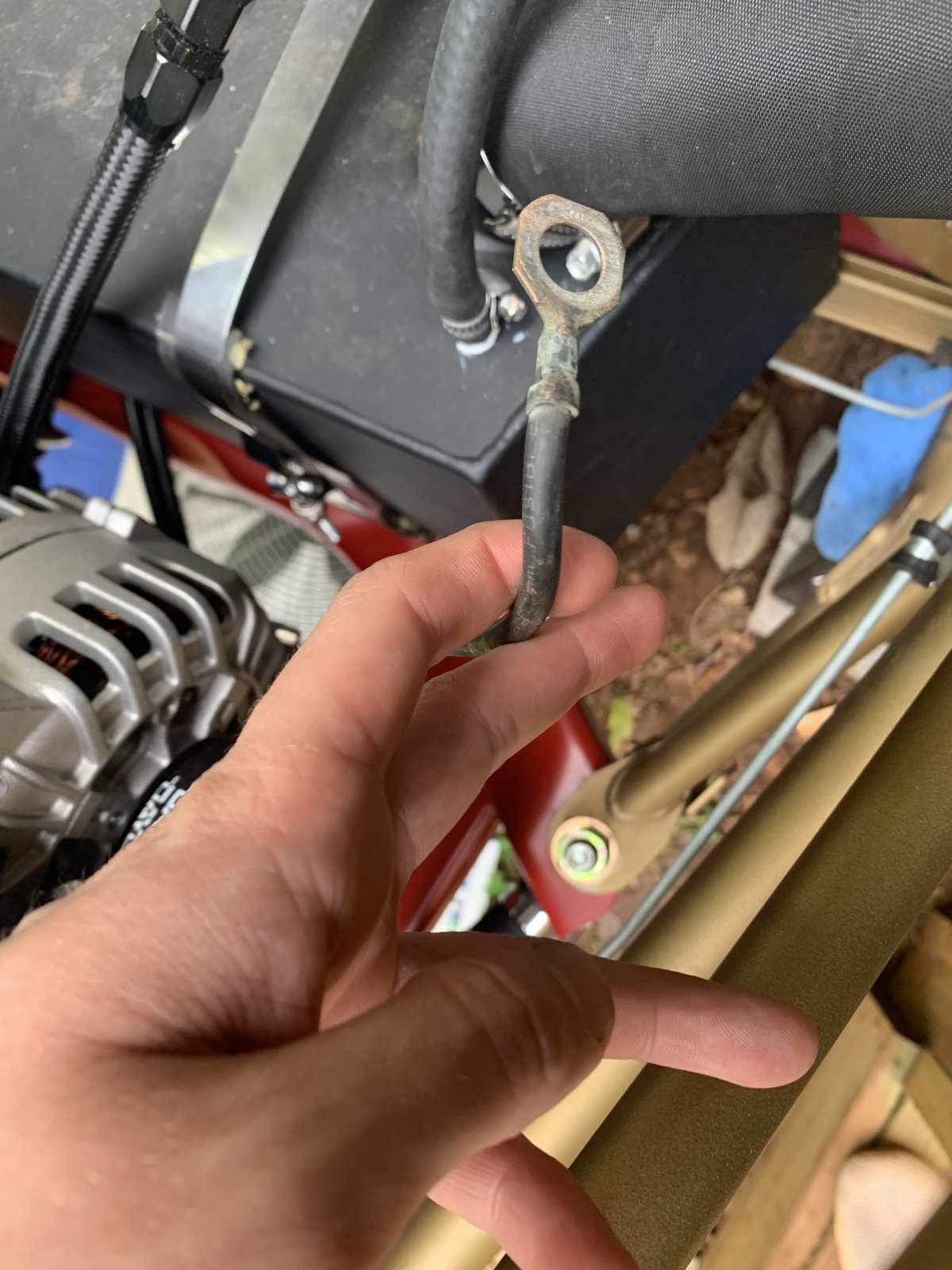

5. This ground pops out of the main harness right at the fusebox. Where should I ground this?
40628

5. My transmission mount has a ground lug. Under the fusebox.
6.the tunnel ground was eliminated.
So Ross in regards to #5...How would you accurately determine whether or not something should be grounded to the chassis vs the powertrain? Does it matter?
Not to put too fine a point on it, ground everything to everything else, unless it is not supposed to be grounded! Especially a big, thick ground from the frame to the engine somewhere near the starter! Two wouldn’t hurt but someone might think that is silly. I’ve personally fixed several cars with an engine to body and frame ground. Two had computer “malfunction”! Corrosion growing from the neg battery clamp and up under the insulation causing excessive resistance at all grounds, what a mystery! I stripped back the insulation when I noticed the plastic insulation was very lumpy and a little crunchy. The corrosion had grown down the copper plated aluminum wire several inches, all inside the insulation! ( A personal preference is that all battery cables be stranded, real copper elements! Thickerer the betterer! That copper plated Aluminum stuff does ok until the end of the warranty?)This corrosion is never caused by excessive battery maintenance!
