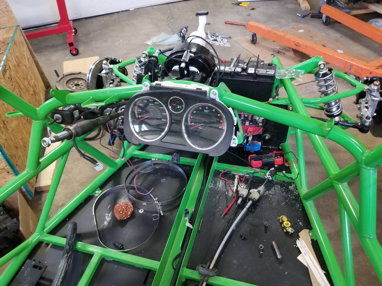

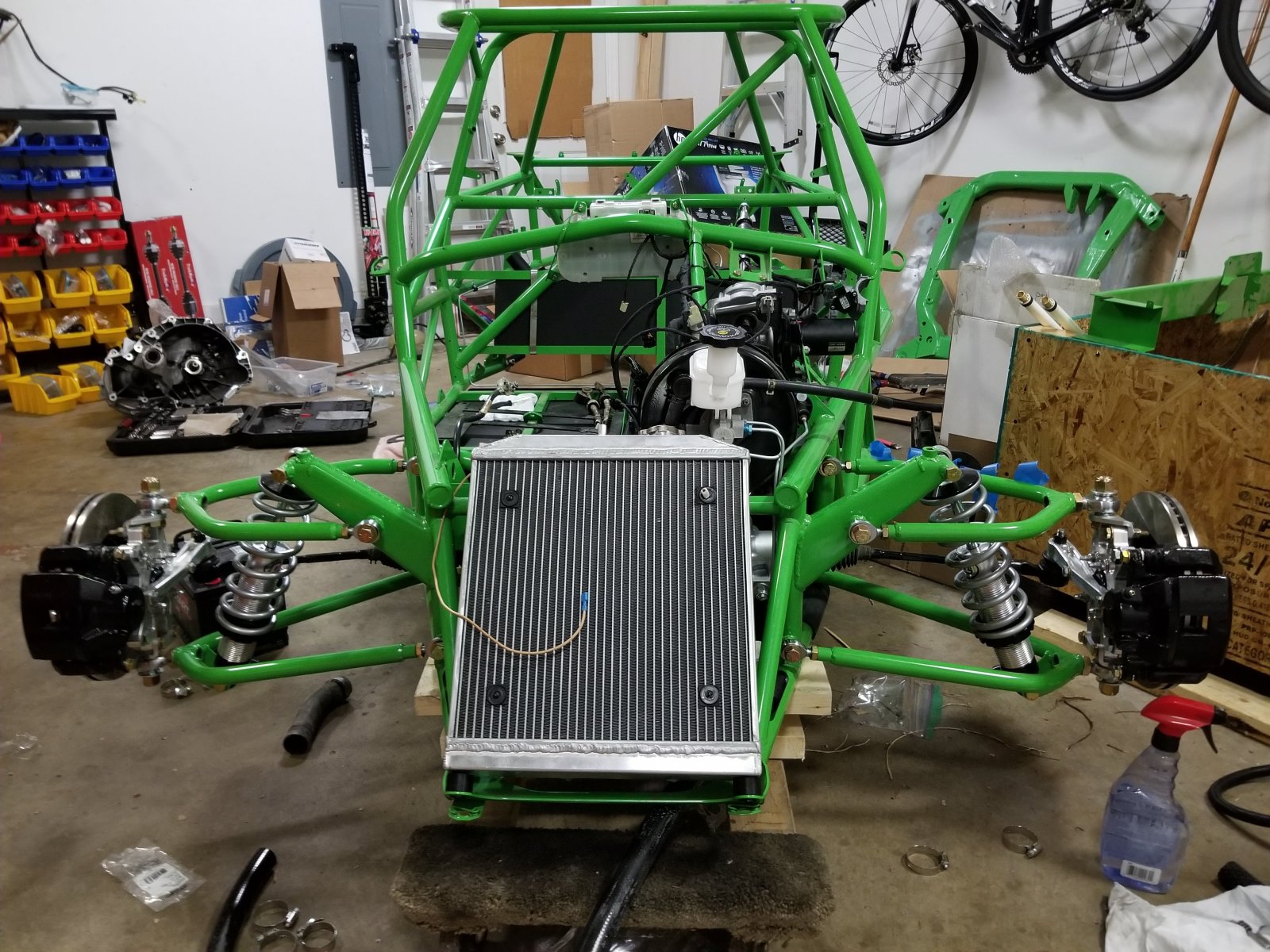

Got the main wiring harness laid out and the BCM installed. I had to create some spacers for the space behind the BCM by cutting a piece of white metal tube from a child gate since I couldn't find them in my bags of hardware.

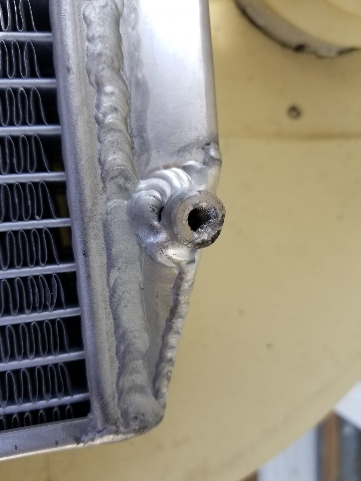

The radiator is installed. I spent a couple of hours trying to clean out the threads on one of the top mounting locations. Not sure if the weld caused the damage or if it got banged up. Anyway, finally got it cleaned out enough so that the mounting studs would thread in. Also, I broke one of the black plastic circle locking pieces that is on the front of the radiator and holds the plastic rod. I ended up using a couple of 20in zip ties to secure and just pushed the black rod through the end of the zip ties and cut off 19.9 inches.
I am really confused about the radiator hose routing. The first written build guide and the video are different. Does it matter if the Driver's side runs to the top or the bottom? Any thoughts would be helpful. Another thing that is going to require some MacGyverness is the hoses that hook up to the radiator. Paul had pulled 1in silicone hoses through the frame, but I don't think I have the hoses that DF typically sends for the final connection to the radiator.

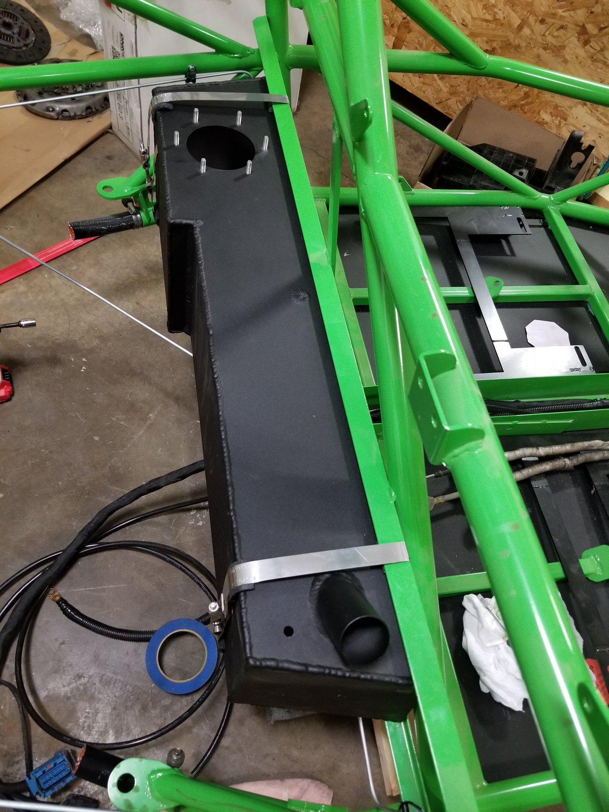

Fuel tank is mostly installed. I need to buy a fuel filler hose to finish it up.

With the radiator hose routing, either way will work. If you follow DF's instructions it says to run the passenger side (hot) to the bottom port and the driver side (cold) to the top port. The down side to this is coolant will stop if you lose too much.
Some of us have switched the routing to OEM way by running passenger side (hot) to the top port and driver side (cold) to the bottom.

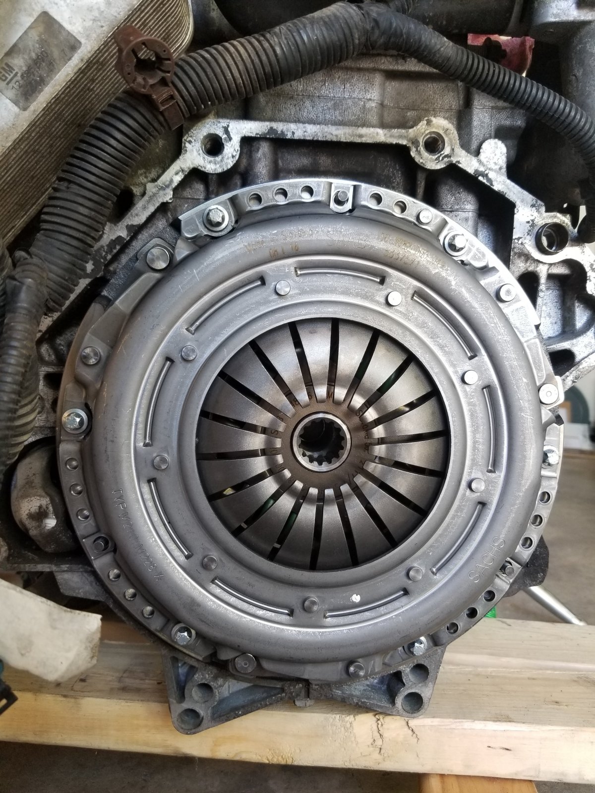

Also replaced the fuel injectors, starter and TOB/Flywheel/Clutch. I'm thinking about replacing the SC pump as well.

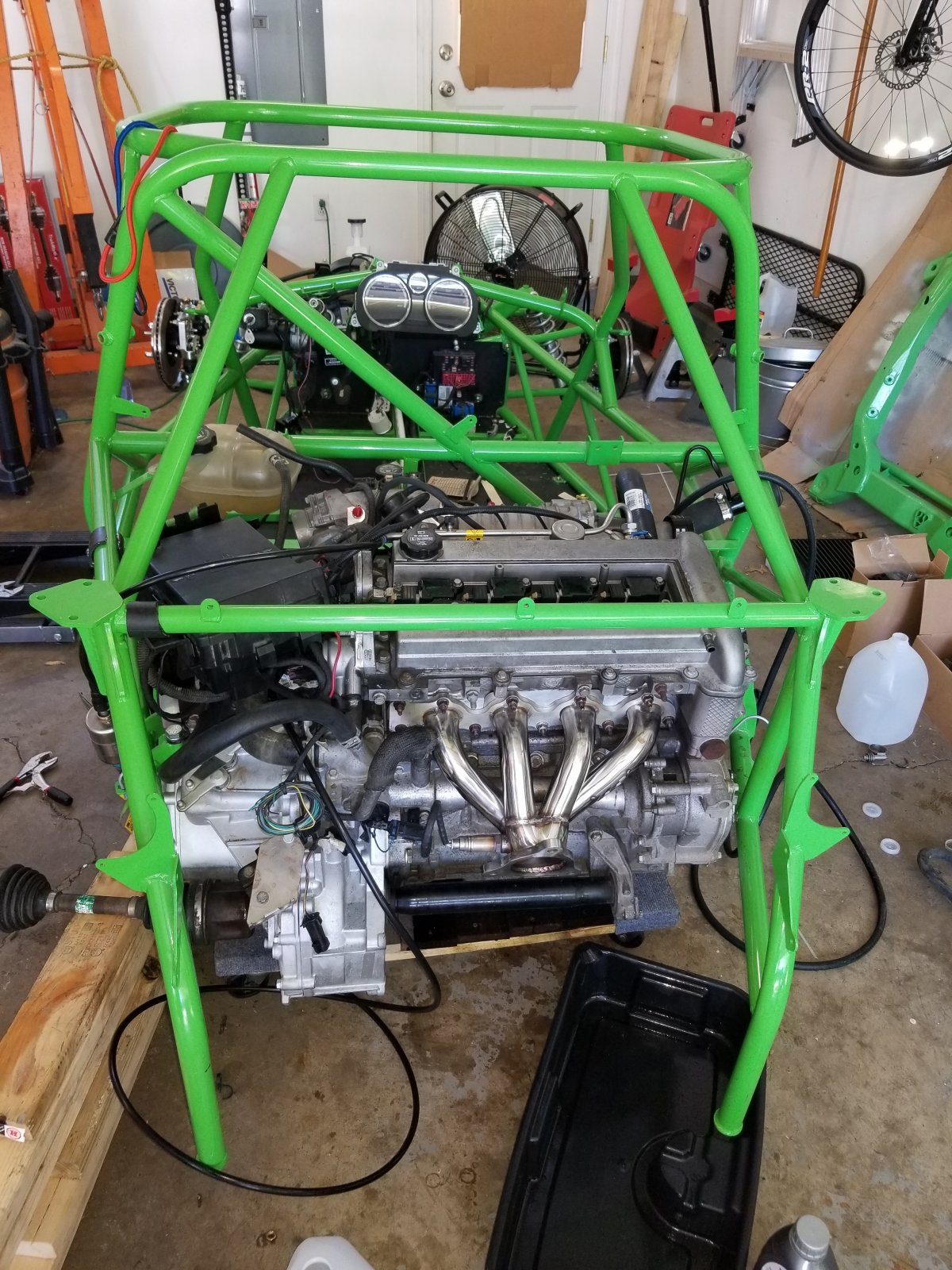

Engine is mounted and running!
Big thanks to George aka Brad for letting me and a friend swing by and see his Goblin last weekend. Took a ton of pictures and got a little extra motivation to mount and test the engine.

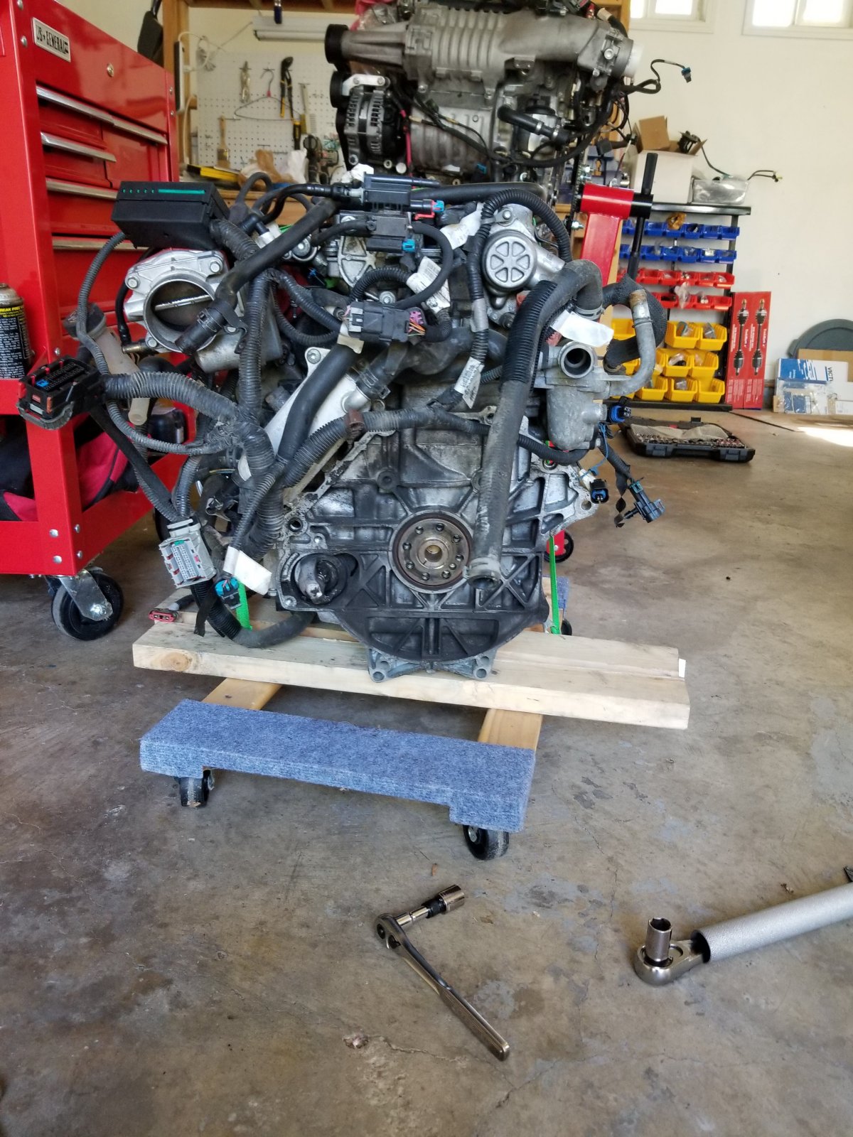

Make sure you have the ECM connectors completely tightened down. Mine felt snug, but were not and only some of the gauges were working. Also didn't initially have a throttle response.
We used 2 different torque wrenches to tighten the larger bolts on the engine and transmission mounts...100 ft lbs made the lock washers separate and become ineffective. Anyone else have this problem?

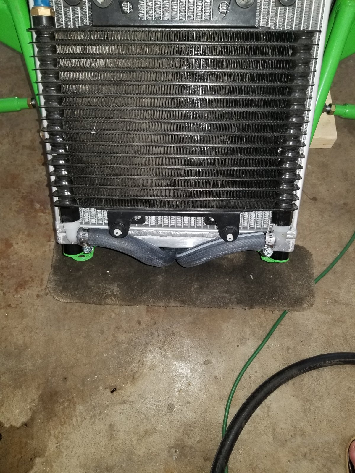

I will redo the HE setup, but for testing purposes mounted one to the front of the radiator. Also used distilled water to check for leaks.

I forgot Paul had an older style engine mount, and there are two sets of bolts. I thought you were referring to the bolts that actually run into the engine and transmission and not the bolts that hold the mounting plate to the frame.
You're right. The mounting plate to frame bolts should be 100 ft-lbs.

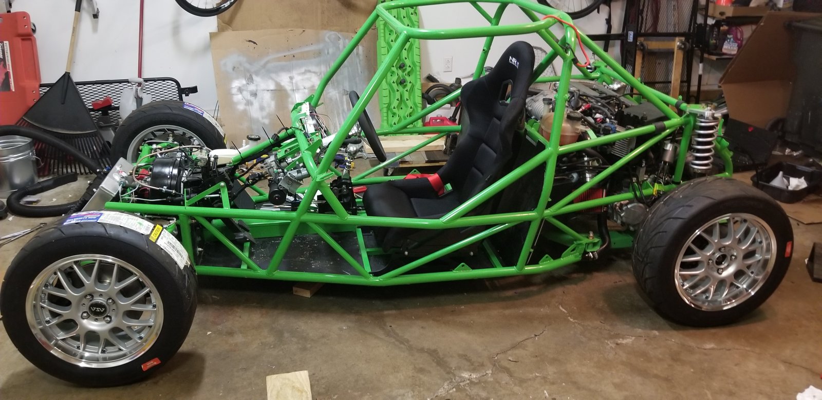

Overdue for an update. Took the Goblin down the street today, shifter wasn't perfect but it worked ok. I trimmed some threads off each side of the shifter cables and it is close.
I riveted the tunnel cap, but put a 5 foot section of 3/4 PVC with some paracord in there to pull wires through if needed at a later date.
A shout out to DF for quickly fabricating and shipping a few things I needed before the maiden voyage. Lonny and Adam thanks!

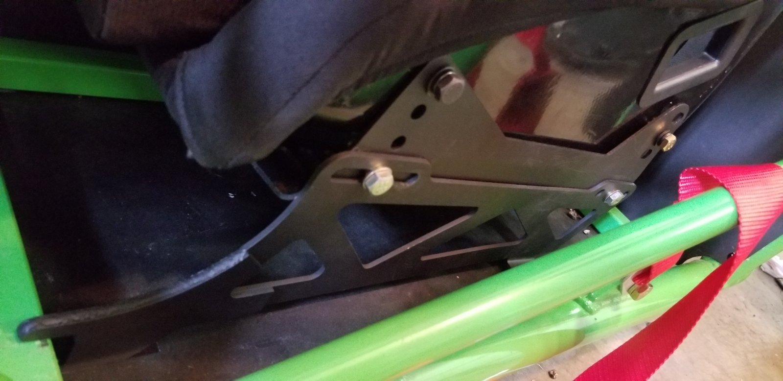

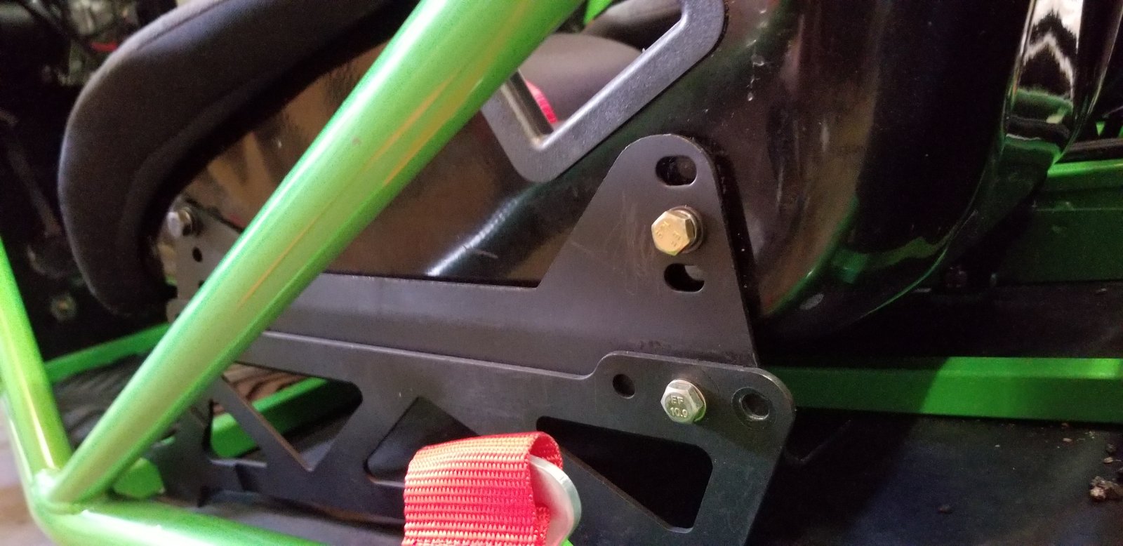

I have NRG seats with side mounts and lightly modified the brackets that came with the seats by drilling a couple more holes to work with the seat brackets supplied by DF. I think it will work well.
Next up is dialing in the front alignment and wiring the lights, turn signals and horn.

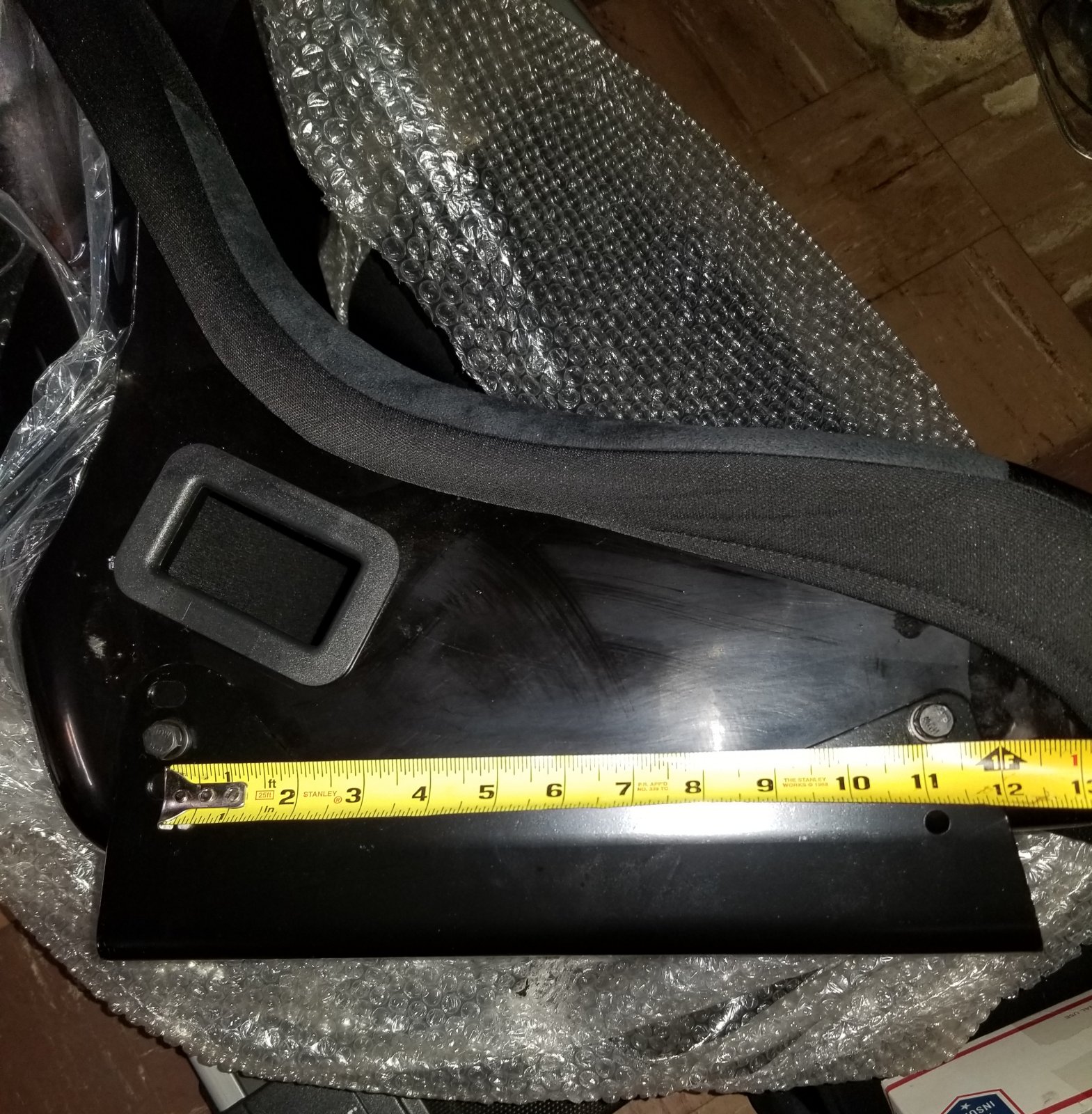

I picked up some NRG seats with sliders also. What bracket are you talking about? And did you have to worry about the big tab potentially hitting the seat in the middle?
W
Since I bought a lot of this from Paul, he had already purchased the NRG seats. He also bought some "cobalt" brackets and a slider that I did NOT use. I used the brackets supplied by DF and drilled some holes in the bottom mounts of the seats and added some washers in the back to get the width to match.

one note on my seat "solution" is that it sits a little high. i dont mind for drives around town, but ill probably revisit sometime.
You probably already know but I believe DF's seat brackets are supposed to bolt directly to the seat. Giving you the lower seating position.
W
Yeah, i tried that seemed a little too low. I may go that route again. i need to measure or sit in one with the corbeaus. i also DD a 4runner, so im sure that made it feel even lower. i think the ideal placement for me would be right in between.

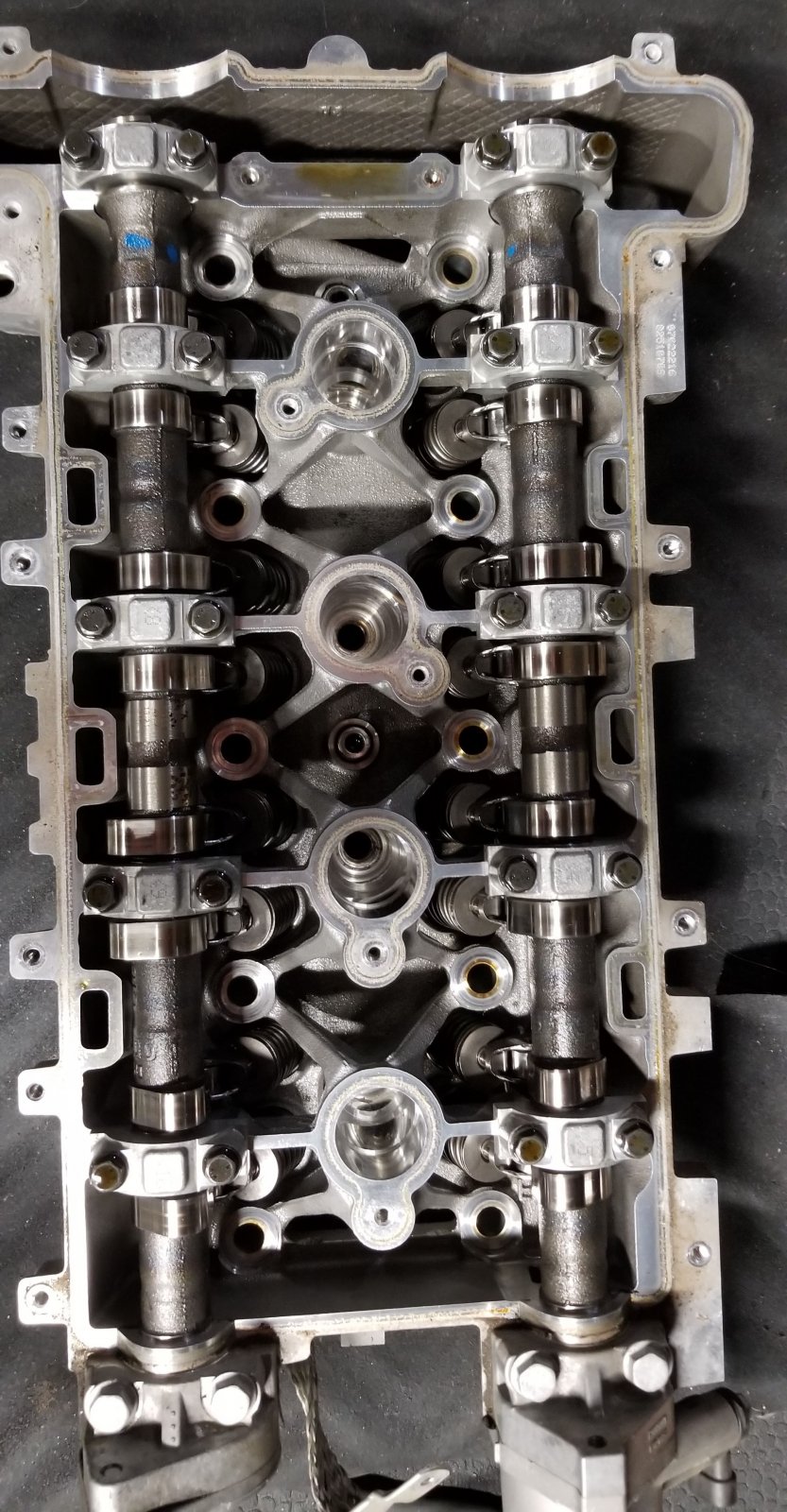

Pulled the head off my 2nd motor today. It is going to be ported and have new springs installed.
I am planning on running a TVS and while I really like the look of the wheels, 205s won't cut it.
