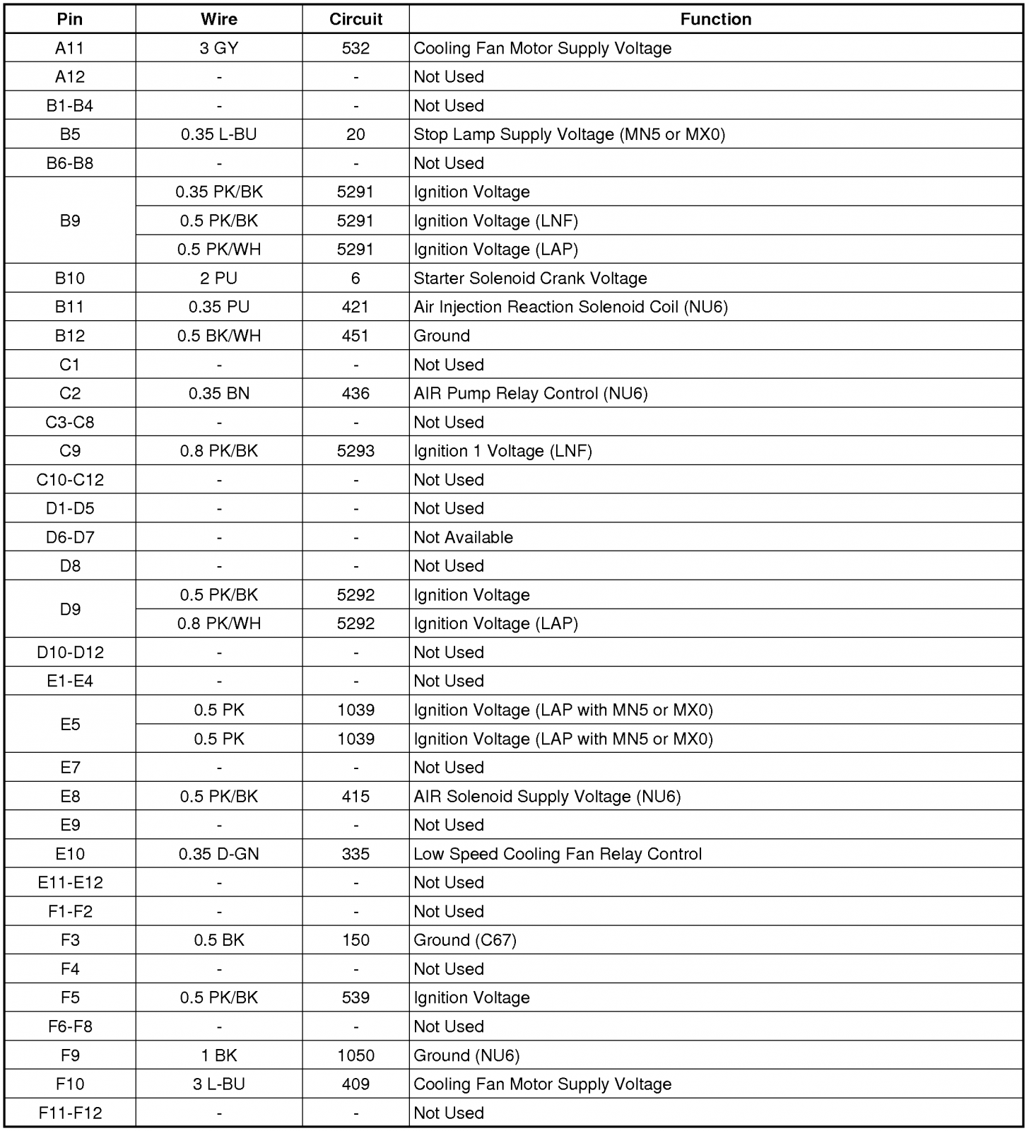

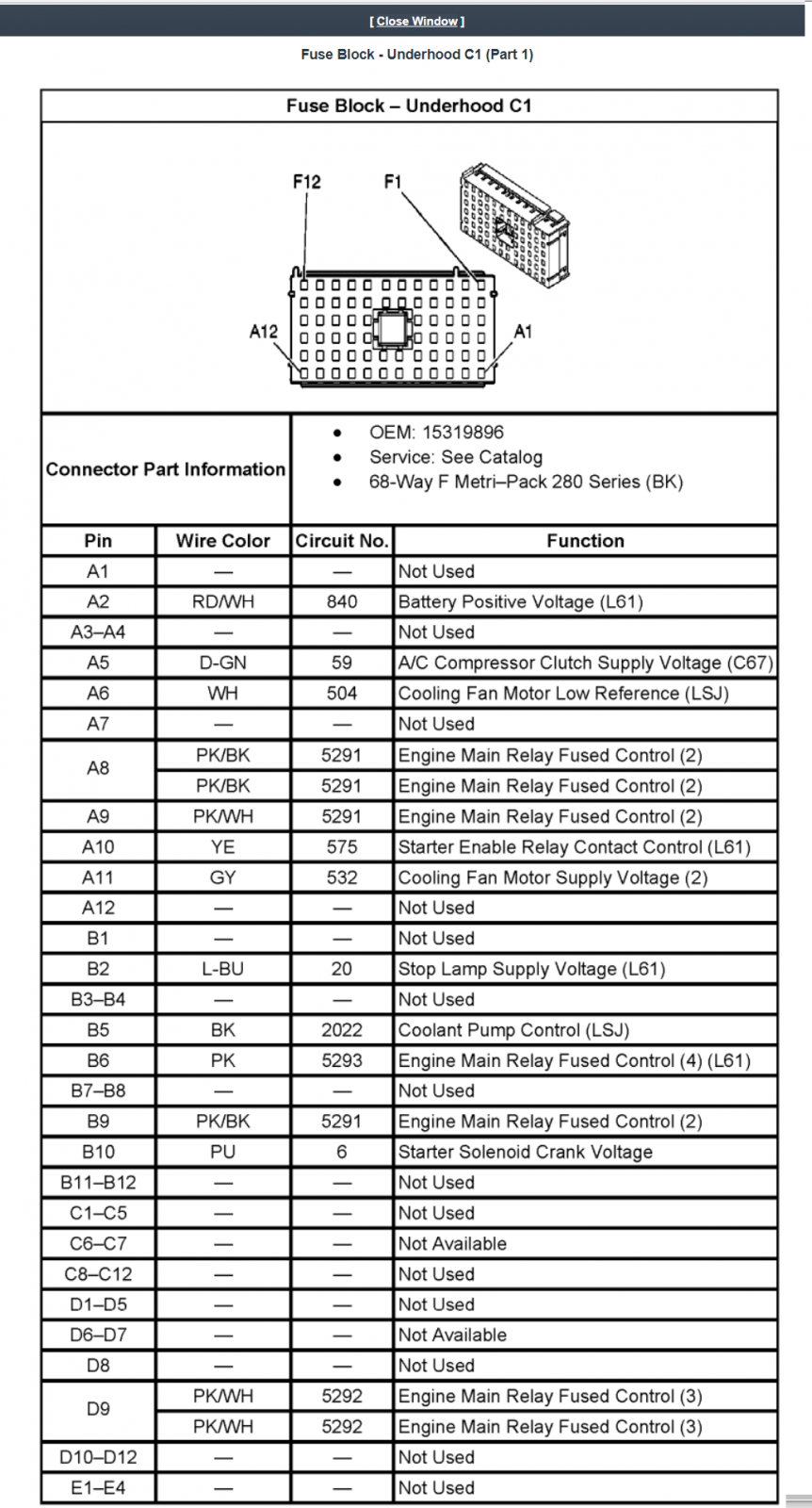

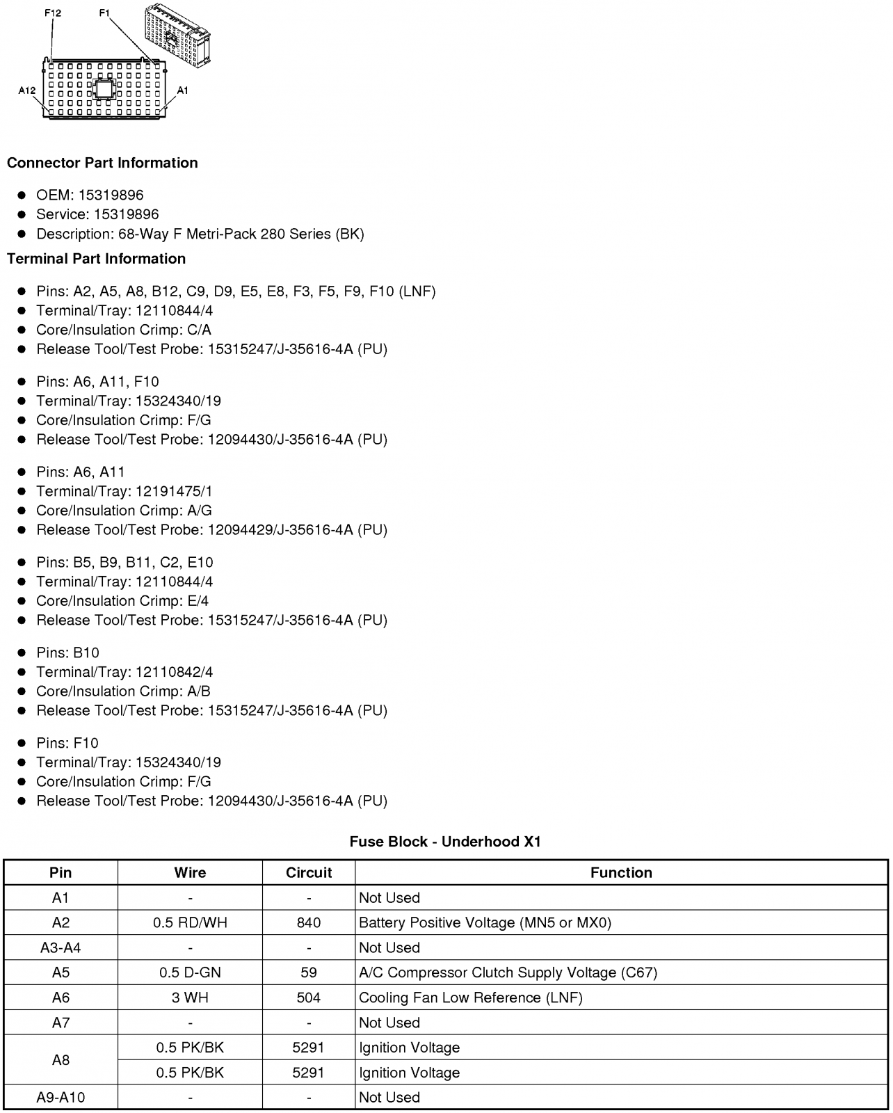

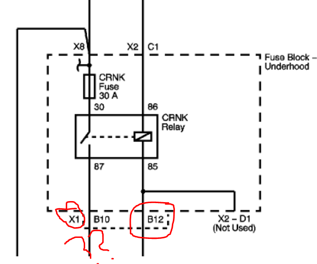

All those grounds should have ended up at G-105 back of engine stud. I think some of you put your ground wires on a chassis bolt under or near the fuse box.
Put in the relay, but leave it up just a little and connect a ground jumper wire to the ground lug on the relay. This will bypass the normal wire and should start the engine. If it doesn't start the engine then start checking the fuse box plugs and pins for non contacting gaps or bent pins. All the videos I sent show the ground connection at G-105 (up to maybe four wires connected together into a single mounting connector to the back of the engine bolt near the oil cooler. There were a couple of other videos that showed other areas to cause a no start.

*edit* To add, the answer to my question at the end was simply, "get better contact inside the fuse box". The ground pin in that relay had a poor/non-existent connection in the fuse box connector.

I just wanted to update everyone, I have been super busy the last couple of days but with the advice I've been getting from here and from Dale E, i've been able to make it run! I jumped the ground from pin 85 on the starter relay to a known good ground, and that was enough to get it to crank and fire up. More trouble shooting to do obviously, but I won't have time to get back to it for a couple days and wanted everyone to know that the help has been very much appreciated!
