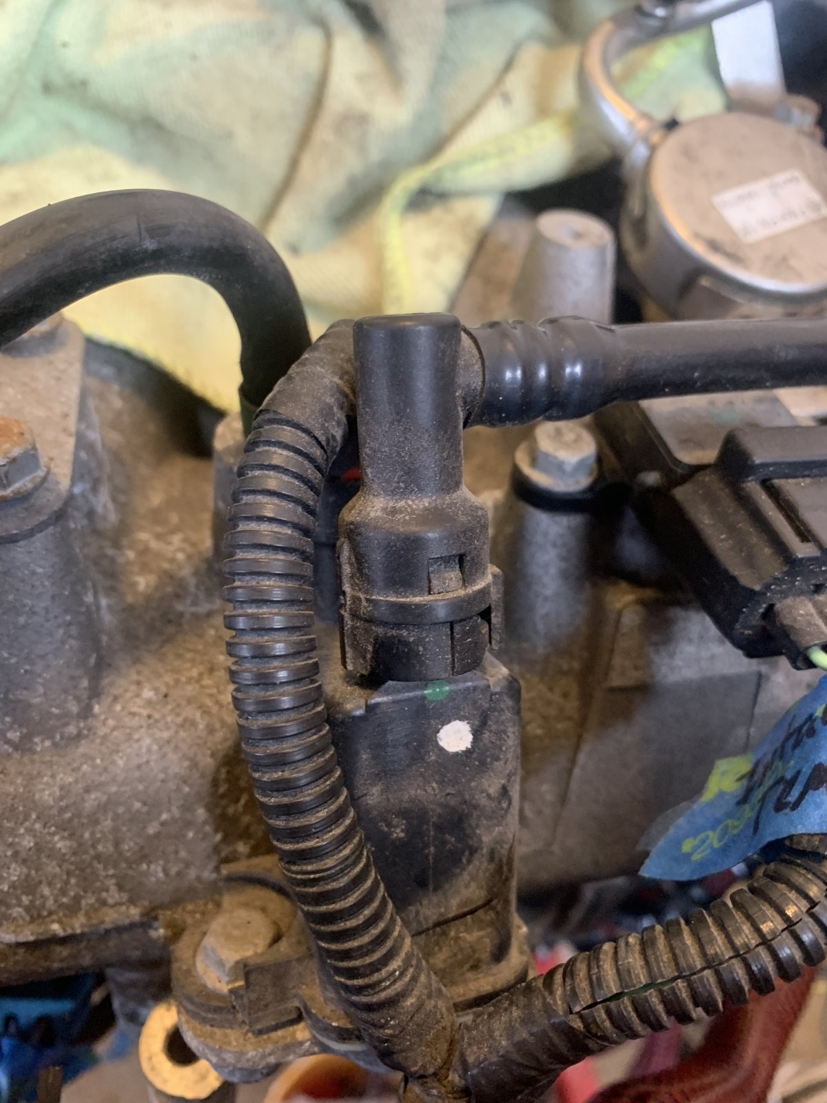

Hey guys, I am just going through my engine harness on my LNF and getting rid some wires and things I dont need to clean it up a bit. Like my AC wiring. My question is, do we need the evap purg solenoid that’s attached to the intake manifold, the wiring and hose? And also is there anything else I can get rid of? TIA guys!!
