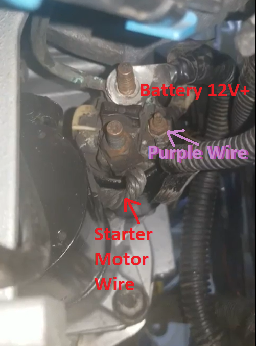

Positive Battery to starter to fuse box
and starter to alternator
Purple is the trigger wire.
Alternator ground just needs to be grounded to the block or frame.
Starter itself is grounded to the block as mounted.
Bare wire on starter is the "field" wire, basically the positive from the solenoid to the winding in the starter.
