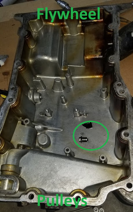

The LSJ has the oil pickup near the pulley side of the engine. The other ecotec engines may be different.
The circle is where I found some cam chain guide parts that didn't get past the oil pickup screen.

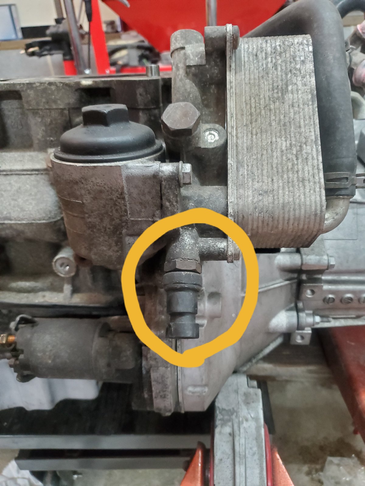

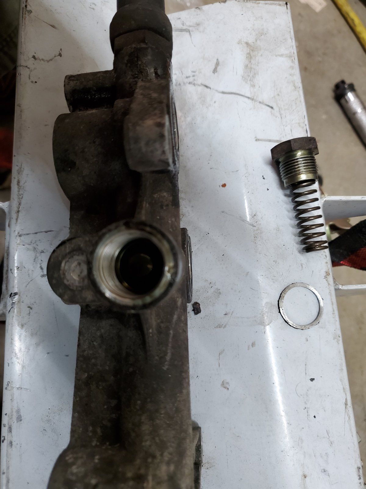

This looked like a good spot to tap into but appears to have some sort of pressure switch in it.
ccannx

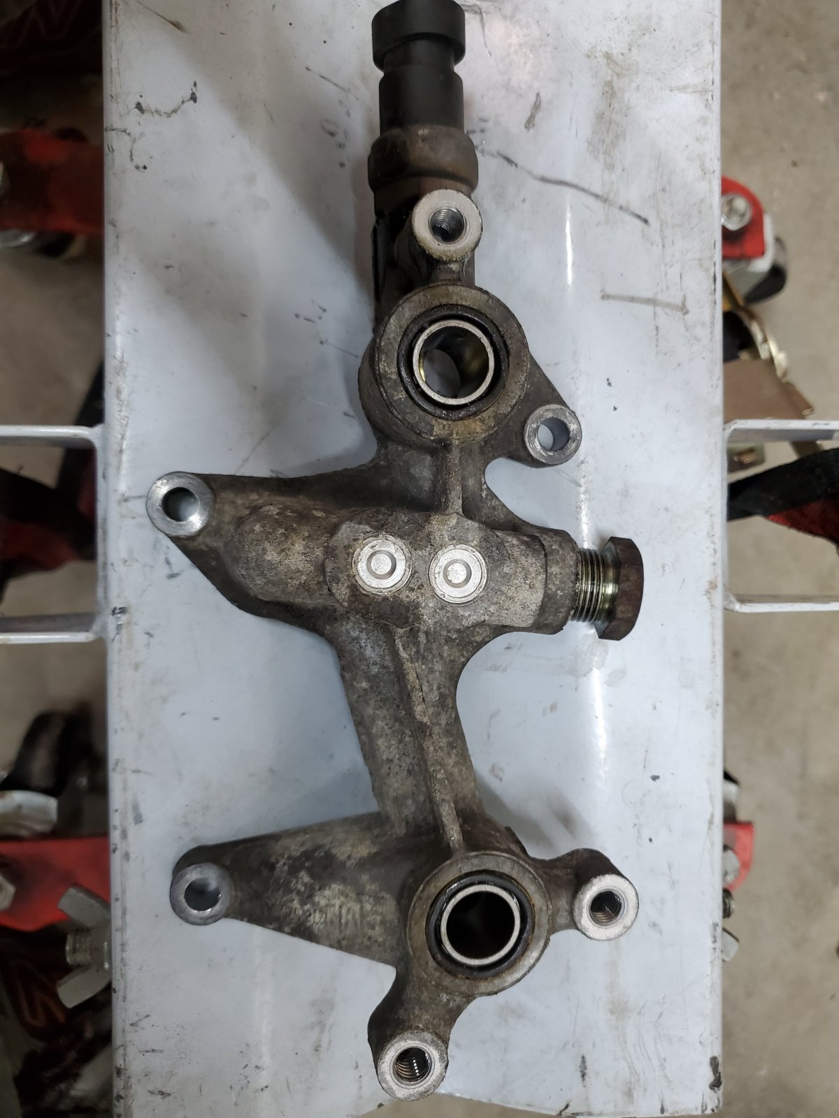

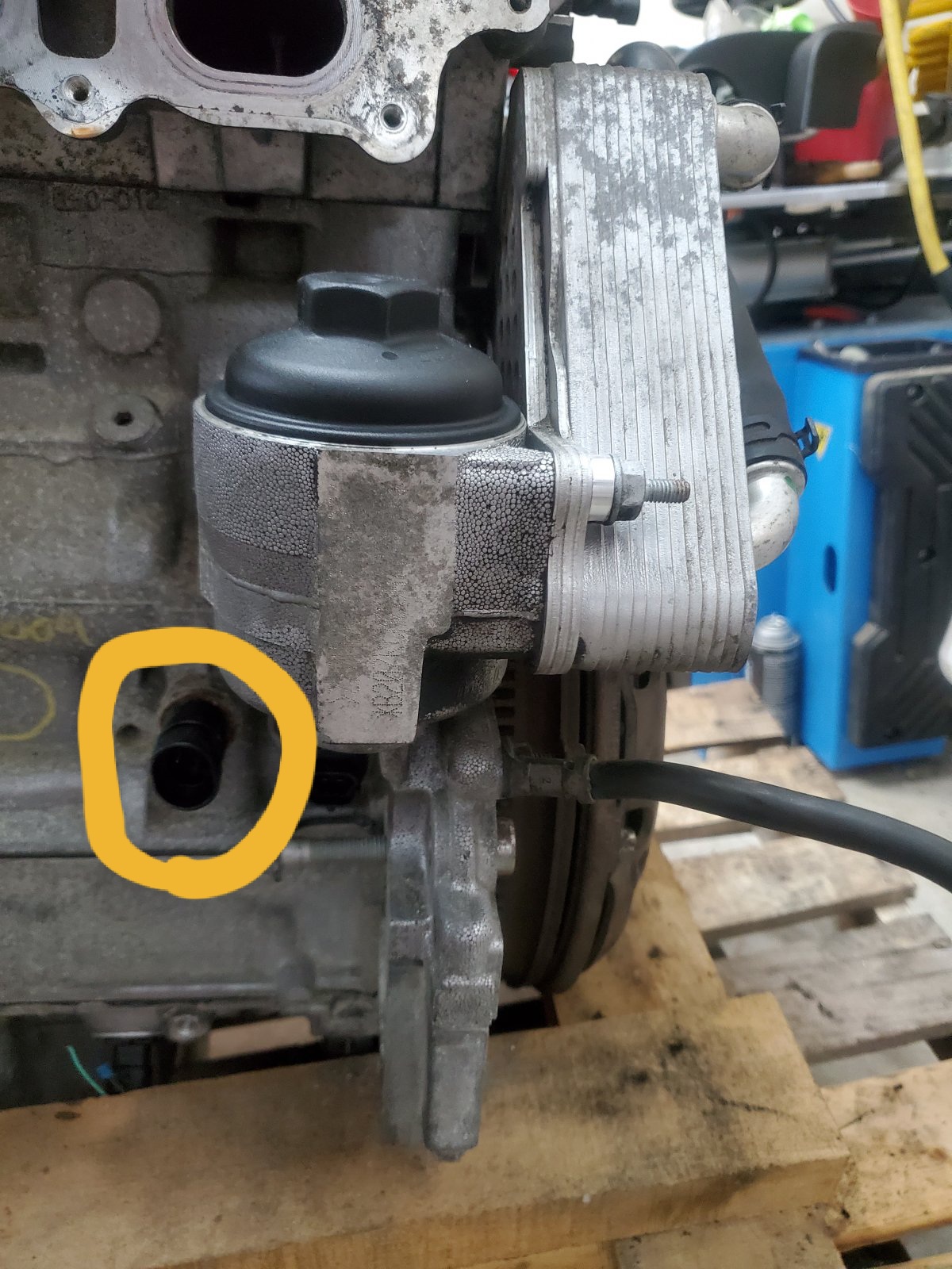

Looks that way, either heat or pressure driven. Looks like oil is pumped to that port from the timing chain cover driven by the crank then it goes through the cooler or overcomes that switch to the oil filter housing. The b207r cooler mounts directly to the motor and the oil pressure sensor is in between the knock sensor and crank angle sensor. Ross posted about it here : https://dfkitcar.com/forum/index.ph...ry-goblin-06-ss-sc-nw-arkansas.847/post-28302. Maybe the accusump can be connected right into the LSJ oil sensor location and the location by the Crank position sensor can be used for the oil sensor.

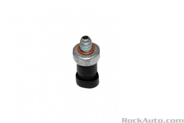

The oil sensor has such a small port for just reading pressure, you really want a port around 1/2-5/8" to flow enough oil in the case the system starts to drop pressure.
Fozda
The sensor is deceiving because the hex is so large but it's a pretty small fitting so it wouldn't be able to flow enough to maintain system pressure.
What's nice is that the sensor actually screws into a 1/2 adapter
