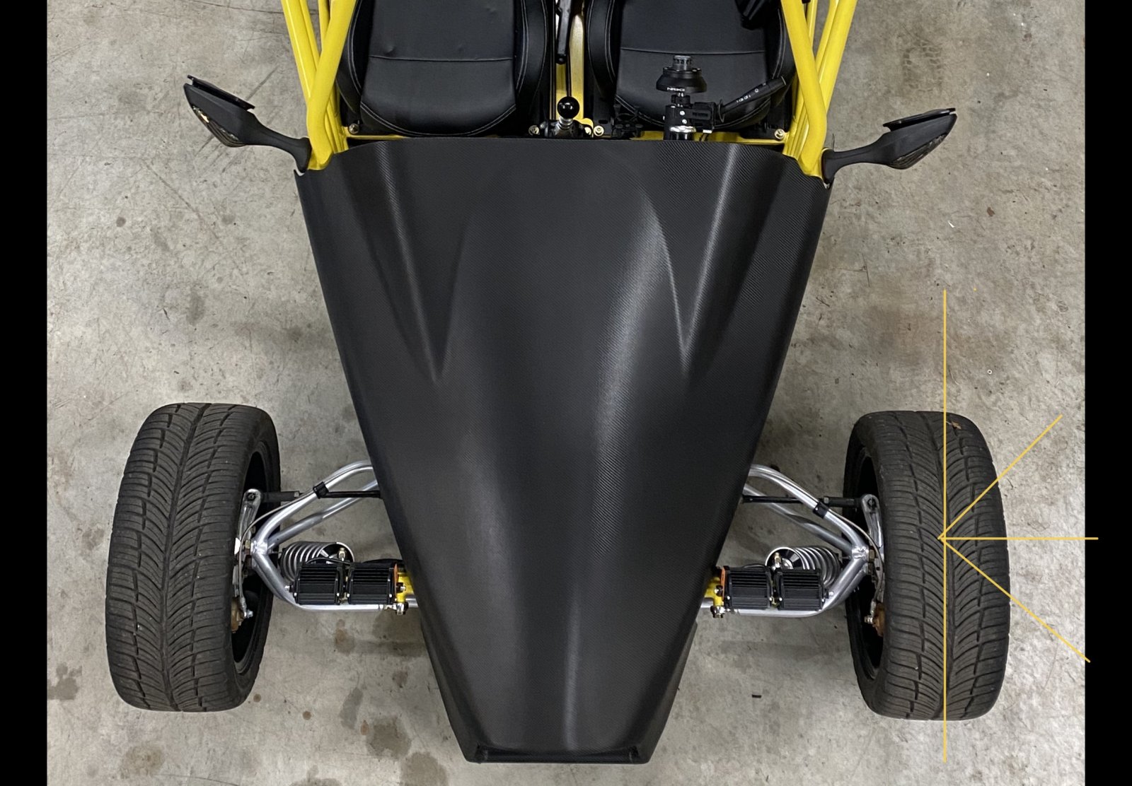

Proper alignment makes a huge difference. I finished the DIY alignment to approximately these specs for both front and rear:
Ride height: Lower control arms level
Camber: -0.5
Toe: 1/8" in
Caster: ¯\_(ツ)_/¯
Took it out for a quick spin and I'm very impressed. It tracks straight now without the nervousness over rough road and elevation changes. Threw it around some corners and it feels like it's on rails. The harder I turn in, the better it corners. Man it feels good. It does need more power though. Now that it feels solid, I want to be able to break the rear loose with throttle. Next season goal: ~260hp
neodied
DF recommended castor is 8+/-1 degrees negative (that's leaning toward the back). Maybe you got lucky and have the castor within limits, if you followed the recommended set up for the UCA/LCA. Good work!
I did follow the DF guidelines, but I don't have turn plates to measure that angle correctly. Doesn't seem like a huge priority to tackle at the moment since the driving dynamics feel good enough. Eventually I'll probably take it to a racing shop nearby that does alignments for custom builds. My boss built a rock crawler and got his done there with good things to say.
neodied
Going out for another run tonight, I noticed that my dipstick had popped out from a previous drive. My valve cover port is plumbed into the intake barb as intended (didn't block it off), so I'm guessing the PCV valve needs to be cleaned.
You don’t exactly need the turn plates. The front end is light, so the tires don’t grab on a slick garage floor. If they do put a piece of cardboard under the tires so they slide better. To get your 20* turn each direction, you can use painters tape on the floor to make your measurements. You’ll find it’s close to one revolution of the wheel. Then just use an angle gauge.

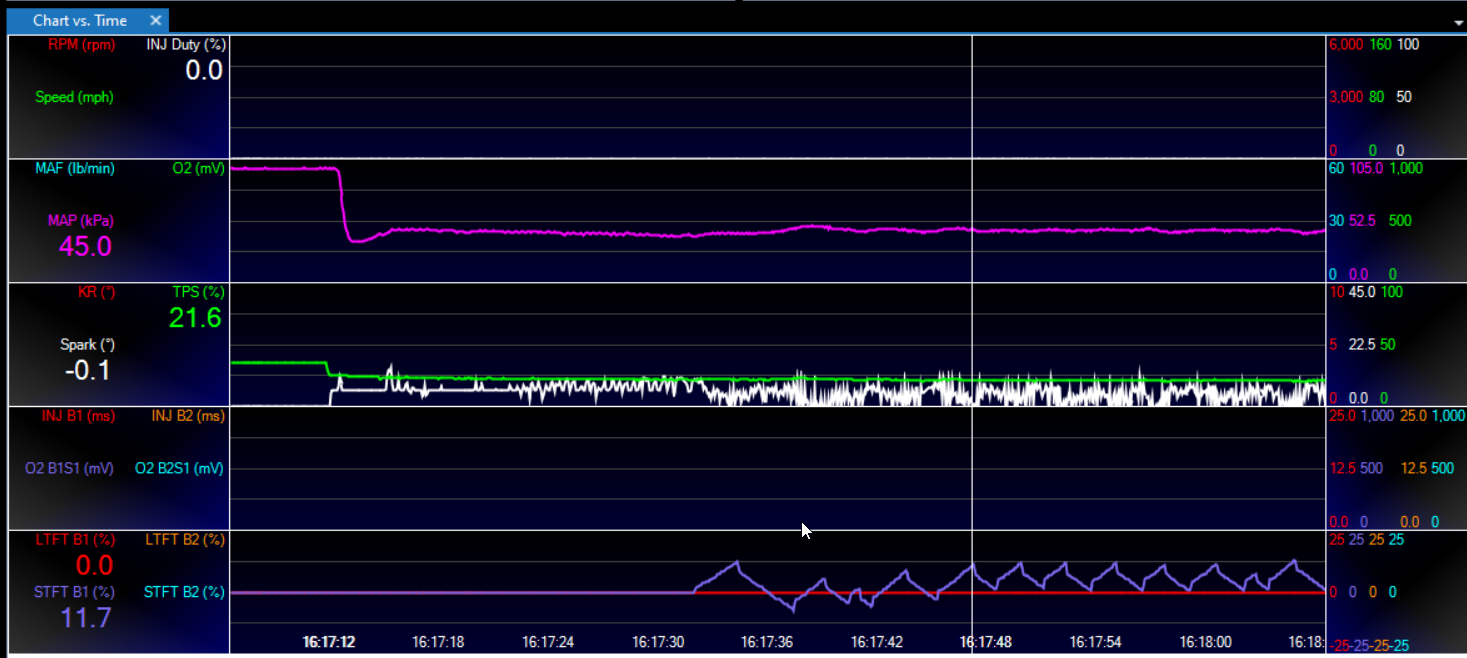

I tempo-perma-rarily wired in the AFR sensor, gauge, and HP Tuners data logger. Just to satisfy my curiosity, I took a short log of crank and idle. And to my untrained eye, the behavior of the spark timing and Short Term Fuel Trim looks.... interesting...
42994
I could definitely hear the oscillations as well. It looks like STFT hits a cap at ~12%.
I didn't have the AFR analog input mapped correctly in this data, but watching the gauge showed oscillations from 14.2 to 15.5 or so during this period, which makes sense to me if the STFT is positive, adding fuel to try to compensate for the lean AFR.
Seems like it's fair to assume that this is sub-optimal behavior and I should try to tune it to not use so much STFT and stick roughly at 14.7 without oscillation at idle. I'll be watching some Goat Rope Garage to learn what knobs to start fiddling with.
I don’t know the particulars of tuning the lsj but if the other parts of the tune need tweaking, the ECM will adjust spark to hold the idle. Spark is the quickest reaction to adjust that it has for idle speed adjustment.
STFTs don't look suspect to me. That's how it dials towards stoich with a sensor that can only read like 14.6-14.8, is to shoot high and then low and target oscillating around stoich with each swing. If it shoots high and then low and never reads rich, then it knows it's lean. Eventually, though, those oscillations should center right at or around stoich. LTFT should be the way it re-centers the oscillations. Looks like you don't have any LTFT at the moment, which could either be because they're turned off in the tune, or it hadn't idled long enough to start getting into LTFT.
If you log B1S1 O2 voltage, it should swing up and down as well.
