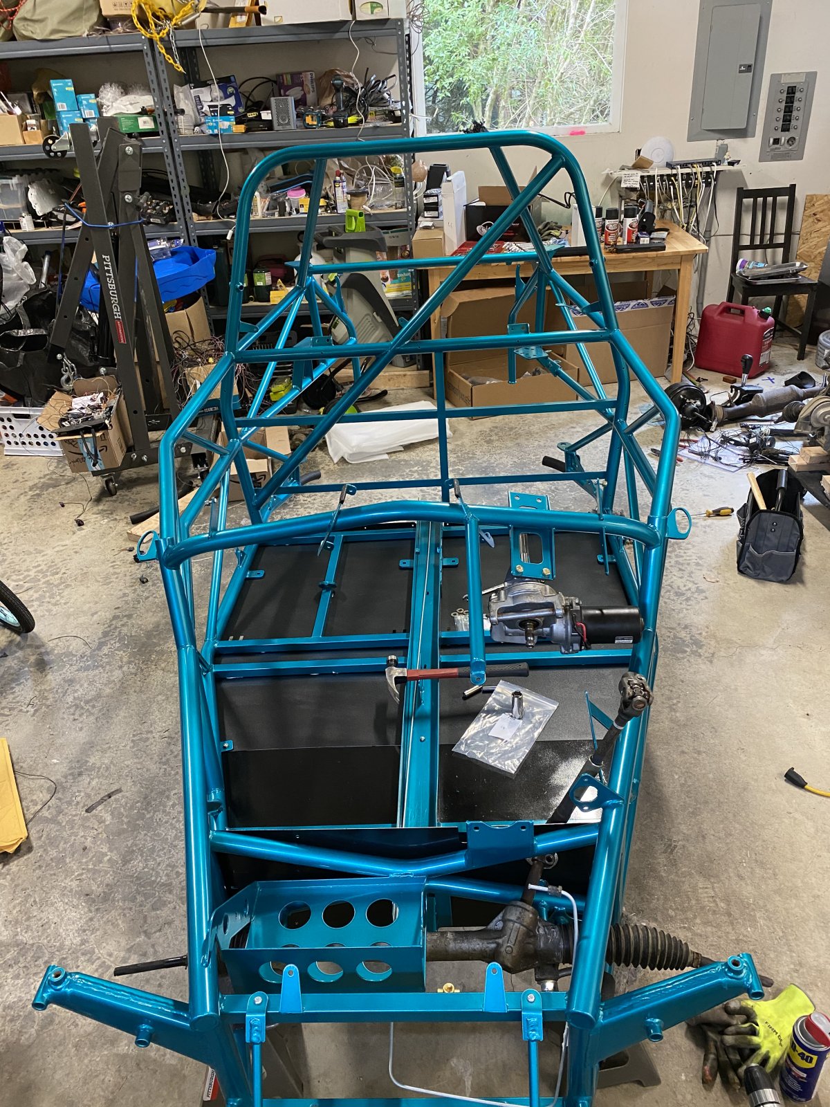

It's been a busy few days at home with a new job. But I managed to get the floor pan installed and got the steering rack in place. I'm waiting on a tool to remove the inner tie rods and replace them with new ones that I purchased and then will add the DF supplied outer tie rods.

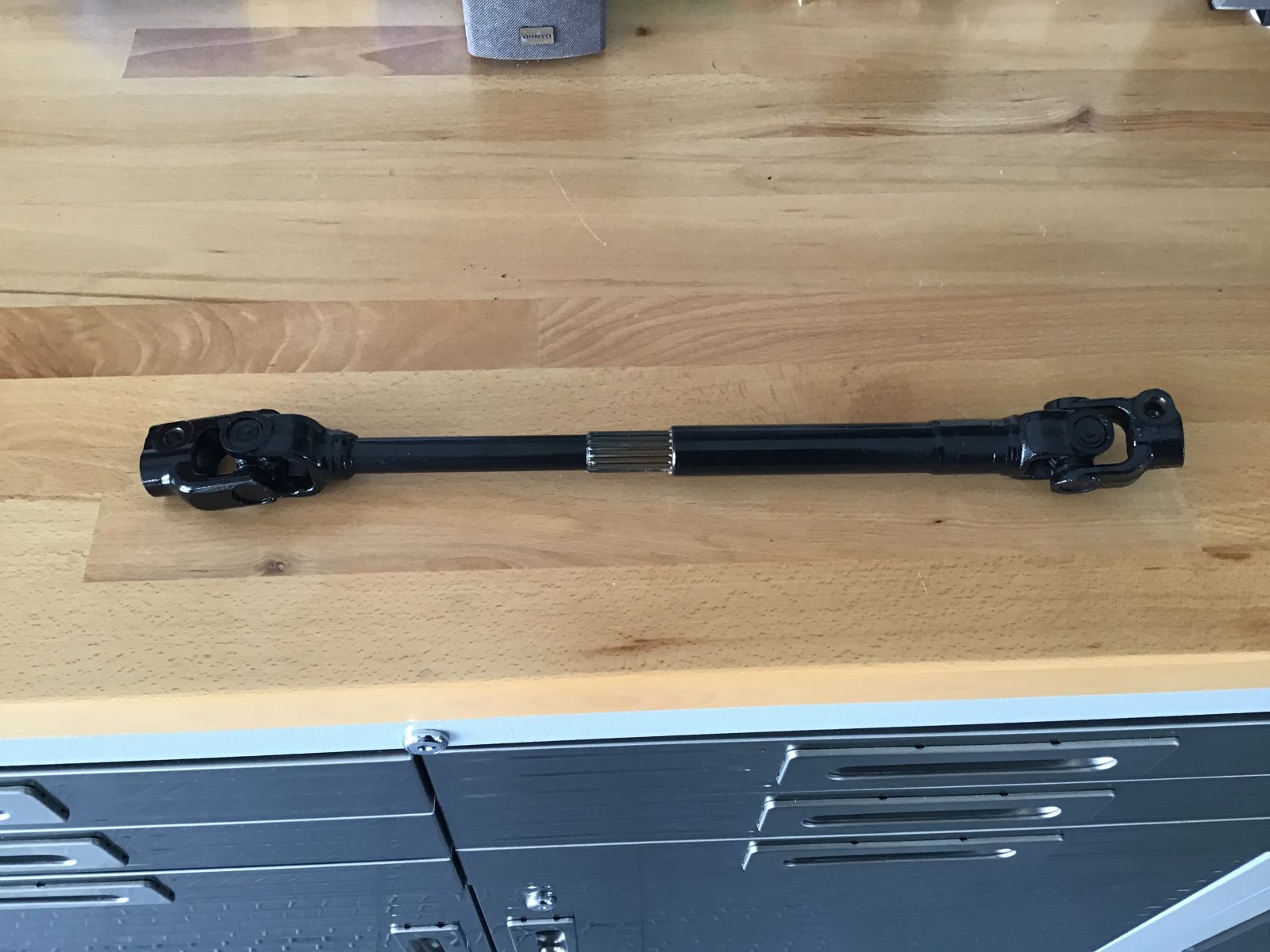

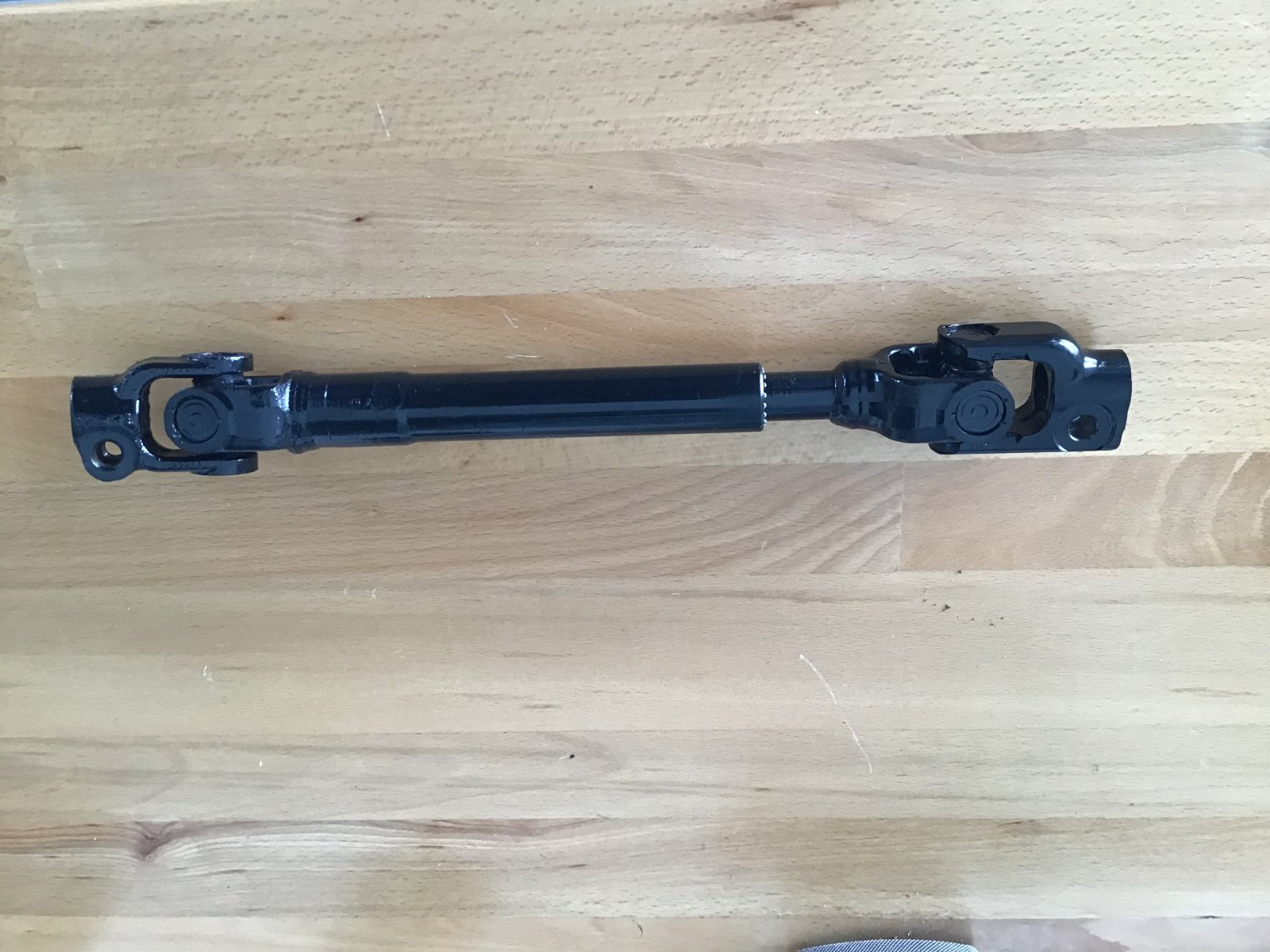

As I'm working on the steering shaft, I'm having some trouble collapsing it to get it to fit between the steering rack and power steering unit. I've tried a heat gun and WD-40 on it. Gonna keep trying that, but I've found a replacement unit on Ebay that I might need to pick up sooner rather than later to continue building.
Zoom Zoom

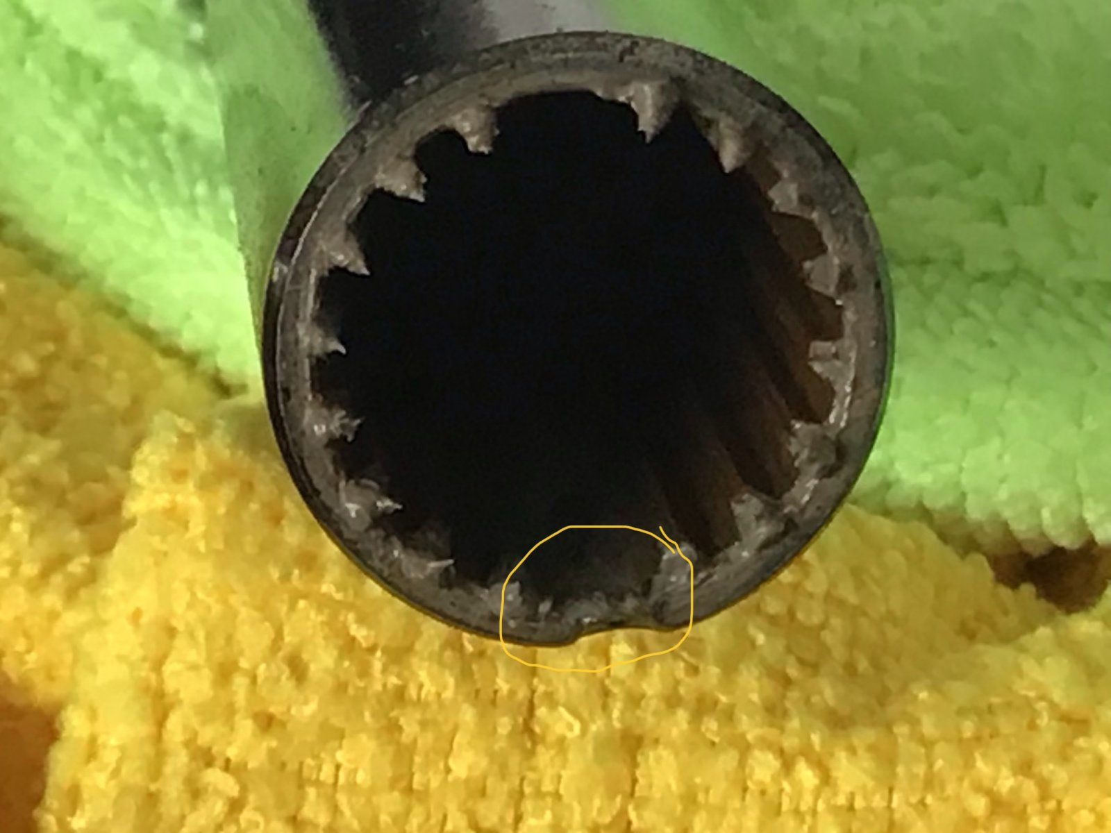

Try pulling it apart and then grind off that little tip and then put back together after you cleaned and new grease, Mine came apart when I dropped motor, Tie to back of lawn mower and something solid and pull apart, easy after that.
see how far it will collapse
GRIND OFF LITTLE TIP WITH A DREMEL TOOL

Y
It took about 2 hours for me to pull it apart. It is held by coked old grease inside. Heat and little force will help.
Start with drilling out pinched point on the edge. Then heat it up to good temperature and try to squeeze it. You can use hammer over wood, but do not stress joints! I used wise hold thinner part and used some force on thicker one to press it in. Once you able to move it a little - all the rest it just time and patience.

I may do that because I had a ***** of a time snaking mine out of the donor car, I don't wanna screw around with it... 33$ is cheap for the lack of frustration.
I spent a couple of days on that thing over the winter. Mine was seized up and after some heat and using a winch to pull the two pieces apart, it still wouldn't collapse all the way. When I pulled them apart, it made a popping noise. I finally kept digging at the bottom of the female part to remove all the rust down there and once it was completely clean, it would collapse all the way and hit bottom. The popping sound was gone. If you are experiencing similar issues, you are very close to having a working part. Hope this helps!

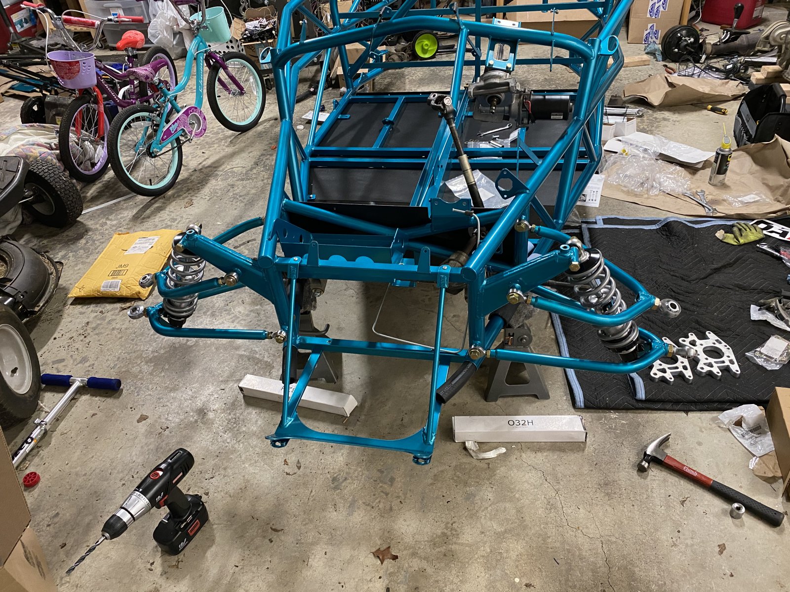

I been itching to work on the car, unfortunately after an hour with that steering shaft, eBay got some money. Then I went to change my inner tie rods, and I didn’t have the right size tool... so, I skipped ahead and worked on the front suspension. At least I can show progress!

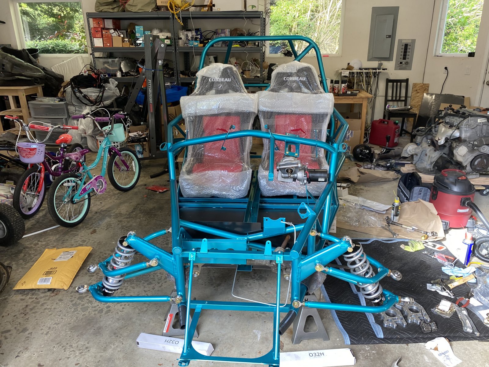

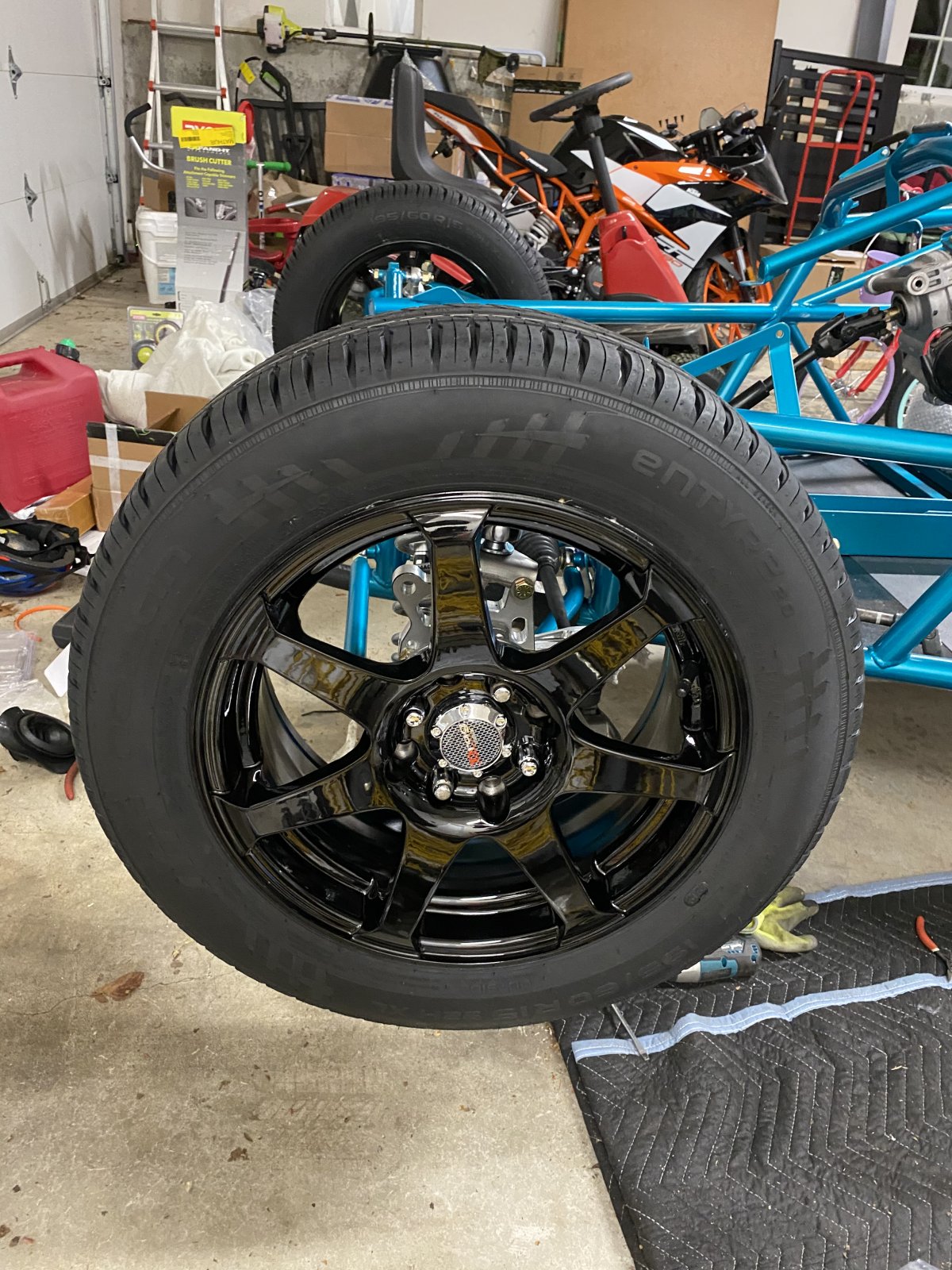

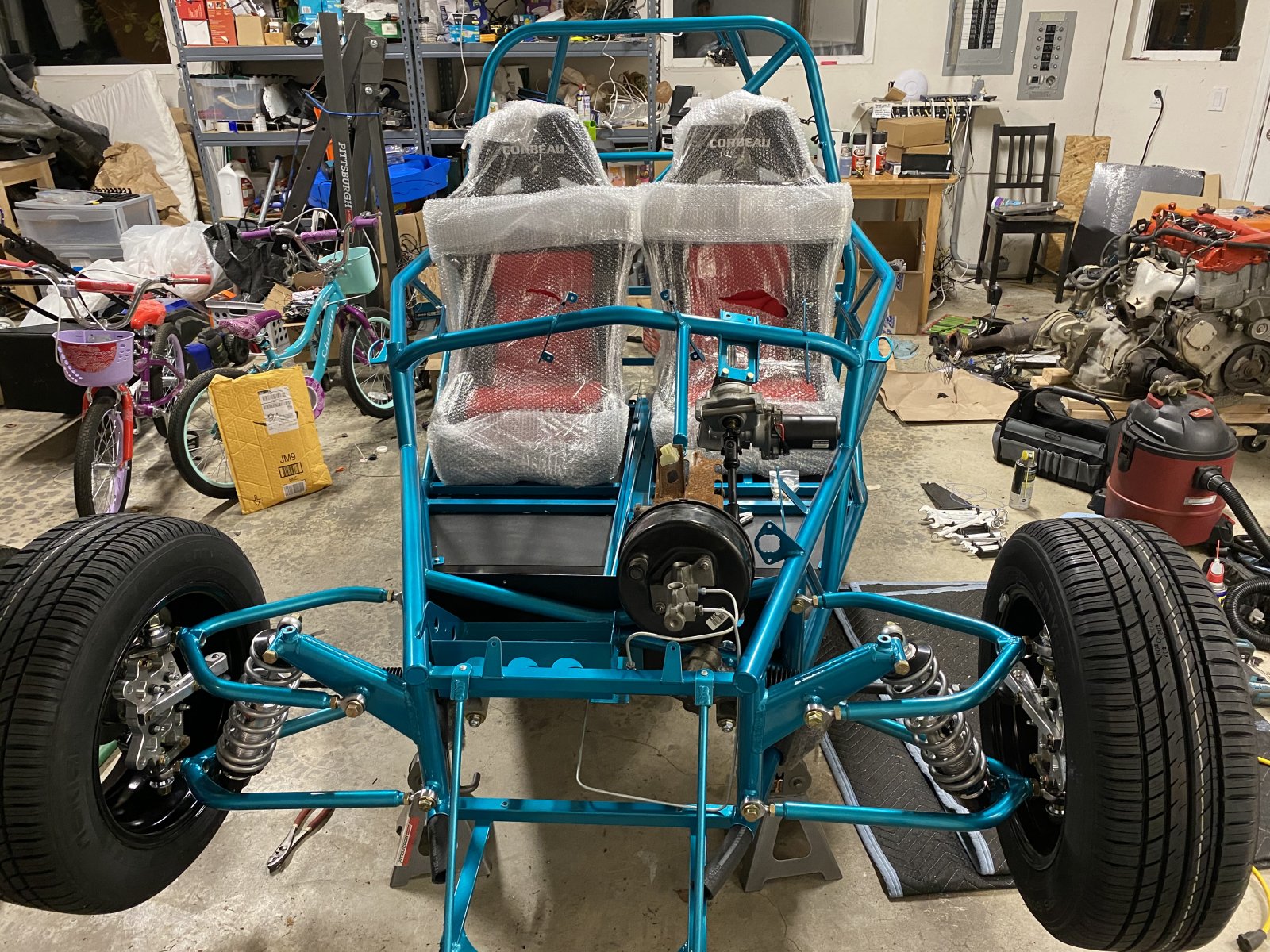

Seats are here! The red pops against the teal frame nicely, the red calipers and red valve cover will really bring it together. I’m also thinking of adding red lug nuts for a little more flair :)
13547
and, yes, I’ve got the DF supplied tie rod end boxes at the front and the replacement donor boxes in the back so I don’t forget.

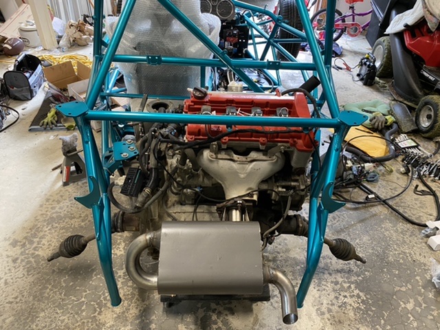

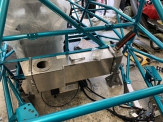

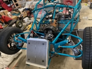

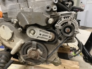

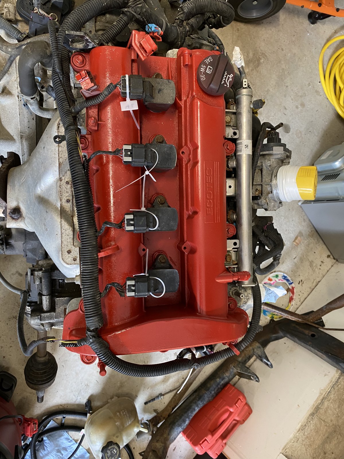

It’s been almost a month since I last made progress, but today I knocked out a bunch of things and got the wiring harness, bcm, radiator and fuel tank all in place.

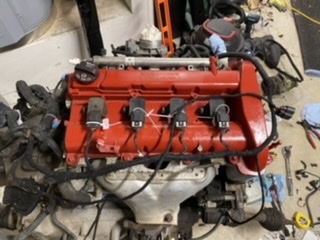

I’ve got some clean up on the engine to do, so aiming for engine installation next weekend! Anyone know what the length is for the M10 bolts that I need to use for the engine? I know it’s the bolts from the seats, but those are in my big box of bolts... thanks!
