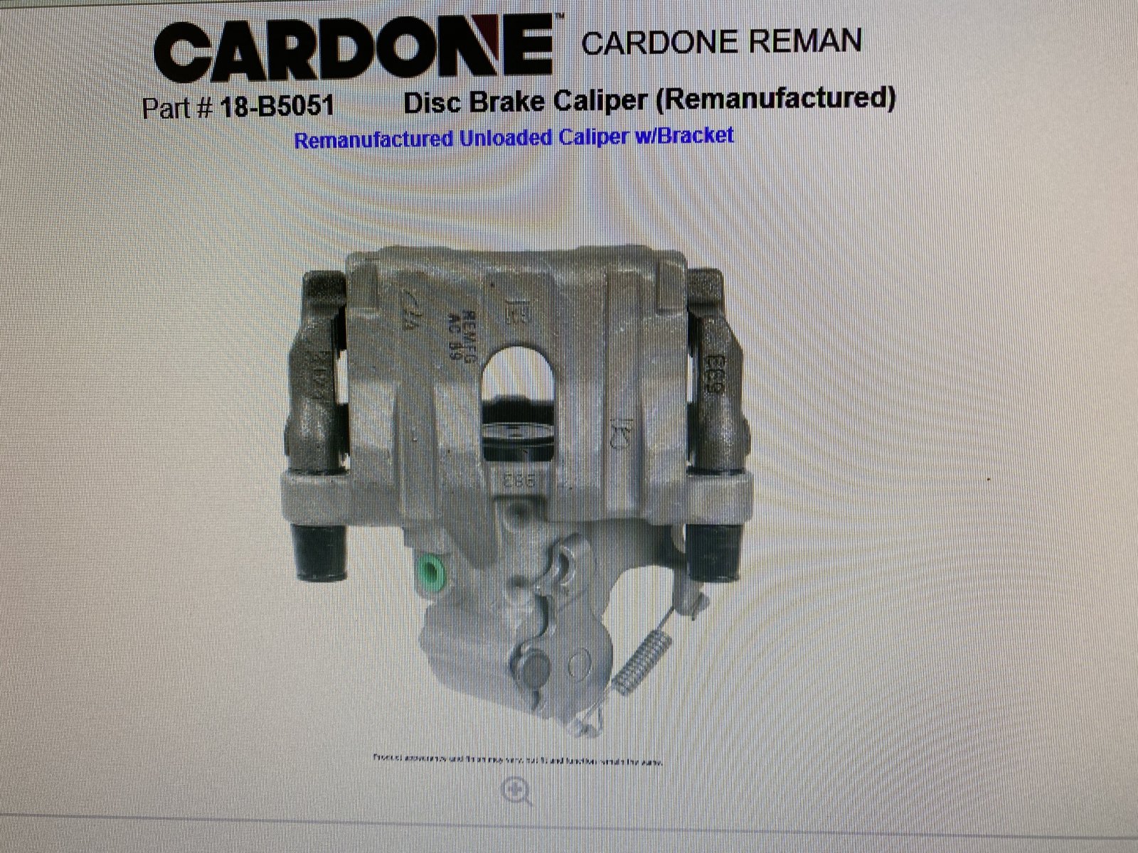

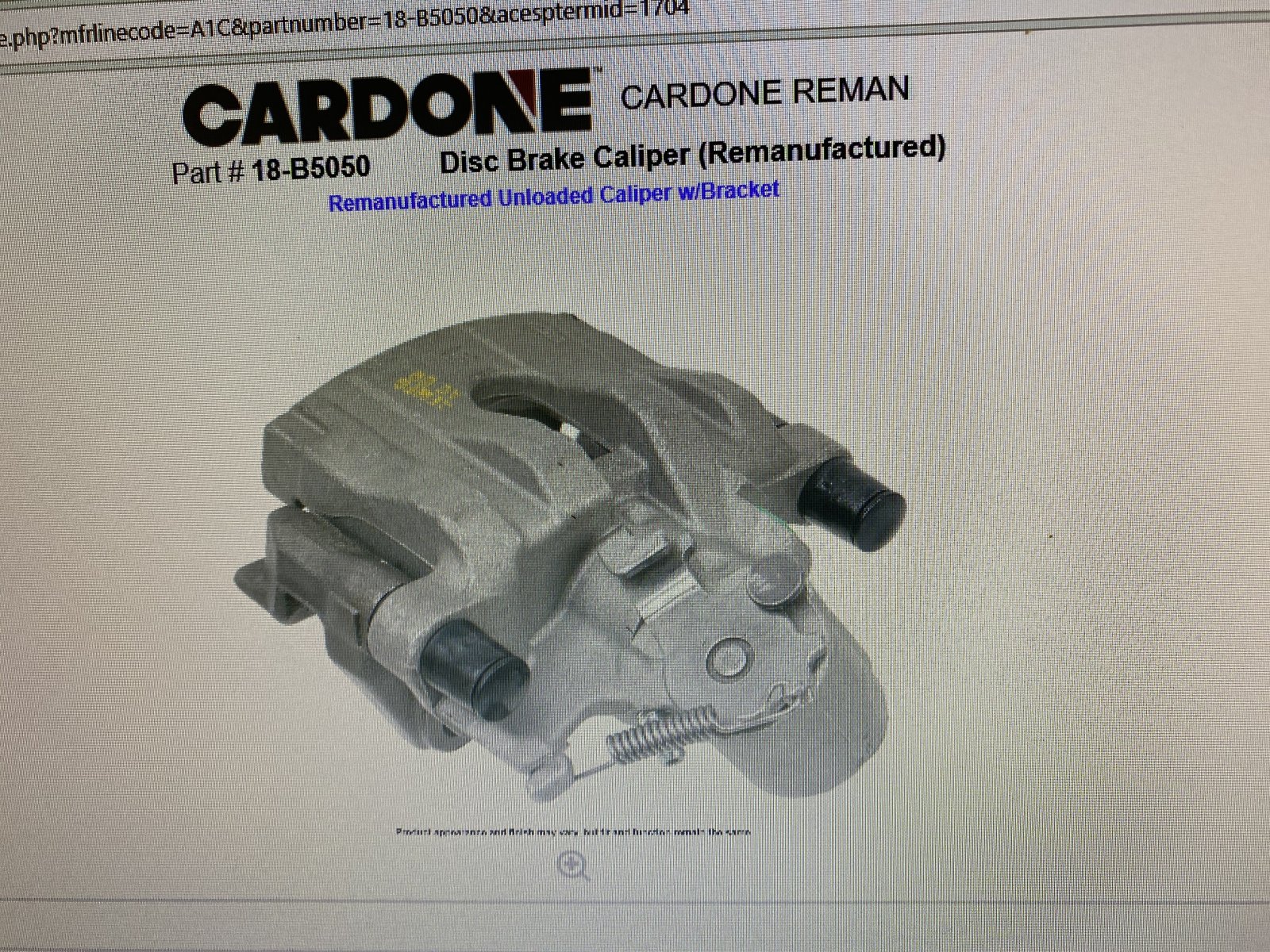

I believe the solstice calipers are machined by DF to add the ebrake mount, so you wouldn't be able to just purchase solstice calipers unfortunately.
They look like stock solstice calipers to me
Looks like the parking brake kit was missed on my packing list, that's why I got the regular calipers and no hardware.
It's not my intention to report on errors made with my kit here, I just want to be clear on that. Also want to be clear: DF has been great and has resolved every issue I've had perfectly, even my self-inflicted ones. So shout out to Adam and Lonny on that. They've been an example of the best support in the business.
baustin
The caliper is stock but DF machines the mounting brackets. The outer corners near the mounting bolts of the bracket wouldn't clear the steering knuckle (or something in that area) without this modification, probably could angle grind it to achieve a similar result.

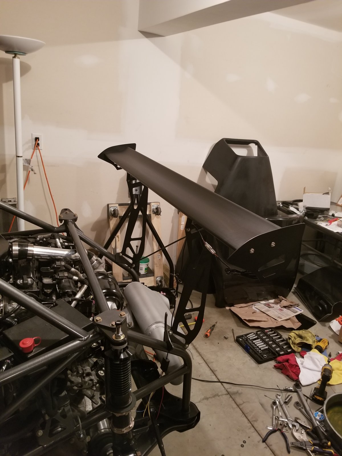

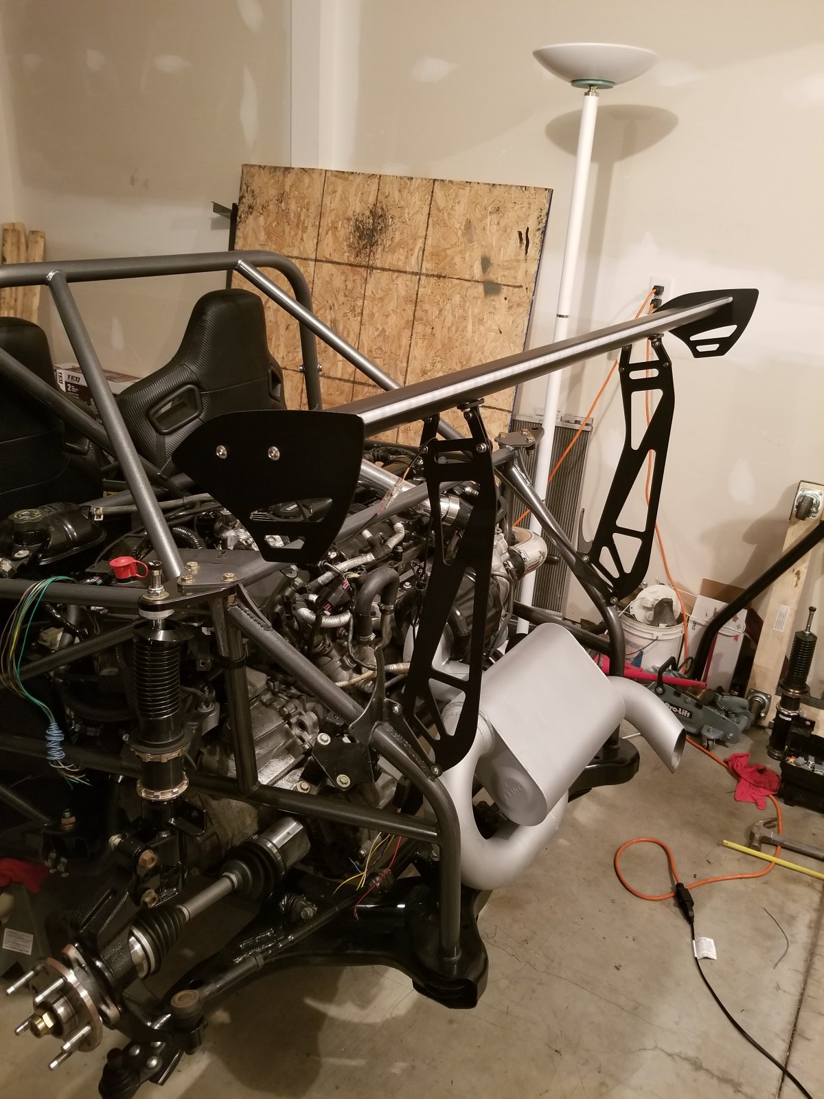

I don't think I reported on it in this thread, but I mounted my wing. 53" long, with a built-in third brake light and turn signals. It was cheap ($180 something) and I don't love the look of it, but it'll be one of those items that goes on the Upgrade List for Later.

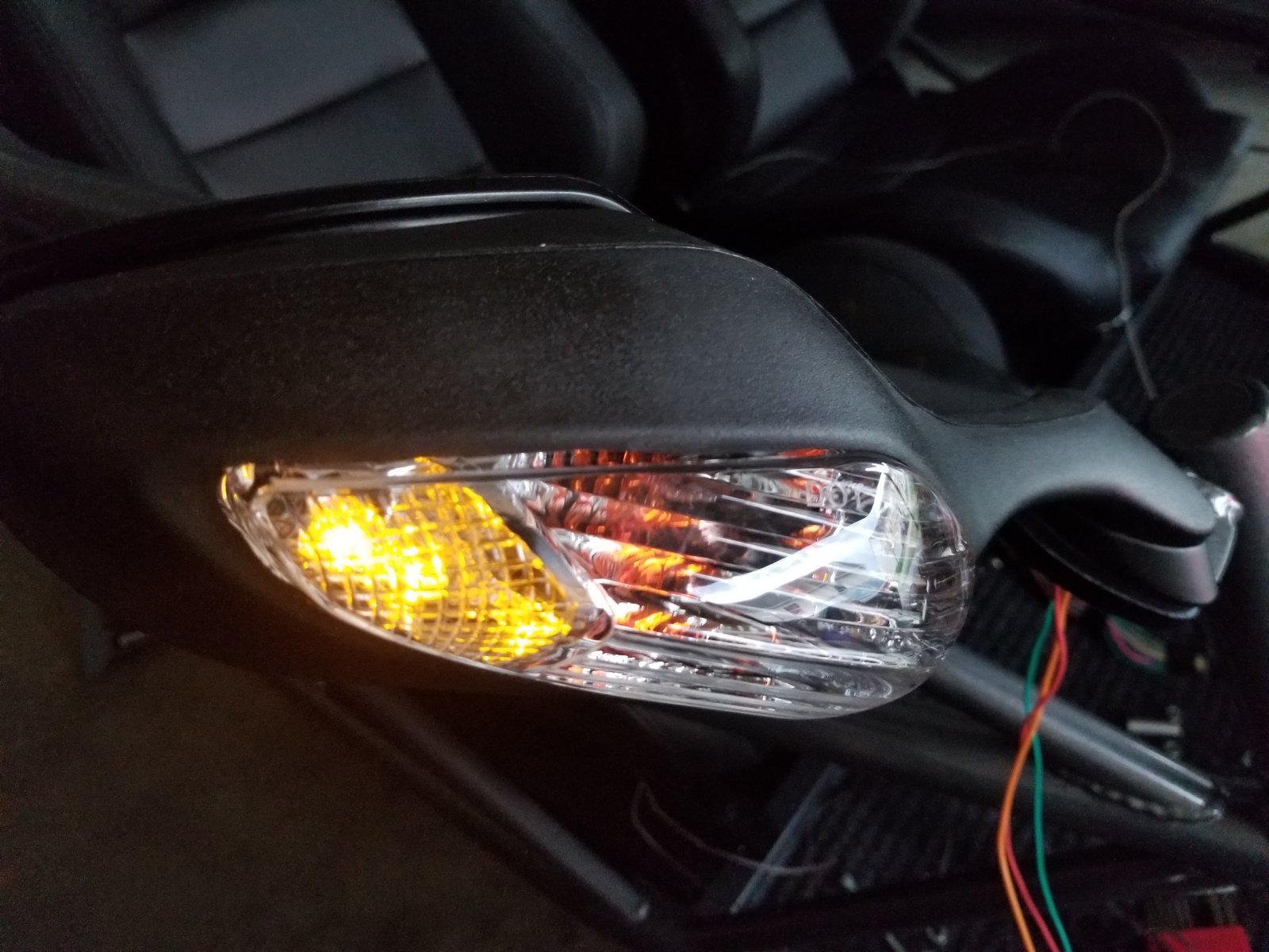

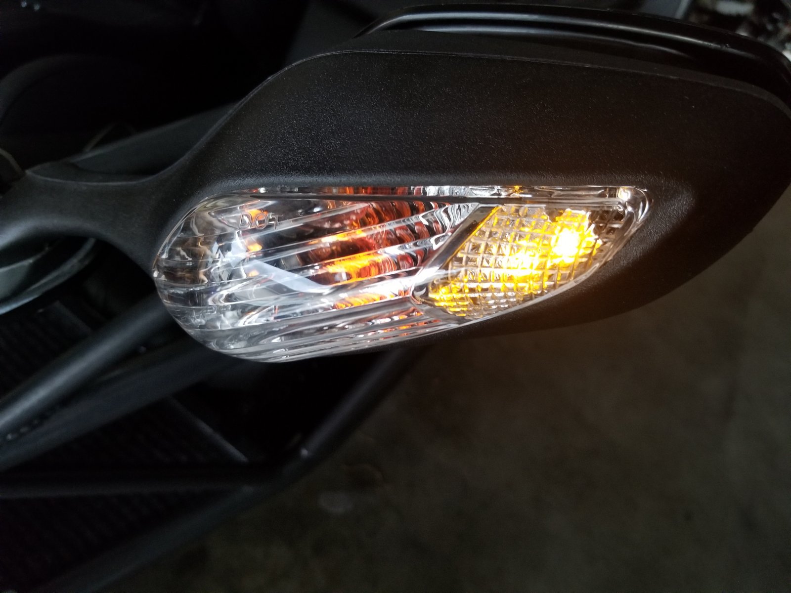

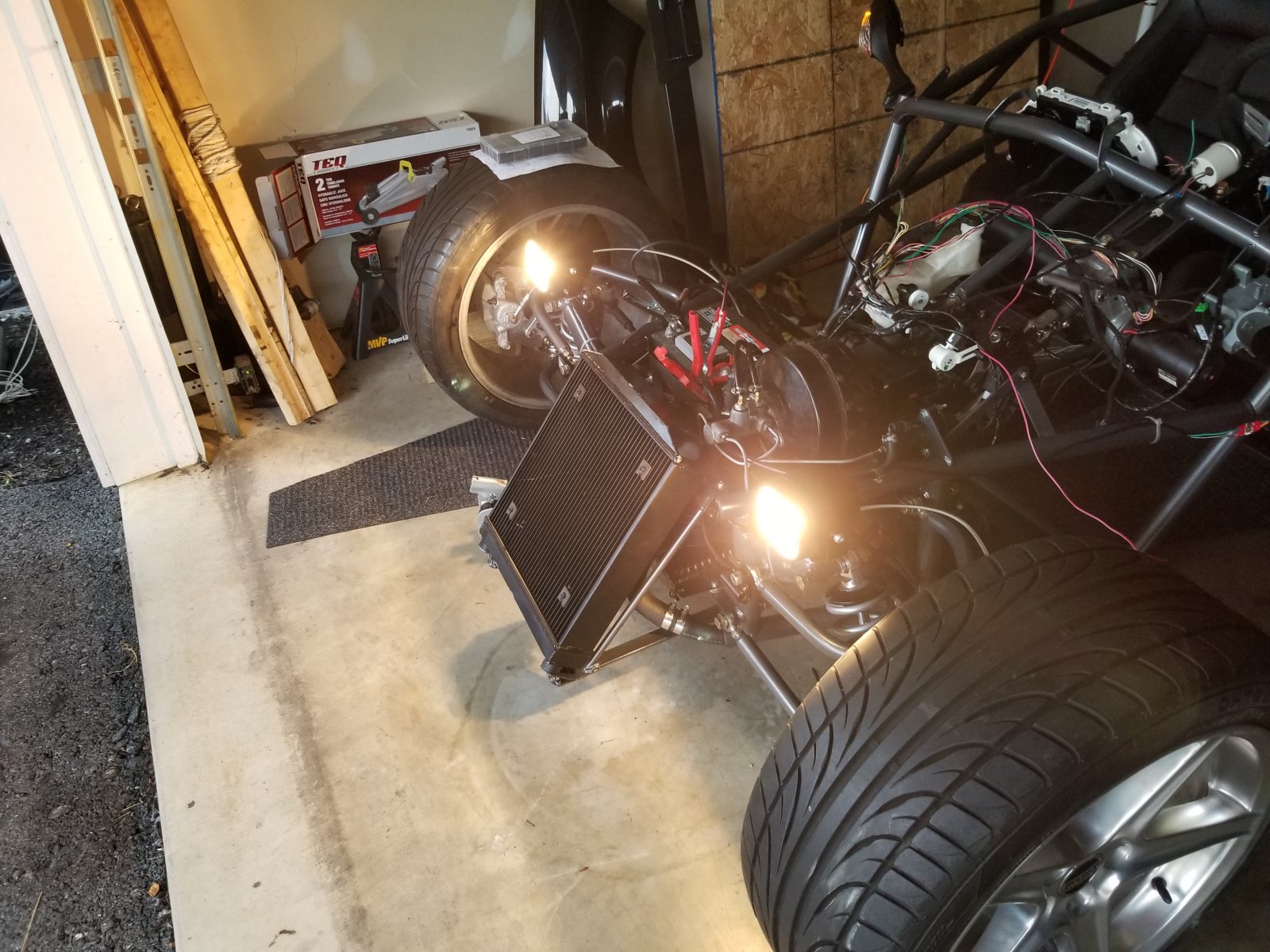

Today, I mounted the headlights (another upgrade item for later, I think) and mirrors, and wired them up. I also corrected a months-old mistake I made with the wiring; I had accidentally ran the turn signal wires to the headlights and the headlight wires to the turn signals. It wasn't too bad to fix, just had to strip off a baseball-sized wad of electrical tape, re-run a few wires, and tape it back up. I do, however, still have a small wiring problem that I will try to fix when I am feeling ambitious ... instead of (ground, parking lights, low beam, high beam) running to my headlights, I seem to have (ground, parking lights, parking lights, high beam) instead. I have no idea where my low beam wires went. Functionally it works, it's just impossible to have the parking lights on without the headlights, and both positions on the headlight switch do the same thing.

What wing is that? I actually like how it looks and the lights are a nice bonus.
It's THIS one.
You're in luck, the price has fallen through the floor for some reason. It's only $103 right now; I paid $180. Here's a VIDEO of the lighting. I don't intend to use any of the cheesy effects, just the third brake light and turn signals. It's nice because it's universal, there's no futzing with trying to make an adapter. It comes with mounting points that slide in and can be positioned anywhere on the underside of the wing.
The QA isn't great though, mine was missing a bolt and they're not easy to replace because they're very short.
On a positive note, now that it's dark outside and easier to test, I don't think I screwed up my wiring at all except for swapping the parking light +12v and the low beam +12v when connecting the headlights. I'll fix it tomorrow and re-test.

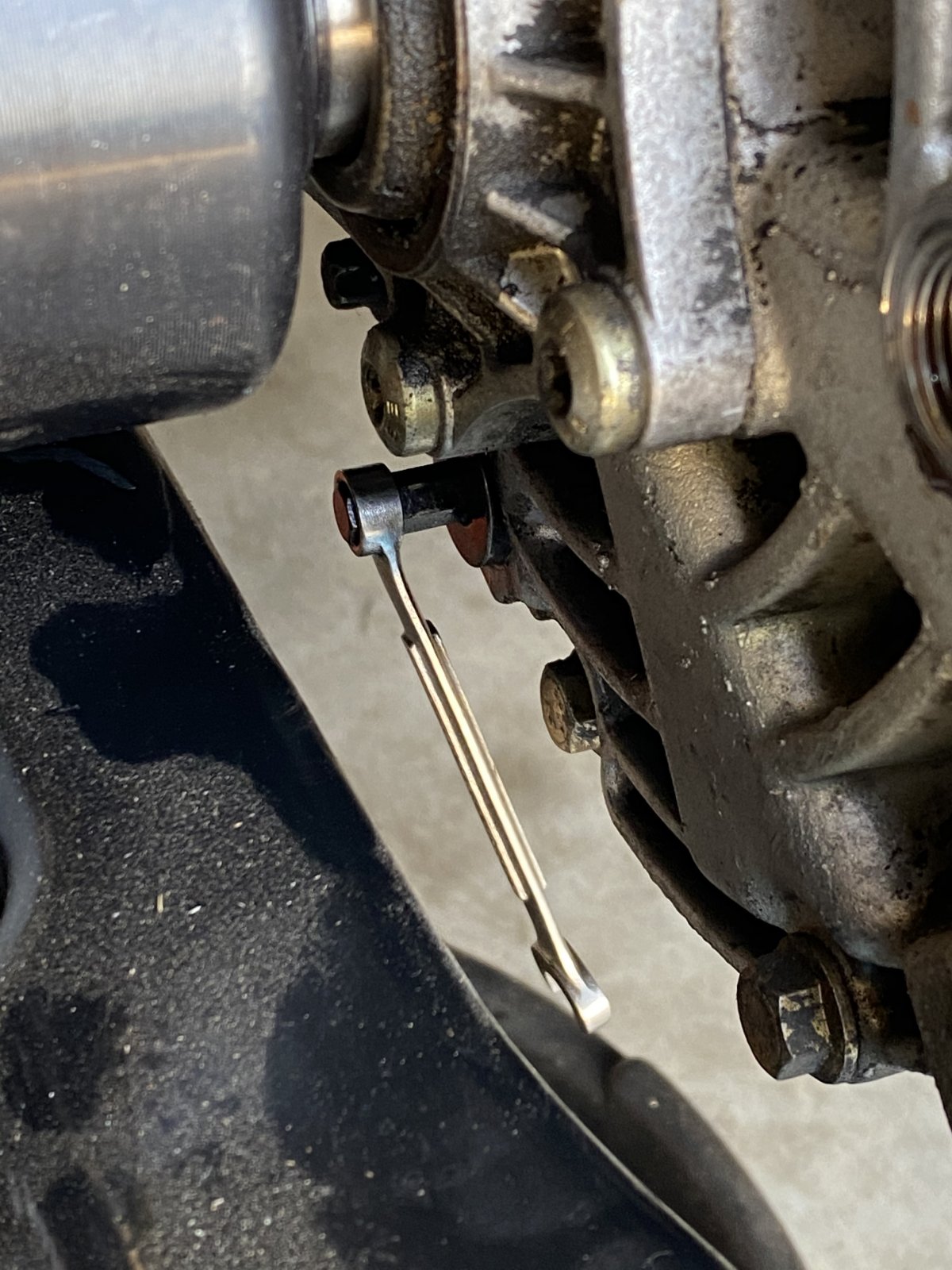

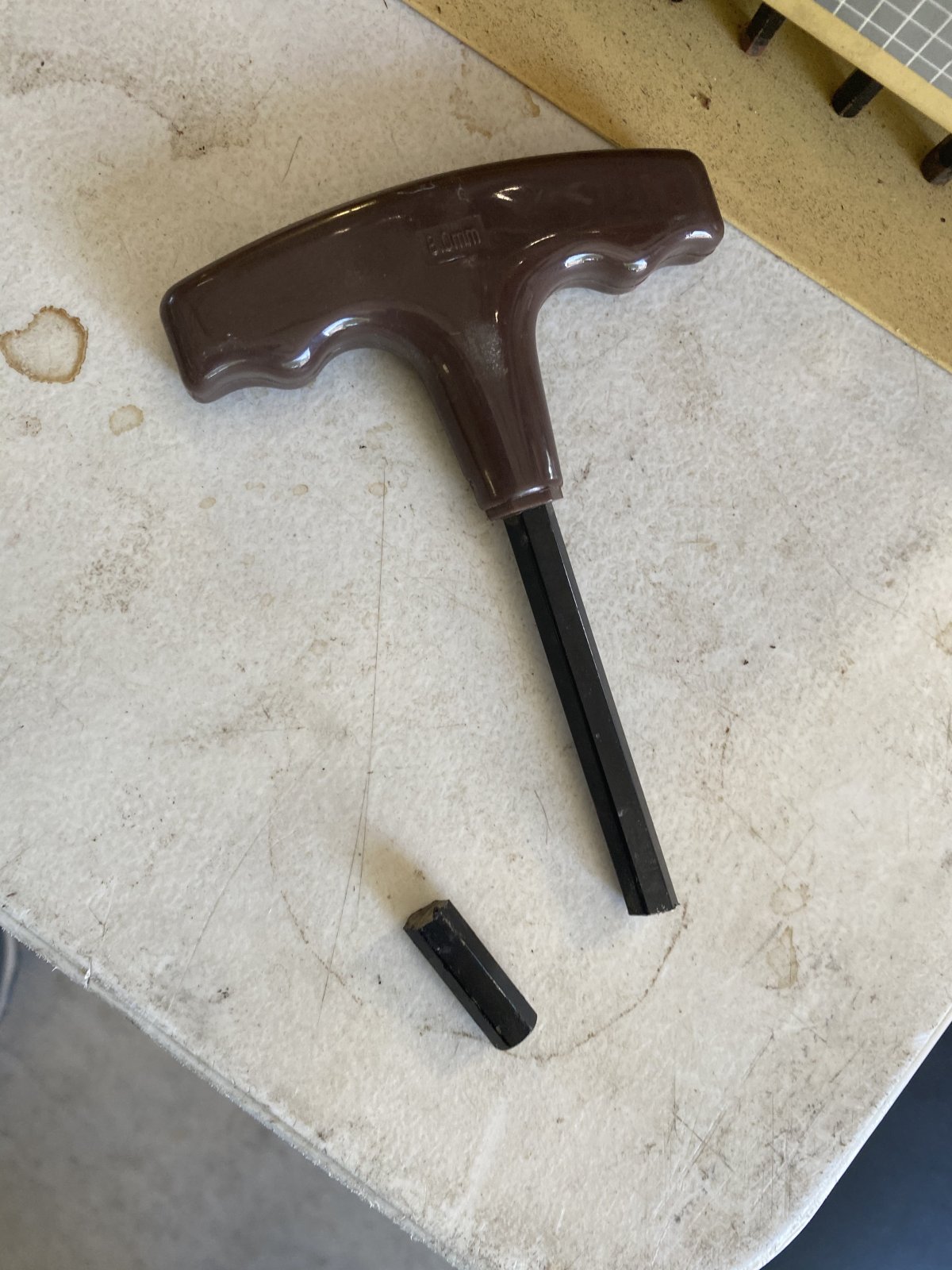

*edit* Hopefully the subframe doesn't prevent me from getting the little hex bolt out to fully drain the trans fluid. Damnit, I should have done it before putting in the subframe.....
Your back will thank you later. Mount the shifter and setup the rods and levers like the instructions say. This makes it a lot easier to center everything up and such. Same with the park brake. You can drill your holes and get everything lined up. then you drop in the whole assembly, move the shifter to run the cables and done.
I was just about to post on this. I took a cheap-o harbor freight T handle Allen and cut the end off, so I could use a wrench on it.
@Anks329 buyer beware, I discovered earlier that my wing is missing the green lead for brake lights as shown in the pics on the site. As it stands, my wing won't function as a third brake light. I've got an email in to their tech support, hoping for an RMA/replacement control module.
Rttoys, to go a little further with this ... is the best way to fill the trans fluid to remove the top hex bolt and use a funnel from the side? Seems kind of janky, but I haven't been able to find anything else.
I can take pics later when I get home, but yes, the Allen bolt next to the dr axle is the fill hole. I luckily had a piece of tube I could stick in there and attach to a funnel to pour it in.
