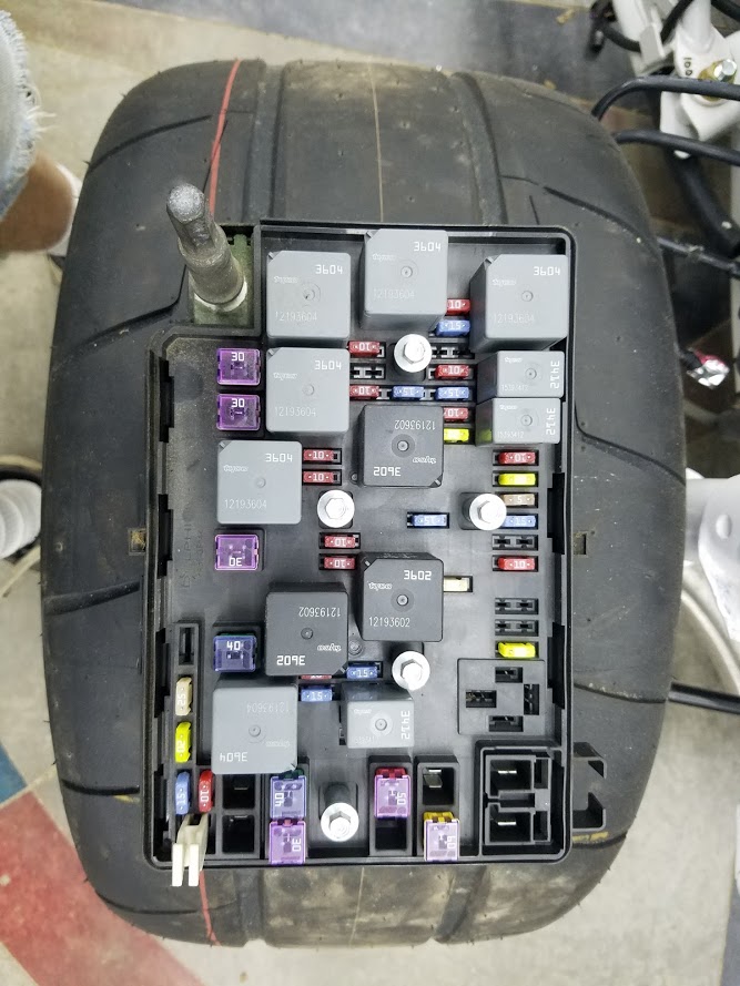

Would anyone with a 2.0L SS mind posting a picture of the fuse box under the hood, with the cover off but otherwise intact? Something's going on in mine; I suspect some of the relays are in backwards.

I really don't believe that it matters on the orientation of the relay. The way they are design, I believe they will work in either direction. At least the relays used in this car.

Well the cover is off, but it is not under the hood. I haven't moved any fuses or relays, so it should be good for your checking.
