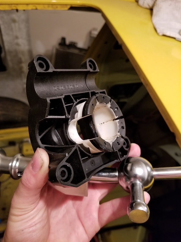

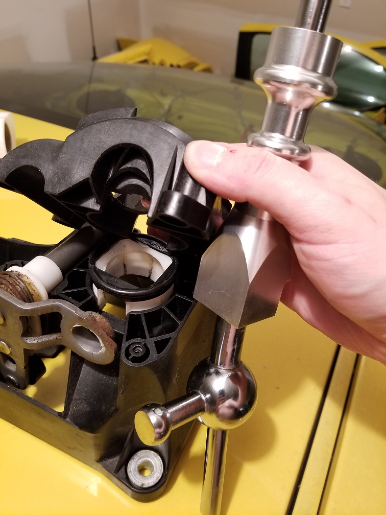

I picked up a cheap Manzo short shifter (the old Hurst shifter clone) to eventually replace the stock shifter. I was going over it, figuring out how to install it, but I'm stuck. I've got the stock shifter out and I want to install the new shifter, but I cannot seem to figure out how to get the crossover hold-down piece (the piece you screw down to hold the white crossover ring in place) to go in between the pivot ball and the reverse lockout part. Neither seems to come off...
Out of all the crap I've learned on this adventure so far, to think I am being defeated by a simple shifter is vexing!!!!!!! Help!
Hopefully these two images are enough to portray what has to happen.
The pivot ball of the shifter needs the white and black ring around it, then that structure needs to be clamped in between the larger shifter base and and hold-down piece, which screws down onto the base. For that to happen, the white and black ring and the hold-down piece both have to get between the pivot ball and the reverse-lock part of the shifter.
The only way I can see to get them there is to remove the pin in the reverse-lock part and slide that part up and off. But, the pin does not move easily and I don't want to risk breaking it if I am wrong.

That's actually the thread I used to help me disassemble the stock shifter. I'm thinking that pin will need to come out and I'll need to remove the reverse-lock piece.
If I break it, I'll let you know!

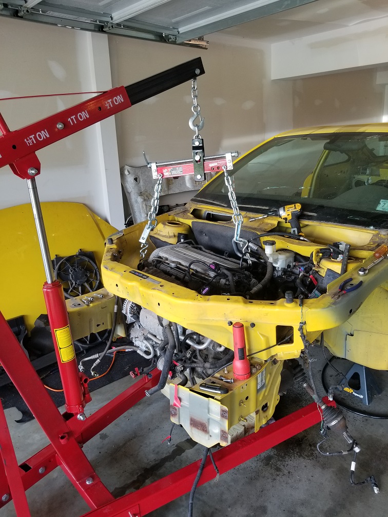

Finally at the point where I can remove the subframe and drop the motor out. I had a lot of trouble getting the front wheel hubs out of the steering knuckles, but I managed. Next challenge is to crack the subframe bolts loose. I tried a few times via the normal methods (impact drill, breaker bar) but no dice. I've got them soaking in penetrating oil now; hopefully they will come out tomorrow and I can drop the motor tomorrow or this weekend.
Aiming to be rid of my donor carcass before my family vacation at the end of July, so, fingers crossed...
Dropping the engine/trans and subframe is a big step. Your donor starts looking less like a car and more like something that needs to leave your garage. It is typically a big event when the donor is finally gone. Good work!
