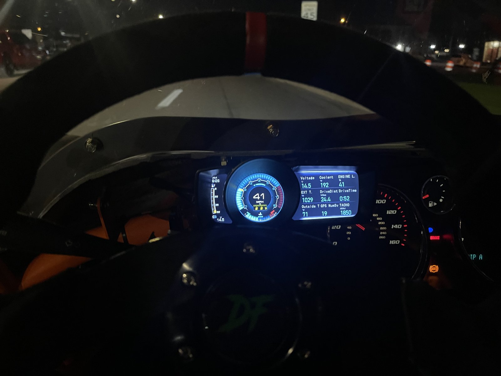

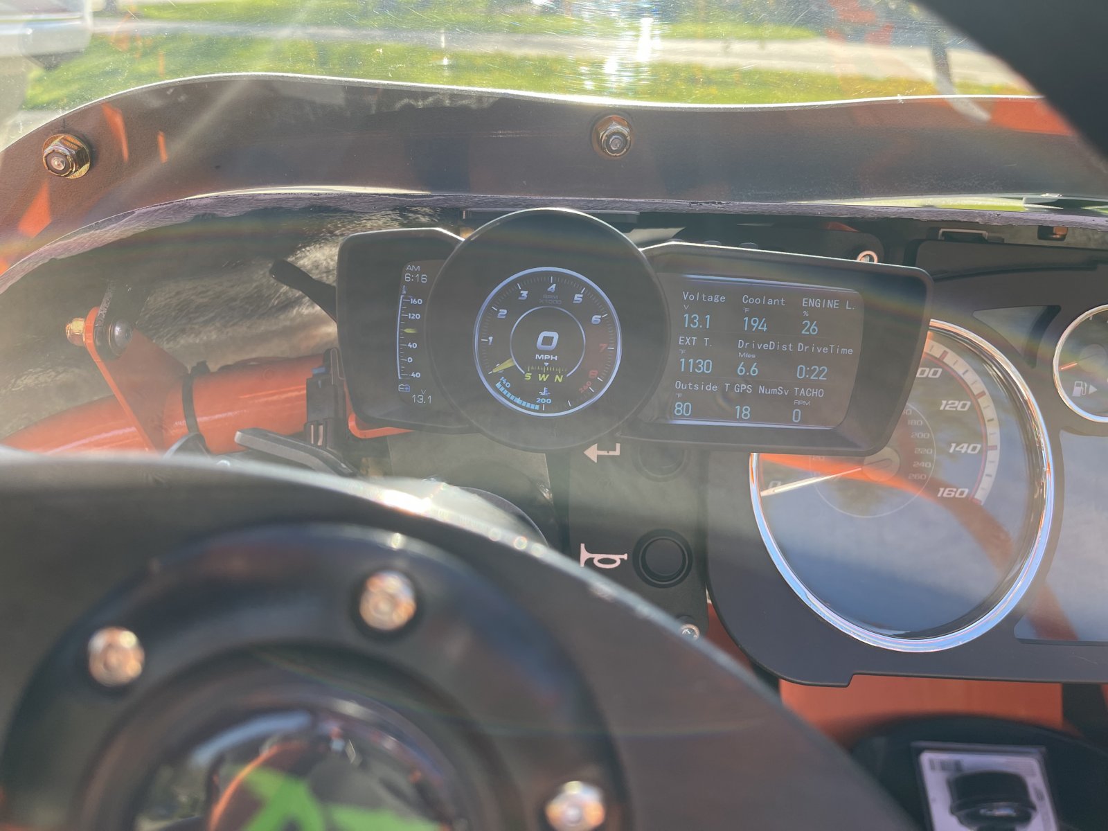

I plugged mine into my 06 SS/SC and was disappointed to find it doesn't work. Some features did work (speedo, voltage), but most others do not. The unit itself worked well when I plugged it into my 2019 Ford, so its not a defective unit. Maybe an OBDII genius on the forum (I'm looking at you Ross!) can find a workaround with custom connections?
My guess is that the gauge is preprogrammed for the 2009+ PID numbers for the sensors. If you can find out how to program it for custom PID numbers, you probably can make it work for our 2006 Goblins.
I'd be happy to send you mine if you want to play with it.
SmsDetroit

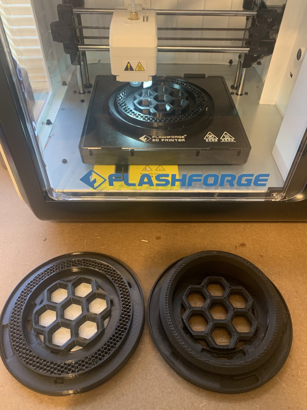

Waiting on the Petg filament to get here then I’ll make it I’ll have it done sometime next week
I used the 3M tape that came with it and stuck it to the under side of the hood. Worked great so far.

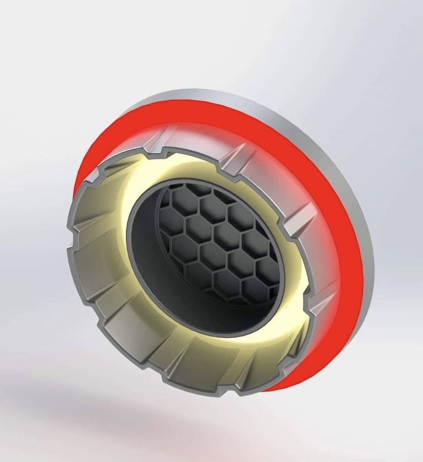

Still haven’t made the mount yet I’m working on some 3D printed tail lights for the goblin to post up on here with all the links to make them or I might make a batch to sell. Doing step by step changing some things on it for trial and error so it may take a while and each print takes 18-26 hours. Final product will be done in a week or two

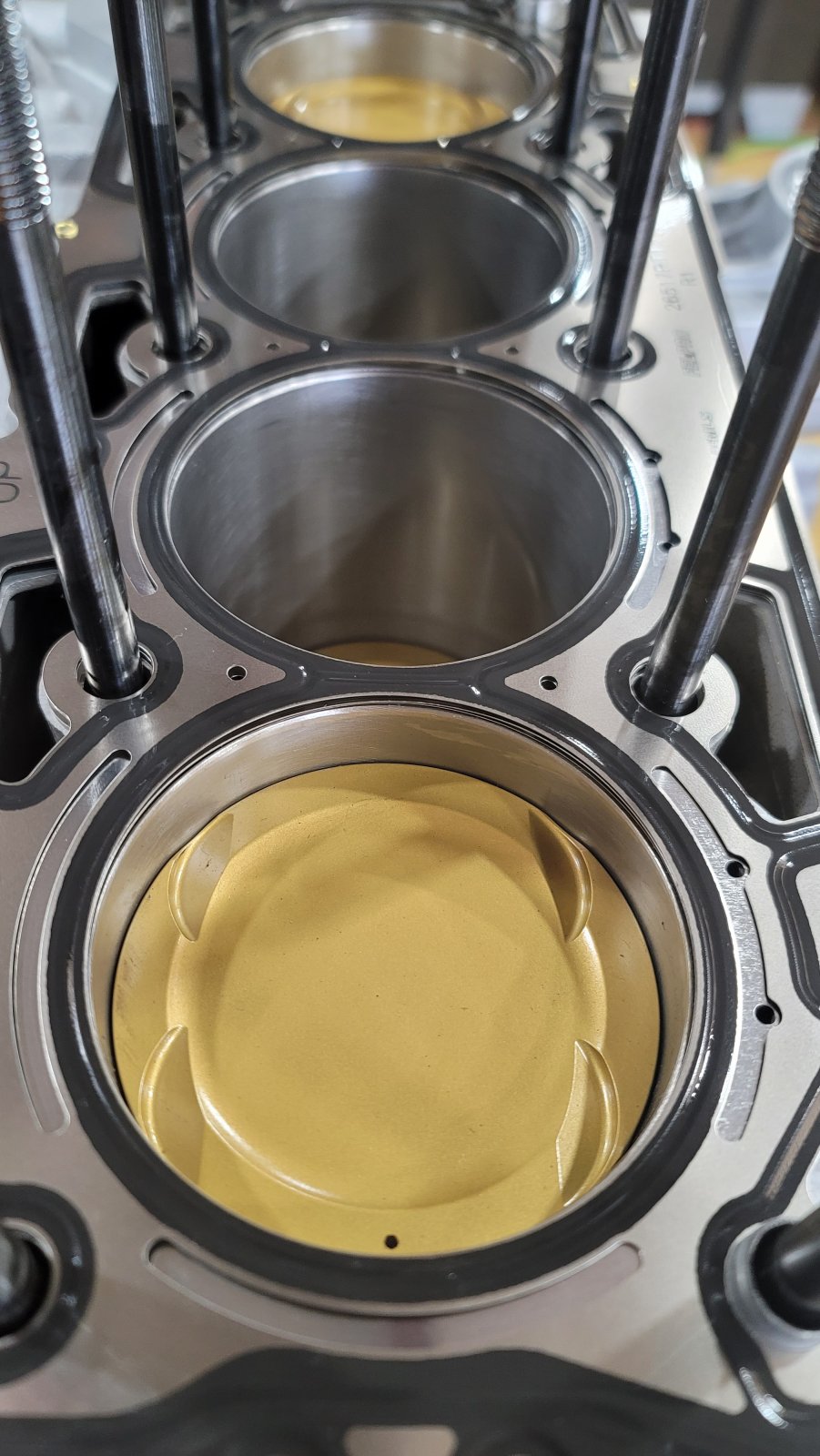

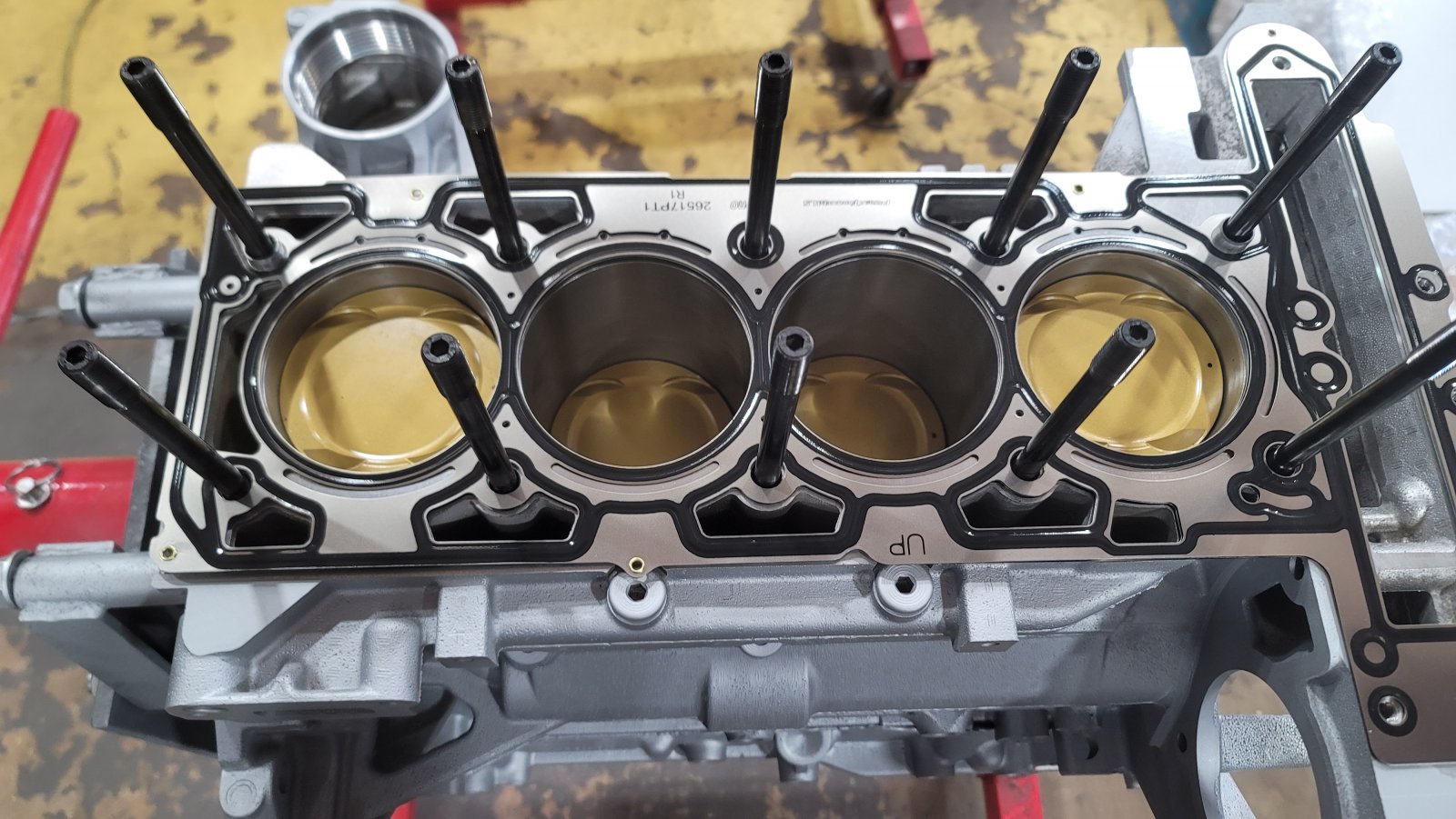

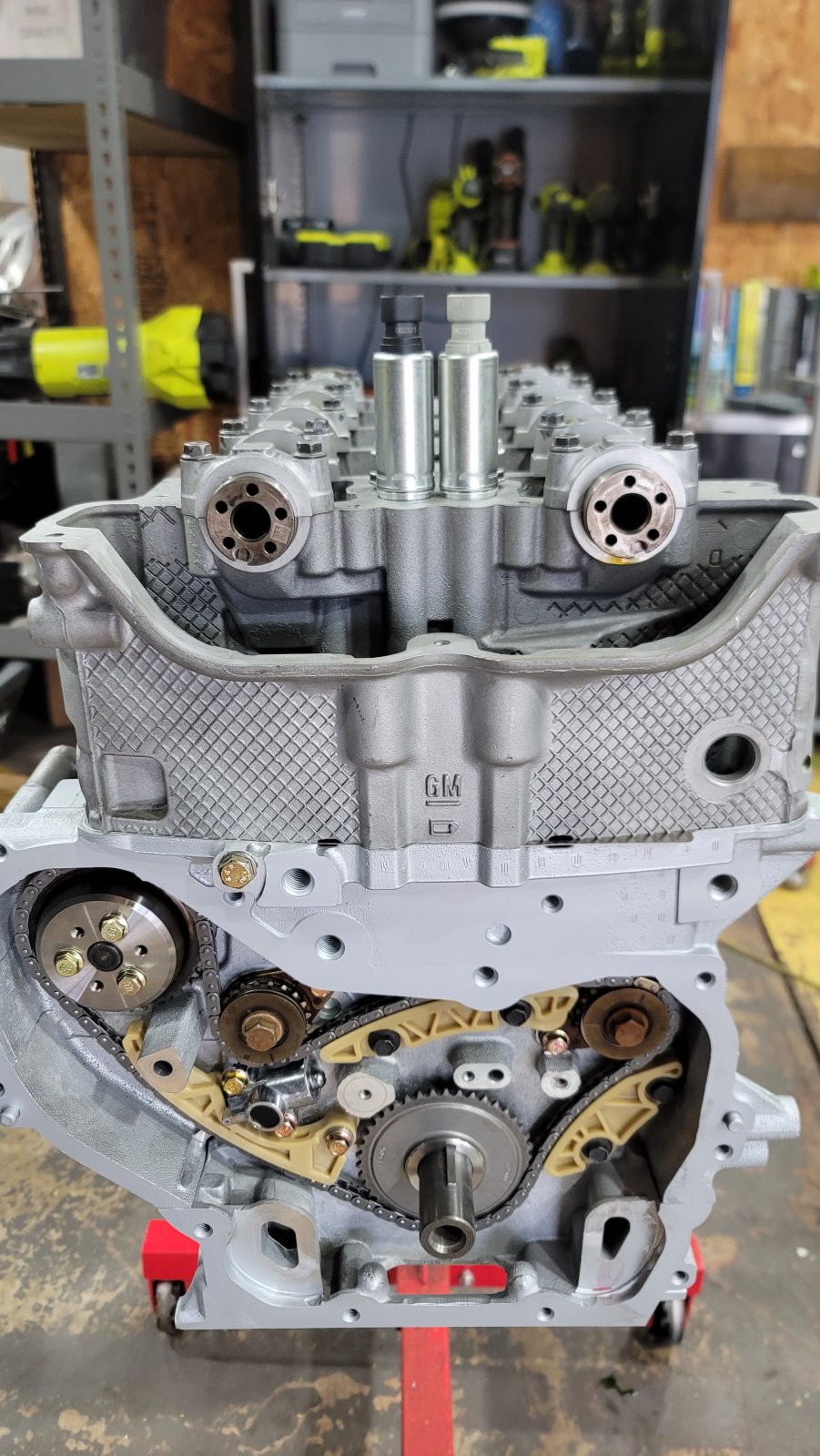

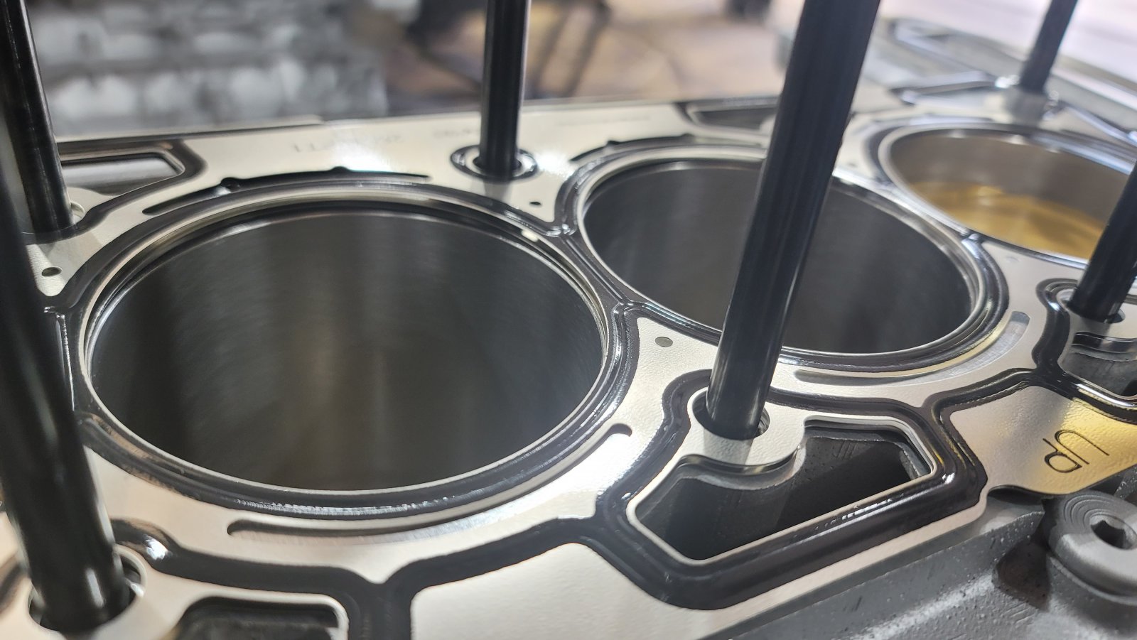

Ooh, really shiny!! Like the nitride coated pistons and girdled block(?) - going for some big HP? The head studs are a must! Did you do the balance shaft replacement or delete? Can't wait to see what power this little monster will make! :D
Bajakid1450
Balance shaft delete, and yea trying to go for some big numbers but gotta wait till I get back from vacation before I can drop the Goblin off to fab up the intercooler and charge pipes
