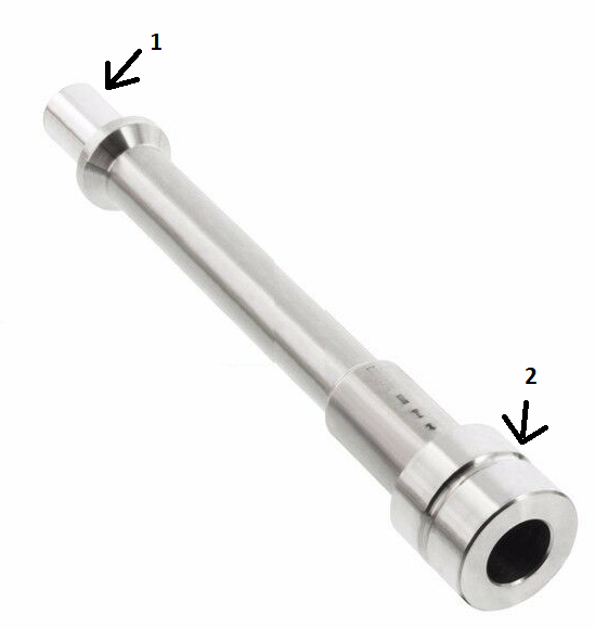

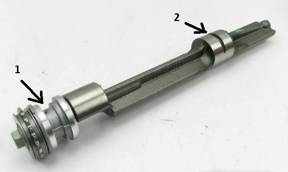

Each of the 2 balance shafts have 2 bearings, numbered 1 and 2 here.
The pressurized engine oil enters one side of the bearing, and leaves out the other side, thru passages in the block.
So to maintain the oil pressure without a balance shaft, something has to fill the bearing.
27040
On a neutral shaft, the front bearing (#1) uses the stock part around the bearing, and the stock sprocket. (those stock parts are in the image above)
the rear bearing #2, is filled with the rotating neutral shaft.

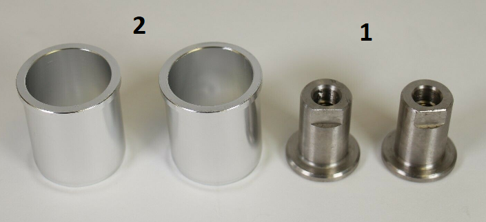

On a balance shaft delete kit,
the front bearing uses the stock part around the bearing, and the stock sprocket is bolted to the supplied part 1 (below). Some kits don't include this part, as they expect you to cut it off of the stock balance shaft. The front sprocket is only supported by the front bearing, as there is no shaft going to the rear bearing.
The rear bearing, is filled with the supplied part 2. It doesn't rotate, but the oil can travel around it, maintaining oil pressure. I have seen youtube videos pounding these aluminum rings in place with loctite, but others just use dry ice to shrink them before inserting in the block. If it falls out, your engine will loose oil pressure, so don't goof this up.

Pounding those aluminum sleeves in was a PITA! Once you get them started it was not too bad, but getting that first lip in.... I 3d printed a holder to position these in the hole as its about 6-7 inches inside the block. i then used a dowel and dead blow to knock those suckers in. They are never coming out lol.
