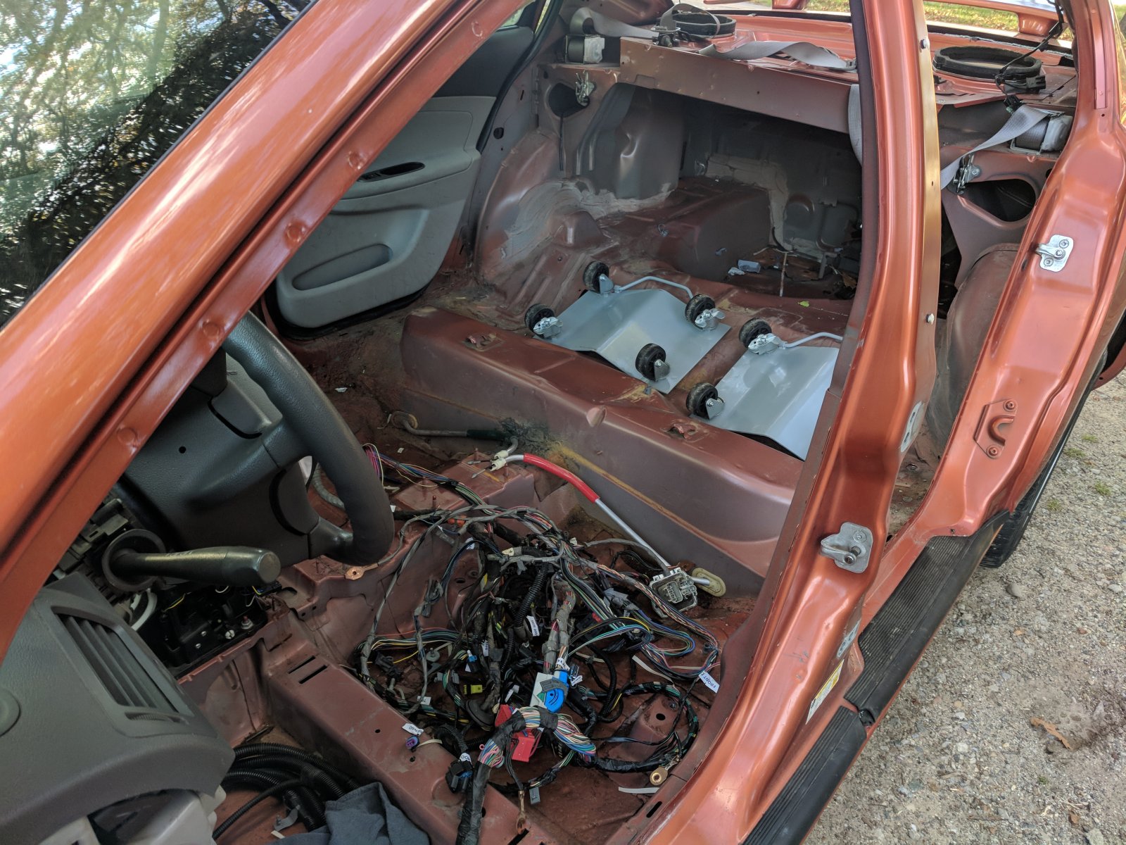

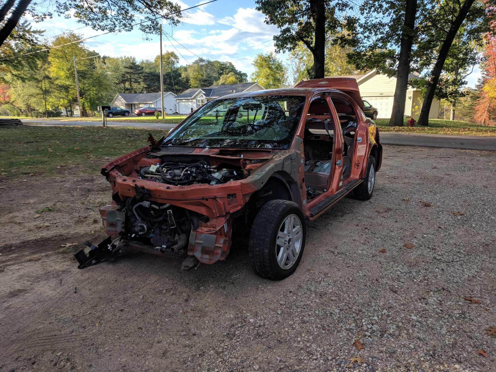

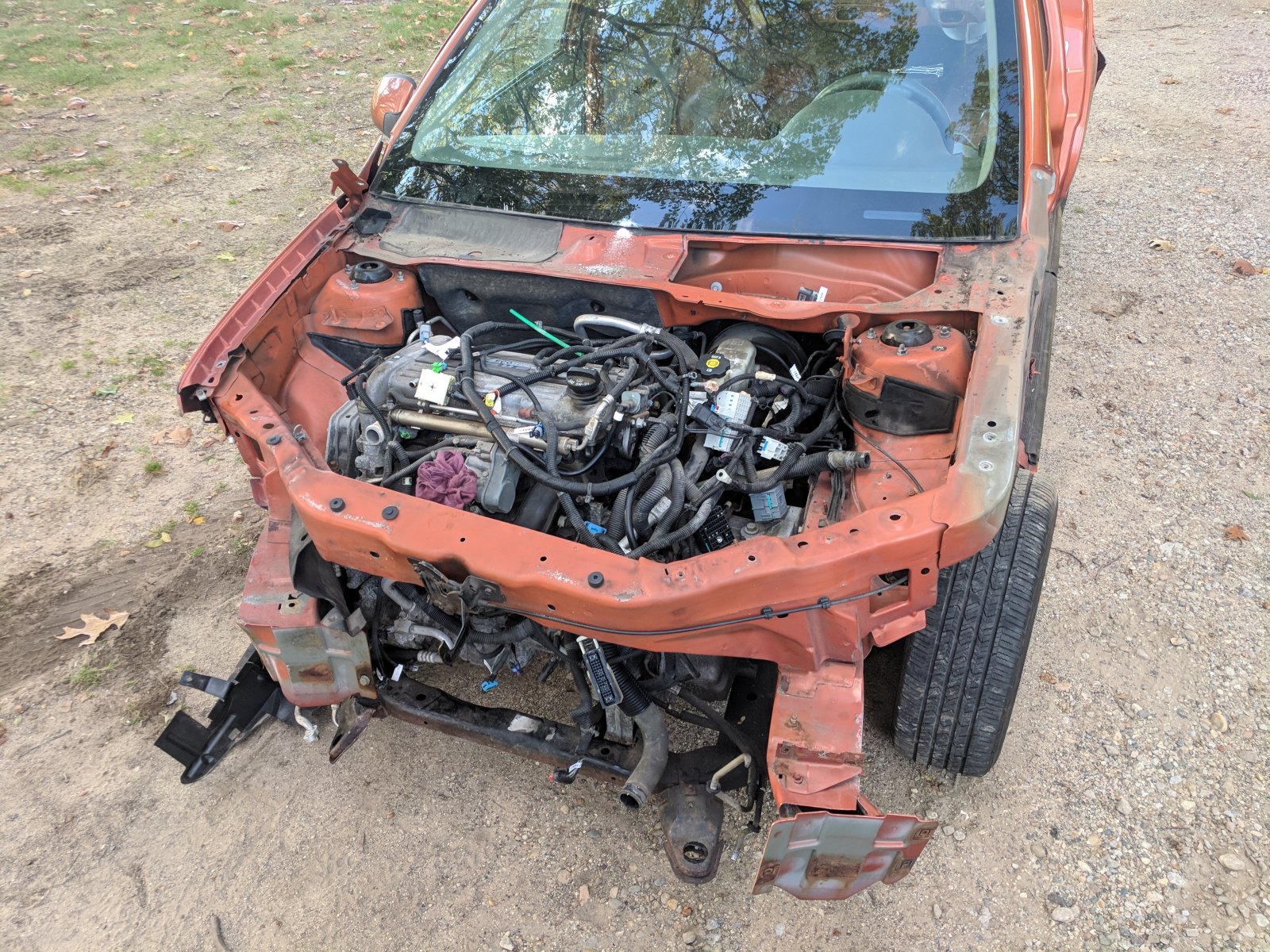

A friend showed me these kits on youtube. I was instantly hooked, and I had been looking for another project. I found a 2005 chevy cobalt as my donor, it was smashed in the front and spun around and smashed in the rear as well. Owner was selling it for parts. I went and looked at it, and the subframe was in tact, very little rust, and the front radiator support was a little bent, however I read that the radiator support flange is not needed in the goblin build. The engine still ran, and the vehicle would shift to park and reverse. I checked the the computer system. and 129,000 miles and no check engine lights in any of the ECUs. The only issue was a broken front left steering knuckle, which I can find from the junk yard. and most of the parts I plan on replacing with new. I paid $200 for a ugly burnt orange smashed cobalt. The tow truck driver laughed when he picked it up and with how excited I was. I immediately posted parts for sale on the cobalt, and got lucky sold the interior door panels, and both front seats, as well as the rubber off the rims, and the used front struts (i'm replacing them anyways). Doubled the money I paid for the car, and still had intact electrical system, harness, a running engine. All the fluids looked in decent condition, so the car was well maintained. I will use the extra money to rebuild from the block up with some upgraded parts. which I have not decided which to use yet. I would love some suggestions on upgrades for the engine internals. I was thinking I find a scrap yard 2.4l exhaust manifold, and throw a turbo on the 2.2l ecotec. the engines are almost identical. I also will probably throw a set of high compression pistons in it, and a set of camshafts. however I would like to tune my ECU. I just do not have solid information to if the 2005 chevy cobalts ECU is "Tuneable" Anyways I will have the machine shop clean up the engine block, and the cylinder head for me. And then i plan on using a product called Por 15. It can be used on aluminum to adhere, and it can withstand high temperature. I did quite a bit of research and i think this will be the best option. So i plan on rebuilding the engine and then painting the outside, and then throwing in some accent color to match my frame on the engine. I want to buy a track frame goblin, and use it for city driving. I like the protection with the roll bar, and the option to mount a full windshield between the uprights on the track frame. I have yet to purchase any part of the kit. I am waiting to save some money up to buy the whole kit because I have almost everything except the engine prepared to be assembled on the goblin. So I have stripped the full cobalt, to nothing but the shell. I have also started prepping and cleaning and rebuilding parts and painting parts. Please see pictures. I would love opinions on any ideas on upgrading the engine internals. and options i have for an ecotec 2.2l with the L61 RPO code application. It is a non turbo, but like i mentioned above i think i can use the exhaust manifold off a 2.4l ecotec. Has anyone done this?

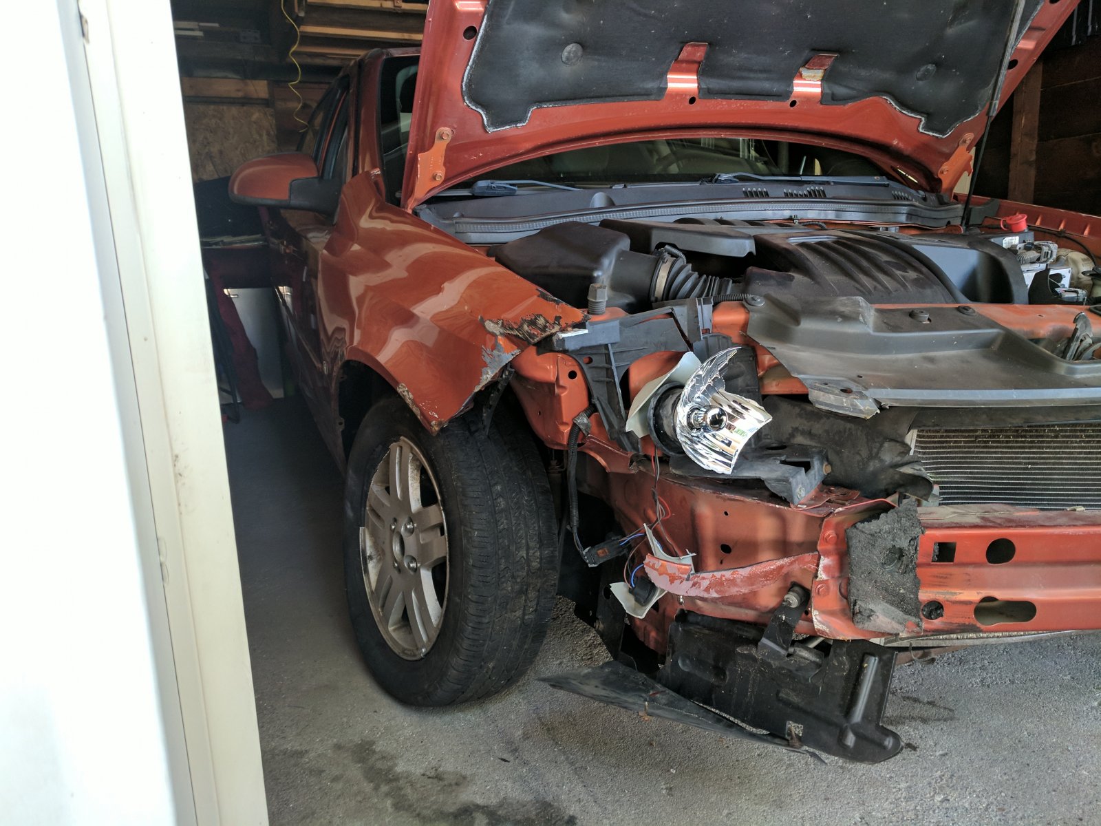

front right damage to donor

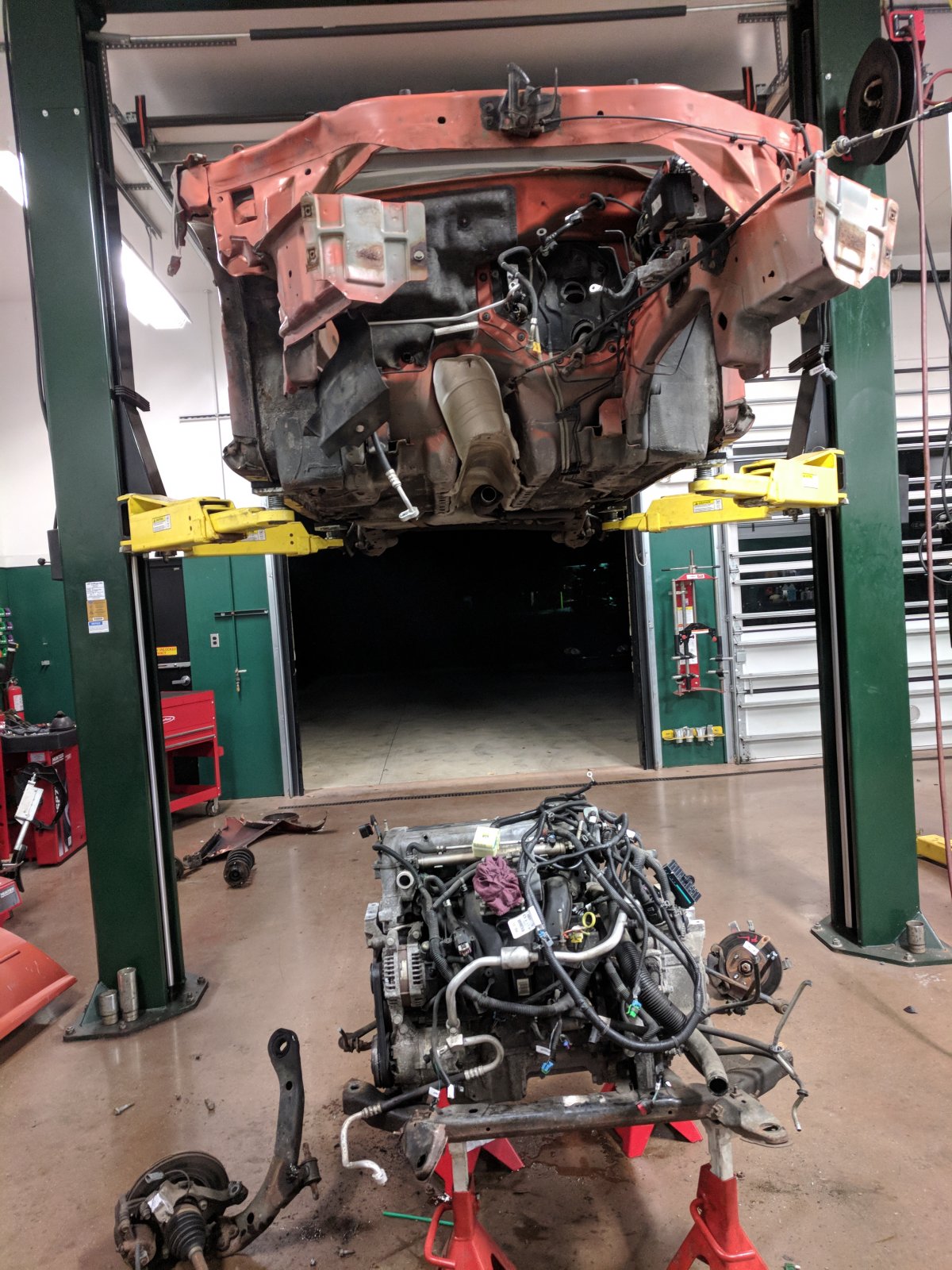

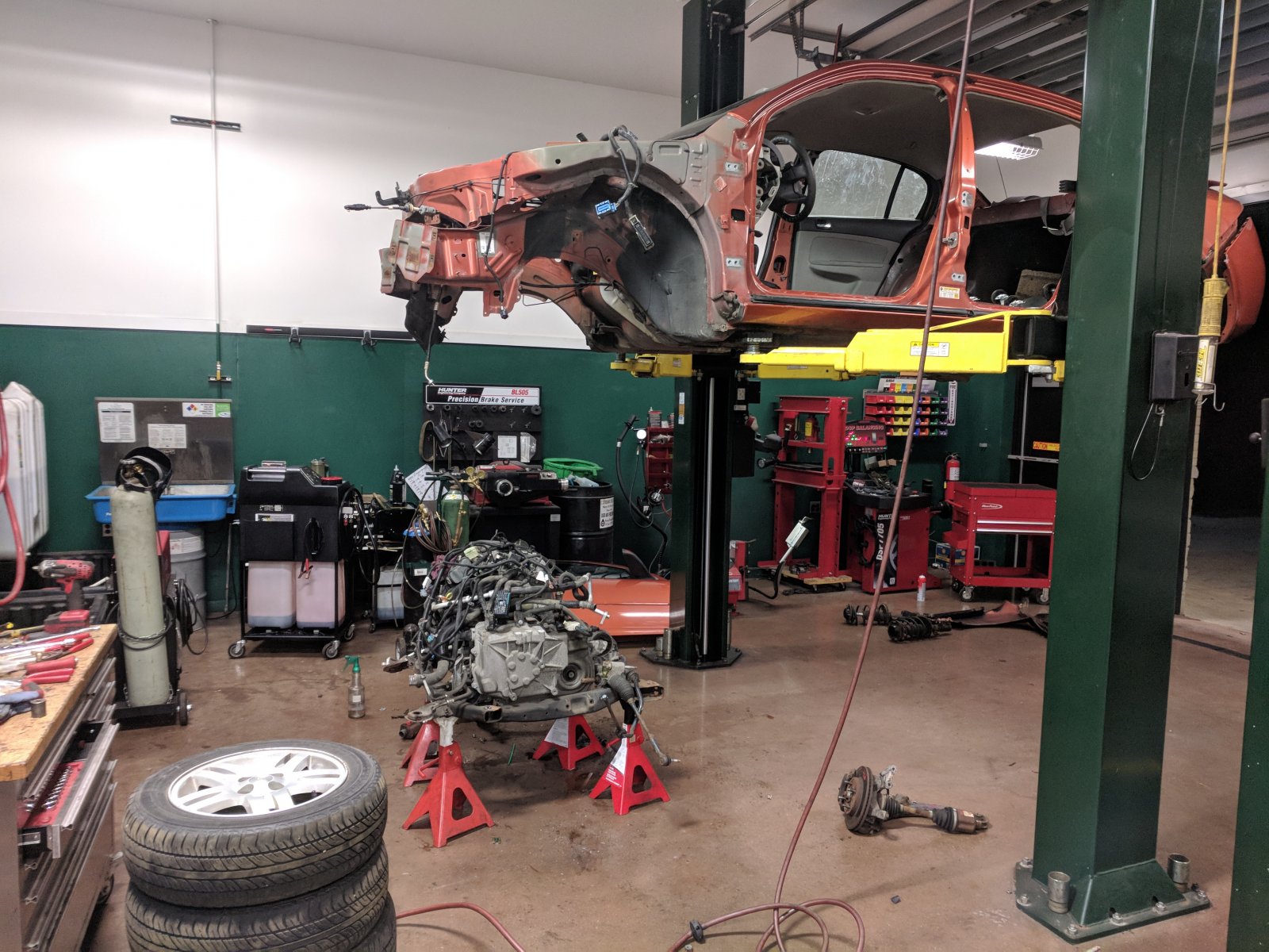

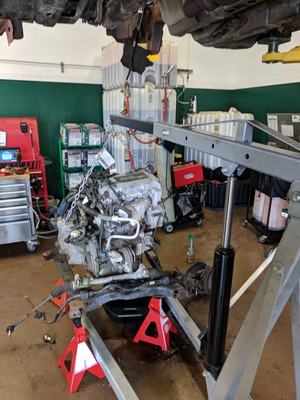

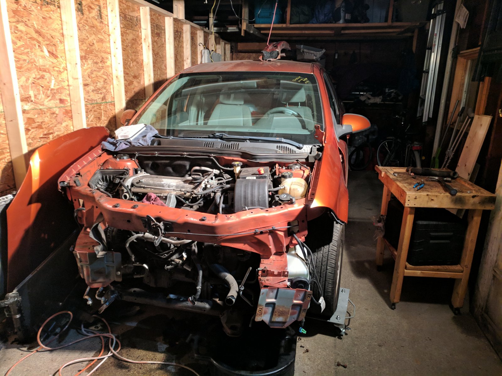

i removed the hood and the two side doors, as well as the front bumper and radiator assembly etc. the first day i got the donor to my garage.

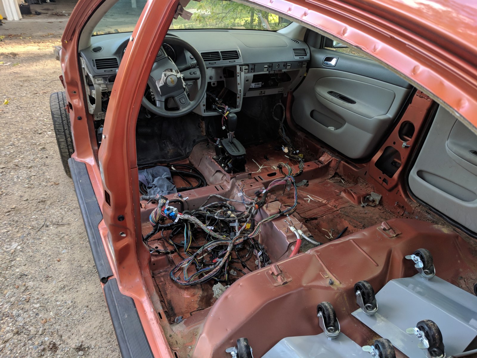

the damage on the front right bent in right up to touch the a/c line that runs by the alternator. I could still move the a c line. The alternator, and that side of the engine were untouched with damage

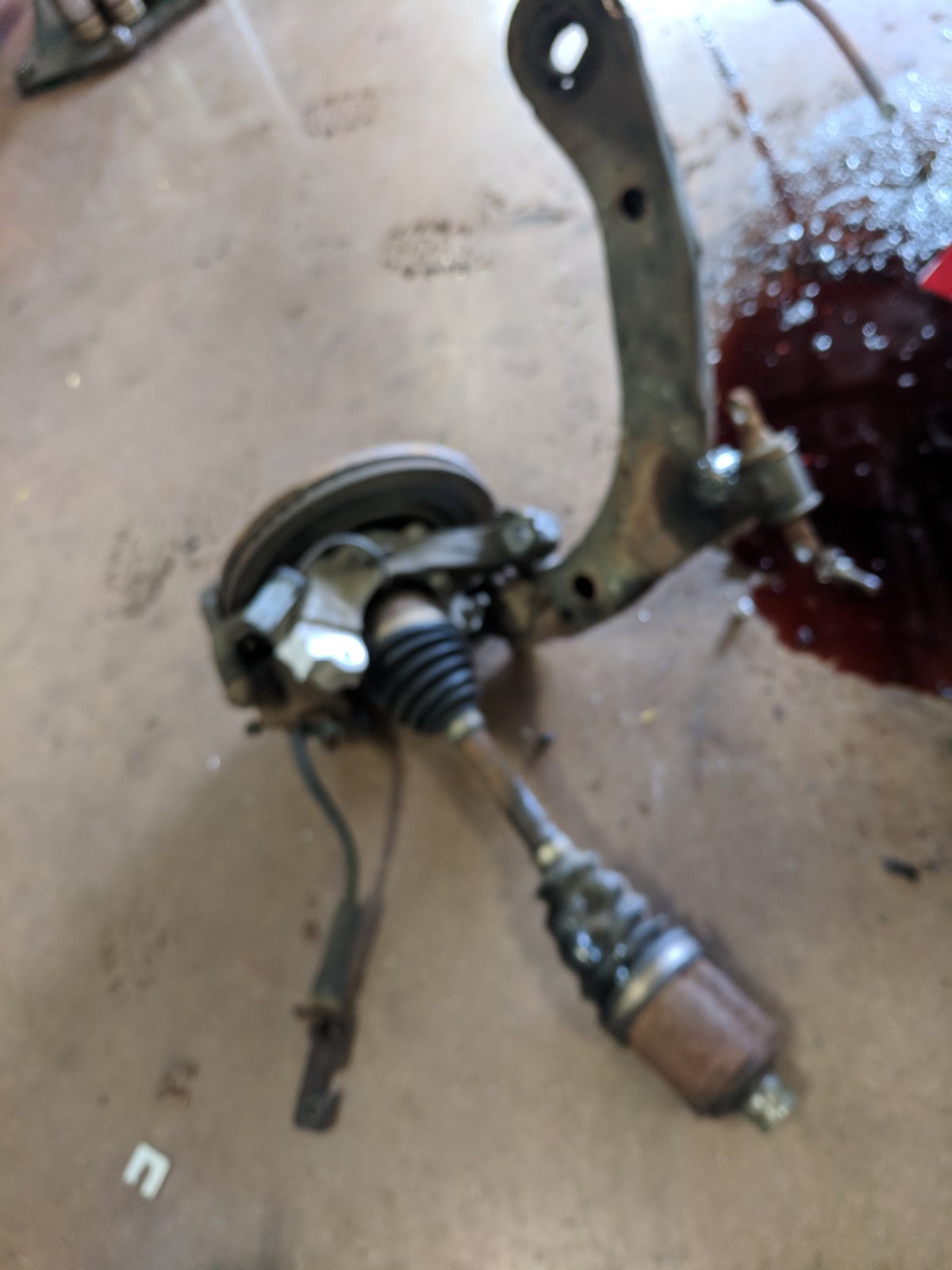

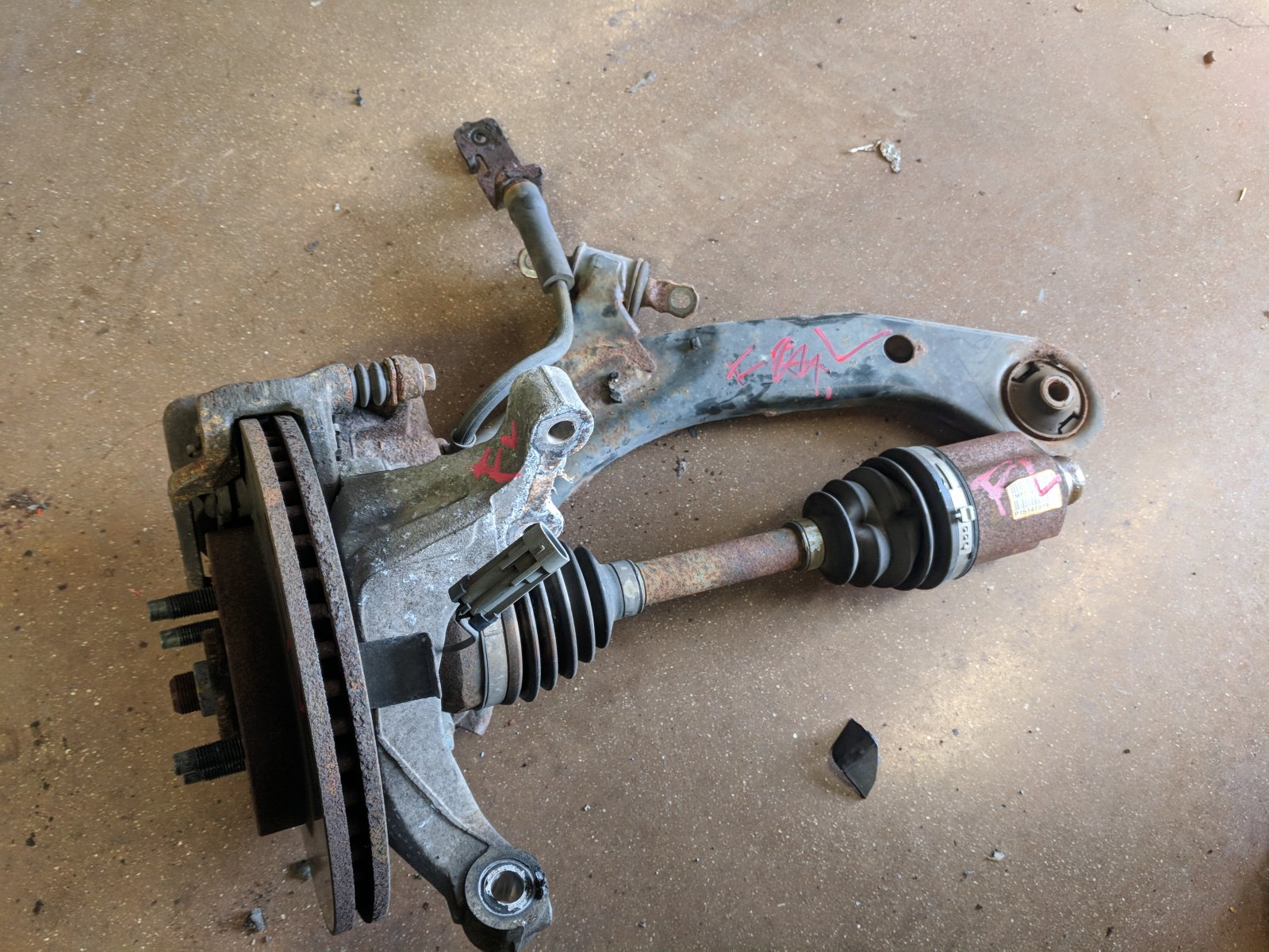

Control arm bolt that ran through the control arm bushing was rusted in there. thanks michigan. So i had to use a torch to heat it up really hot. which caused melting of the bushing to the control arm. I took it off as an assembly. I have to replace the front right side knuckle due to it snapping in the accident. so most of these parts are going to get replaced new on the the goblin. and then there is a good picture here of the subframe out of the body.

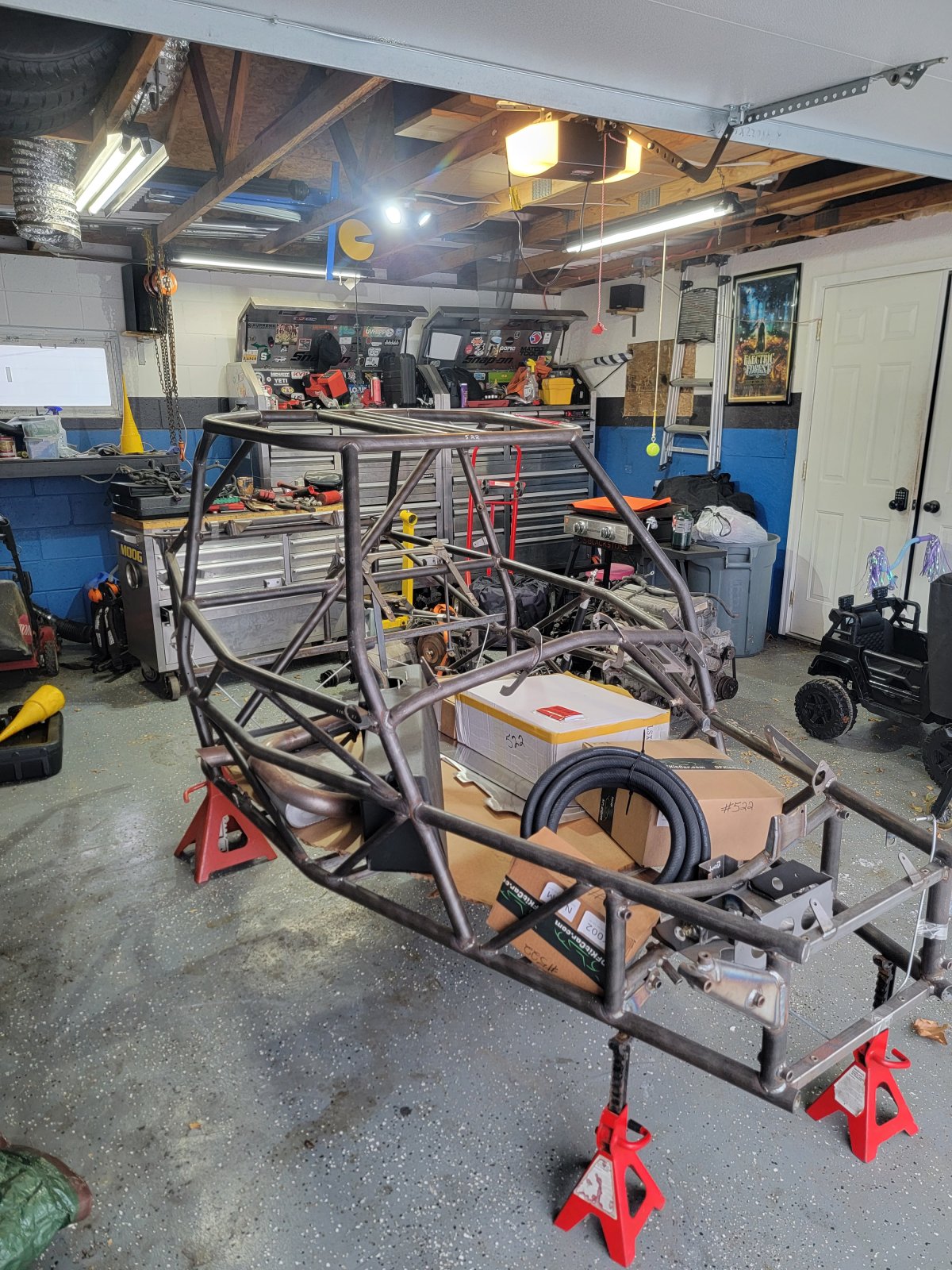

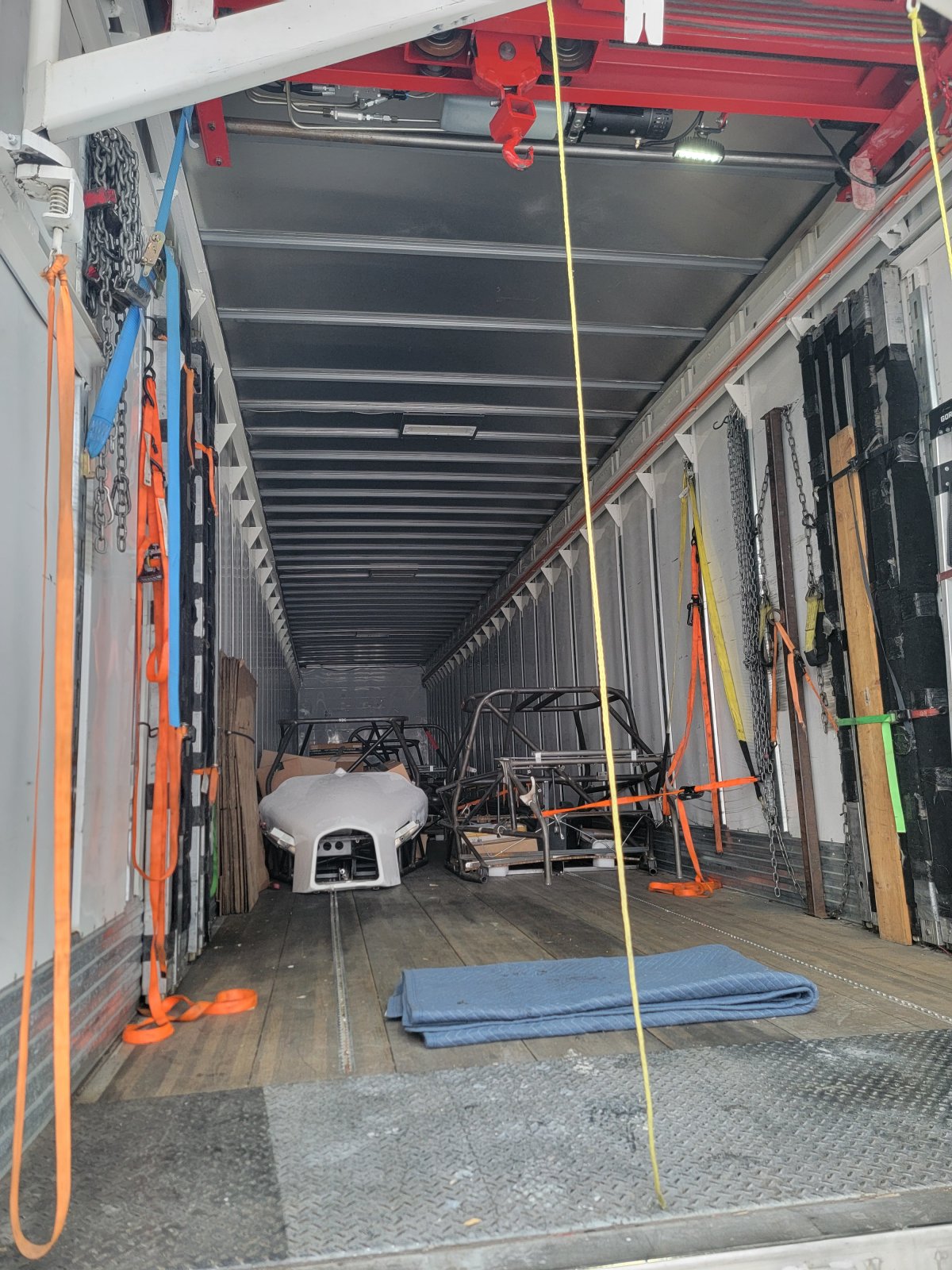

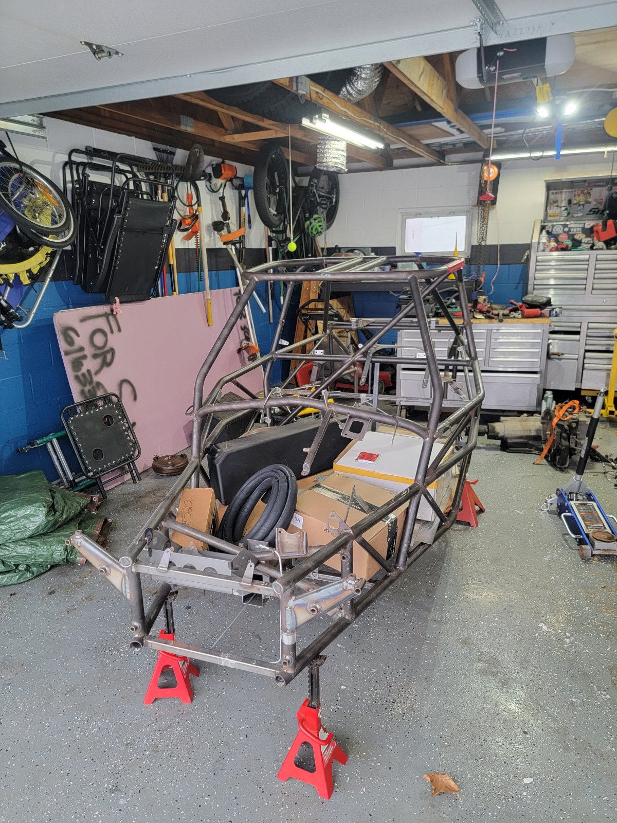

Well my friends. After 7 years of manifesting this project and holding on to all my donor parts I finally purchased my kit before the Gen 2 came out. Chassis #522. It was delivered last weekend. Now that it is here I will finally be able to update this thread as I progress. I'm excited to keep more constant updates.
Unfortunately I had to buy in stages. But I'm locked in and can't wait to get this built.
Located in Holland MI. Shout out to all the other MI builders I see on here.
As I scroll through build logs I love seeing all the color schemes as next step is powder coating and trying to decide the color.
Any tips and tricks for stage one build would be helpful.
Master ASE technician here, currently working for Rivian Automotive. So I was tempted to almost make this an electric vehicle with access to a lot of parts. haha but maybe in the future. It would do wheelies with that power train and instant torque. But that's a pipe dream.
For now I'll get it built and registered and insured.

Let me be the first to say congratulations and don’t forget to save the parking brake tubes. Also once you start on the wiring harness don’t stop or skip around. Work it start to finish
Nice. Glad you are sticking with it. A lot of R&D has happened since 2017. o_O Your background is the same as mine, so you should be fine with any roadblocks that come along.
