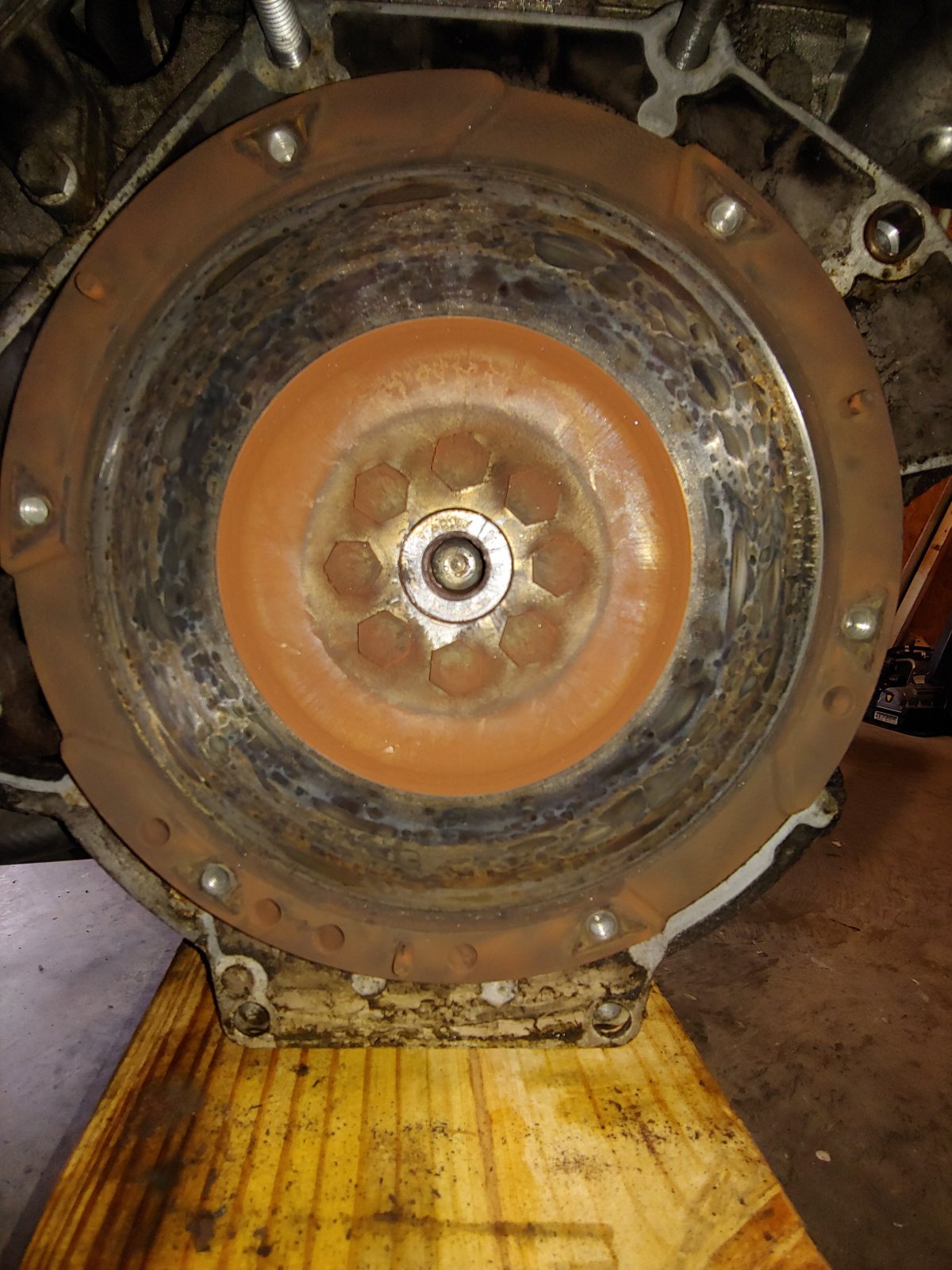

On Sunday afternoon I pulled the driveshafts (full passenger and what was left of the driver's side) and replaced the axle seals. I might hold off on installing the new driveshafts till later since they'll just be hanging in my way. I separated the engine and transmission and pulled the flywheel and clutch off. Different day I'll pull the flywheel and install the new GMPP clutch/pressure plate and ZZP lightweight flywheel.

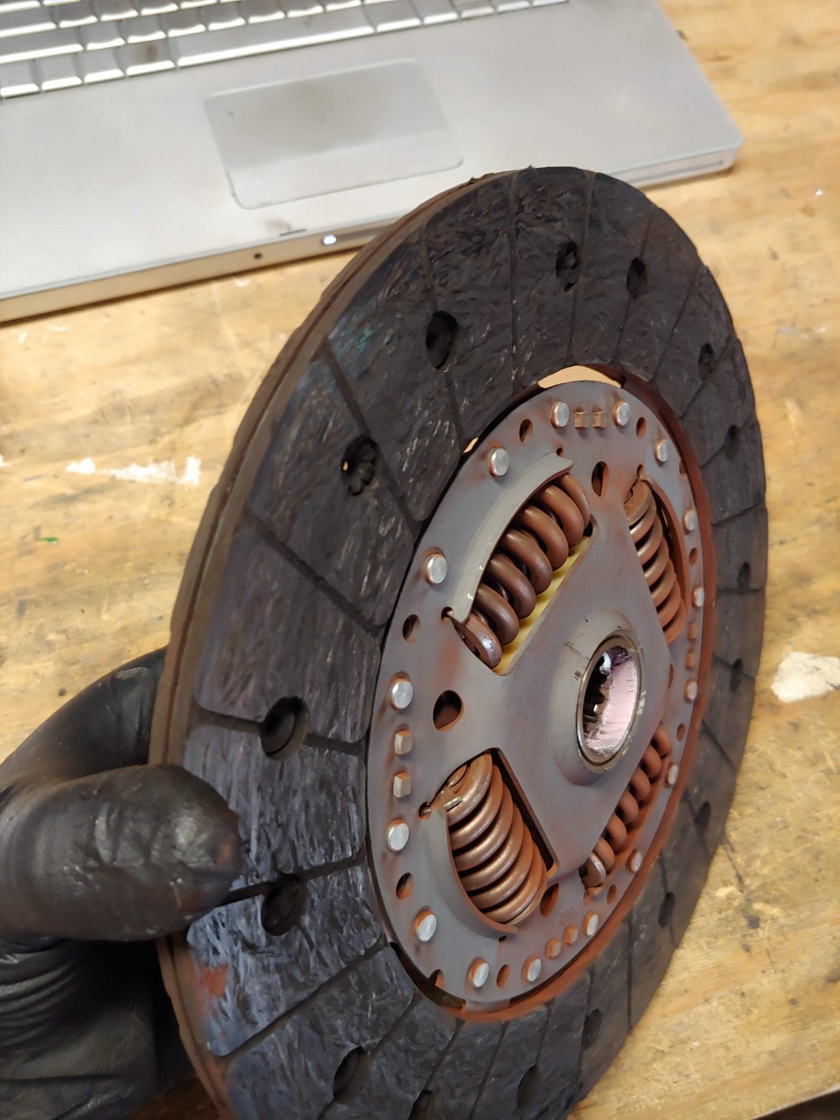

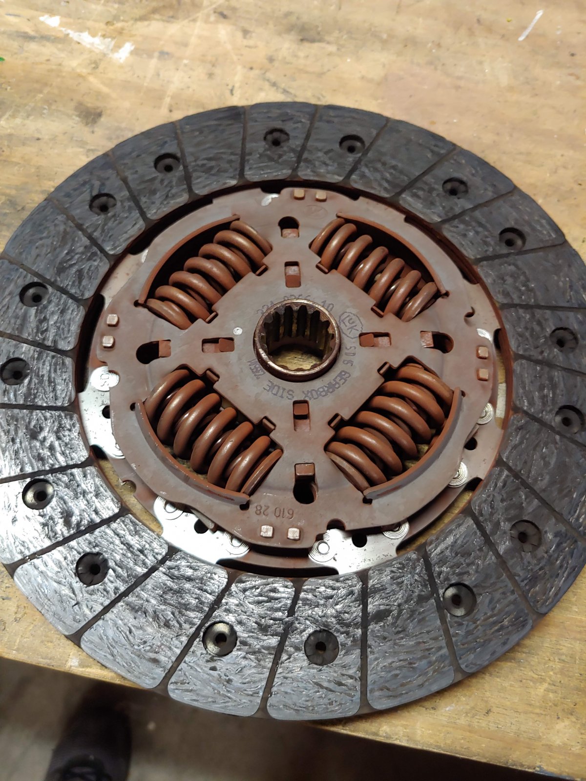

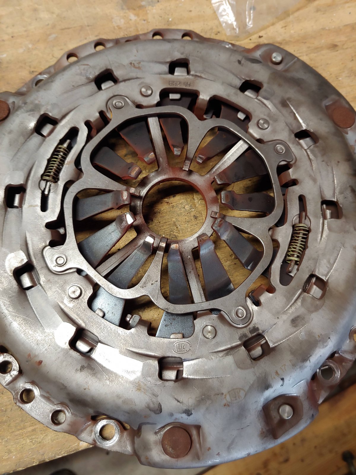

Looks like the pressure plate and clutch I'm pulling off are LUK, not sure if these are the original or not but my quick google searches show these are likely at least OEM level not improved, not sure if I'm right or not.

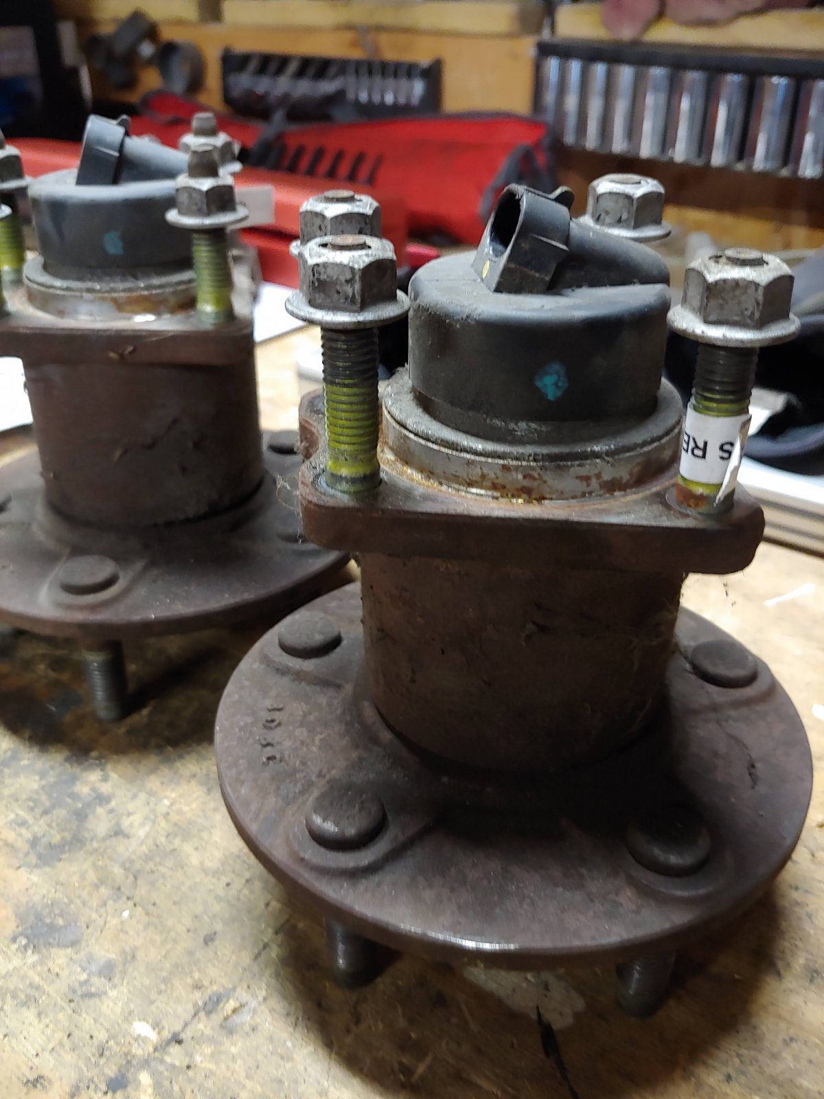

I was reading up on the hubs (http://dfkitcar.com/forum/index.php?threads/bearing-hub-info-4-lug-5-lug-abs.456/) and it looks like I've got the style (512250) that will require a little extra work unless I buy new. The thought of spending that money on new parts to then cut makes me at least want to try to rework what I have.
9142
I'm currently planning on 5x110 wheels so going the route of buying 4 new 4x100 hubs that were made for no abs isn't my plan right now.
Cutting those caps down was easy. A few layers of aluminum duct tape, and boom, your done.
You already own those parts, might as well try to use them... cheap solution if you succeed.
Or ask Adam if he is still selling 3D printed caps.
