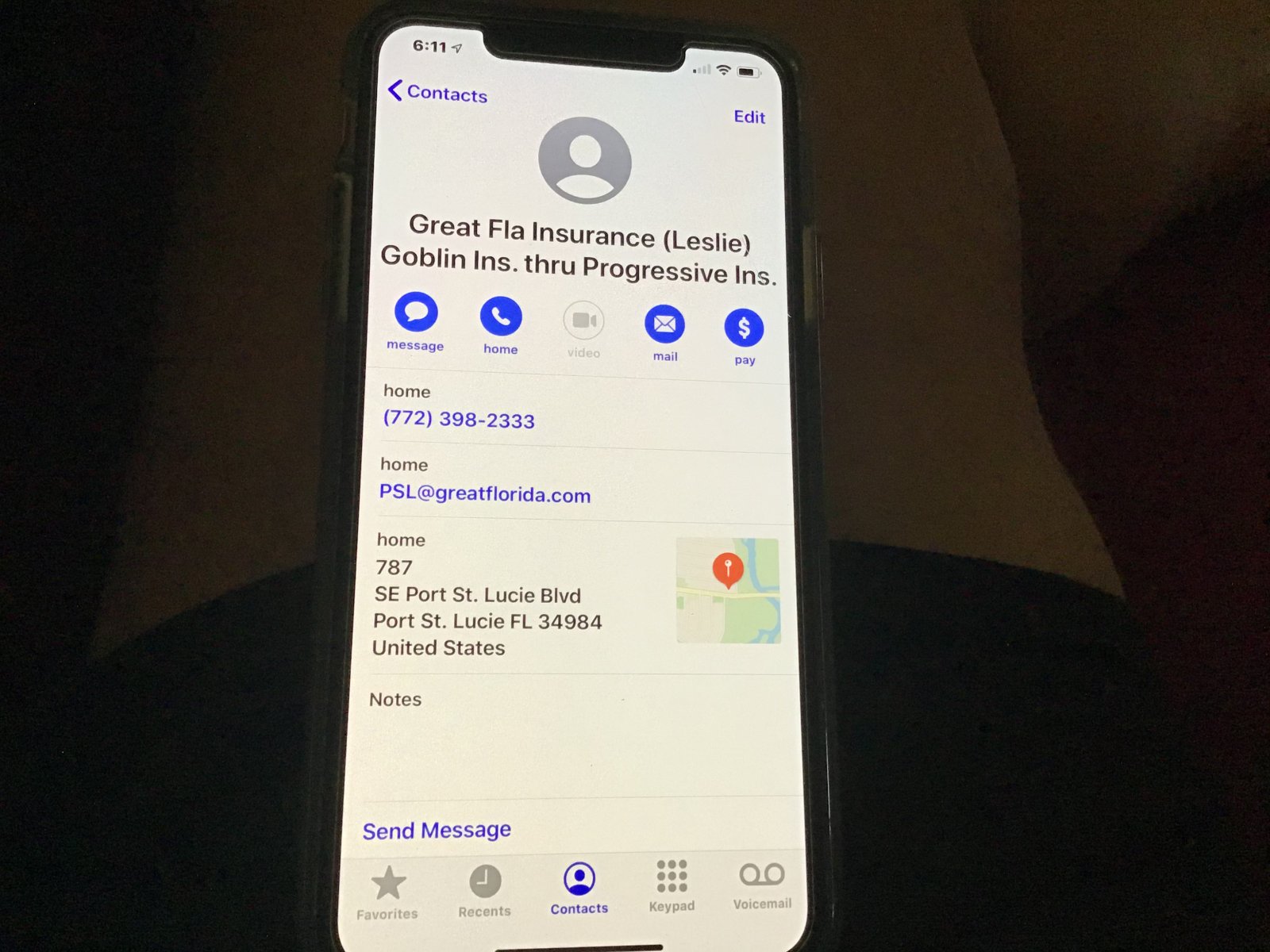

Try Great Florida Insurance through progressive 550 a year no mileage limit if you live in Florida I have a contact person , Or maybe she can tell you how to get insurance through them in your state.

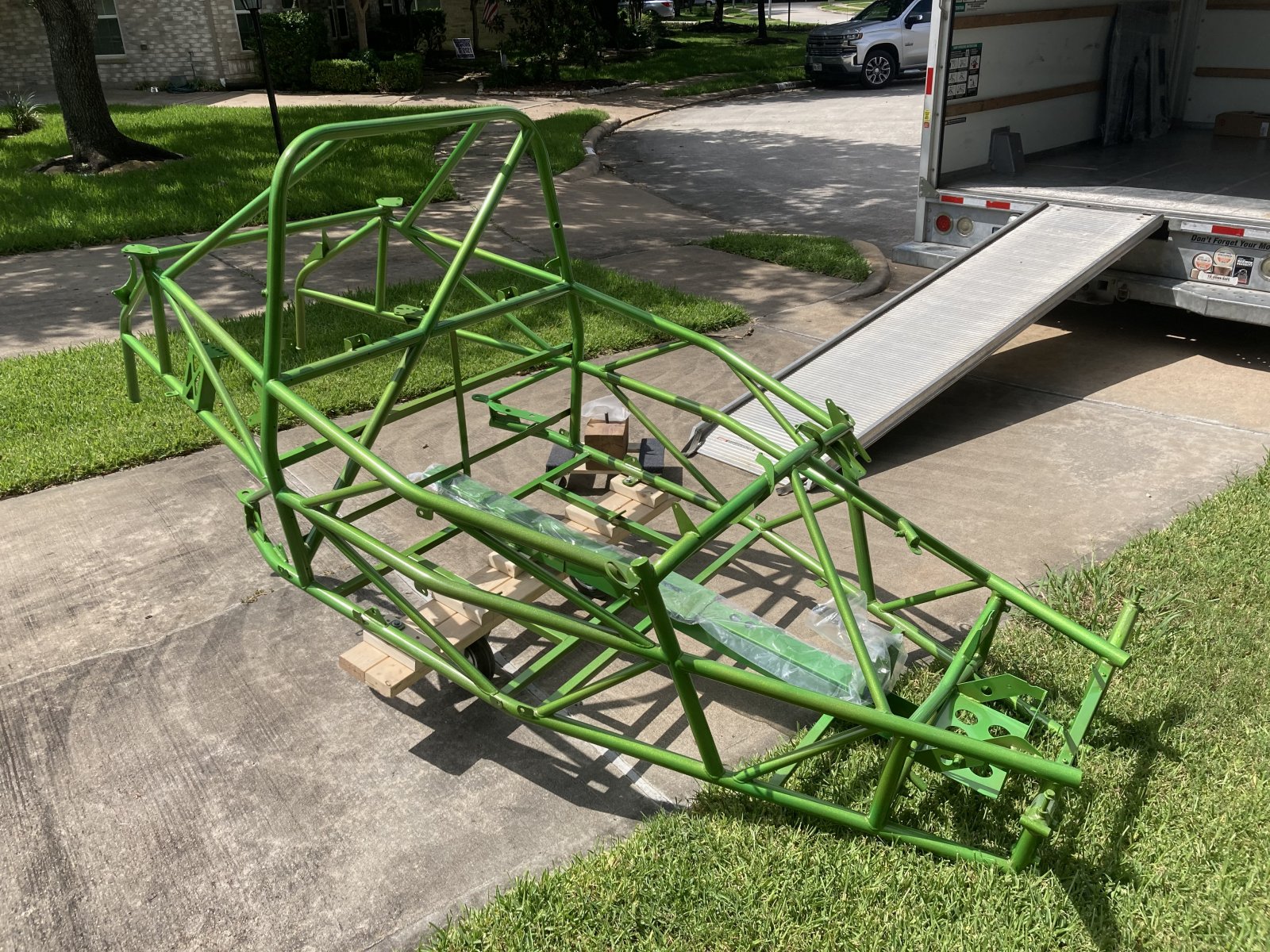

See my build log for a better picture. I would try to space the outside of the wheels about 23" as the loading ramp handling straps take up some room.
I kept the dolly on until time to install the engine. Worked great.

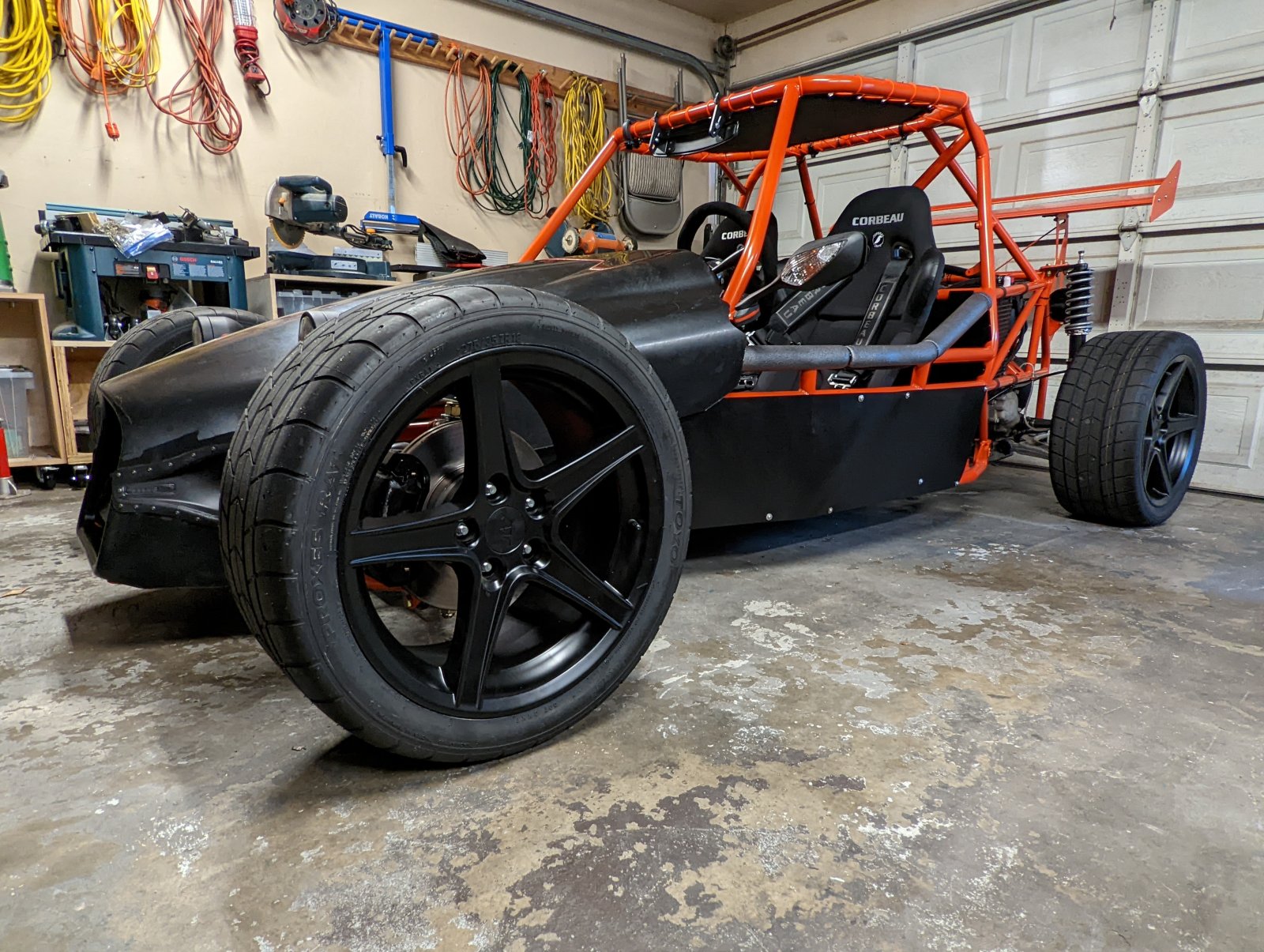

I have finally been able to get back to the Goblin after dealing with family issues for most of January.
Got some random items completed. The car starts reliably after replacing the clutch switch and Rotty running a calibration on it.
Also resolved the cooling fan not coming on. Had a bad electrical connection and now it works reliably.

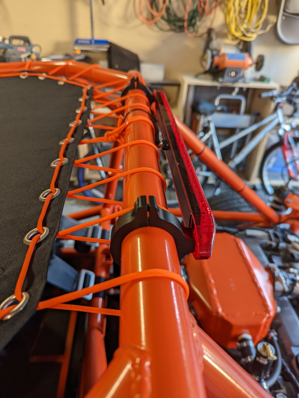

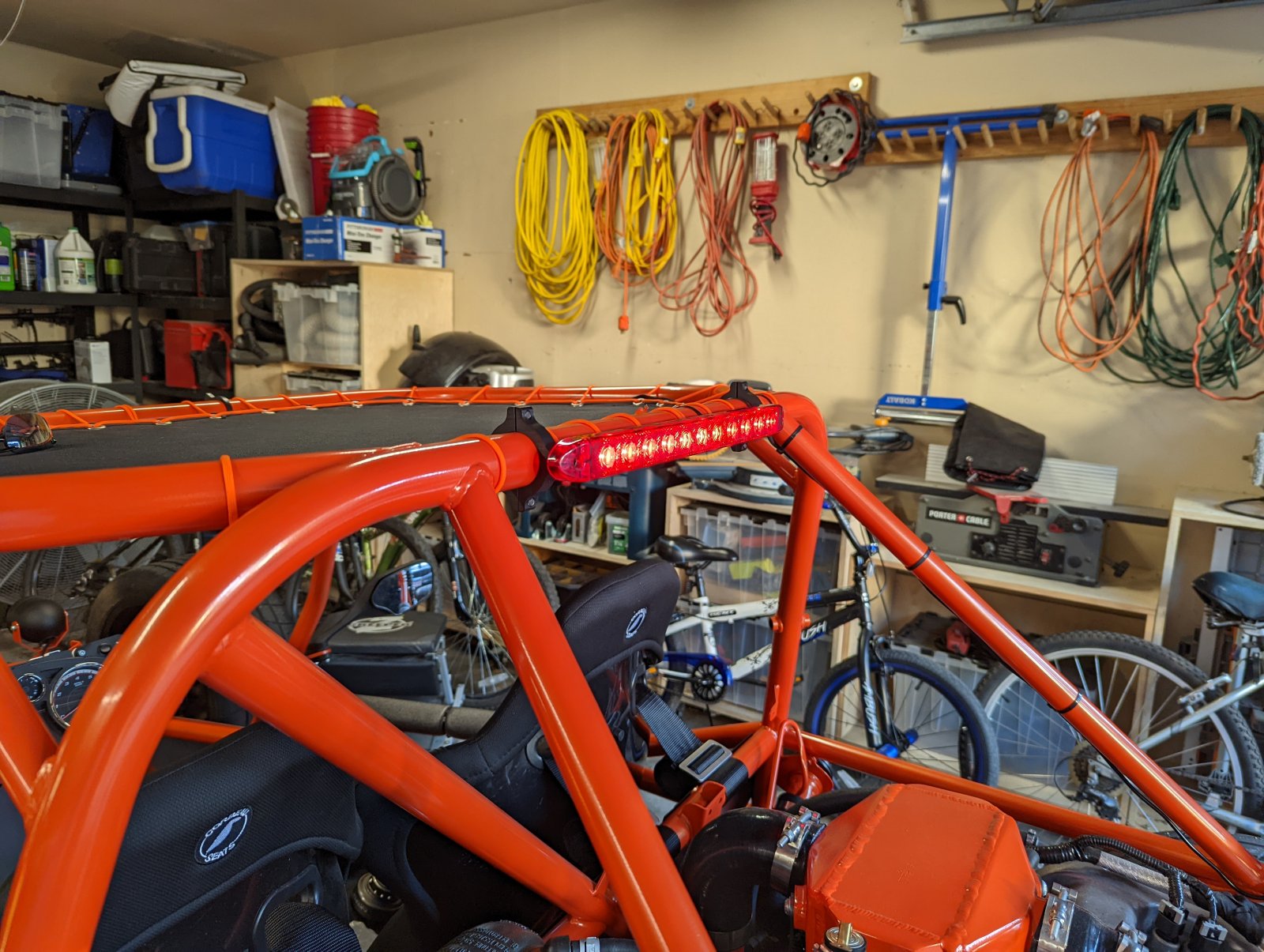

Changed out my 3rd brake light. While the previous one worked, I just wasn't happy with it. Used an LED brake light and got some brackets from speedway (or was that summit) that worked well.

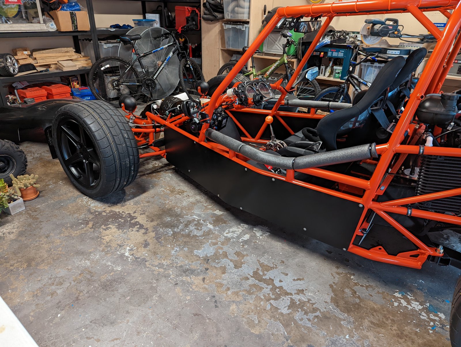

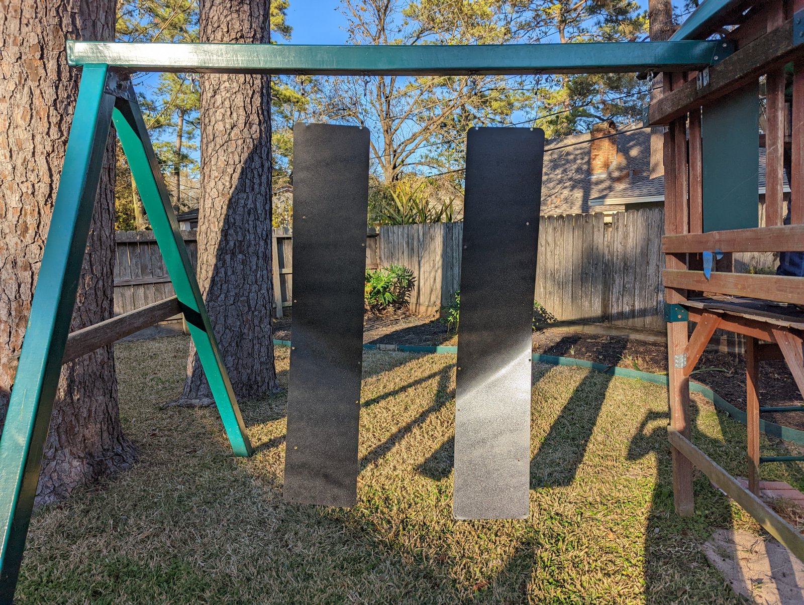

Also, trimmed the back end off the side panels, added rivnuts and painted them with Herculiner bed liner. Also, added some foam tape between the panels and the frame. I think they turned out well.

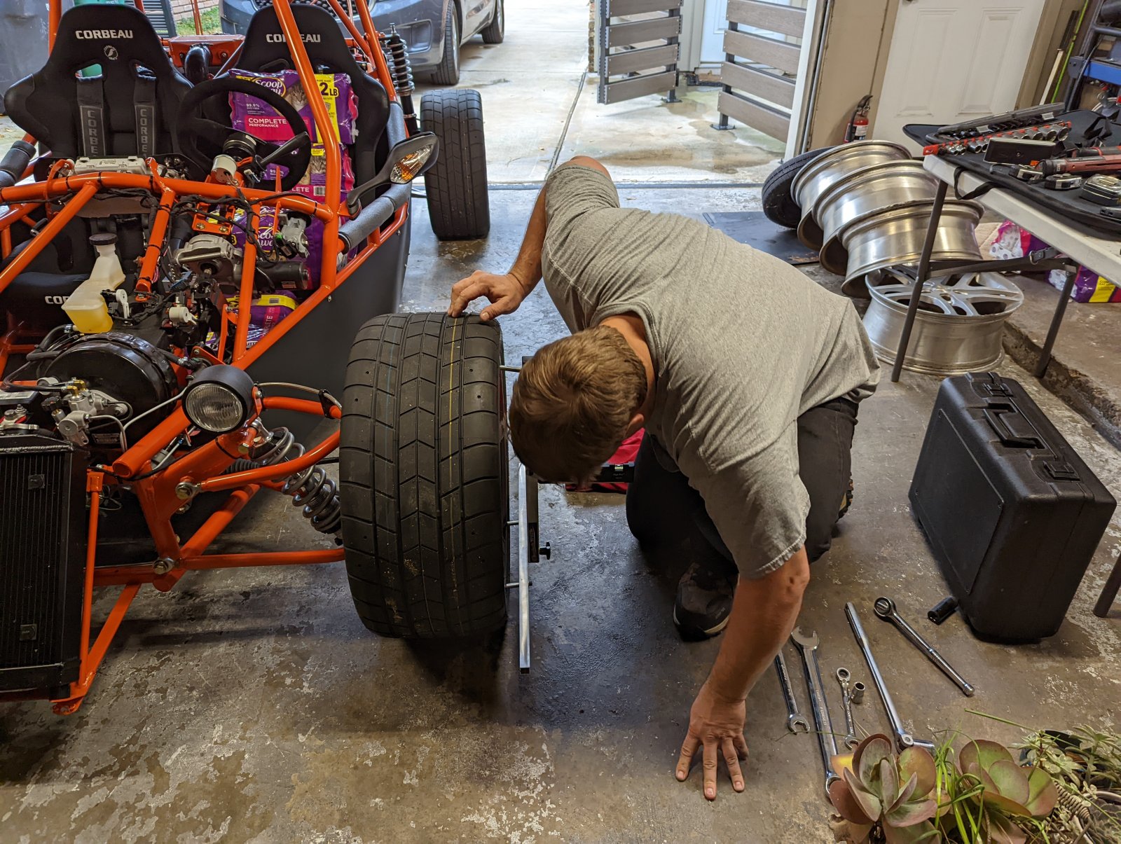

Russel (Rotty) also came by and helped align the car. Then we went for a drive around the hood to make sure nothing fell off. Seemed solid.
Headed out for the March 6th autocross. Thank you JBINTX for the trailer loan and Rotty for towing it.
PXL_20220209_231728543.jpgPXL_20220209_231741515.jpgPXL_20220211_223909560.jpgPXL_20220212_155336763.jpgPXL_20220216_224217453.jpgPXL_20220227_230958712.jpg
Russel (Rotty) also came buy and helped align the car. Then we went for a drive around the hood to make sure nothing fell off. Seemed solid.
View attachment 30950View attachment 30951View attachment 30952View attachment 30953View attachment 30954View attachment 30955
