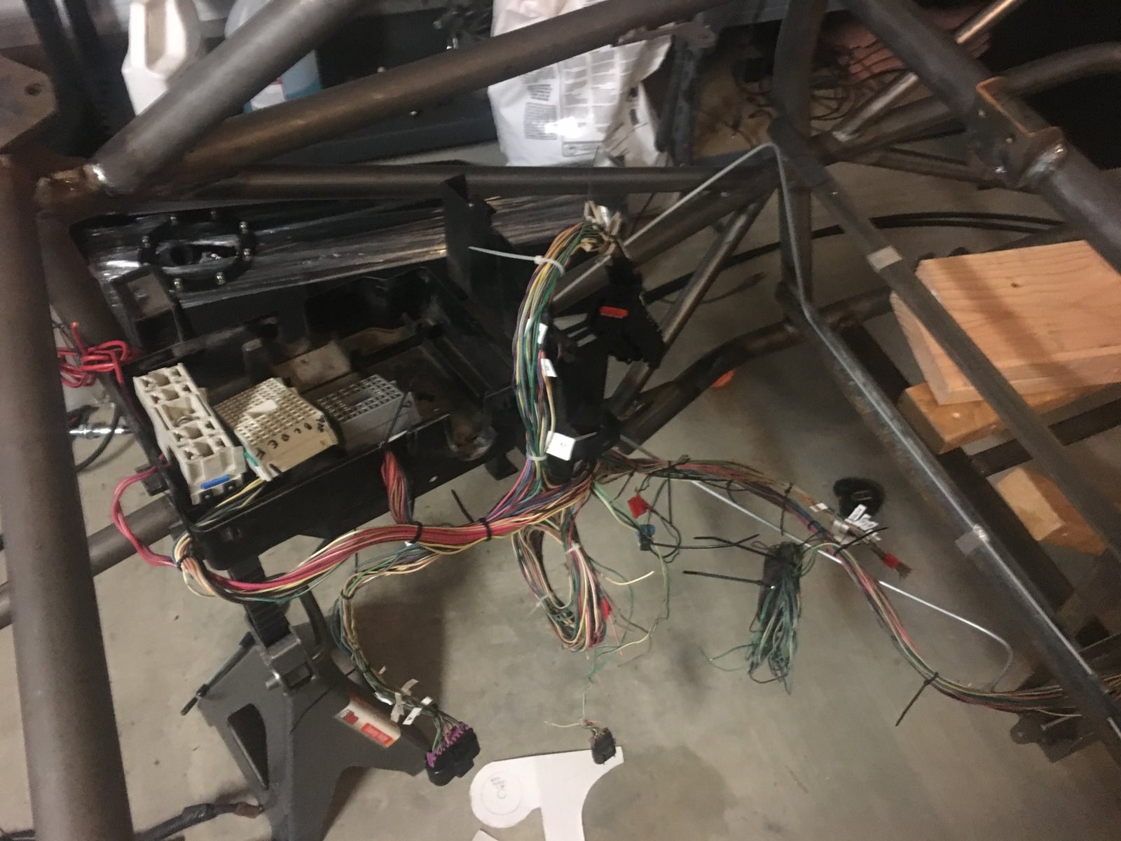

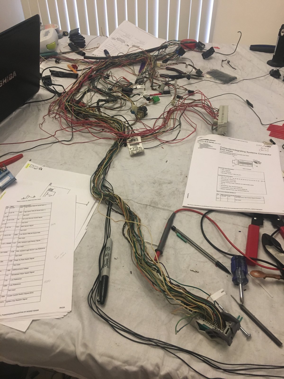

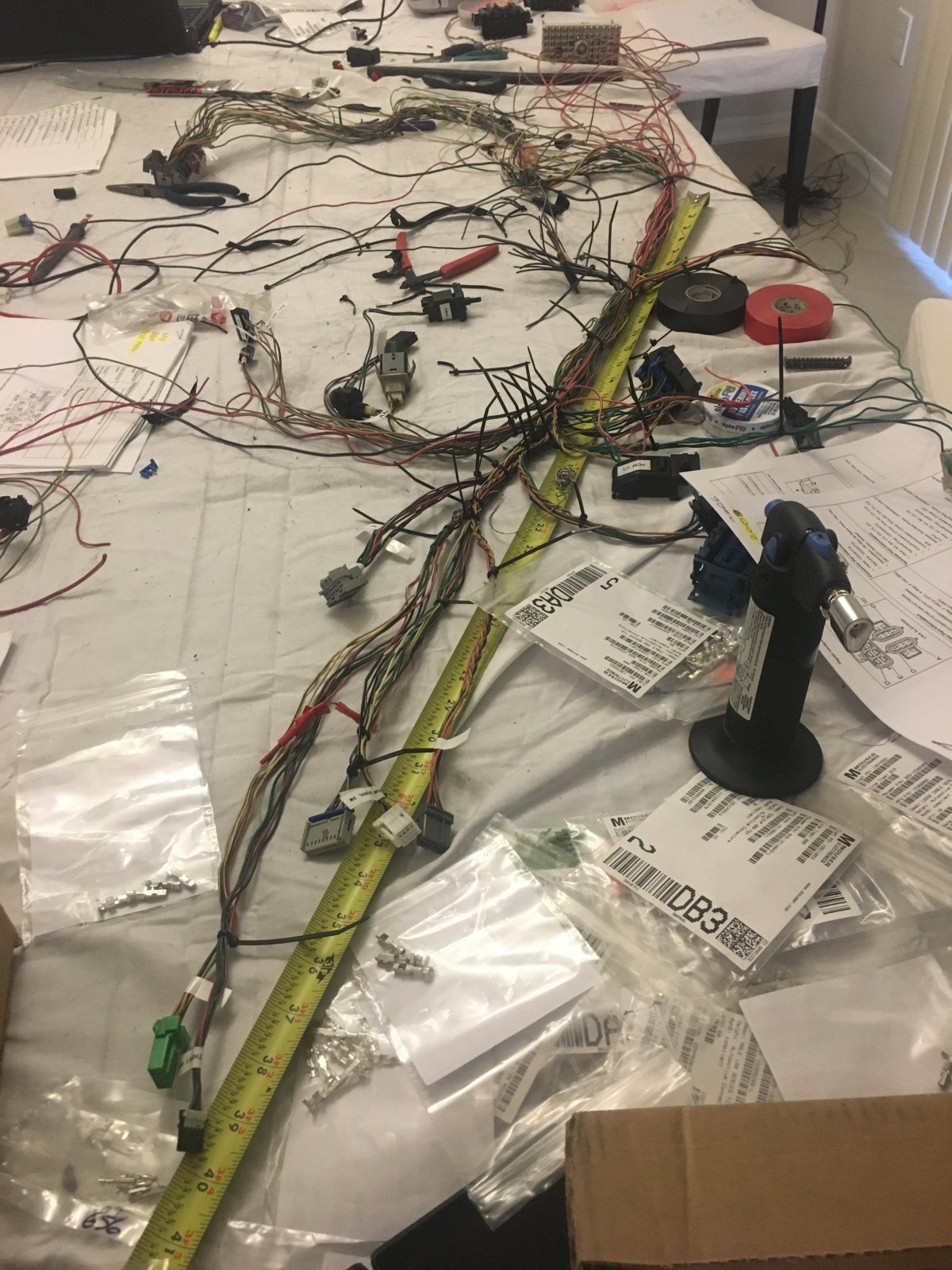

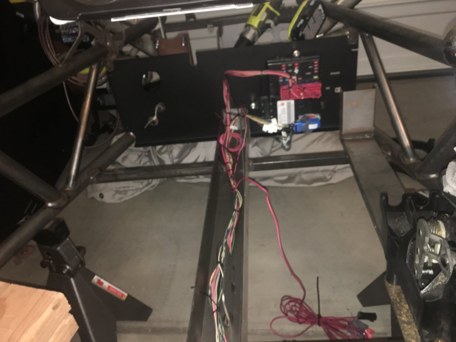

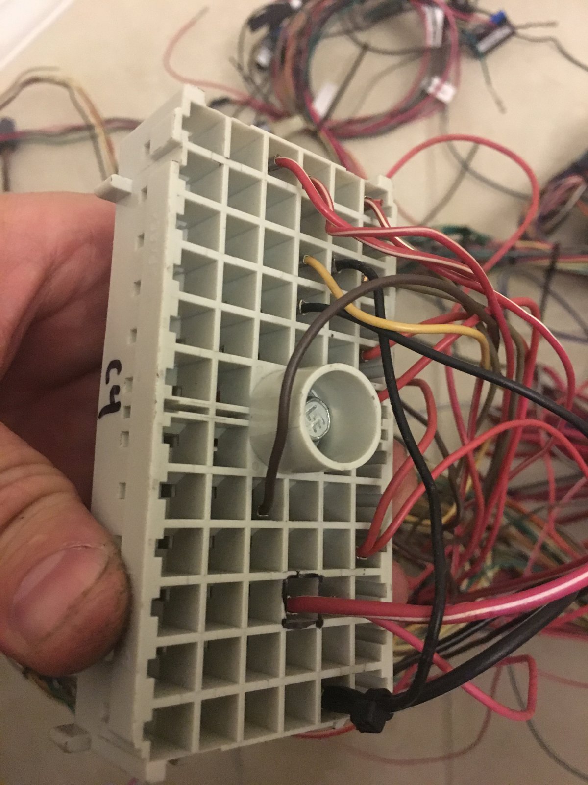

Got the body harness out to the car this weekend to check the mock-up fit. Everything looks good. I brought the dash harness in and got started on it. I had to pin in/add the CPP and brake position wires as the 2006 harness does not come with them. I had to remove and swap a pin on the instrument panel connector. I centralized all of the dash grounds to a single location. I will use 2 ground terminals. I found that using a torch works great for re-soldering the multiple ground terminals. I cut back and repinned the body harness X4 connector terminals to make everything an even length. Next I will build the extension harness for the body harness C201 connector.
Running into a bit of a jam with the driver information center button circuit. The 2009 uses a slightly different switch circuitry and so far I’m having no luck finding the wiring schematic for it.

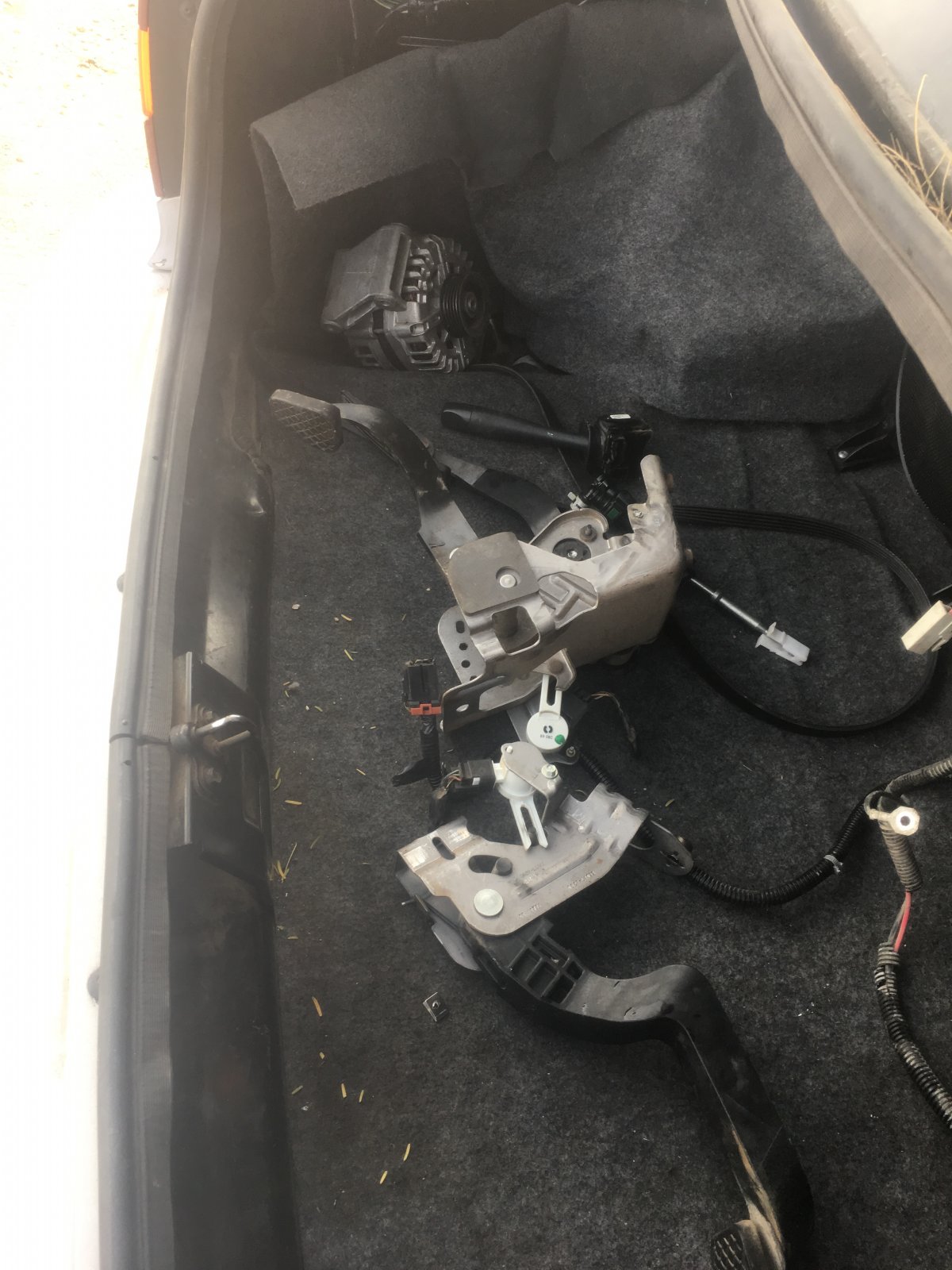

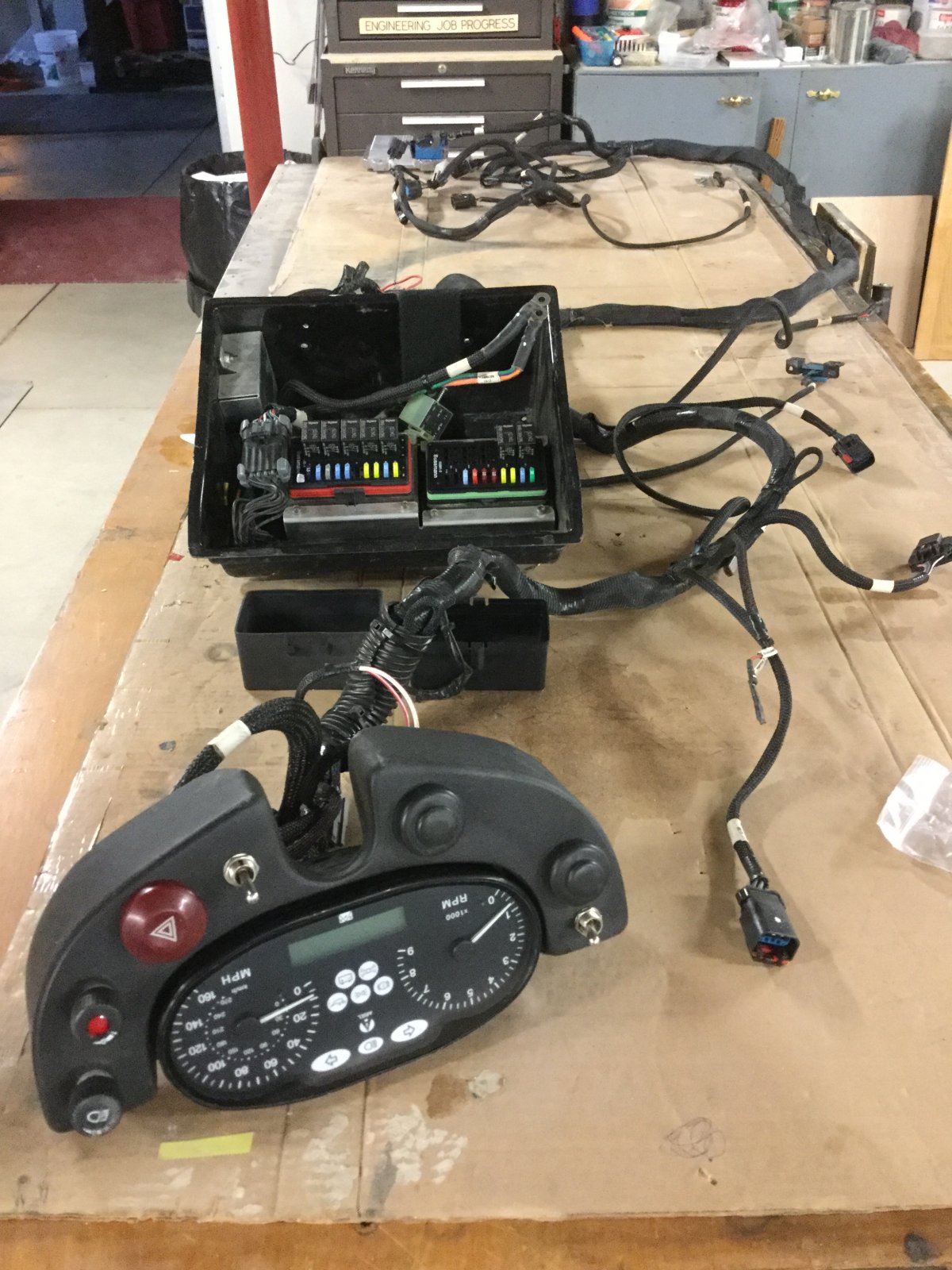

Its been a little slow lately as I’ve been busy with several other projects. My next goal is to fully mock up the dash & body harnesses to check fit. I ordered & received a new fuse box/ECM mount for the Bosch E69. I drove 100 miles to the pull your own yard today in Phoenix and picked up clutch & brake pedal assemblies out of a 2010, as my 2006 pedals are not compatible with my setup. I also grabbed an alternator.

Much of my time today was spent brainstorming and drawing up diagrams for my added circuits. I decided to integrate my fwd rad fan and liquid to air radiator fan wiring into the main harness. I will run the ECM relay trigger for the L2A radiator straight to ground as well as for the pump so it they always run with the key on. Its a bonus that my donor came with the pump, engine pump mount, and a dedicated pump relay. The 12 gauge wires will connect with a 3 pin 630 series Delphi plug off of the main fuse box.
I am going to run a pw modulated dimmer rotary switch for the instrument lights and junction all of my dash & switch lighting at a terminal block. I jumpered the factory dimmer pins inside the BCM connector.

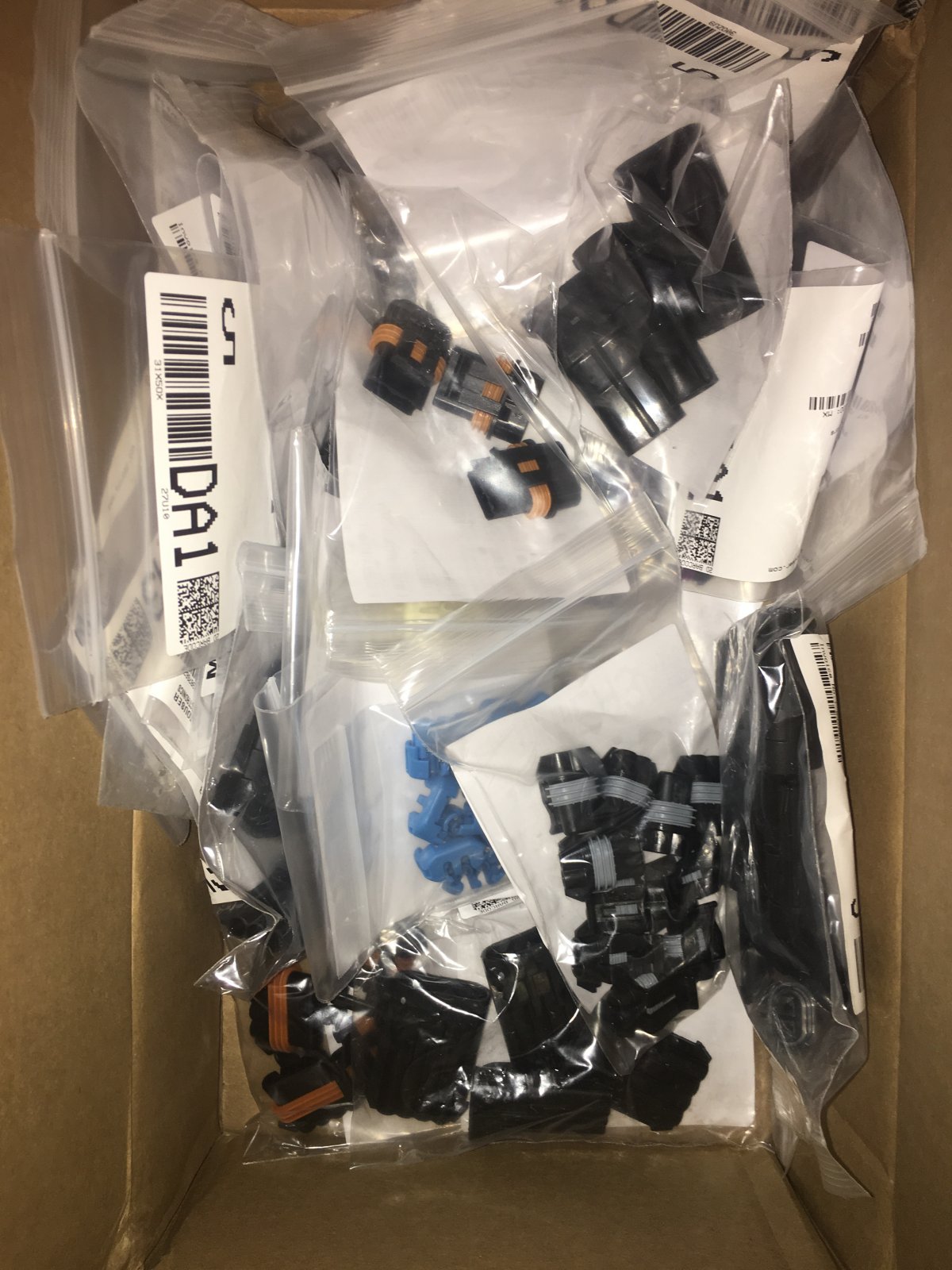

I just ordered 20 or so various 2,3 & 4 pin Delphi 150 series sealed connectors for all of the lights, turn signals, horn ect. I’m hoping one more solid weekend on this harness and I will be ready to do a mock up and functional test. I plan to have the harness fully completed, tested & wrapped prior to even beginning my stage 1 build. It will look factory made.

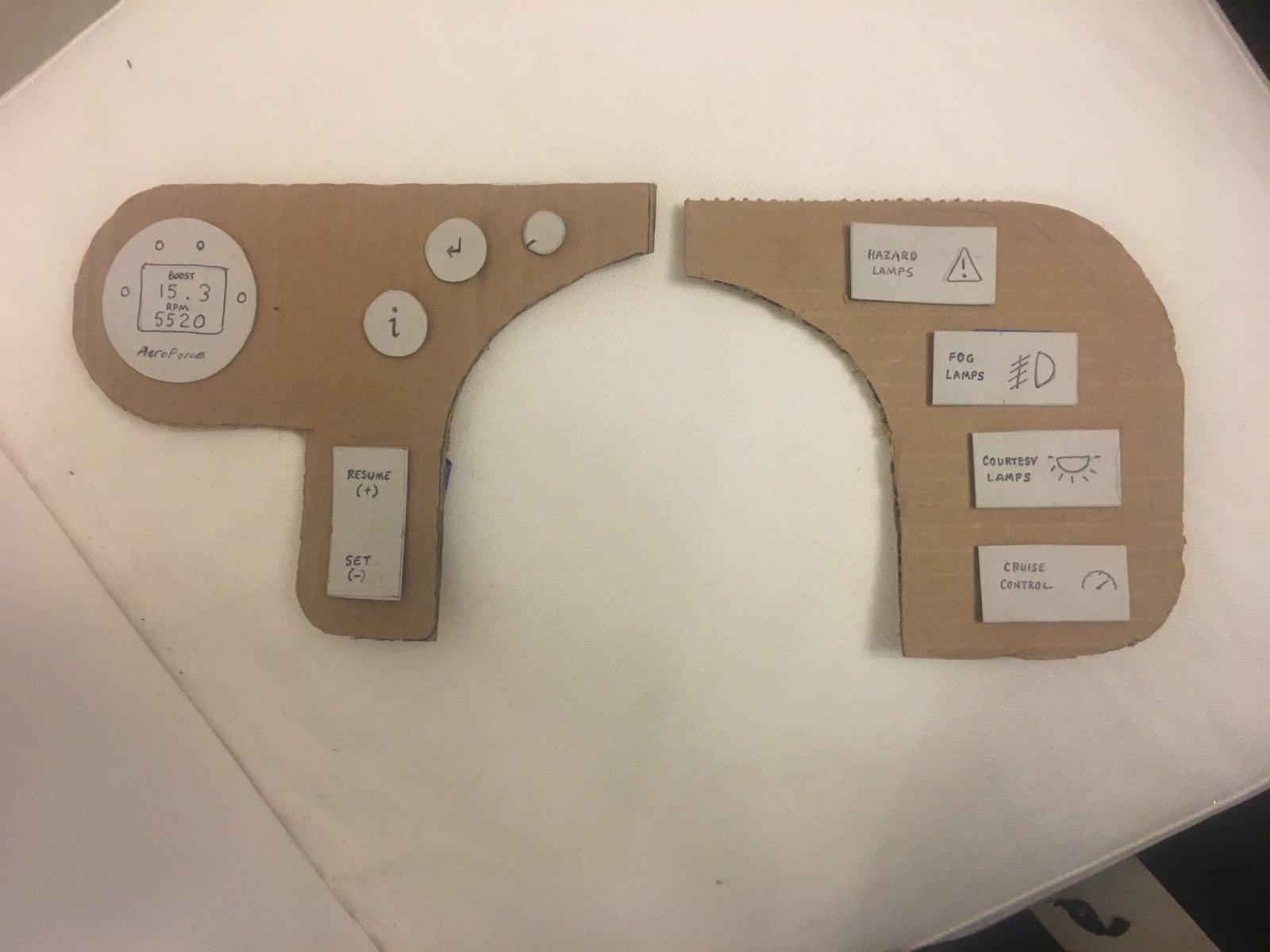

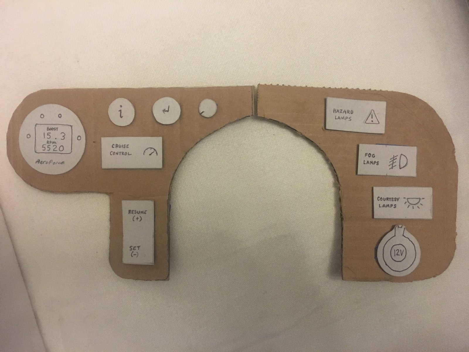

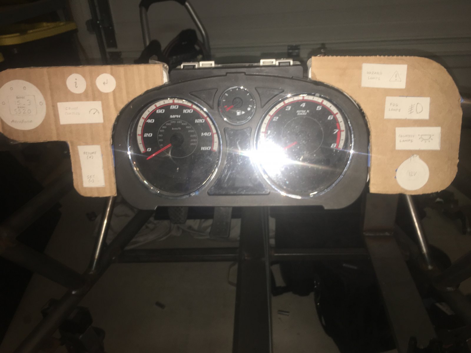

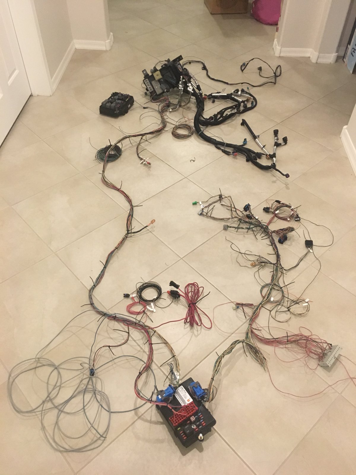

Started rough mock up on my switch panel today. I was going to go with the billet round black buttons but they have no backlighting behind the etching, making them difficult to see at night. Instead I am playing around with ideas for using V series Contura toggle switches. The panels will be cut from 16 gauge steel and powdercoated to match the frame. All the switch rockers will be custom etched. Horn switch will go on the steering wheel hub, using a coiled cord.

I like the direction you are heading with the panel. I too will go down this path, as I would like to retain the cruise and have some sort of radio.

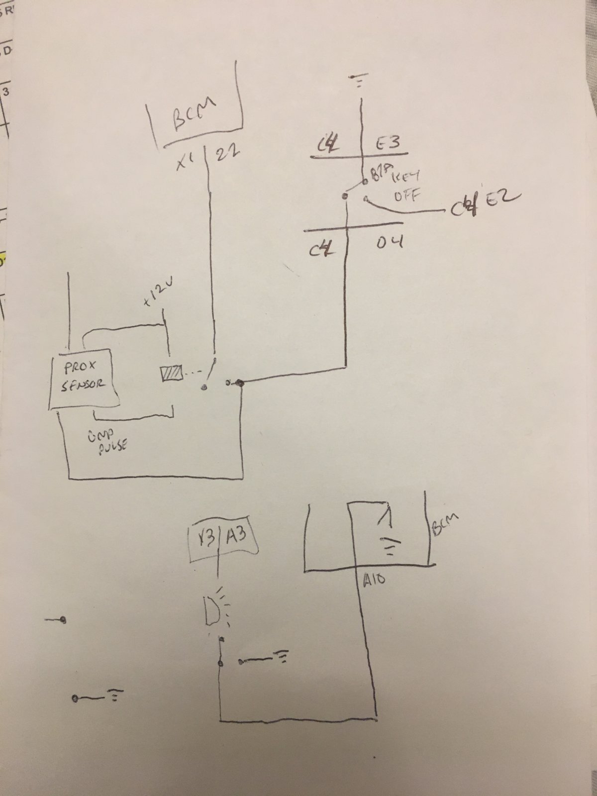

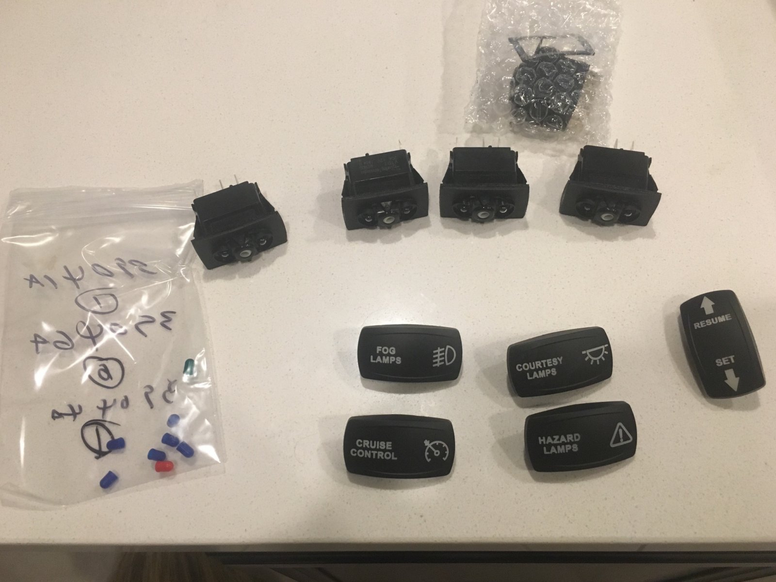

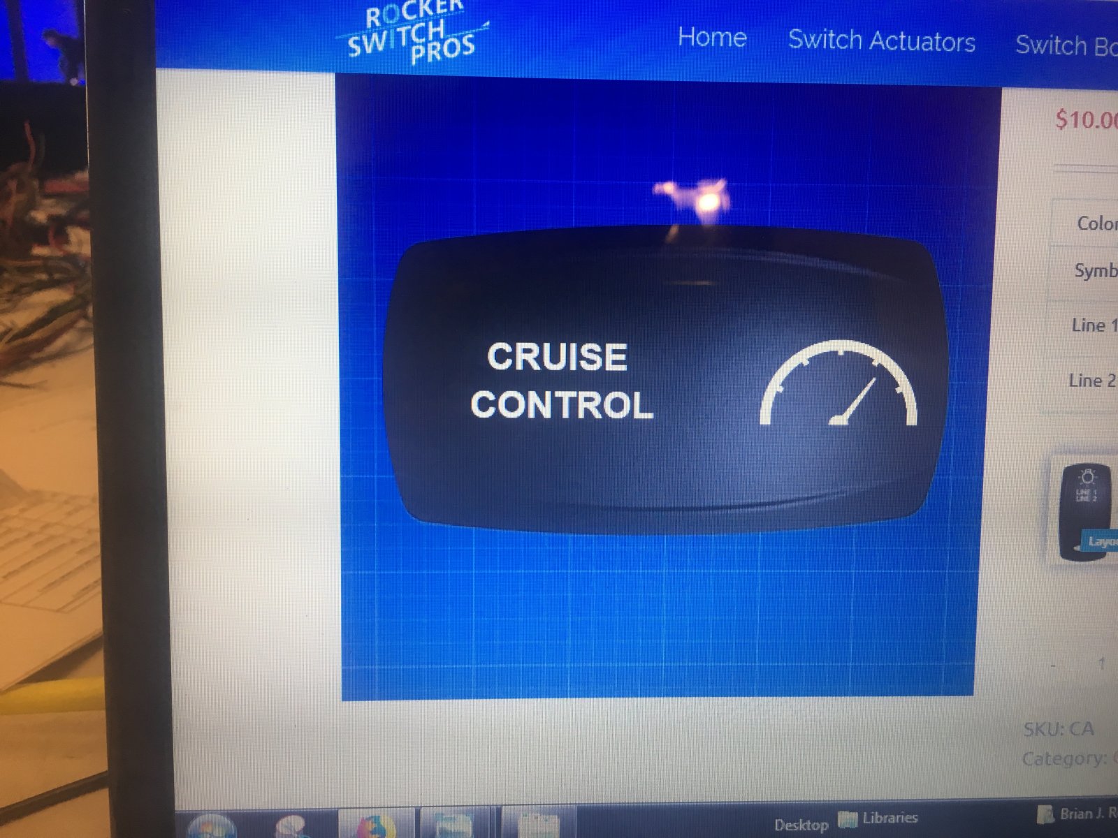

I found that nobody in the world seems to have the Contura SPST switches with dual blue led backlighting, so I ordered the white led ones. I ordered some colored led caps from an led store; hopefully that will suffice. For future reference those caps are 5mm wide. I’ve also drawn up the schematics for which pins to solder my new cruise control resistors on to the momentary dual pole switch.

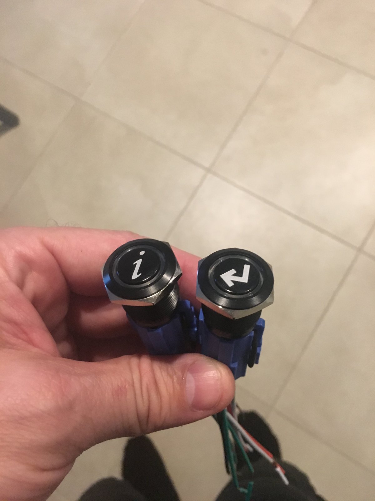

I ordered 19mm billet buttons in anodized black for the info center switches. I am having them etch the info center button logos into the center of the buttons.
All in all, I came out around $250 for all of the switches & buttons.

Rewired my BCM blower relay to be a ground switched relay. When key is off, that relay will supply a ground for the motion sensor to activate my courtesy lights by sending a ground signal to the BCM door switch sensing trigger. Since I am using the factory circuit and controls, it will do a soft turn off after 20 seconds. When key is turned on, it will drop that ground and switch off the courtesy lamps. I am using a triple throw dual pole rocker switch which will can turn the lights on, off, or motion only.

Changed my switch layout slightly. I will relocate my accessory plug down near the floor. I pinned my factory dimmer wires together at the plug and will instead be using a pwm dimmer switch for all instruments and switches. Still waiting on my info center buttons.
Got a huge order from mouser with all the connectors to do my lighting and cooling fan harness. Every connection on this car will be environmentaly sealed using GM factory connectors.
