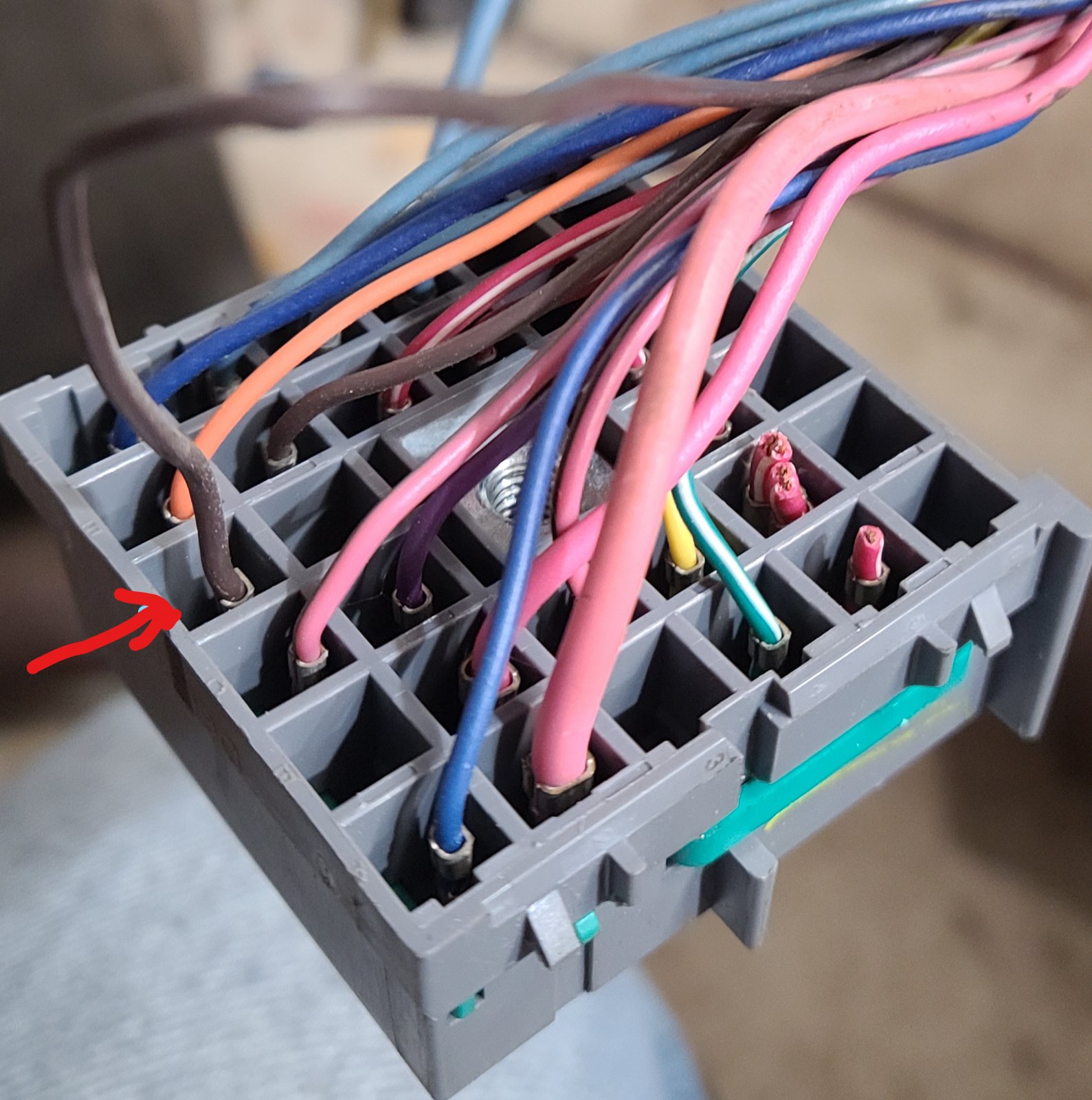

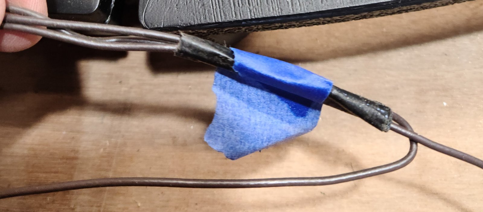

for turn signals and brown wire. is that from the headlight or should there be a different brown wire that is soldered to the red turn signals
C
i went back through the video and found the brown wires that should be used, however it says they should be cut already. 5 brown wires at a taped junction. I found the junction and the 3 wires that pointed to the fuse box were loose and go to the taillights. the other 2 are not cut. one goes to the Bcm the other goes to what I think is pin D1 of the gray multiplug in the fuse box.
Some donor models have more marker and tail lights than others. Tie into those brown wires with a wire long enough run to the two red mirror wires.
