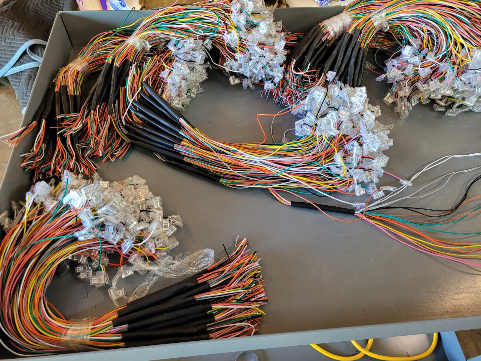

We received our pre-wired button harnesses.

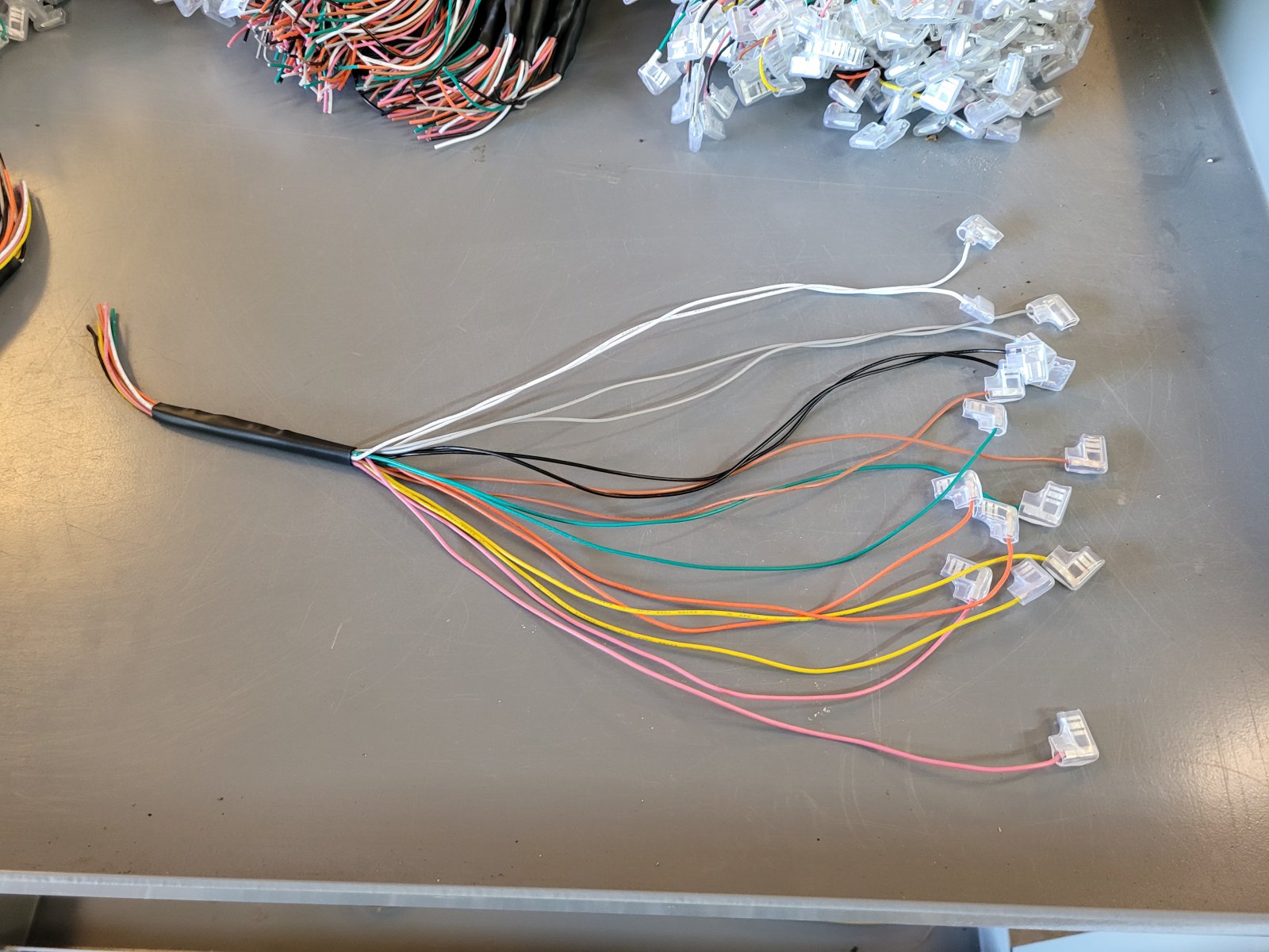

One end matches the wires coming from your dash harness and the other ends are pairs that go to your buttons and already have the correct resistance pre-wired.
This makes it super easy to wire buttons wherever you want them.

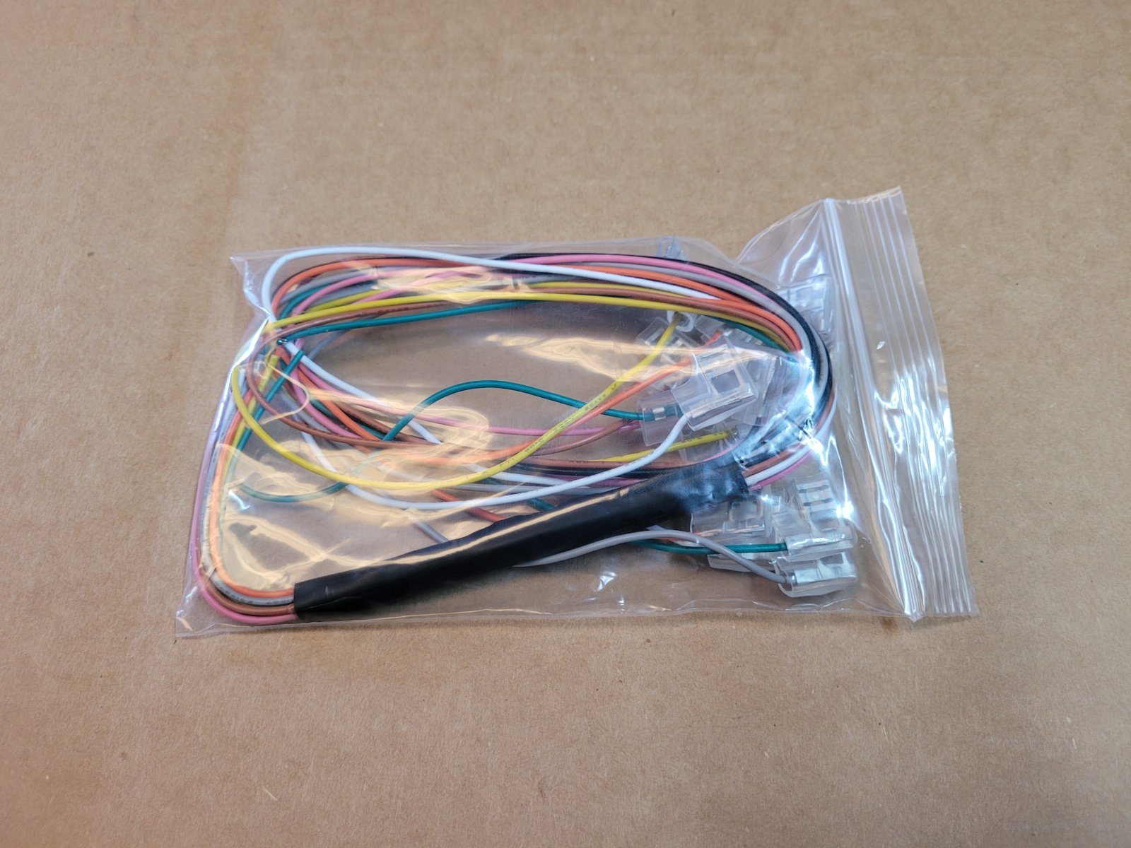

Wiring harness only (early or late model). $40

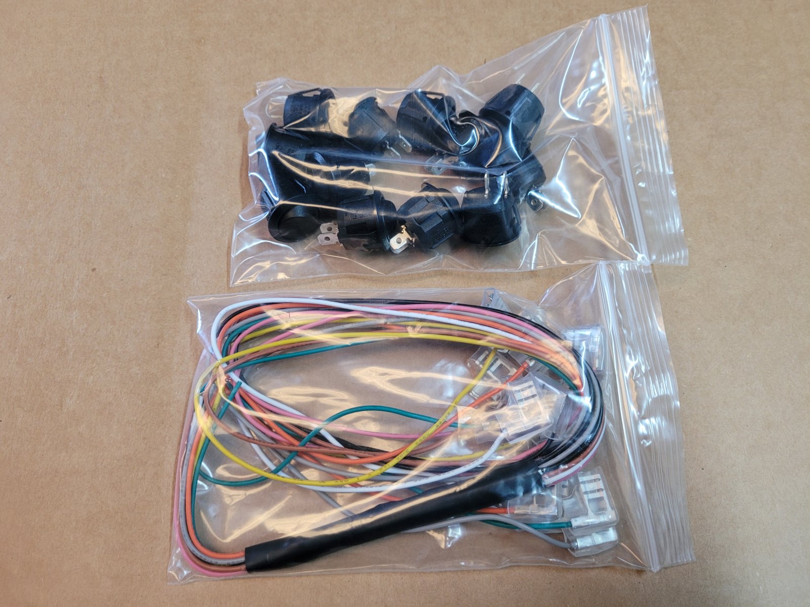

Wiring harness with 9 buttons. (Three toggle buttons and six momentary buttons) $70

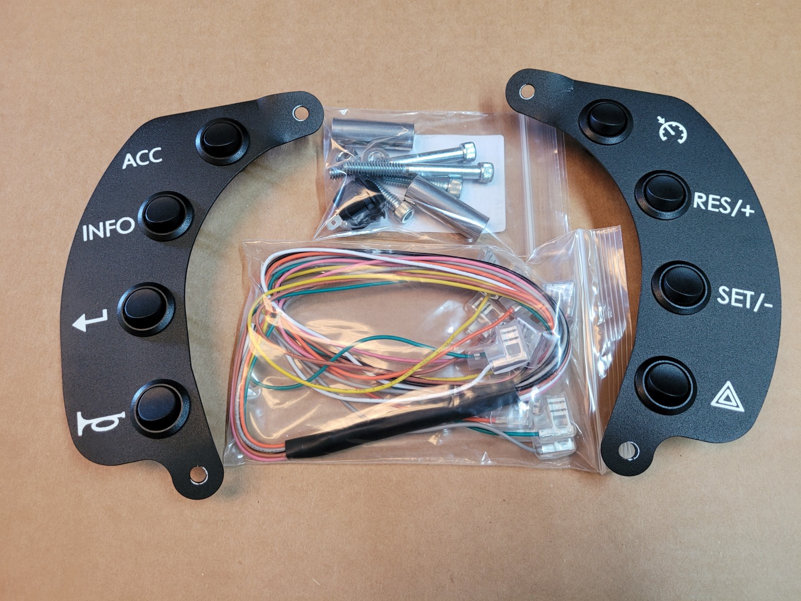

Wiring harness complete kit. (harness, hardware, and button panels) $175

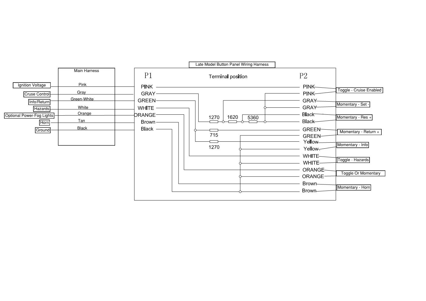

I attached a PDF for those of you that are curious.
Also, the harnesses will be shipped with a chart indicating which colored pair is for each button.

Do the button panels come with the longer bolts and spacers? I cannot for the life of me figure out how to mount the panels (my kit 2006 ss/SC) did not come with those bits.
Thanks
C
Ok thanks. I got 4 small spacers, short bolts and nylons nuts. The long bolts and long spacers must have just been missed when packing. A trip to the hardware store solved it.

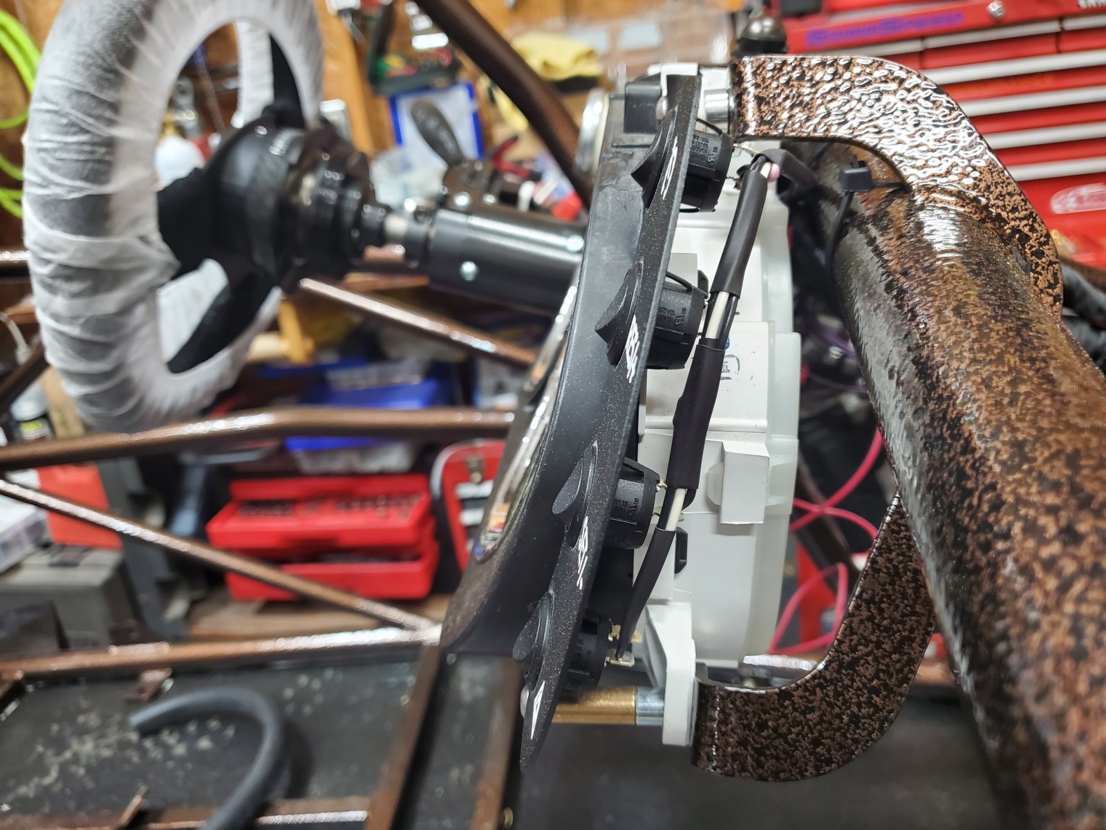

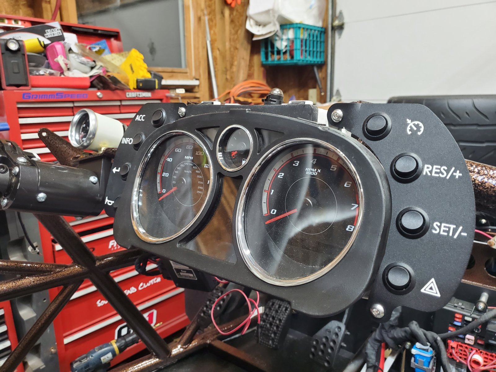

I got the standard gauge mounting hardware like you mentioned with the four short spacers. But I also did not get the spacers with my button panel kit. What did you end up using to make the buttons fit? Do you have any pictures?
Sparvy
I bought a pair of brass (just got the brass because it was a length I needed) and steel spacers along with longer bolts from a local hardware store. If I remember correctly I got 2" long bolts (2.5" would have been better) in order to push the bottom of the button panel out closer to the outer gauge face edge. I may also put longer bolts and spacers on the top as well so the gauge cluster plug can be unplugged without having to unfortunately it from the frame.

Appreciate the pictures. That's what I'll do. Thank you for your response.

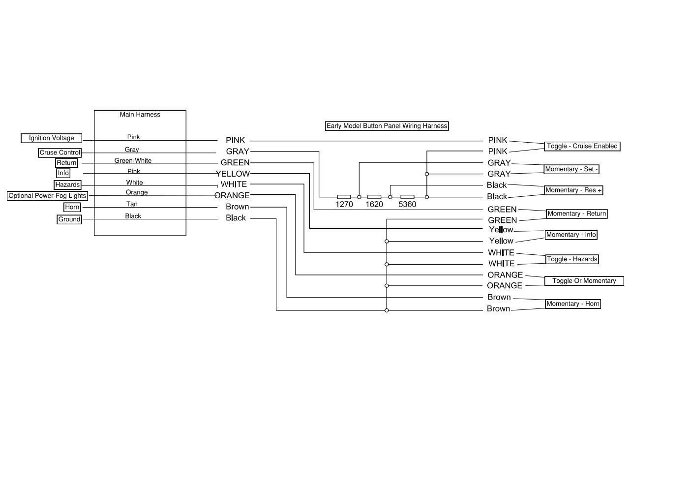

Because I'm a simpleton and like things crystal clear, this is my understanding of the button wiring
It wouldn't be the worst thing if someone wanted to double check this for me. :)
