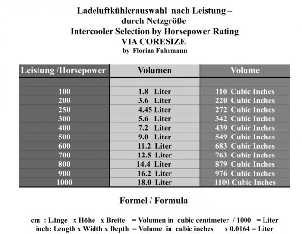

My 2 cents: the intercooler and heat exchanger sizing is critical to making good HP - obviously - but the sizing is the key. The DF intercooler, at a 9.25x3.5x3.5 core size, has 113 cubic inches in heat transfer volume. This core is at the theoretical low end of sizing for a 260HP LNF, which is good enough for a street driven car at moderate ambient temperatures. The matching heat exchanger - not sure what size is supplied by DF - must be equal to or larger in core volume to adequately remove the heat from the intercooler, given adequate air flow.
The attached chart from a German racing source gives approximate sizing, with some generous margin, for intercooler core sizing from a race car application. Cutting this core sizing in half would define a more than adequate intercooler size for a street Goblin.
From this chart the 113 cubic inch DF intercooler, based on the 1/2 sizing from the chart is good for just over 200HP plus generous margin. So it is right at the low end of providing adequate cooling. Uprising from the DF intercooler for any increase in HP from stock is a must, especially if driving in warmer temperatures.
I have taken this to heart and will be installing a larger intercooler with a 11x10x4.5 core with 492 cubic inch volume to compensate for the much higher ambient temperatures in Phoenix and the planned bump up from the stock LNF 260HP. And didn't forget about the heat exchangers - dual KZ750 radiators at 500 cubic inch volume. ;)

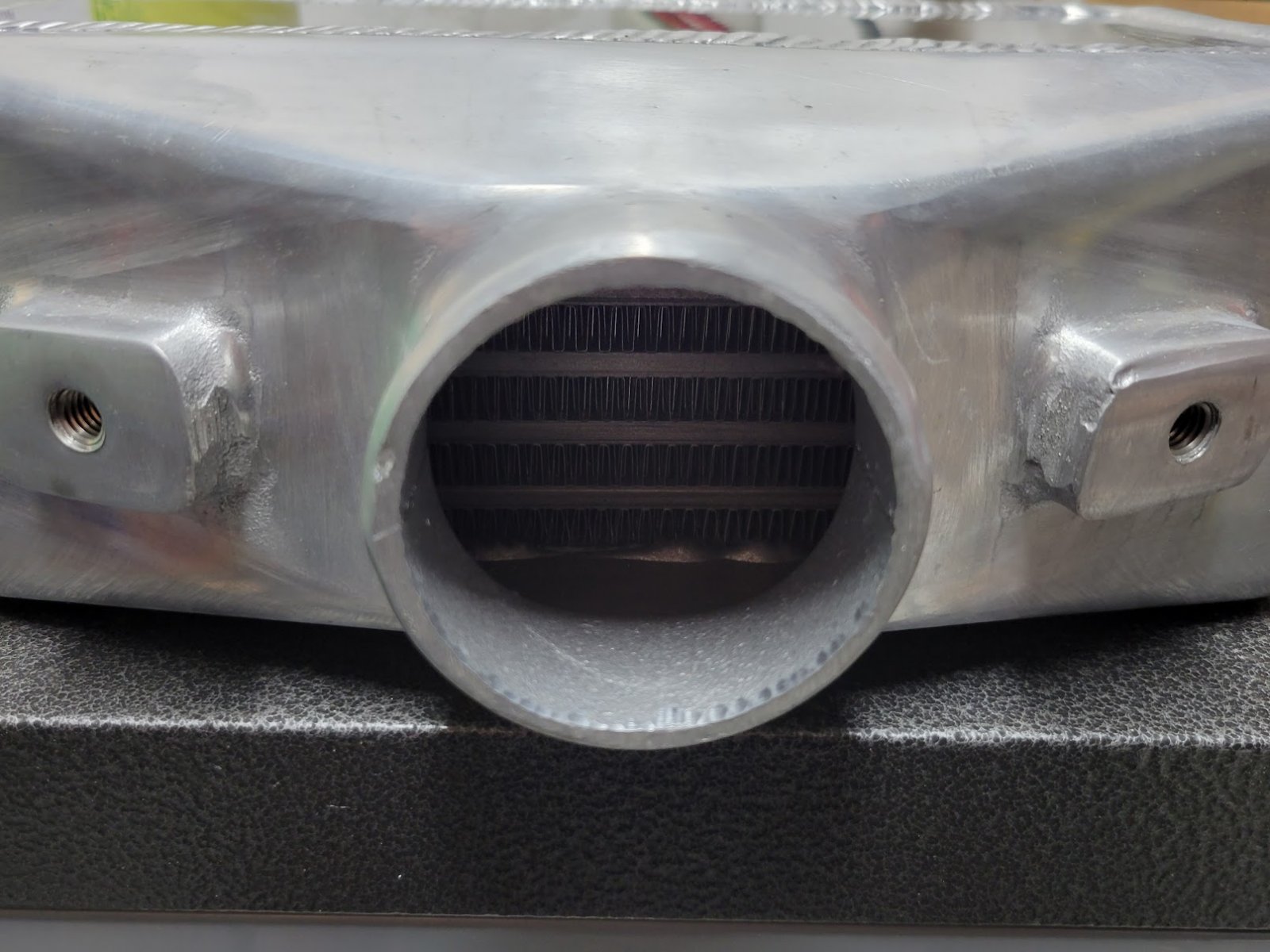

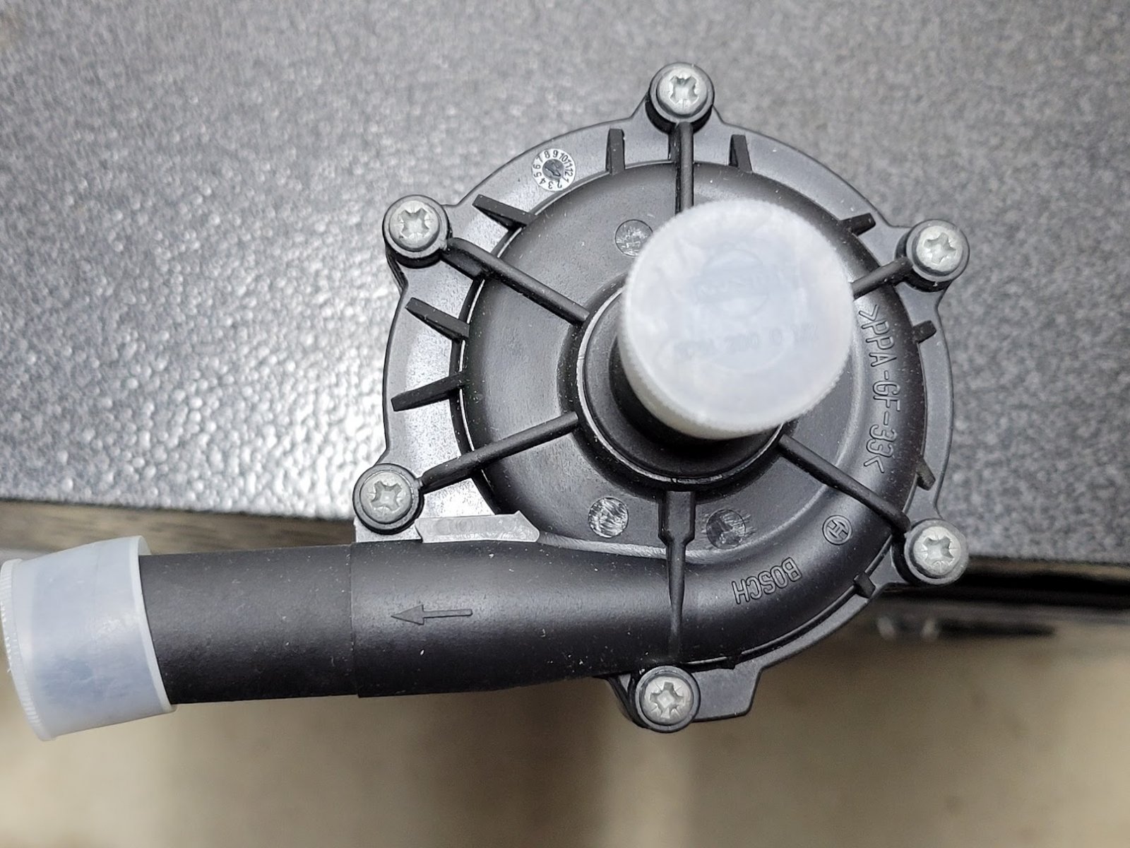

TC/LNF Air-to-Water folks: Does DF supply the intercooler bracket (for Type 16 ICs) or do I need to fabricate or buy it 3rd party? Some of the threads mentioned a supplied bracket. I reached out to them via email and they're looking into it. If there's a part number that would be helpful.
Also, do you guys run your water lines underneath the car along the floor, or do in the tunnel with the wires and shift cables :eek: ?
Lots of bits have arrived, waiting for some plumbing parts. I want to get this part DONE. :-)
Brett
I have DF made brackets for my air to water intercooler. Not sure of the part number.
I ran my lines in the tunnel alongside everything else.
Water Lines are ran through the tunnel. The temps aren't that high. It's really just pex plumbing tubing. The brackets came with my kit but I don't have a part number.

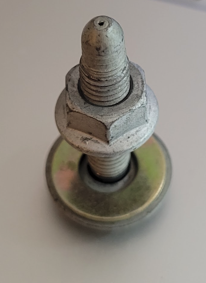

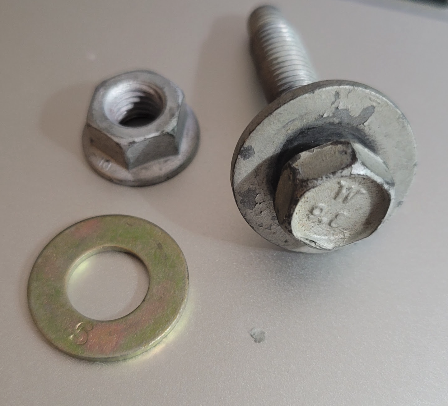

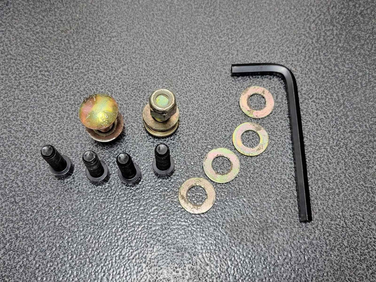

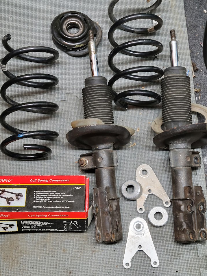

While waiting to hear from DF about an intercooler bracket, I took a look at the rear suspension assembly work. I'm going through the car bit by bit, essentially verifying and sometimes re-doing previous assembly. This is not a knock on the previous owner, it's just if I'm going to track this thing I want to know precisely how everything goes together and verify it's all good.
The previous builder used what looks to me to be M6 property class 9.8 bolts on the tabs that hold up the rear shocks/springs. My current understanding is that equates to an SAE Grade 5 bolt, which strikes me as not strong enough for the intended use. These appear to be donors from the original car, and don't look like alloy steel. Like many of the parts installed on the car, these were only finger tight when I received it, and trying to secure and torque to a moderate torque resulted in a snapped bolt.
What are you guys using for rear suspension mount bolts, and what torque spec did you use? I think these need to be replaced.
P.S. This is stock rear suspension, I'm mostly likely going to replace with DF-supplied rear coilovers.
View attachment 26706View attachment 26707View attachment 26708

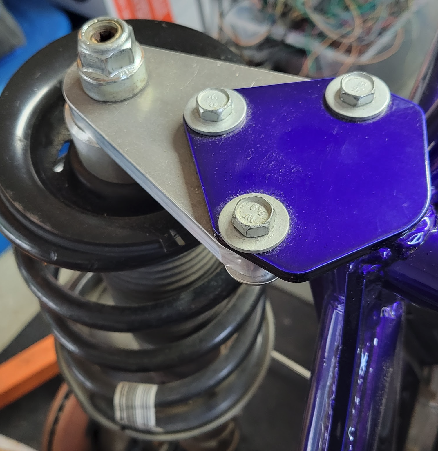

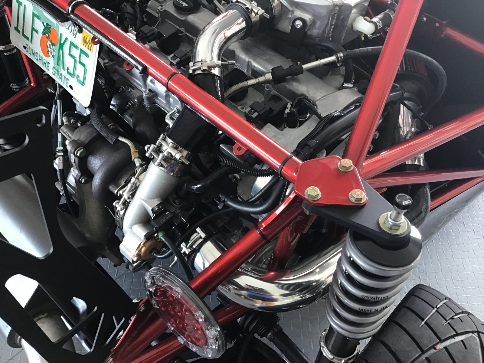

DF rear coil overs with hardware

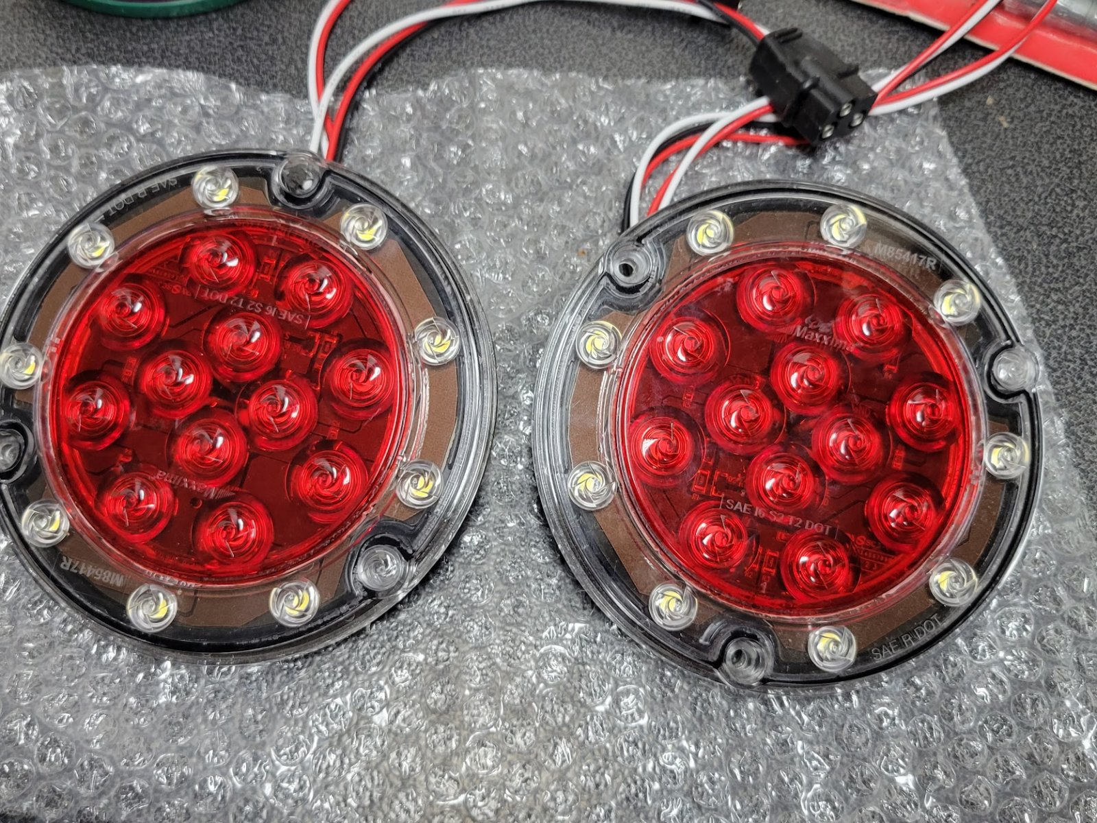

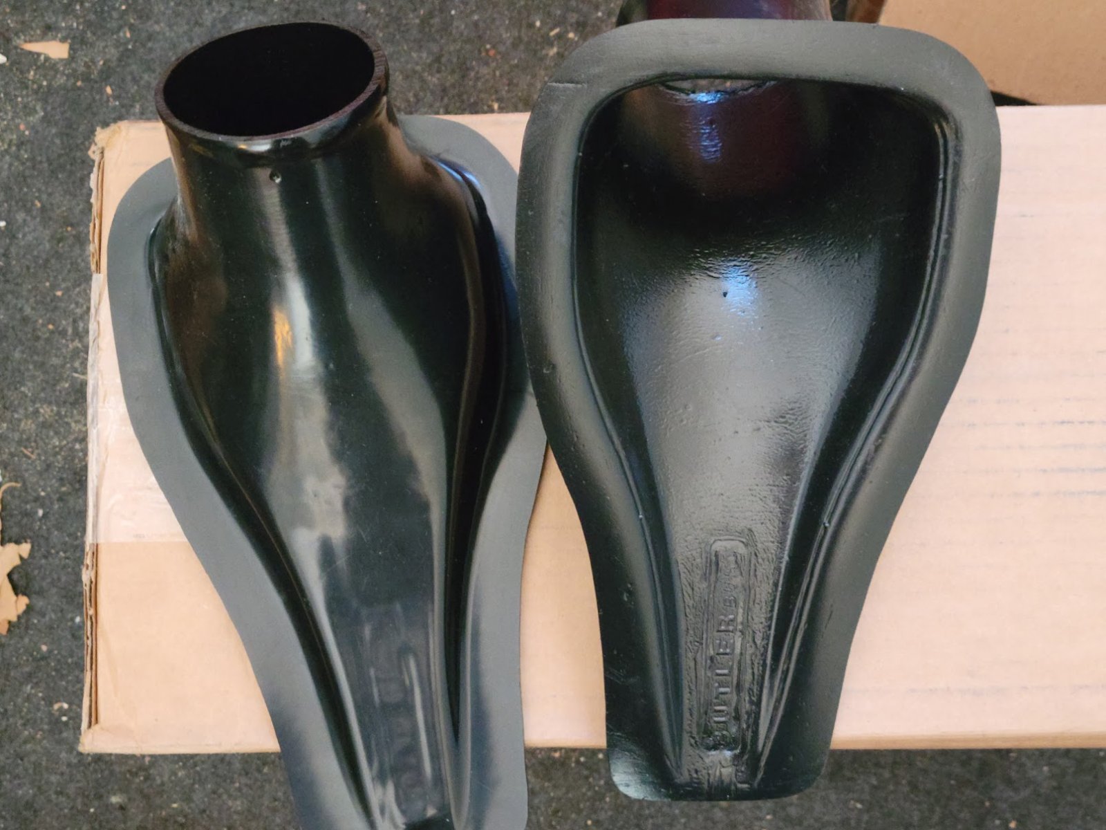

Getting ready for the next phase, parts are rolling in:
26872
26873
26877
26874
26875
26876
26878
26879

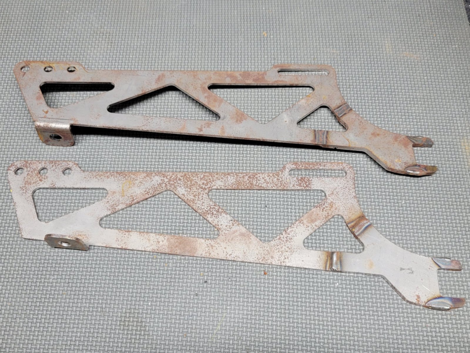

The car has been sitting for a long time, so I removed the seats and brackets. I'm going to clean the brackets up and paint them this weekend:
26884
26885

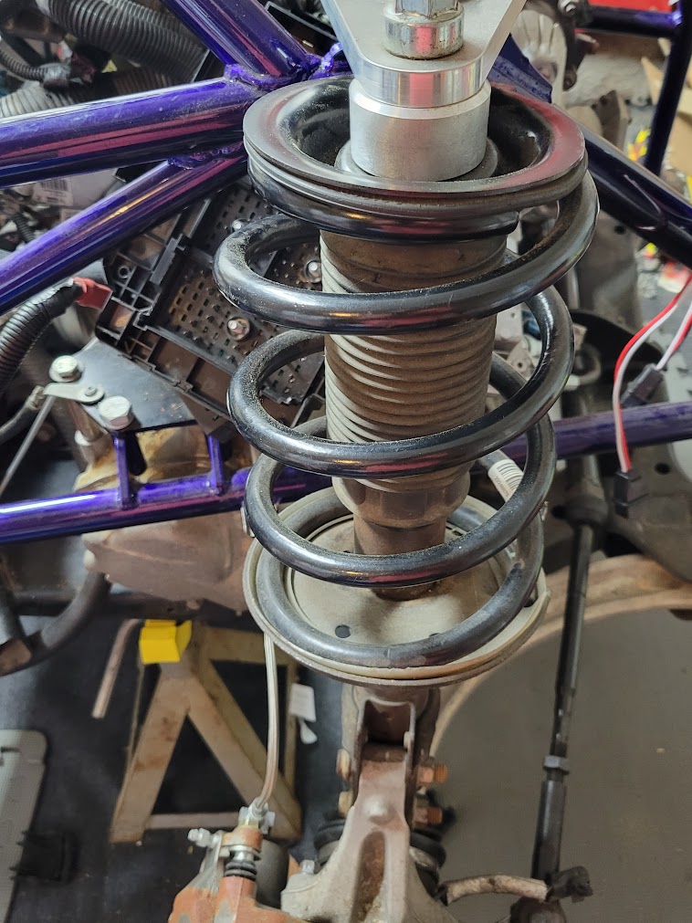

Nobody died and no windows were broken removing the stock rear suspension from #13. New coilovers from DF arrive very soon, looking forward to seeing them on the car.
I also found some really awesome photo albums, carefully disguised under the topic "Helpful Photo Albums" :D which will make sorting out the new rear coilovers easier. There are also some great photos of the a2w heat positioned in the nose, which will help make installation easier there as well. Now if I had just ordered a heat exchanger bracket....

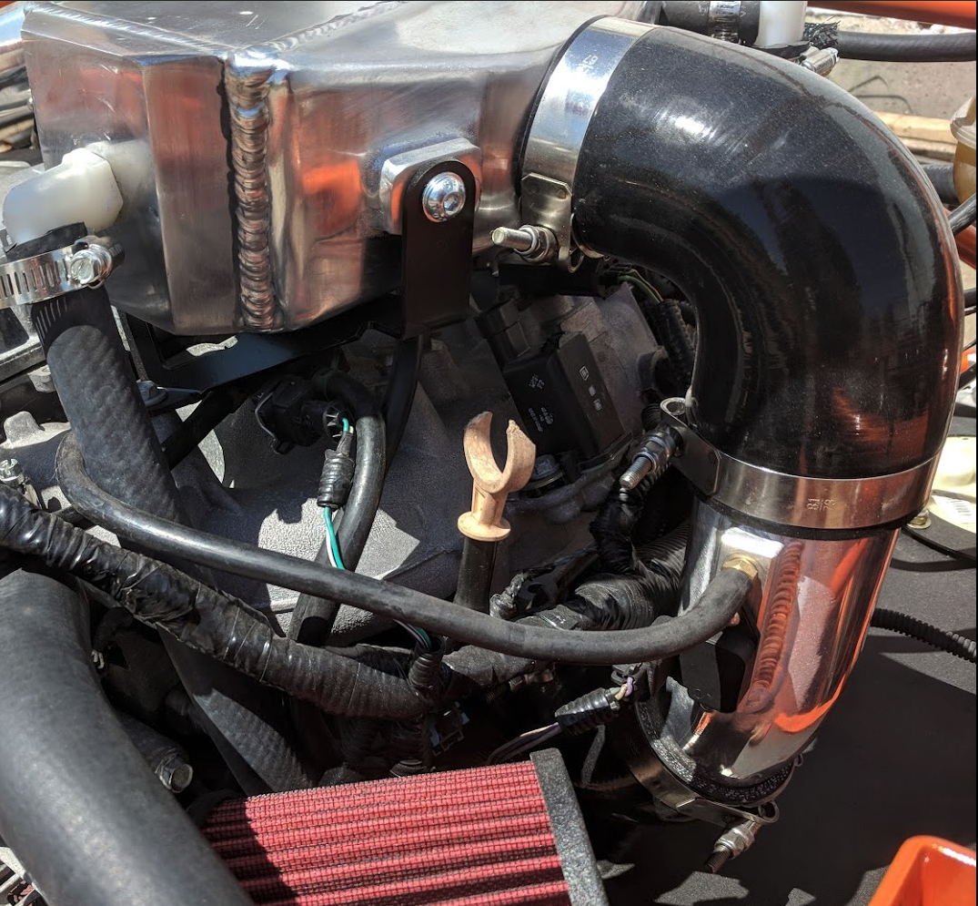

Folks, the pipe in the lower right of the photo (with the small hose and wiring attached)...I know it's part of the intake, but what are the small hose/wires for? I went through all the pieces/parts that came with my kit and it wasn't included. I'm looking to understand the part and figure out the part number/vendor so I can order it. Any help appreciated!
27250
