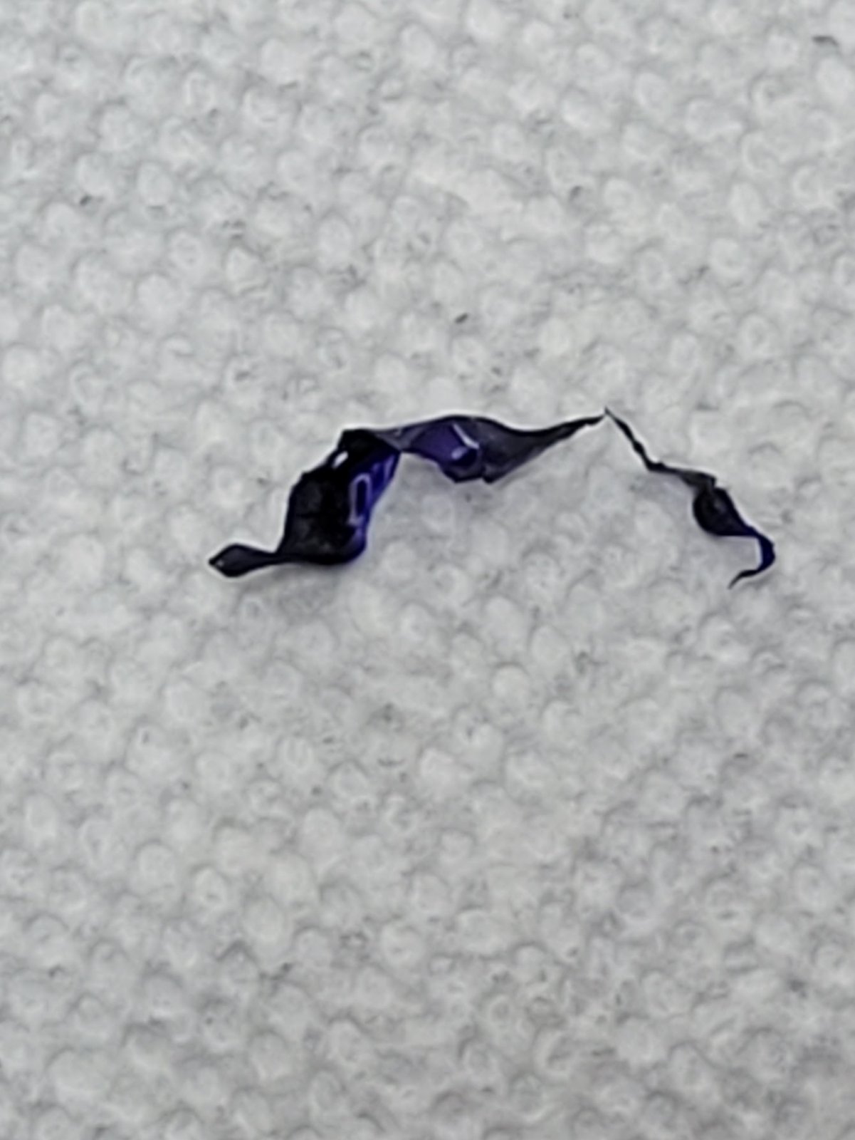

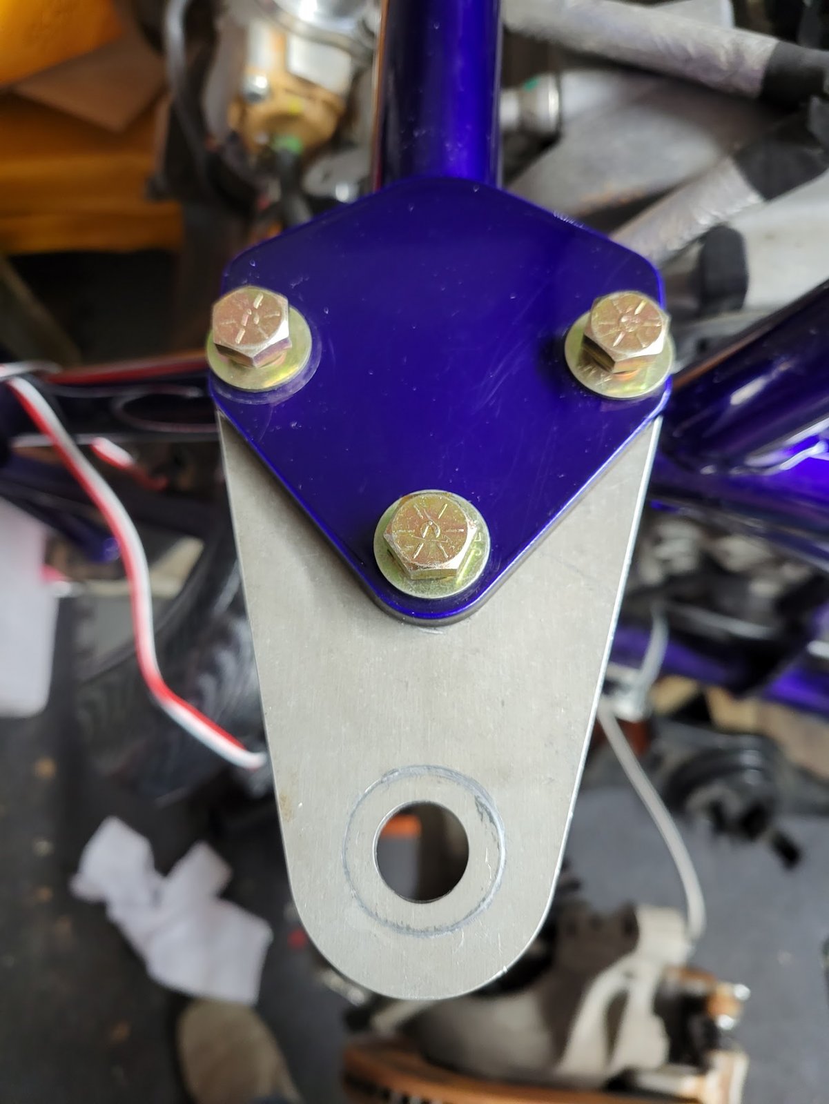

@r3drckt had it precisely right. I grabbed a brand-new 3/8" drill bit, lined everything up straight, and then went low RPMs and slow. The powder coating within the hole came out like an orange peel. My Grade 8 3/8-16x1.75 bolts went in easily and everything mocks up the way it should. The kit comes with 1.5" bolts, I have a pile of new 1.75" and it looks like those will clear just fine.
Does anybody know the correct torque spec for these bolts, and also for the bolts that attach the coil-over assembly to the lower suspension?

There is a torque sheet somewhere in the Forum. It shows the "Lower shock mount to steering knuckle bolts" at 89 lb-ft. This should be the rear (what was the front) because the front shocks do not attach to the knuckle. I also am wondering about the upper shock to bracket and bracket to frame torques. As you mentioned, it's holding all the weight of the rear.

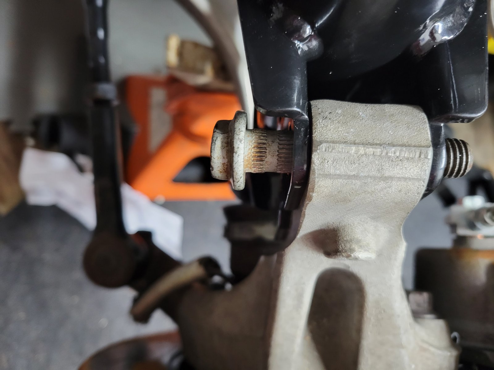

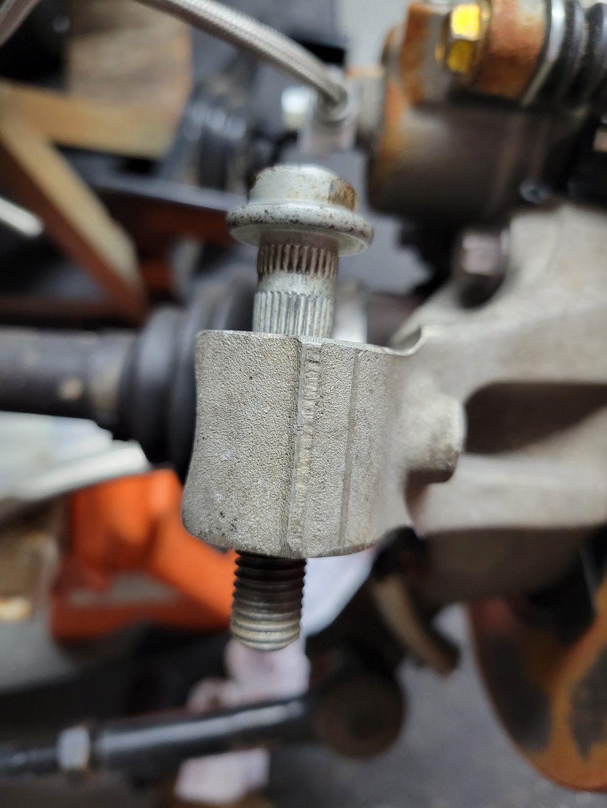

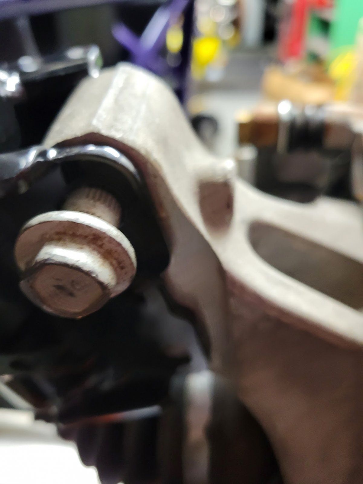

Installing the DF rear coilover kit and was surprised to find the lower donor mount bolts don't want to go all the way through the mount. I honestly don't recall if they were all the way in when I removed the donor rear suspension bits. Both the DF shock and the donor car shock mounts appear to be the same width. What am I doing wrong here...or is the expectation that you use new hardware to bolt these in? I was hoping to get these installed today! :confused:
31311
31312
31313
ccgillett
The splines will pull into the knuckle so the bolt doesn’t turn. Just tap it in with a hammer. If you notice the bolt doesn’t have much of a head to put a wrench on.

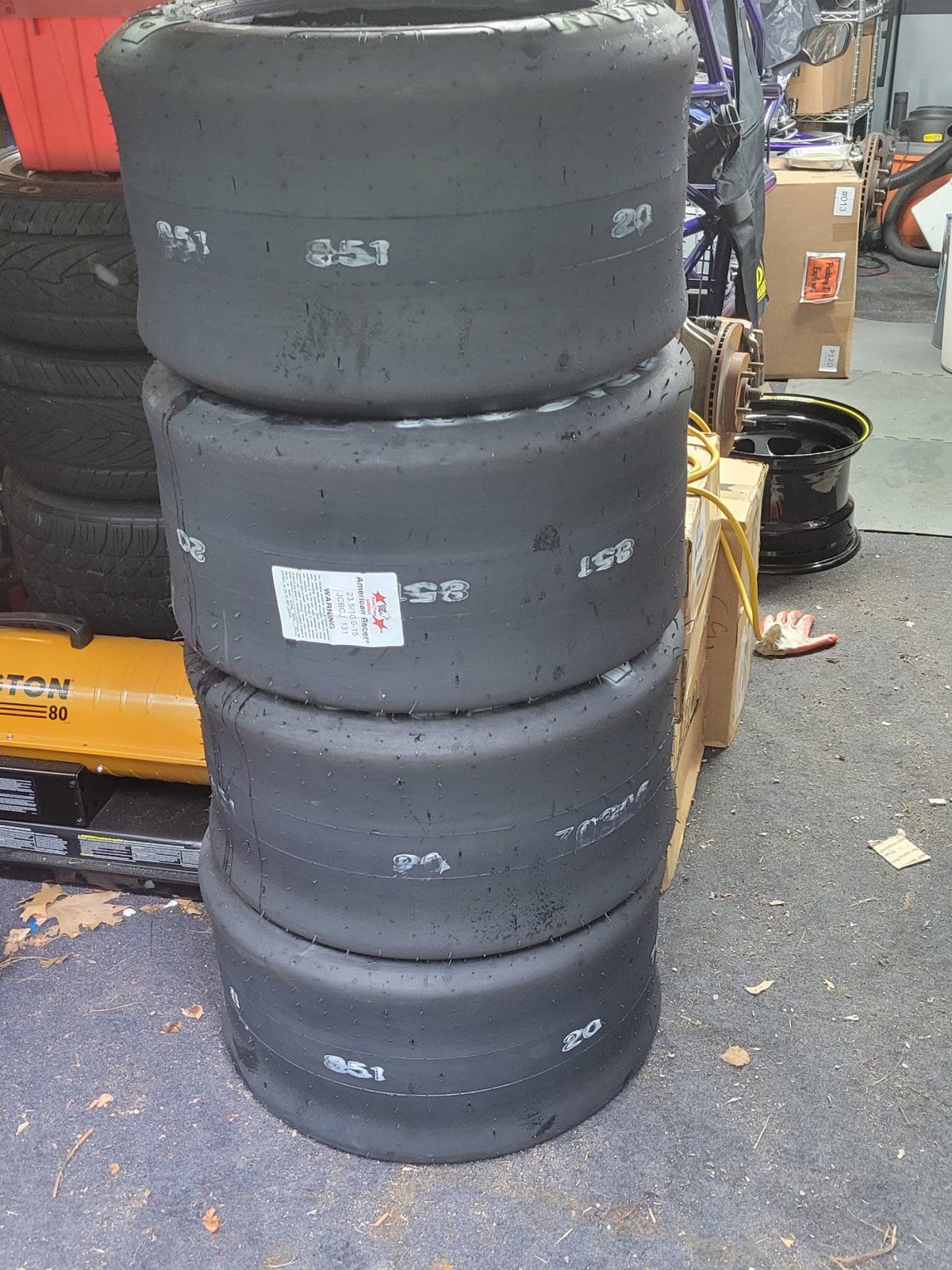

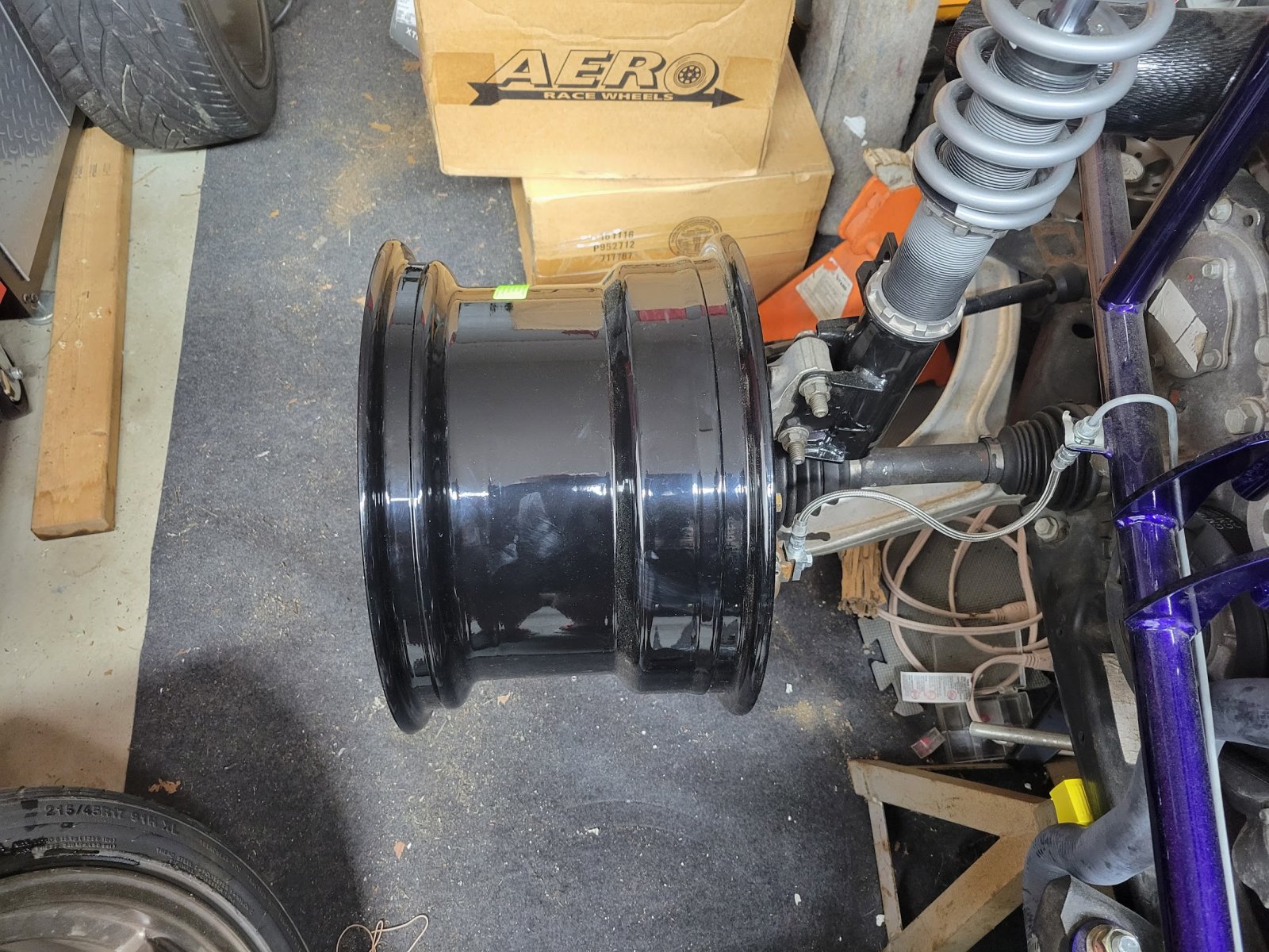

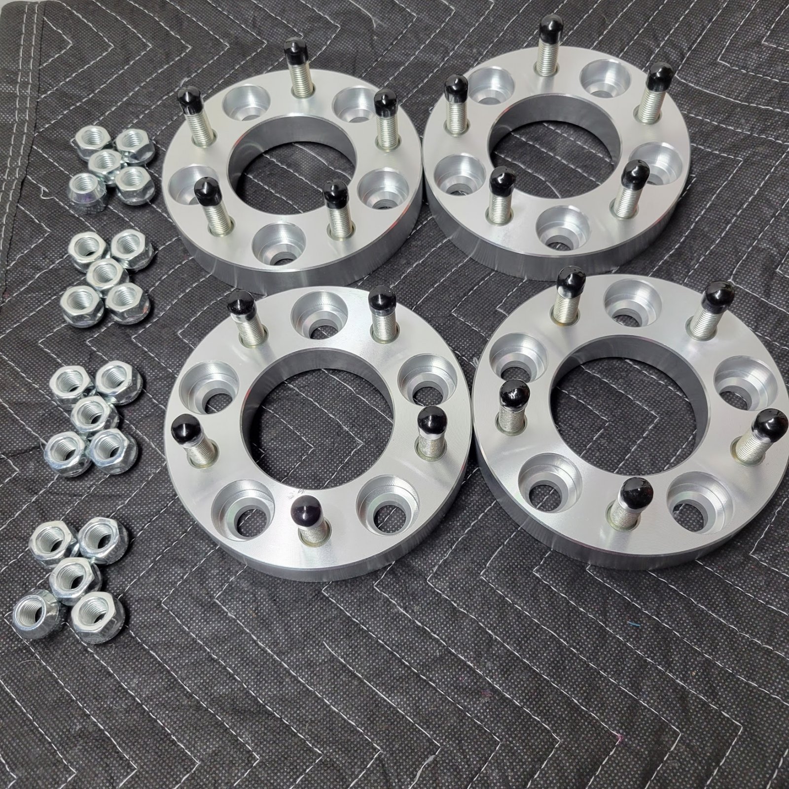

I decided to go with different wheel and tire package than what came on the partially-built car. Borrowing/stealing from @JBINTX I went with this:
  • Track tires 15x10 American Racer 23.5/10.0-15s (131 compound)

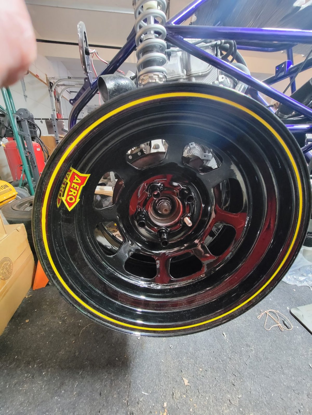

  • Track wheels Aero Race wheel 50 Series 50-104550 15x10 with 5" back space (these clear the calipers on the 09 tc SS model), Day motor sports 800-543-6238)
  • Track wheel spacer/adapter - 1" to get from the 5x110 to 5 on 4.5"
The supply chain is weird. I got the spacers right away, from US Wheel Adapters in Lubbock TX. I suspect these were the easiest thing to get quick because they manufacture locally and were probably not waiting for materials to arrive from off-shore, etc. Great guys to work with, recommended.
The Aero Race wheels came next, from Day Motor Sports. They look awesome, and arrived quickly. They are also made in the US in Estherville IA.
The long pull was the American Racer tires. I waited several months for those, and that turned out to be OK since the car isn't really ready yet.

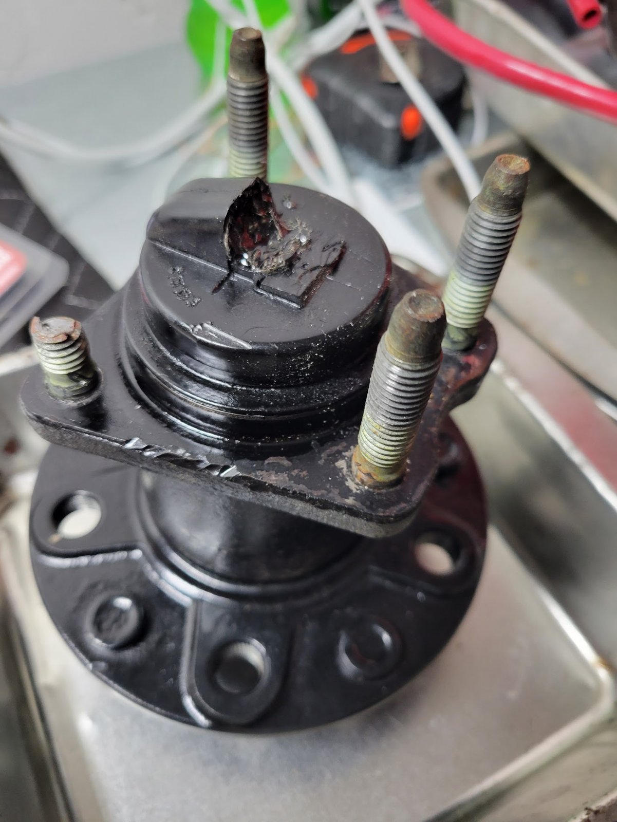

I got the rear coil-overs installed, hopefully correctly sorted out the front tie-rod situation, and then turned attention to the front suspension. I've been eyeing things suspiciously up there for a while, mostly because when I received the car nothing was torqued to spec - in fact it was all mostly finger tight. So I decided to go through everything and check the assembly process, set everything to torque spec, etc. So I pulled everything off the car, and re-did it. And that's when I found this bit of bad news:
33455
This is not only annoying, but it's really going to slow me down if this isn't field serviceable. The car came with 5x114.3 hubs, and I'm coming to learn that as a result everything needs to be custom ordered. I really hope I can get that mounting stud removed and replaced. It's not cast in to the piece, and it doesn't look screwed in. I soaked it with Aerokroil penetrant, and in a day or so I'll take a torch to it and see if I can then hammer or press it out. In the meantime I asked DF to quote me on a new hub just in case.

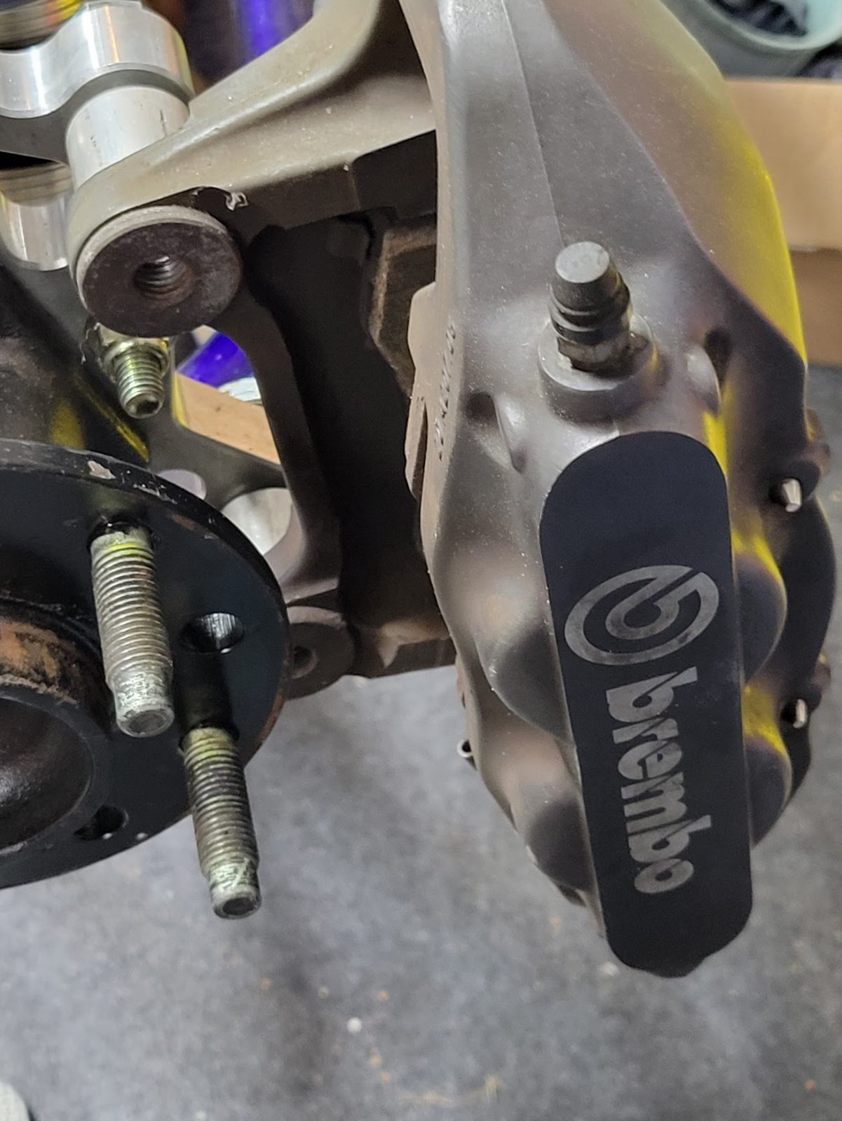

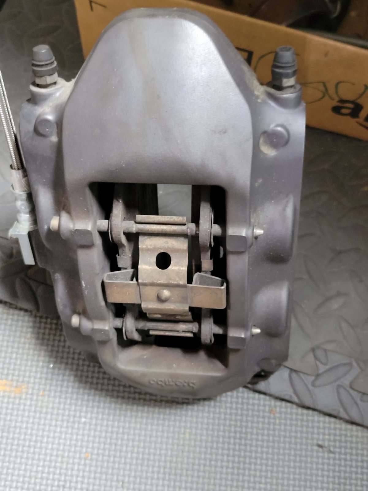

These are the SS/TC donor car Brembo fronts installed on the Goblin, with big honking rotors. These are not going to work for several reasons. First off, the new wheel/tire package won't clear the assembly...no real surprise there I suppose. More importantly, the Cobalt SS unladen/empty weighs something like 2,975 pounds and I believe when full of fuel, luggage, passengers, etc. can go up to 3,900 pounds. So it needs a LOT of brake to pull that down from speed. I am guessing that our cars will weigh in around 2,200 pounds, so these will massively over-brake the car. That's never fun, leads to lots of wasted $$ on flat-spotted tires, and arguably isn't as safe as something you can pull down hard without lockup.

The Brembos are now off the car - I'll toss 'em on a few lists for sale - and these smaller calipers will go up front. Of course now I need different rotors, and rooting around the forum it seems the only path forward there is to source them from DF. I'm waiting to hear what they have for me.

The rotors you have are fine. The front rotors as supplied with the kit measure approx. 11 inches in diameter. If you want to further reduce front braking force, you can source the 10 inch rotor and the front caliper bracket from the 4 lug Cobalt and/or add an inline proportioning valve to the front brake circuit.
The rotors that came with the car definitely won't fit - they are 14" diameter from the Brembo donor setup. The correct size is around 11-12" diameter. I hope to have those soon.
The picture I saw in the other thread looked like it was about 11 inches per the tape measure or whatever. My mistake.
Because you have hubs with 5x114.3 PCD, you'll need to have your rotors redrilled.
