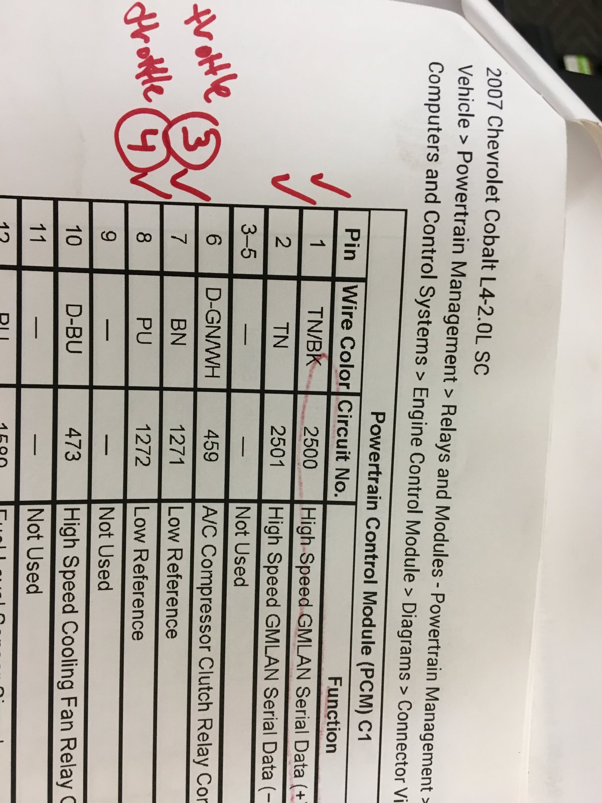

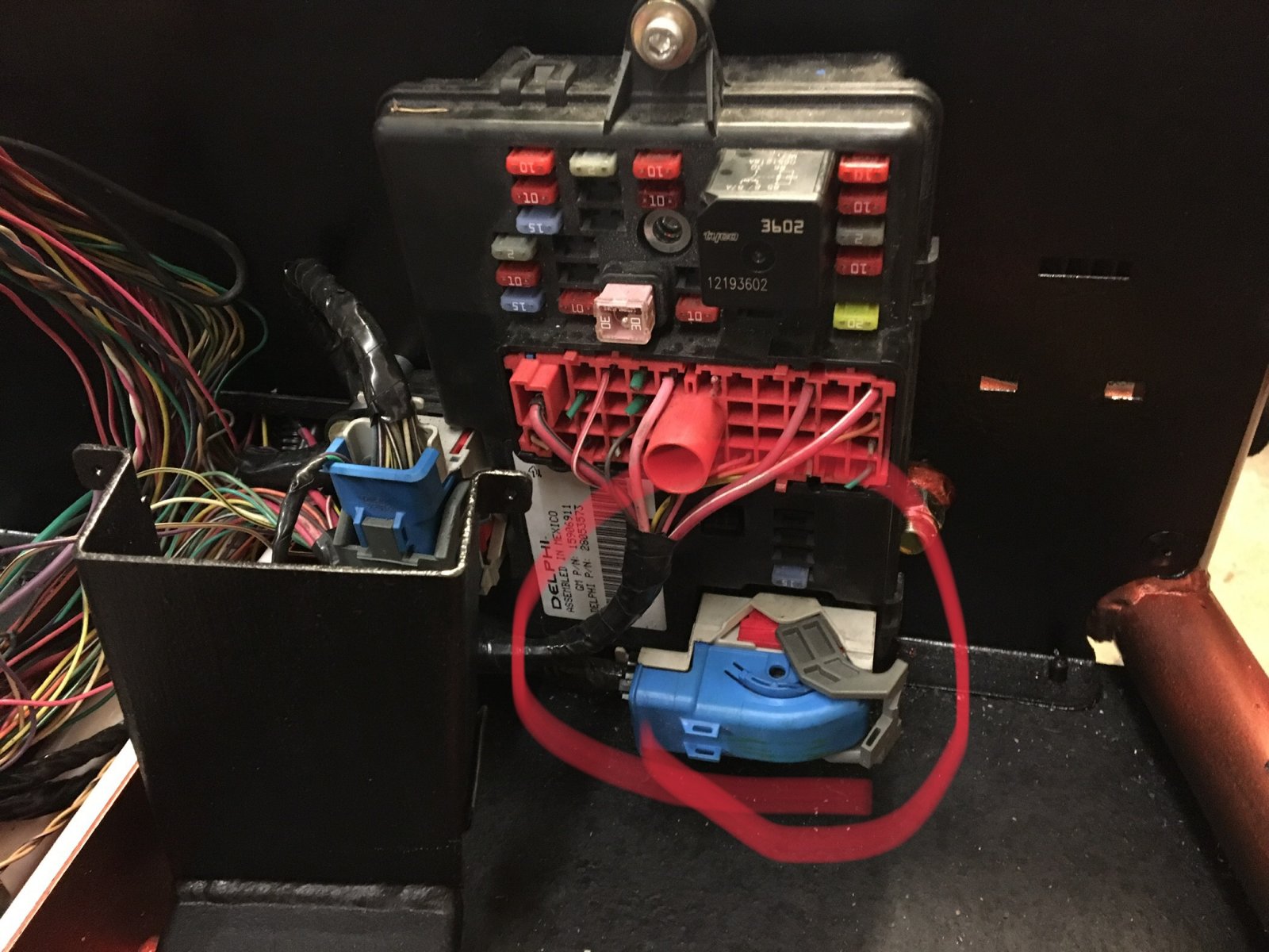

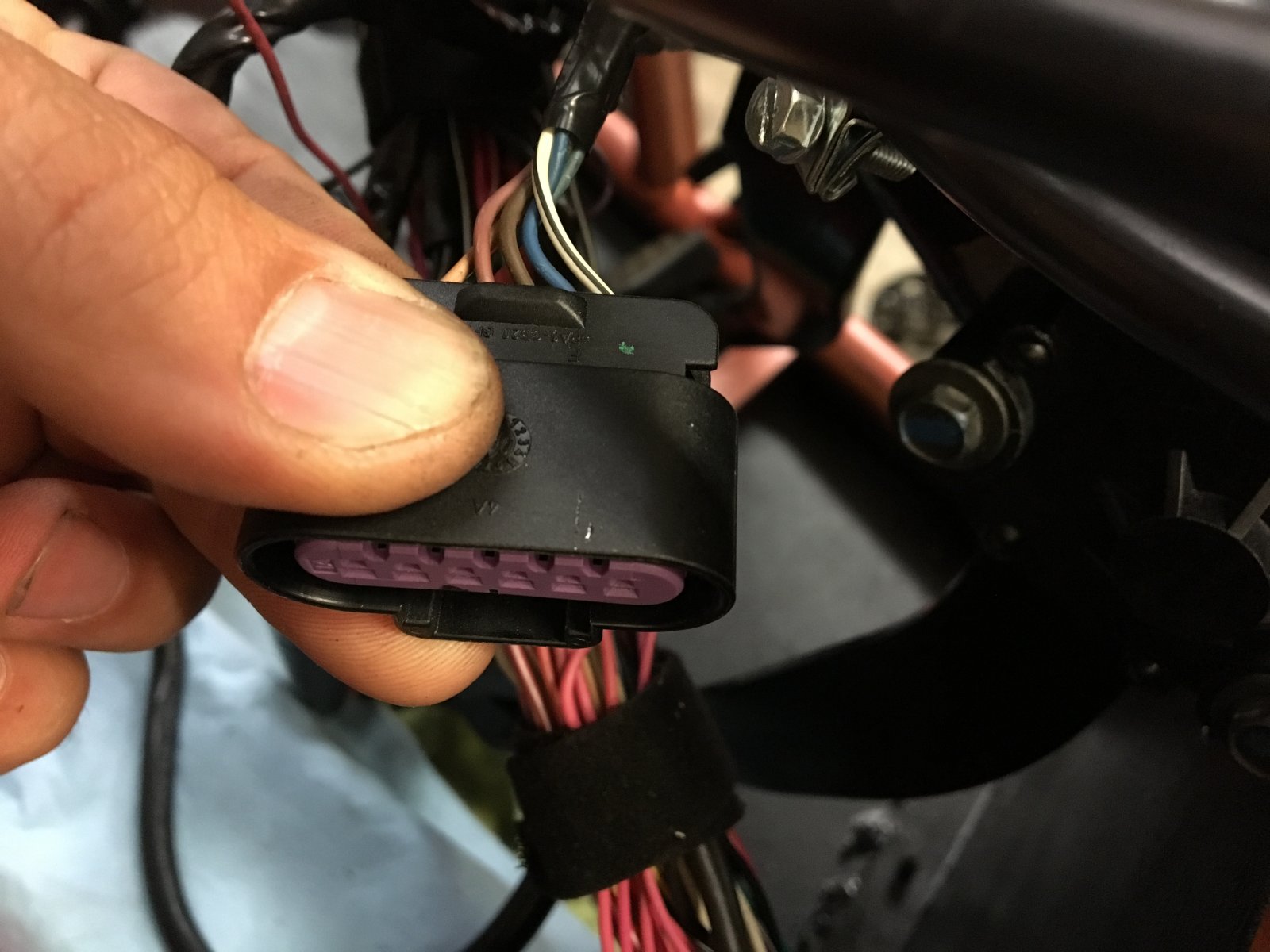

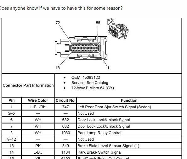

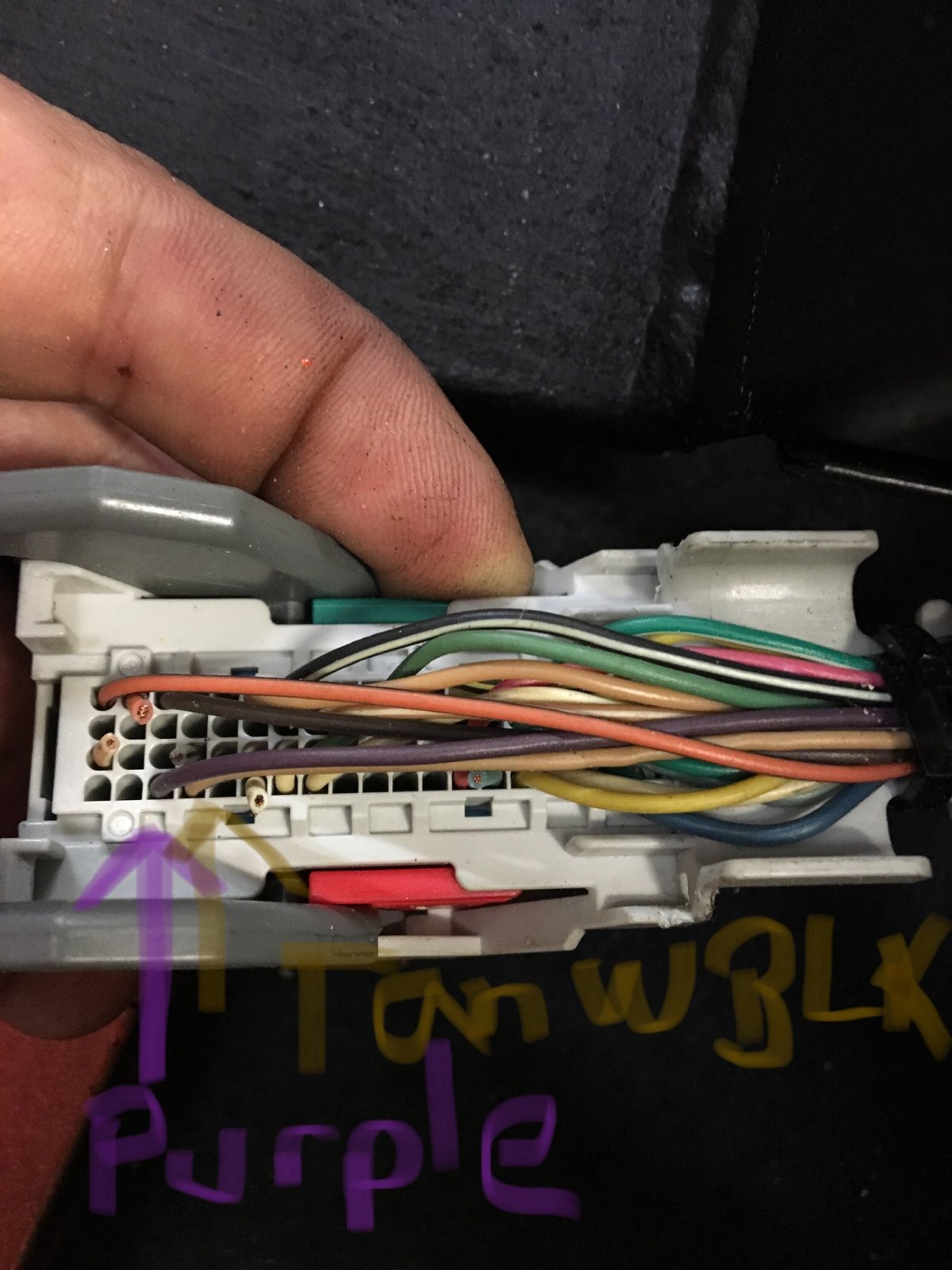

Found the location of my mystery purple and tan w/blk wires they go back to the blue BCM plug at the front. No splices just straight back.
1 minute ago
Post 50 by DCMONEY shows this BCM plug as not having these wires 3 and 4 : maybe its from a different model ? 678 are white 13 is pink I think it matches up but no wires on the diagram..

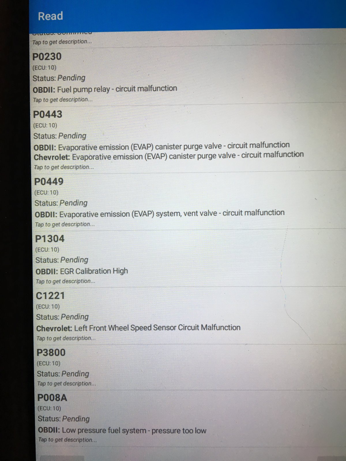

I have scanned it but haven’t attached HPTuners yet. P0230 is one and evap code which I guess I can disable with a tune.

DCMoney
1 minute ago
06 ss has different pin outs.
Here's a link to 07 ss alldata BCM, ECM plugs pin outs.

I ran a ground straight to the fuel pump and seems like the only code I’m getting now is p0452. The car starts and shuts off with the relay jumped, with the maf unplugged and with a different relay. I’m thinking maybe there some sort of vacuum leak or bad wiring somewhere.
ccannx
I used a circuit tester and found only 1 ground at the fuel pump relay that was coming through the pump brushes back. The other ground for ignition/relay trip was missing. I had no ground on the harness block that the fuel pump was on so I wired one in to a common associated with that pin. The car started and I let it run for a few minutes and shut it off. Now it starts and shuts off after a few seconds. No codes on my scanner. Going to try the DCT scanner on HPTuners this evening when I get home.

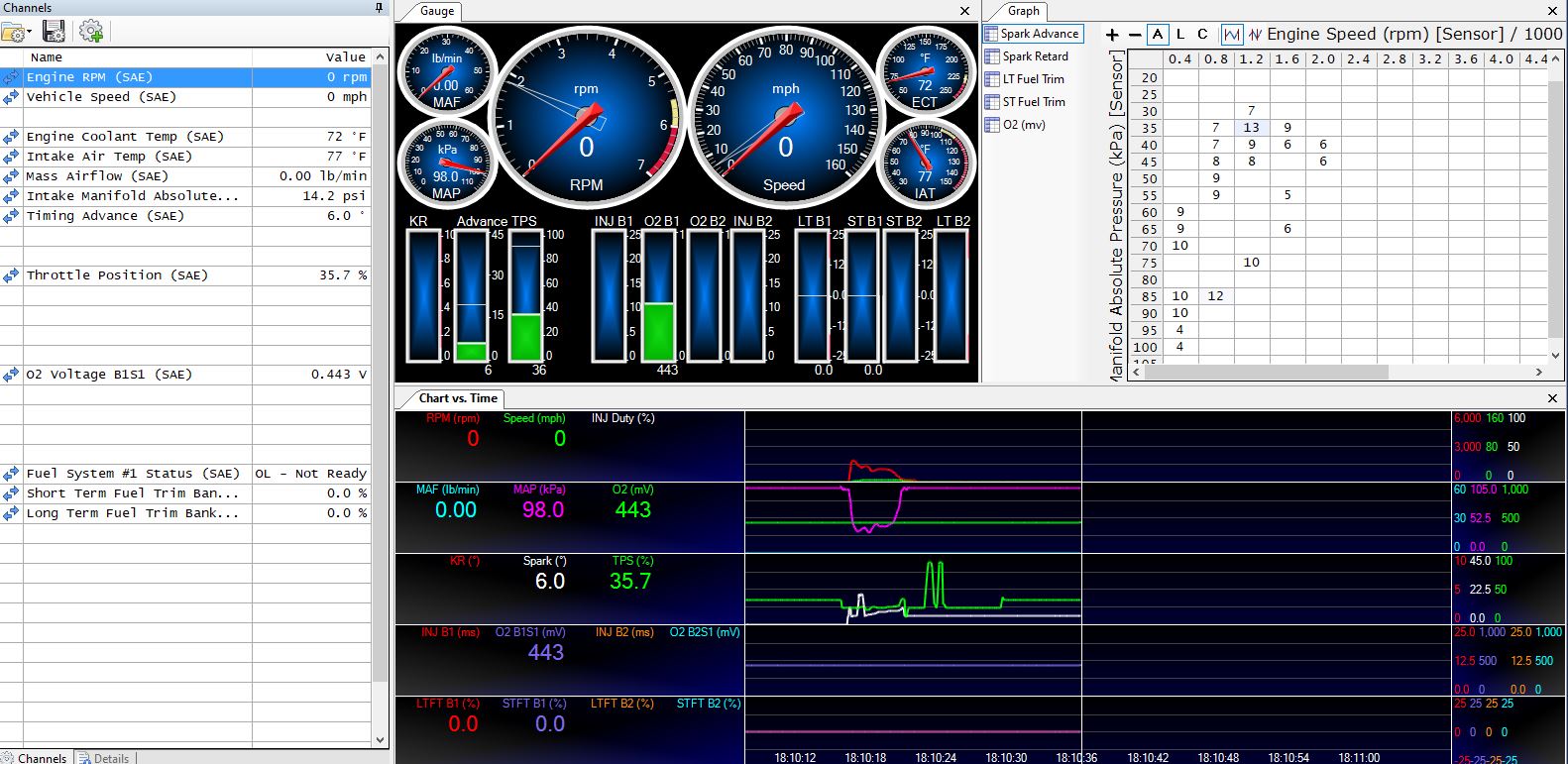

VCM Scanner from HP Tuners had some 2D graphs that were only populating one row (1D graph), then I realized I had a bad MAP sensor. Cheap fix ($10.20), but the car ran better.

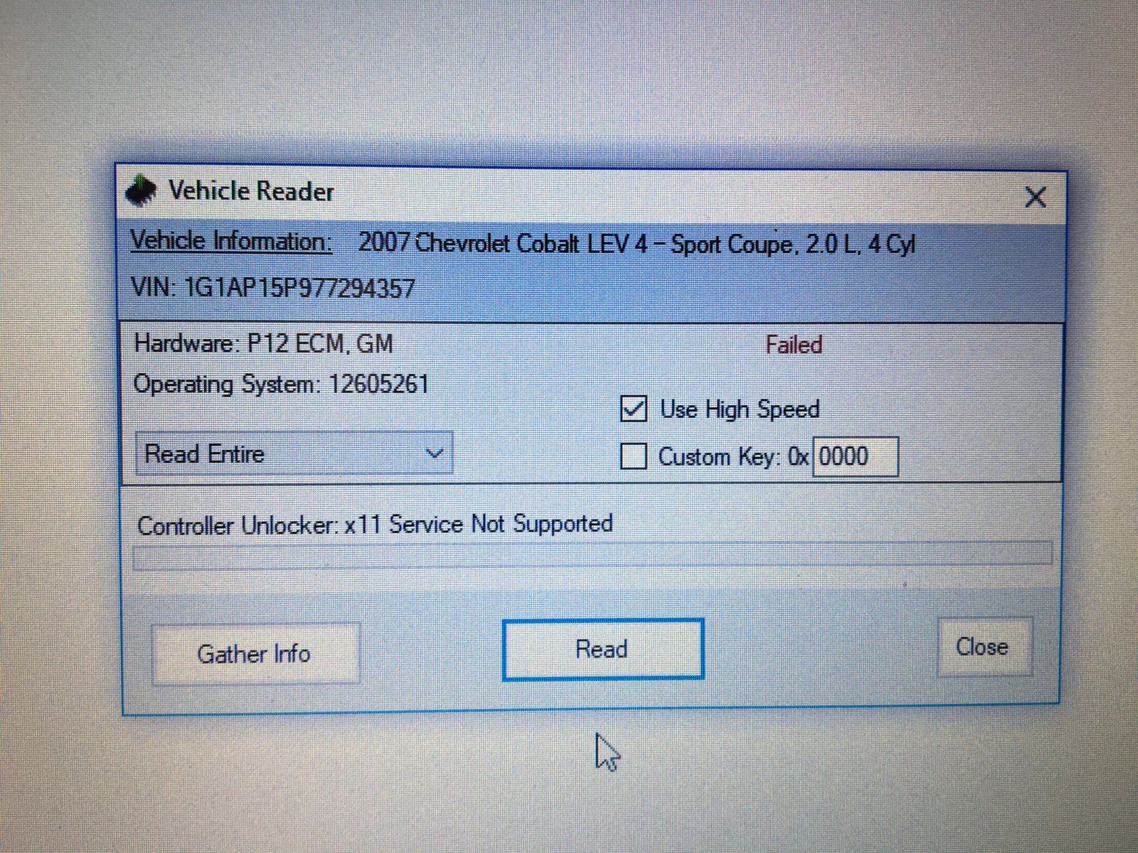

Attempted to read/download the stock tune with HPTUNERS. Got a failed message... not sure what to do with this. “Controller unlocked: x11 Service Not Supported” I emailed HPTUNERS support for some guidance.
I started the car and captured a very brief log. The MAP sensor looks off the charts but of course this isn't running more than a few seconds. long and short term fuel trims Showed 0% for some reason.
No obvious codes with the VCM scanner other than EVAP that would indicate why the car would be shutting off.

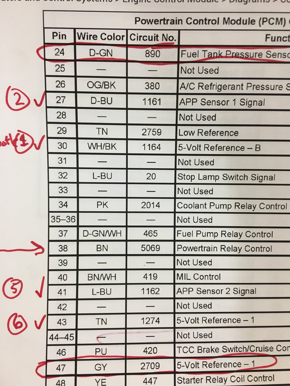

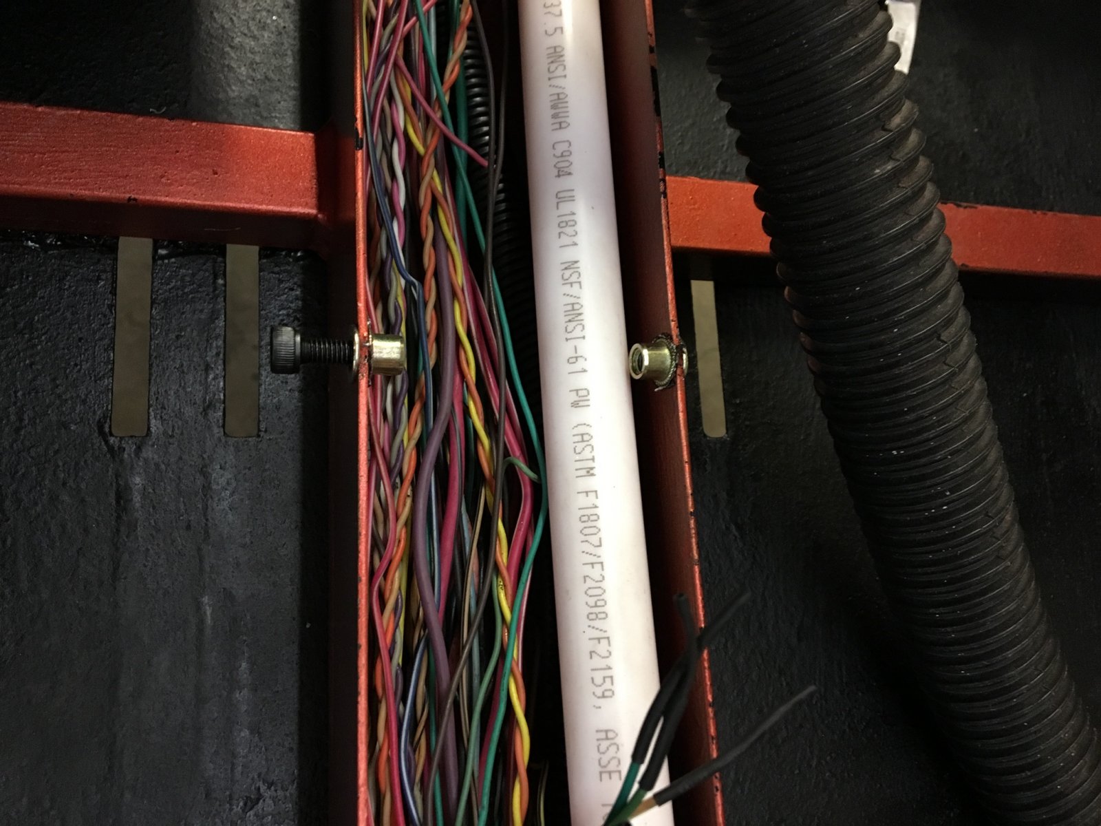

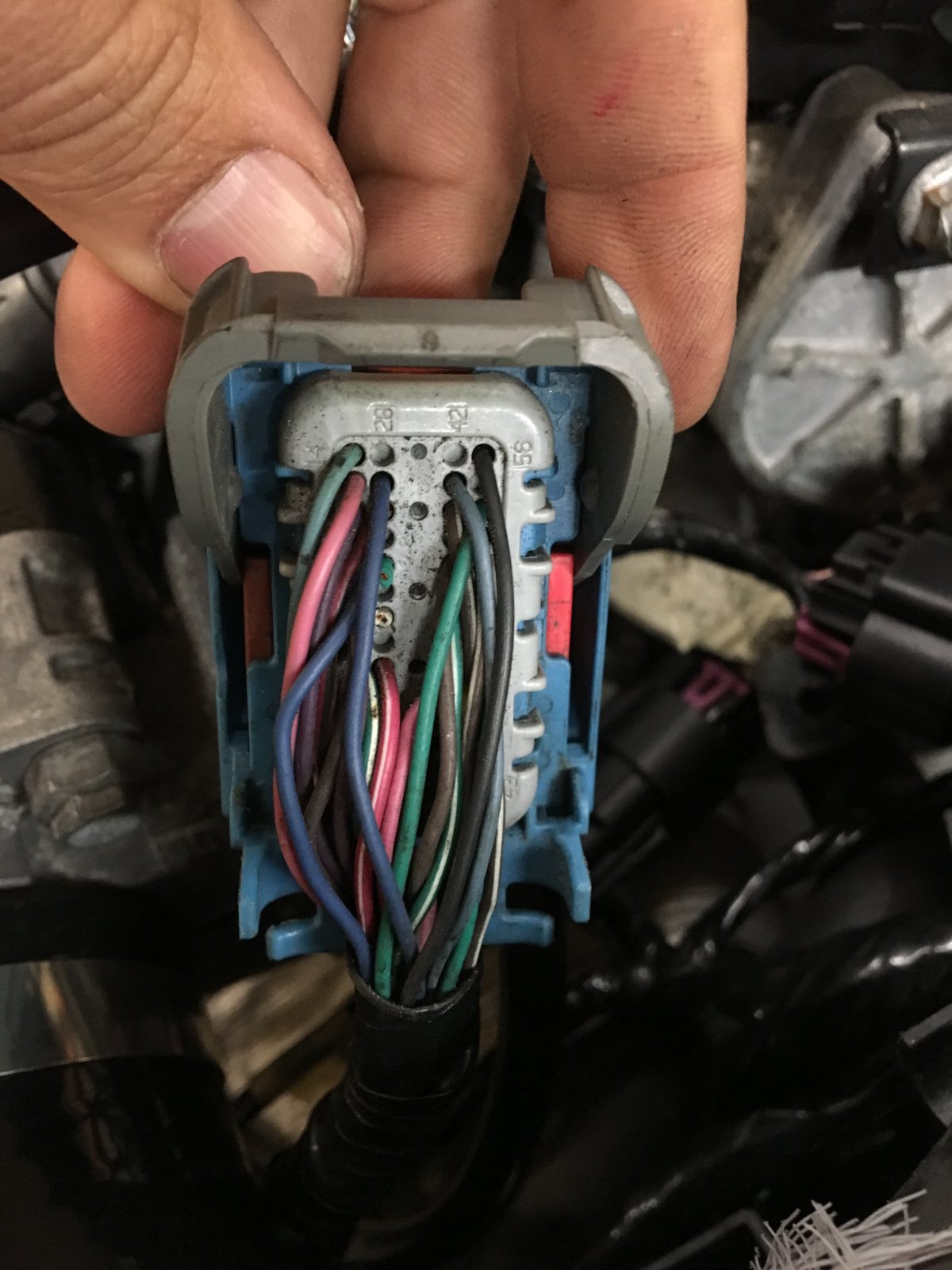

I went ahead and verified all my high and low canbus wiring from the power steering to the BCM and then to the blue ECU plug at the rear. Everything checks out and the car is still shutting down 2-3 seconds after start.
I ordered a new throttle pedal in case my poor wiring messed up the other pedal and still no luck.
Verified all pins from throttle pedal go back to the same blue connector on the ECU and took a couple pics of the pins they land on back at the throttle for future reference.

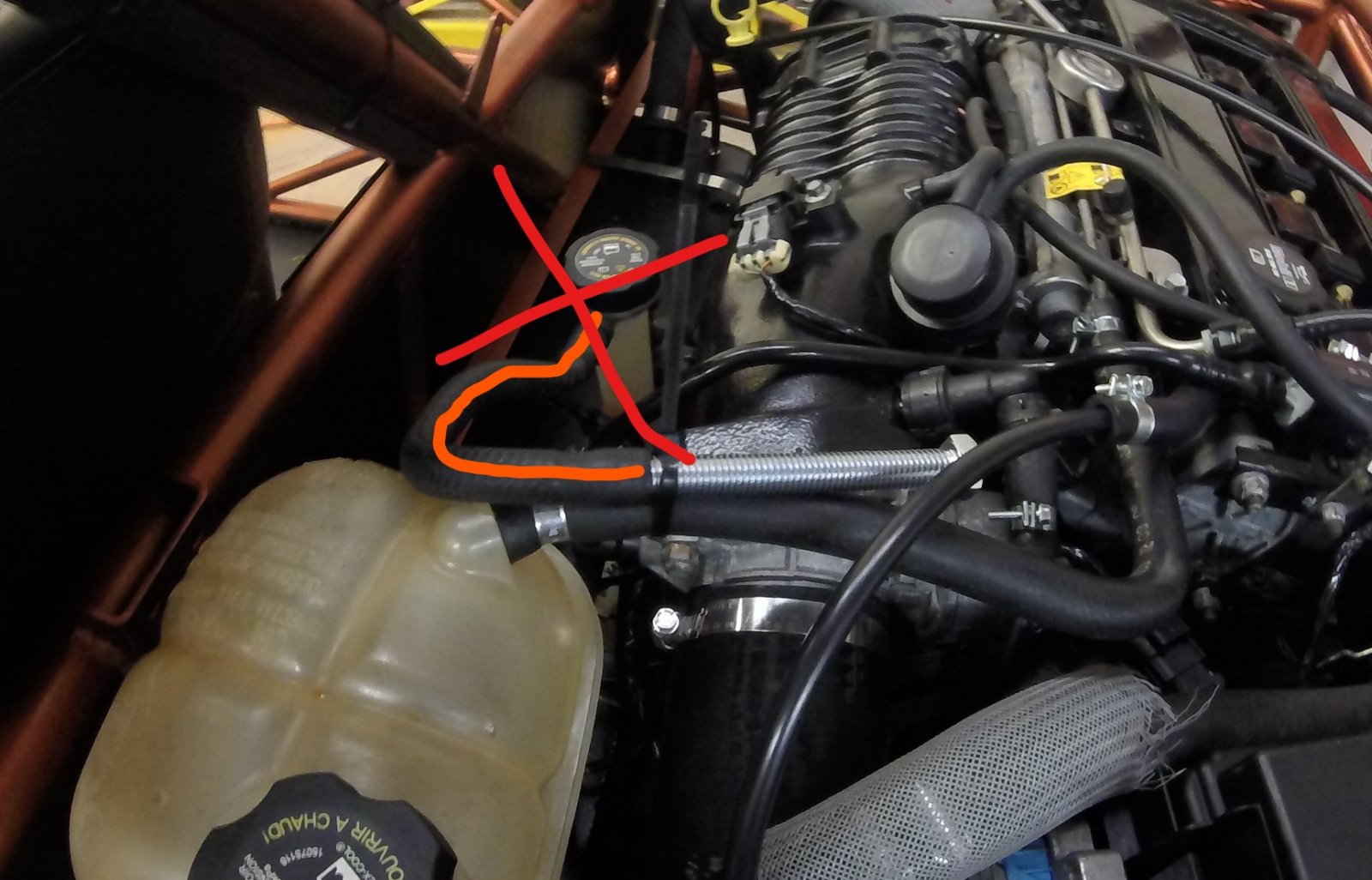

Got the goblin running under its own power Saturday night so naturally I loaded the car up Sunday morning and took it to an autocross ! What better way to shake out the bugs, 10mm's, a 6 inch long bolt, coolant and some gas.... oops.
Everyone loves the car, definitely a big hit with the autocross crowd.
I managed to wipe out a wall of cones at the end of my last run and had a little damage to the front radiator just lost one of the clips that holds the fan to the back of the radiator.
The front radiator mounts got scrapped and hit a couple times from underneath from some bumps and low spots. I may consider raising the car a little in the future.
I have some coolant hoses I need to figure out, left one unhooked and never noticed until I spun out on the first run and splashed coolant/water on the course.
My shifter is not very user friendly I started every run in 2nd gear so I didn't have to make the 1-2 shift which was surely going to fail if I attempted it. The mount on the rear is flat and I think it should be at different levels like the stocker but I never figured out how it was supposed to mount.

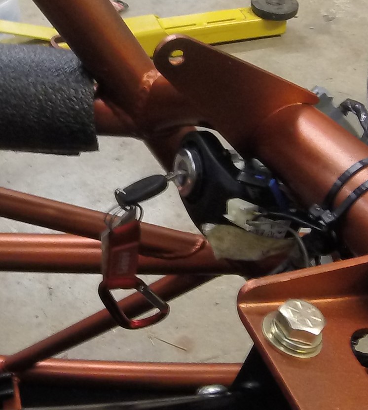

My left knee makes contact with the key while under weight transfer, I need to research the push start thread to see whats needed to eliminated that.

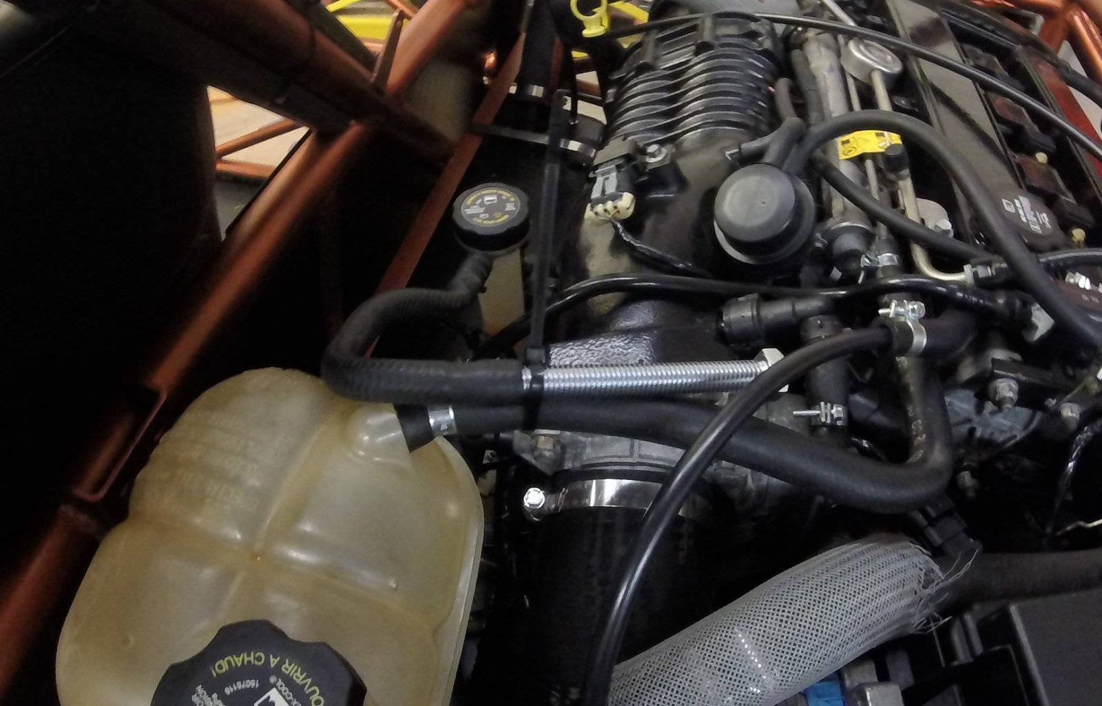

baustin
That hose you put a bolt in is the supercharger overflow hose. It doesn't connect to anything, just hangs there pointing down in the cobalt. Not sure how full you got that system but I think mine is supposed to be full when the coolant is only at the bottom of that fill tube (height of a hose thickness, not actually up into the full tube cylinder) if that makes sense.
