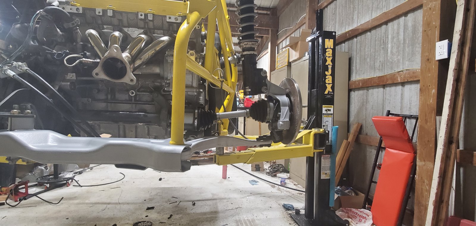

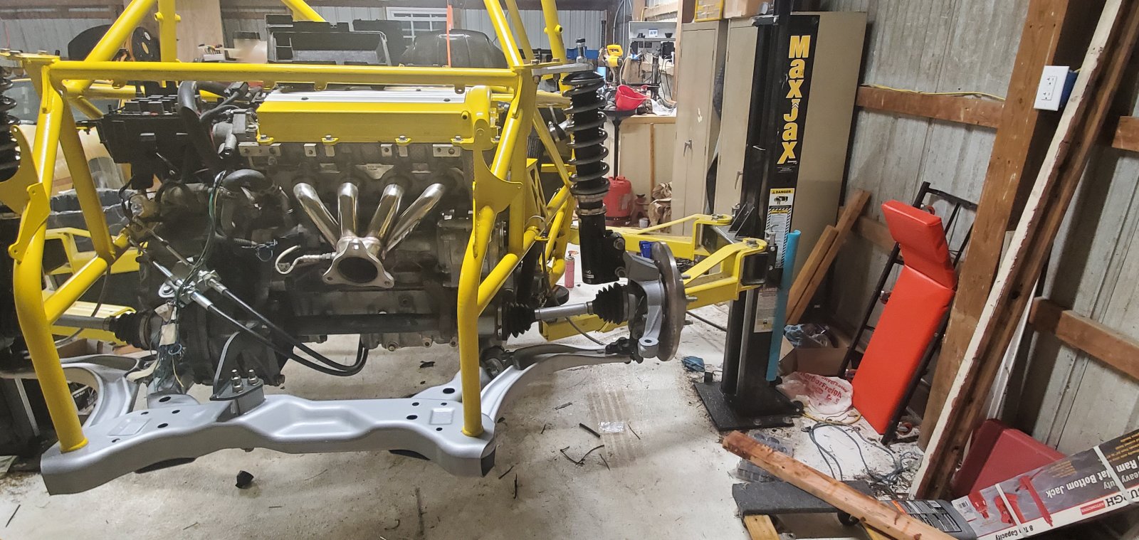

Just looking for a quick sanity check here. I got the rear suspension and coilovers all assembled and bolted up. Even with zero load on the suspension, the axles are actually at an upward angle, and the suspension arms are about perfectly horizontal. With no load.
Doesn't that seem high? I expected there to be a little bit of suspension droop when the car is in the air. Did I assemble something wrong? It all went together smoothly, fits correctly, and I can't imagine what I did wrong, so maybe that's just how it is.
Are everyone's axles at a constant upward angle?

It looks like you've got the coilover body threaded pretty far into the base that attaches to the knuckle. Adjust per the last image in Chad's post and see what happens.
C
I bet you're right, I didn't even realize that portion was adjustable. I'll check it when I get back from work this evening. Thanks.
C
After adjusting the threaded portion of the rear struts, the rear suspension looks great. After 20+ years of engineering, being a motorcycle mechanic, and tinkering on cars, I still run into new stuff. I have never adjusted a strut-based coilover before.

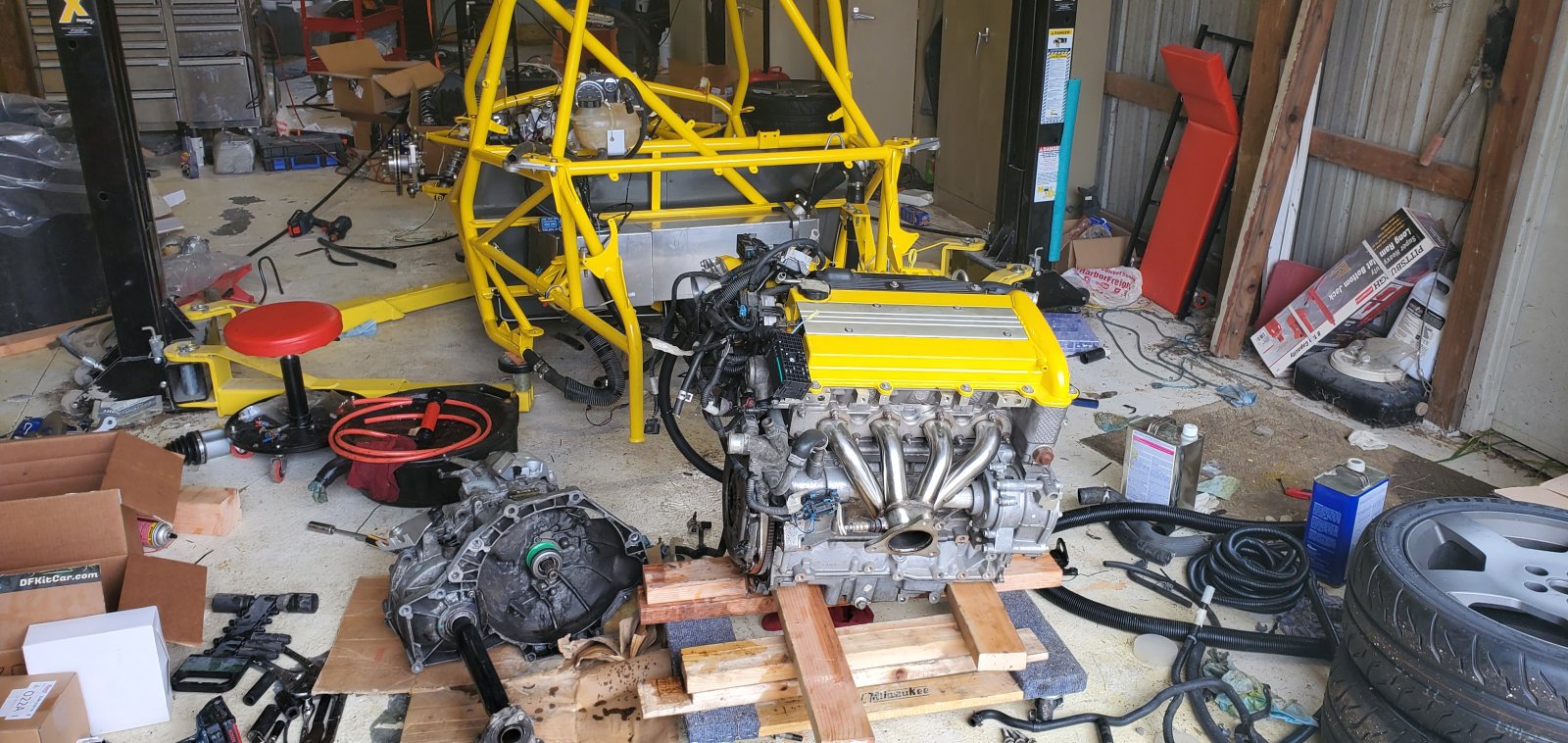

C
It was 2:02 when I took this picture of the disaster area that has become my workspace. My last post was at 11:31, and I probably spent half an hour just trying to figure out what I was going to do. So in reality, it only took 2 hours to get the entire engine out.
Assuming it takes the same amount of time to put it back in (optimistic), It becomes a 4-hour mistake. I've done far worse.
It appears to be the throw out bearing that's leaking. I'm going to replace everything inside there, and never do it again.

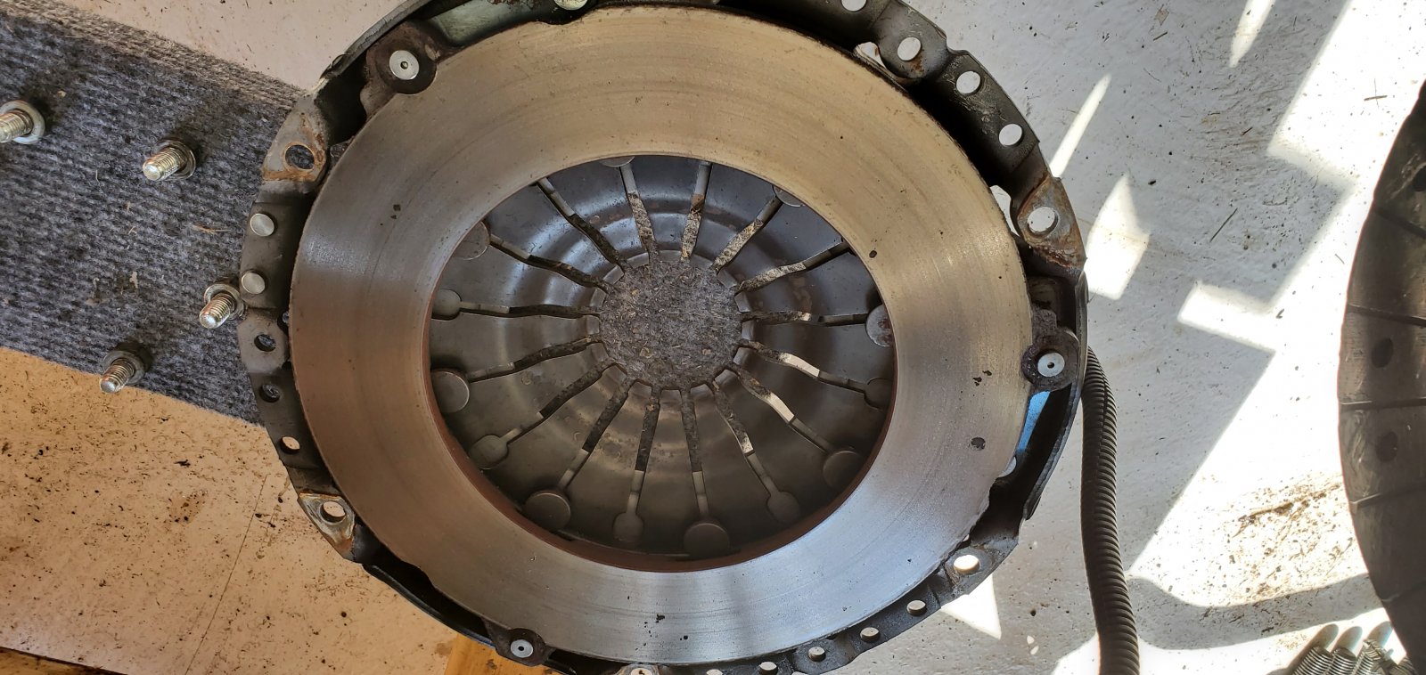

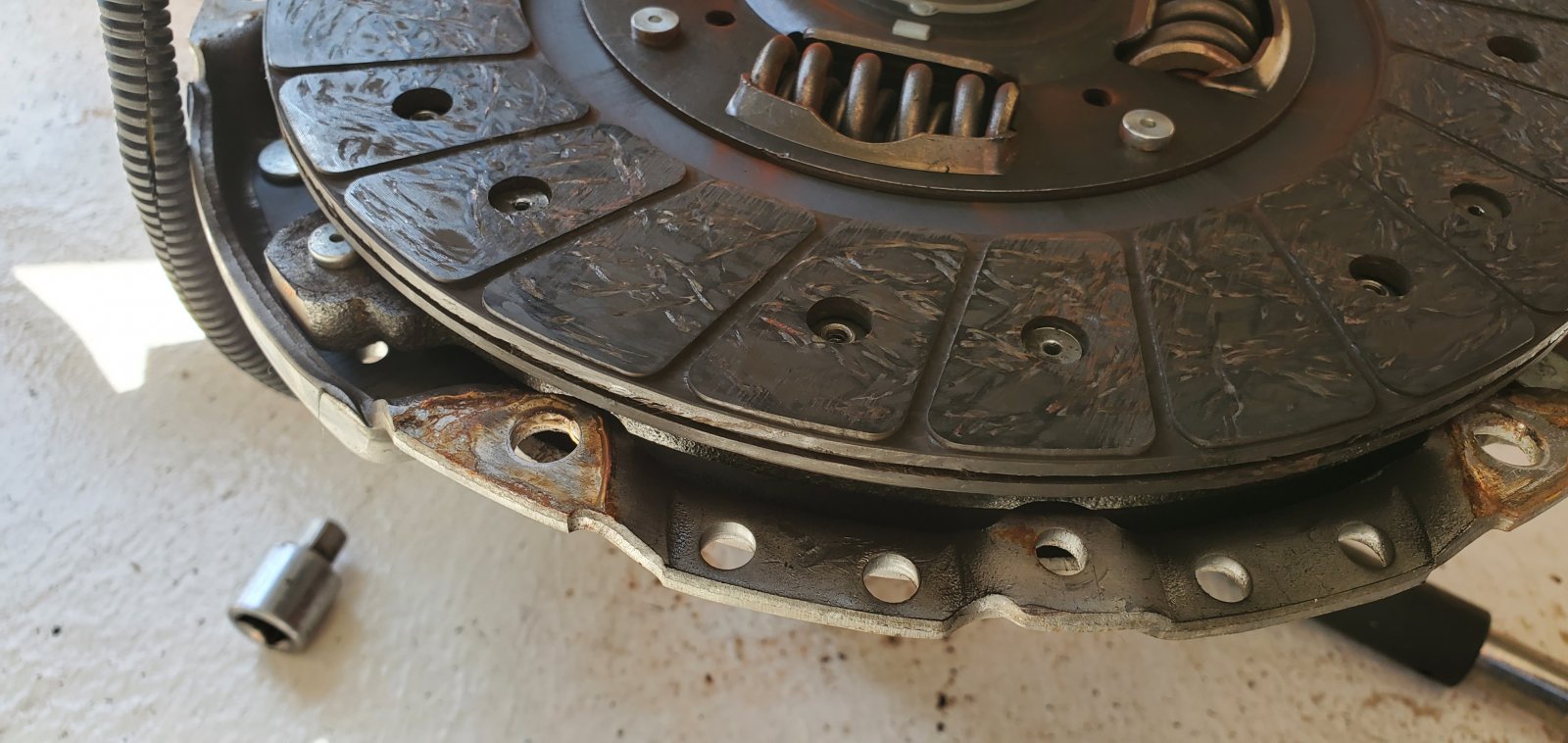

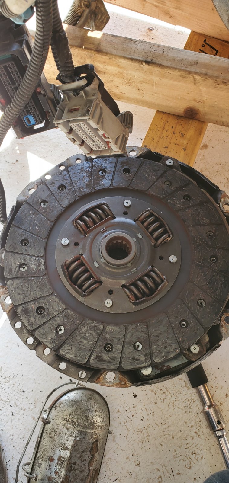

Pics of the clutch and pressure plate. They sure look good to me. Anybody see a reason these can't go back in?
Looks similar to what I found. 82k on mine. I decided to replace and upgrade at that time.
