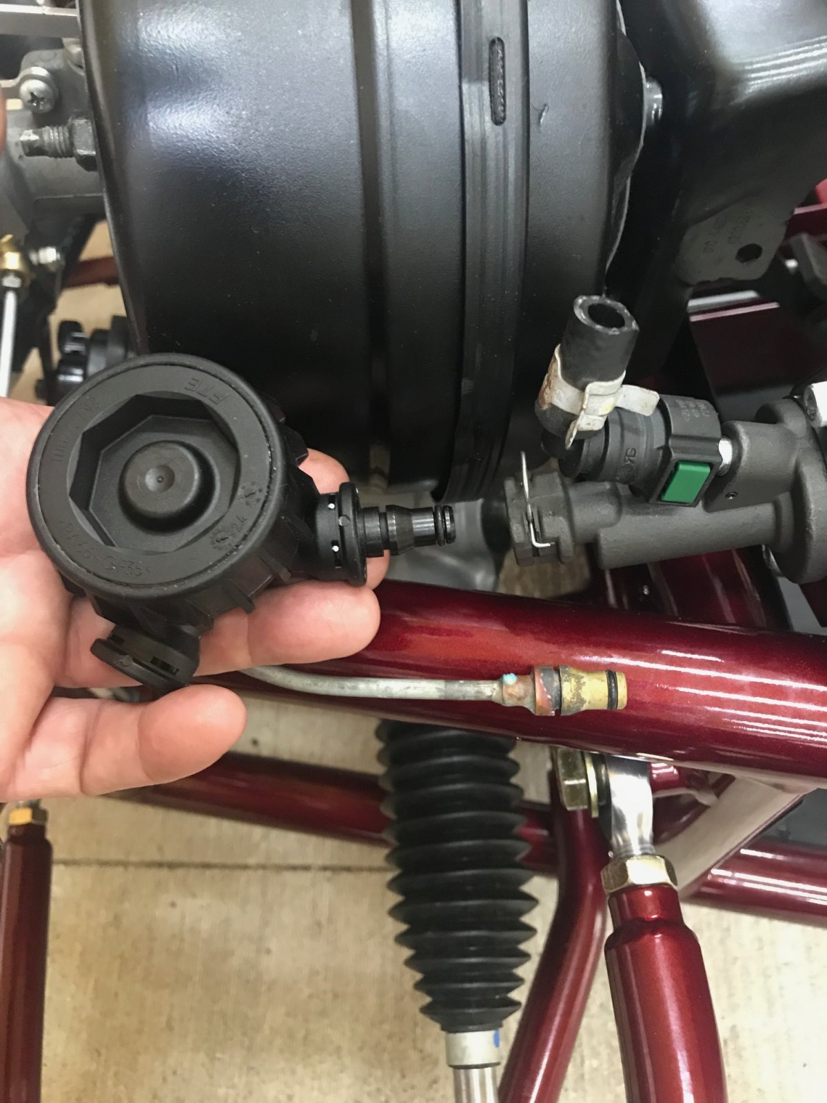

What parts of this are reused or discarded? How to hook it up? Thanks !!!

You use both ends, but not the hose. DF supplies the line that goes from front to back. That does look a bit different than mine though
Y
I used only part on the right side of the pic (T with bleeder) which goes to the clutch slave cylinder. Supplied line goes from master cylinder and to the T (do not forget O-ring)

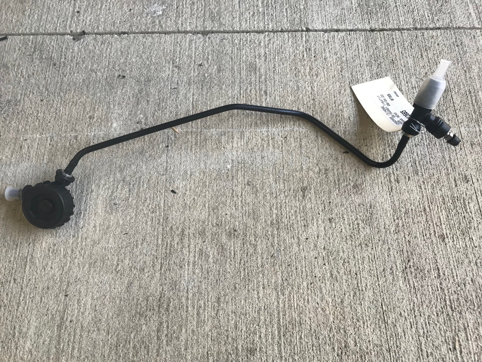

That is kind of what I figured. The other part (That round thing) from the donor does NOT fit anyway. The frame is in the way. Thanks !!!

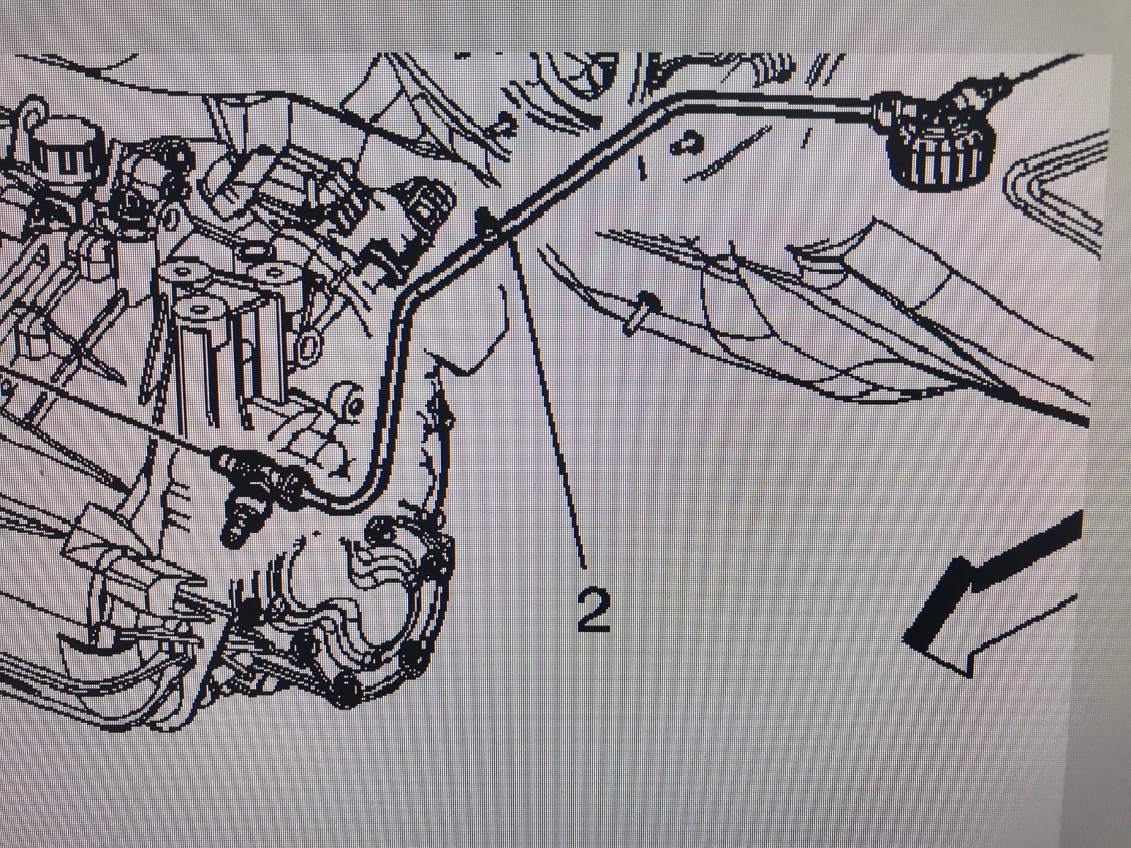

Here is the diagram showing the part in question (don't know what is does). And as you can see it doesn't fit anyway.

I didn’t use that piping. It’s literally sitting in my garage waiting for me to finally throw it away. If I recall, it goes from the clutch cylinder to the throwout bearing. DF will supply a new line to go from the front to back that will go in place of that part.
