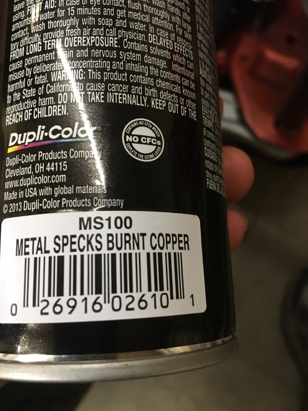

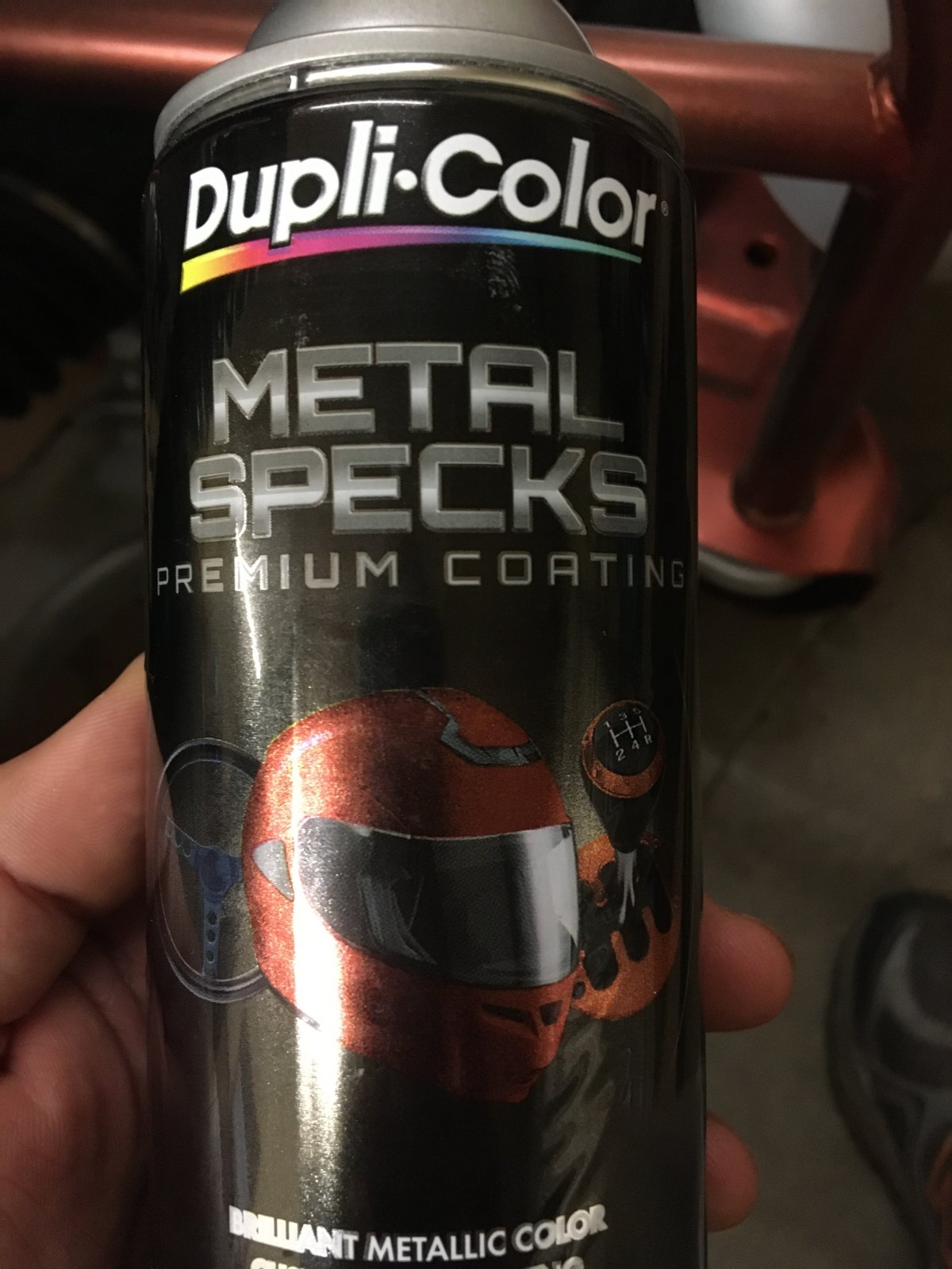

The POR came out great my spray job afterwards no so much. If i did it again I would POR do a light sand then maybe use a gloss paint or clear. The metal flake stuff I used was a pain it kept clogging up and splattering everywhere. Its a Monet !
Spraying metalflake is an art in itself and requires special spray tips that clog less - they will clog after time no matter what. I've sprayed it in the past and never did get the hang of it, but my cousin could spray it and it would come out perfect almost every time. Go figure. :cool: Sorry to hear that your topcoat didn't come out as well as you would like. Finish sanding may help before you apply a clear coat.

Still researching things here, particularly the POR15. The more I research it the more I'm liking it. I called them up to ask a few questions and mentioned metal flake and he said they do not recommend adding any metal flake to the POR15 or 2K overcoat. I like the idea of a metallic frame though... ccannx, what did you use for your spray job, was it the 2K product or an automotive paint? It may explain why you had difficulty spraying it if you used 2K...

The POR went on great and is tough as nails. The problem I had was with the spray paint I used and not prepping my surface well. The POR is extremely hard when it dries and is hard to scratch even with a wire brush so the spray I used barely holds on.
I was at Bass pro not to far back and remember seeing some awesome flake jobs on the boats. I think they use gel coats though.
Yep, the POR15 will dry within 24 hours - typically - and if you do not get an overcoat (2K, urethane, enamel, etc.) on it before then, you will have to sand it to get the top coat to stick. I made that mistake the first time I used it and ended up spending hours with a power sander getting the surface to a matte finish to accept the top coat. Once the chassis was done it looked great and still is no rust today (15 years later) on a Jeep YJ living up in the rust belt (northern Illinois).
